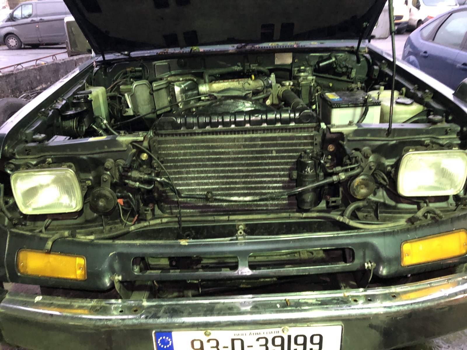

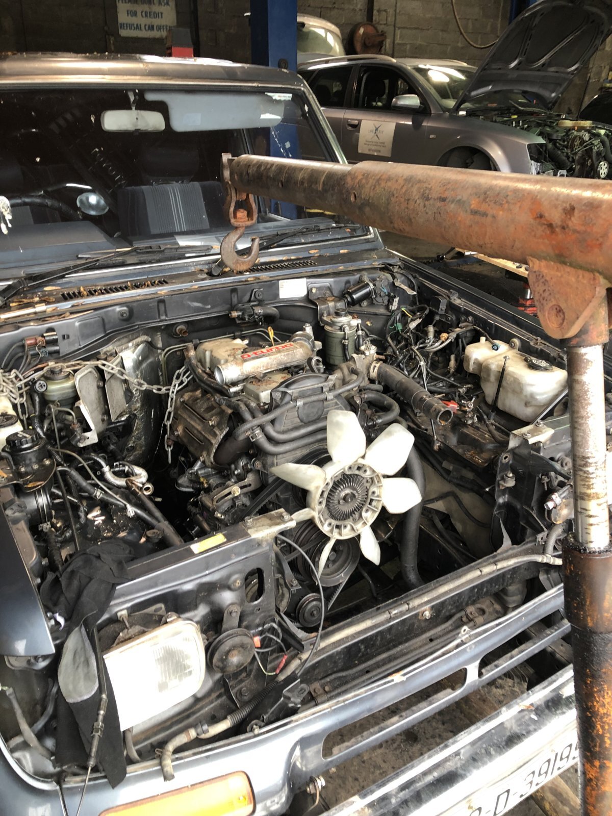

Quick update. Started taking out the 1kz te engine. Tight enough but out.
49C3B2D7-73A3-4A39-9A53-6C3B188272A1.jpeg 1DC7A90C-8BC9-4EFD-ACA3-FE5902388CA7.jpeg 9758B4B9-644A-464C-94A3-745DC3521591.jpeg
Had plenty help and a two post lift so not too bad. Unfortunately the 2 post got busy then so had to start stripping the lj on the ground which isn’t too bad there’s plenty to do standing

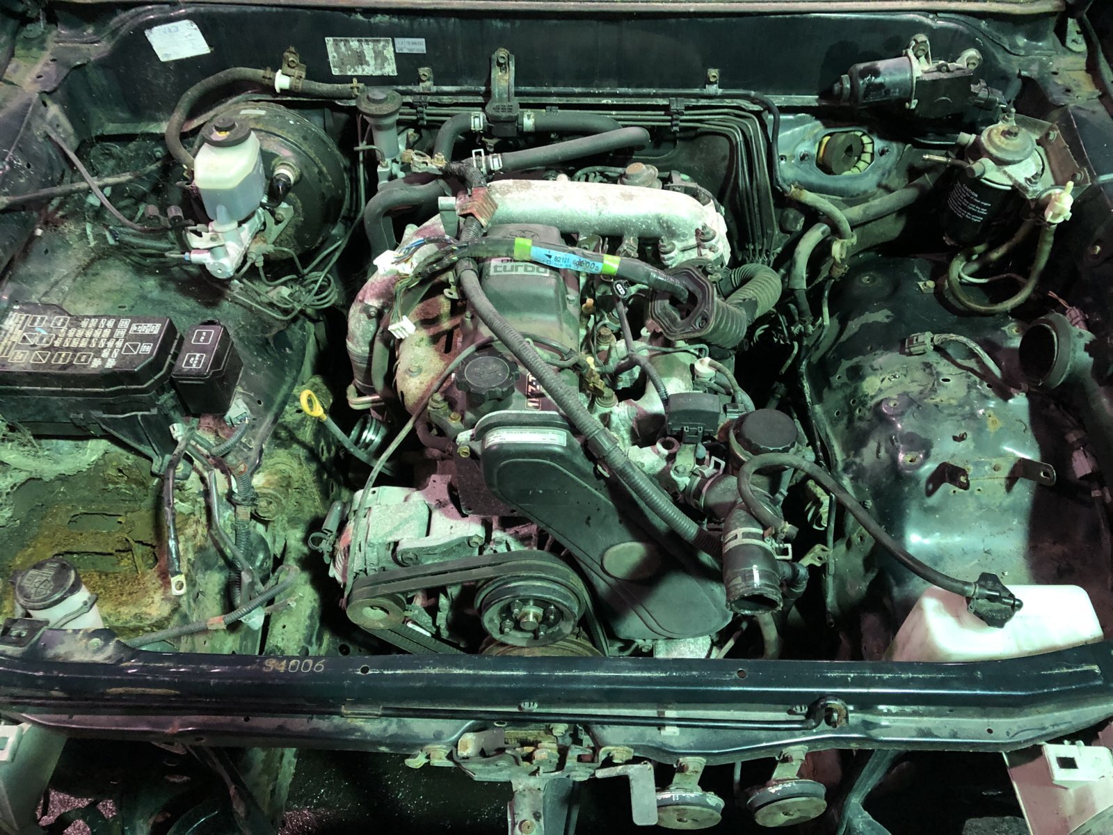

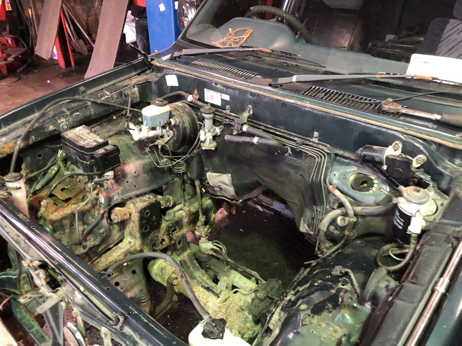

17C0F87A-D6F6-41D8-B967-B19DB829FC1C.jpeg A86B28ED-07BF-4CAB-99AE-4535A59991CC.jpeg
Iv all the front off now. There loads more room around the 2 lt engine. I’m hoppy going to leave the gear box in so I can bolt it up and figure out the engine mounts. I leaning towards removing the original mounts from the chassis or cutting them off from the donor and reweldind them back on in the Wright place. Only because it will look more original. My cousin the guy who owned the garage where I’m doing the work is a good welder so he can do that.

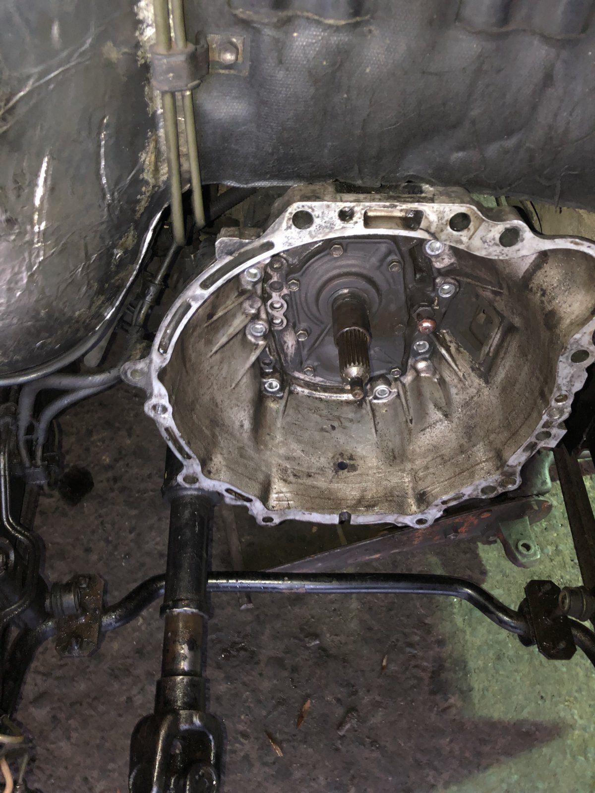

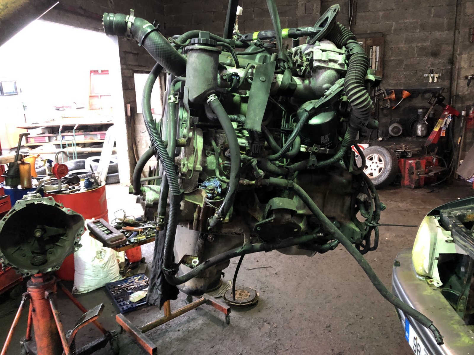

Bell housing changed. Which was easy. 2B53499E-0914-4031-9689-3D21B45CB47B.jpeg 5413D07D-70C3-4813-909B-DB996BC8AFAC.jpeg

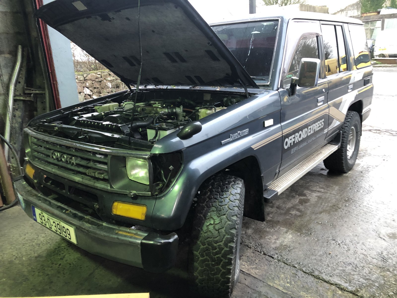

Just reading back on your post. If I get the engine mounts you subjected do I not have to move the chassie mounting points? View attachment 152861

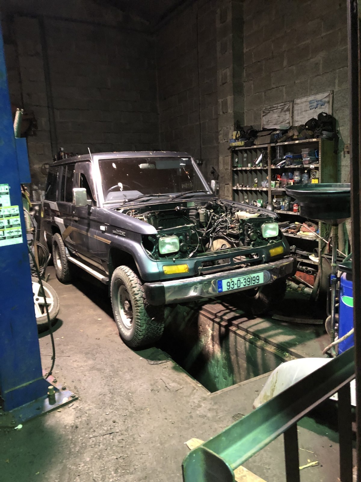

Here a pic as she stands now. I been moved three time since iv started from 2 post lift (idea) to 4 post lift (not as idea) to pit which in fact I’m out of the way in a coner not isn’t two bad
Looks good mate! Ref the sump unfortunately just is incorrect with the 90 one... it'll be sat on the front axle and unworkable.
