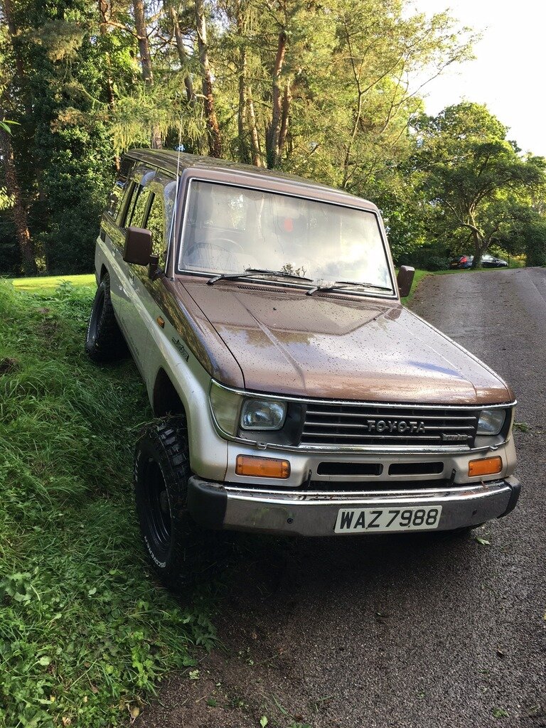

I love my car to pieces. Literally, I've been taking parts of it apart and putting it back together again since I bought it 6 weeks ago. I've removed all unnecessary lamps/fog lamps from the front to increase air flow into the radiator, the bull bars have also gone! Much prettier imho.
Just checking out my wheel articulation on the chunky tyres / standard springs / no cutting panels for Lincomb in a couple of weeks!! Touching nowhere. Not many places to try my car out where I am, many many gun wielding farmers around, and we don't want to upset anyone, so thanks go to my parents for letting me ruin their bank :)
