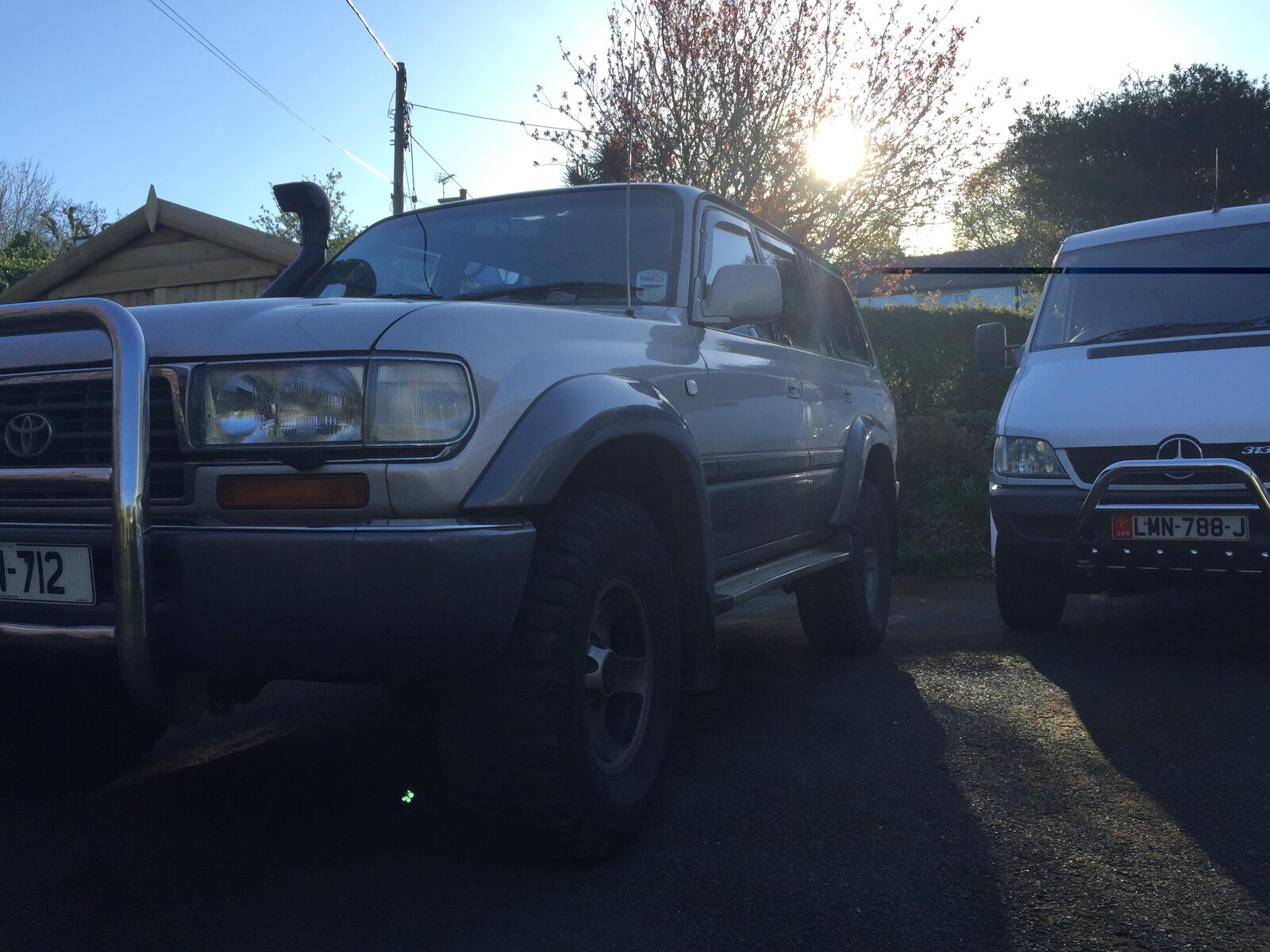

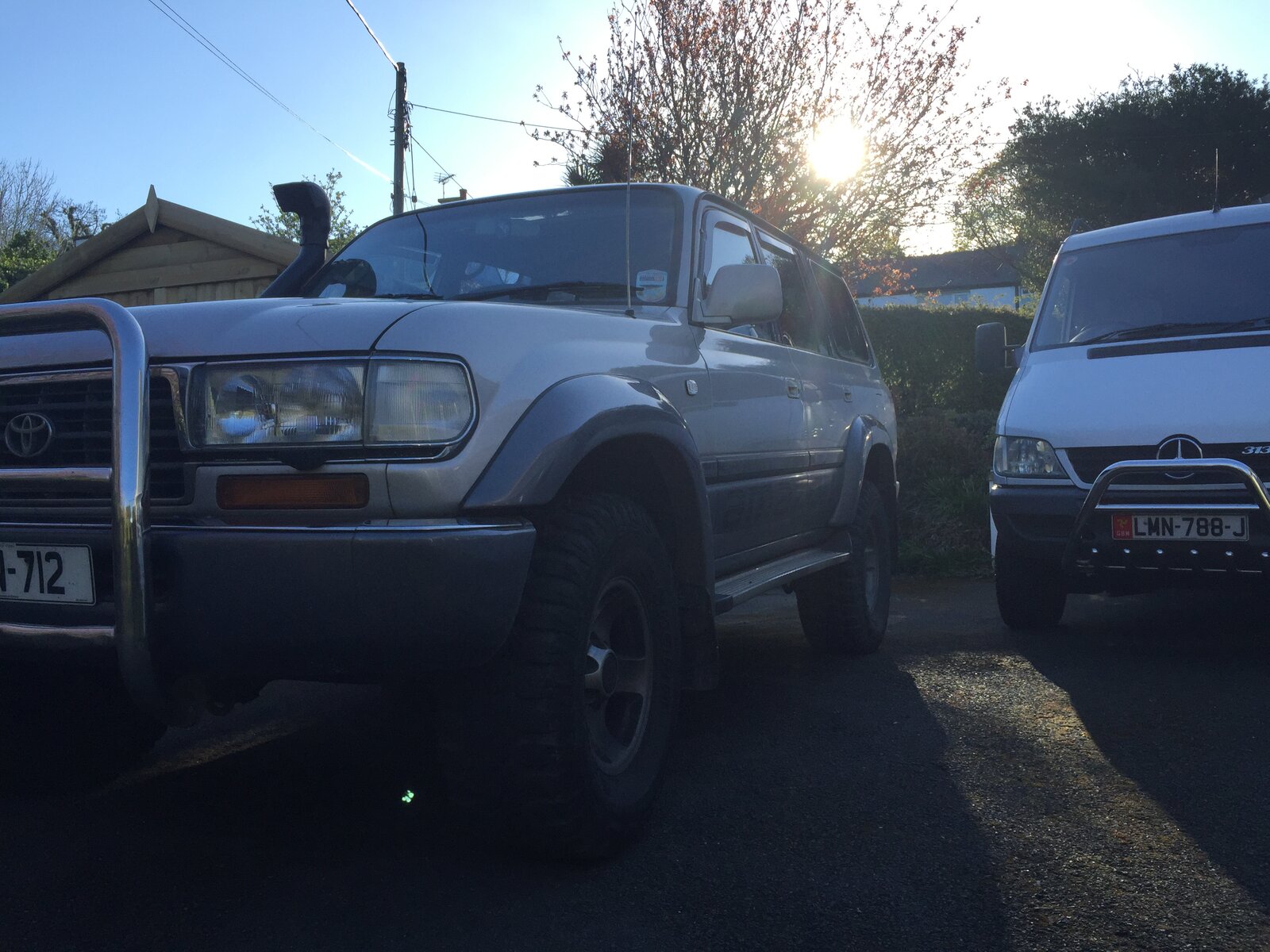

Running 305/70/16s on stock rims, +2" Pedder suspension kit - seems pretty well balanced to me...

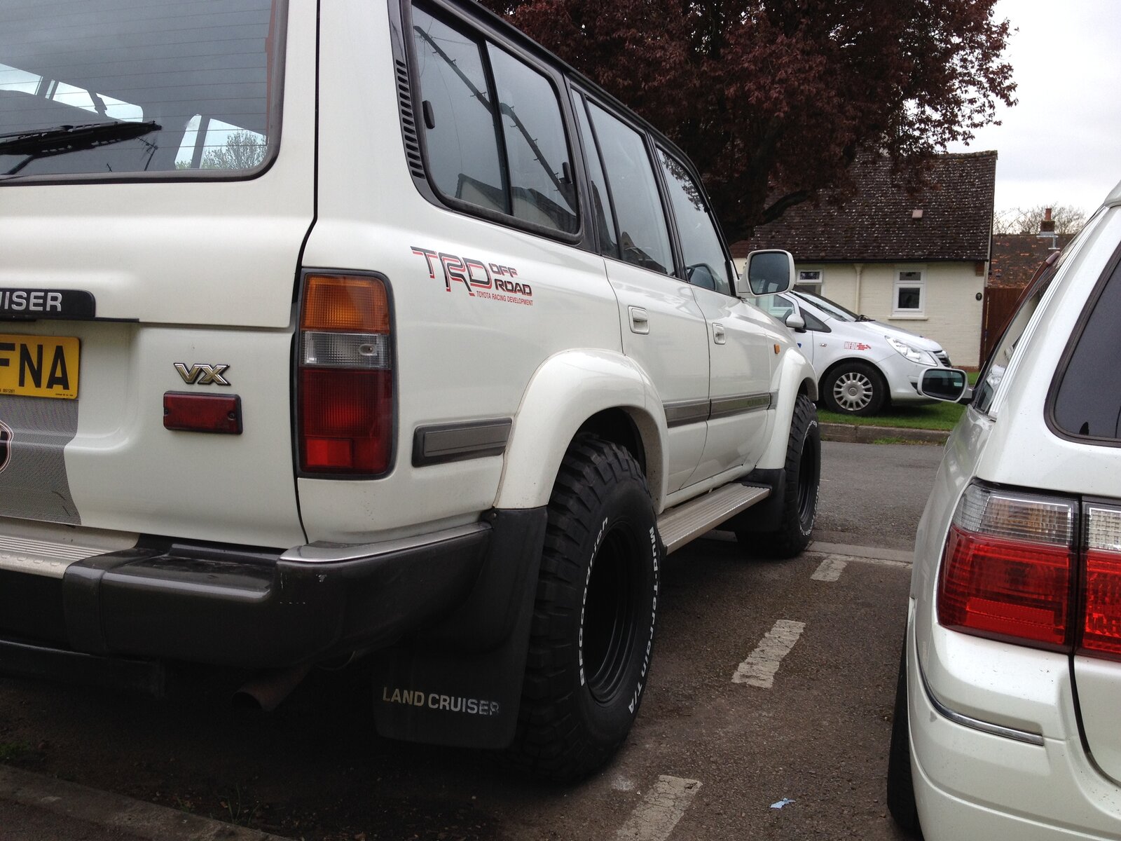

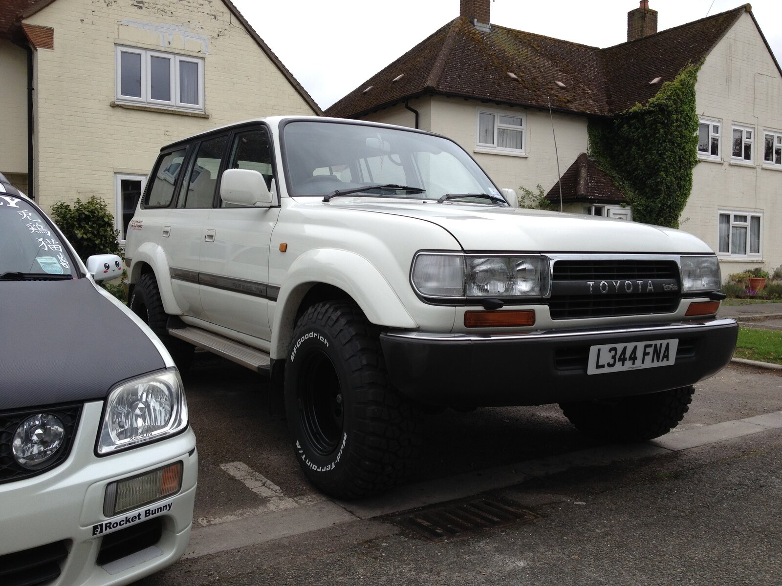

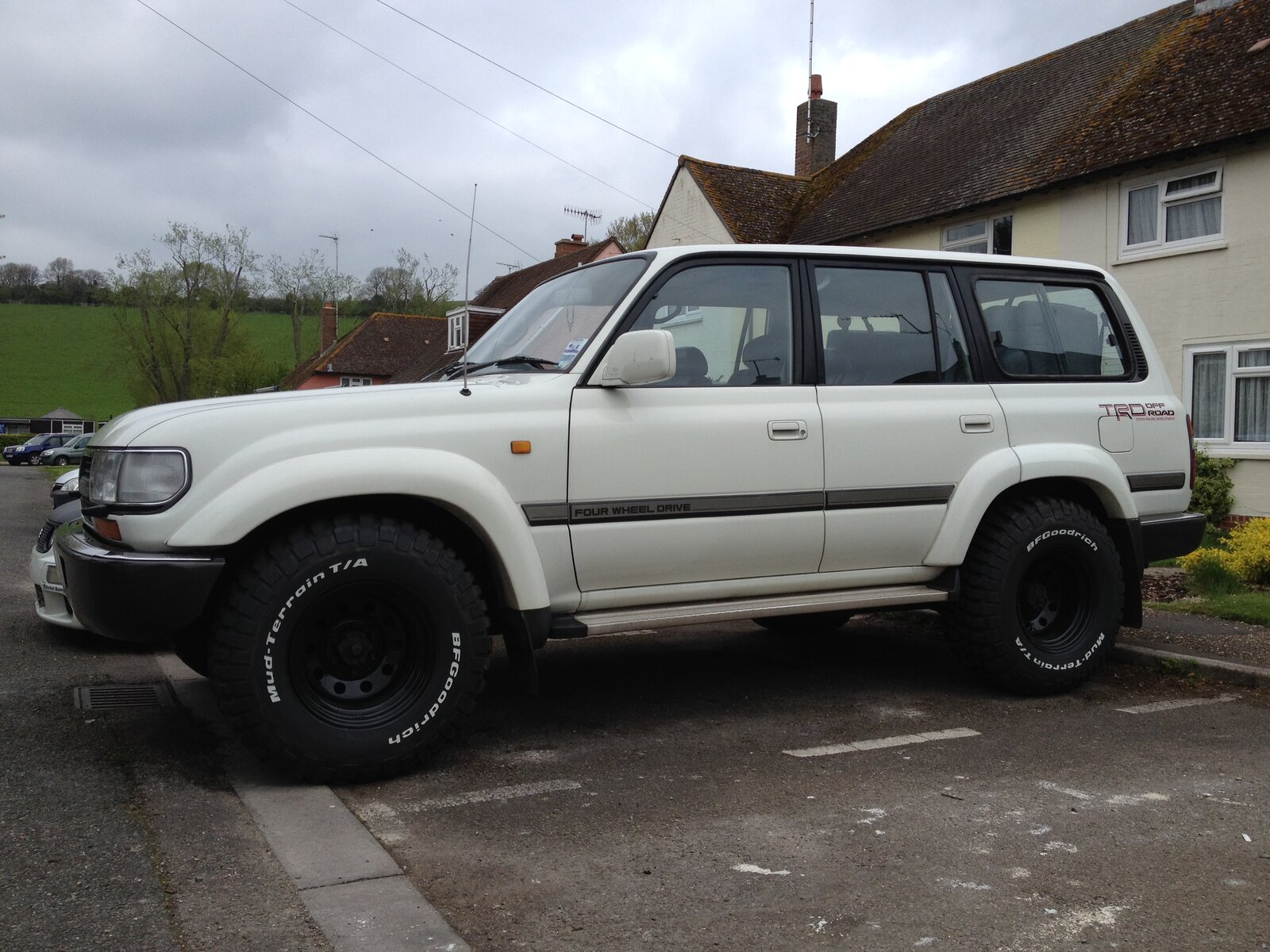

decided to get some new tyres and rims.
now running: 305/70/16 BFG muds on 10x16 steels et-32.
stock ride height, but uprated springs.
no rubbing at all, trimmed bumper a tad, but it wasn't really necessary.
Nice combo John, almost the same as me, only I have a 110mm suspension lift and run zero offset. I'm well pleased with the set-up.
I think you'll get some rubbing if yo do any extreme flexing though. If you don't do much serious offroad it won't bother you.
But it would be a shame to scar such nice new rubber :lol:
