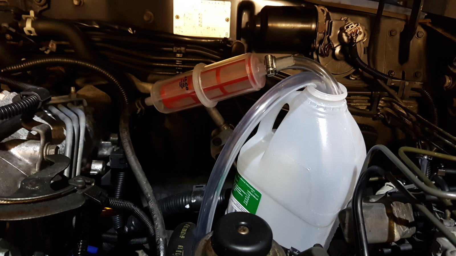

Update
Thanks to this stuff
We are now running on all 6 cylinders again, cant recommend it highly enough.
Thanks for all your help and advice along the way, appriecate it.
Few pictures of Liqui Moly setup
Even if you have no issues that stuff is a must every now and then
Its a cleaner, and when it cleaned mines its good i assure you.
Hit it up on youtube, defo worth it
Am converted lol anything i have will be getting that from now on.
Remember DONT put it in the tank

Main reason this poor girl was so bad was lack of use been off the road almost 3 years. It wont happen again tho.
Did you take the filter out of the pump. I wonder exactly what was blocked ?
No i didnt touch pump nor injectors, i thought to myself another good system clean before taking anything apart.
