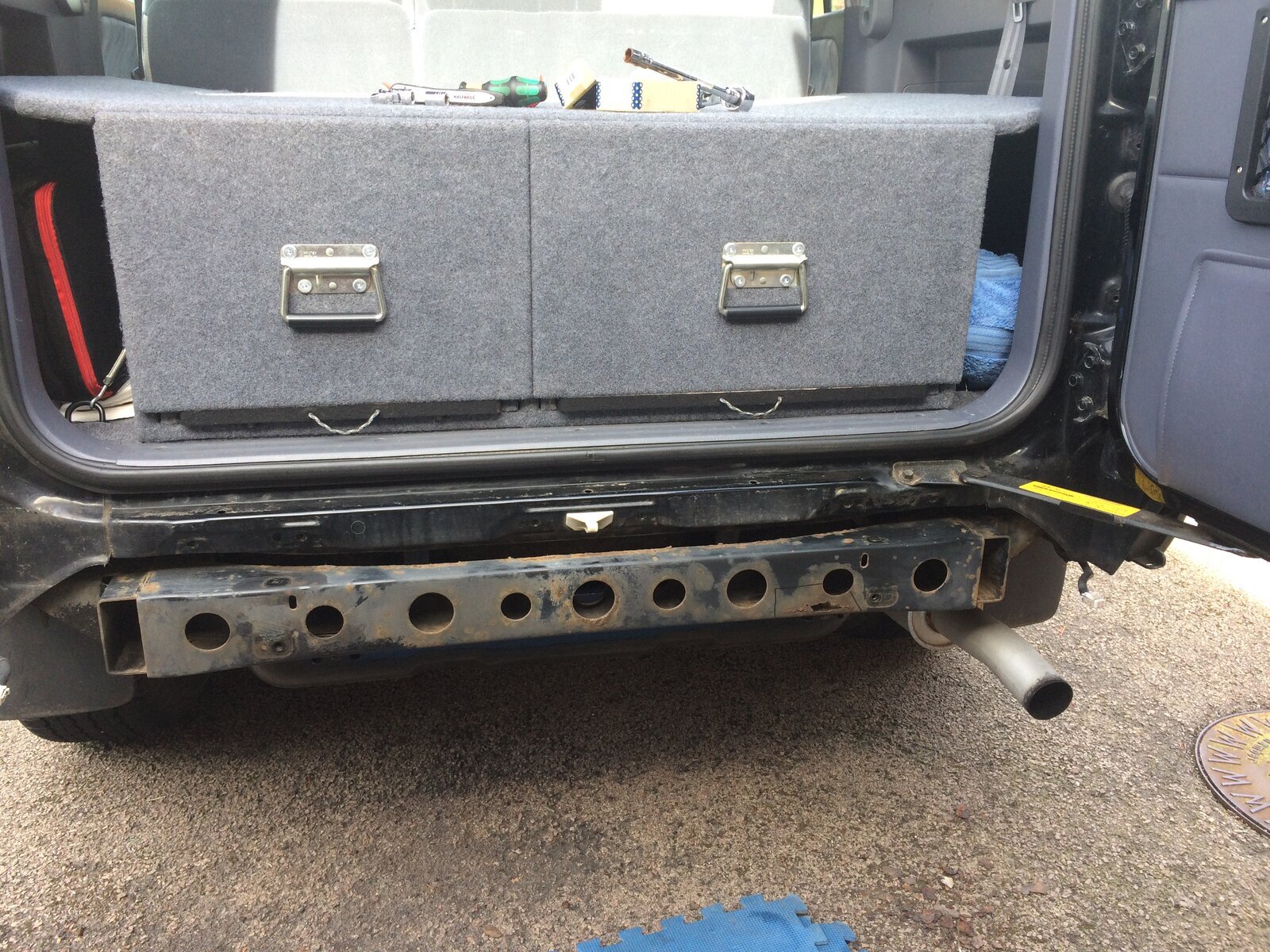

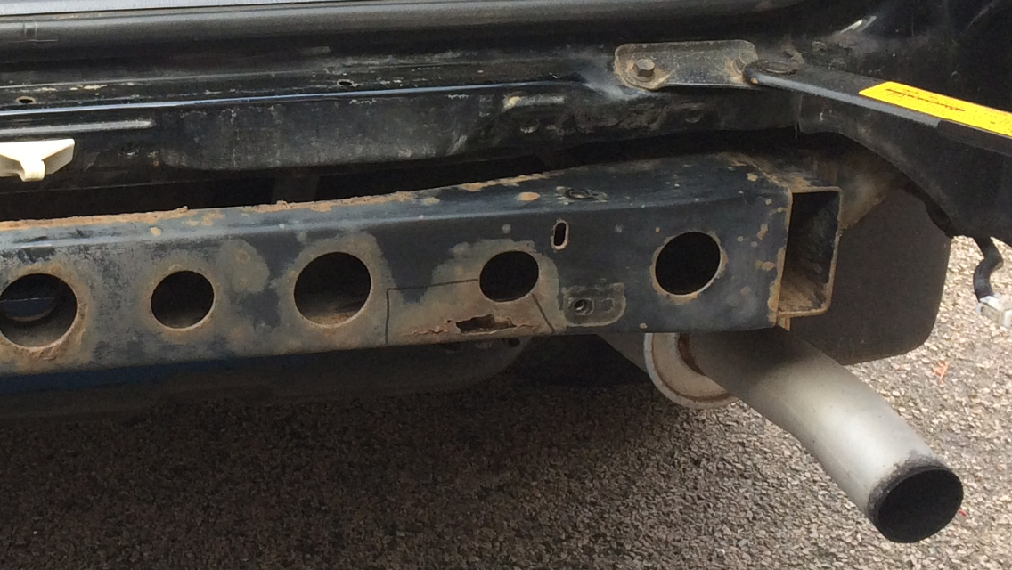

Hello - I have an area of rust on the rear crossmember where the bumper bracket mounts. It’s gone through at least 2 MOTs like this but I thought it could fail because it’s near the bumper mount. Otherwise the chassis is mint.
Anyway, I want to cut out the rot and weld in a 3mm thick repair patch. I’ve never welded on a vehicle before and am a bit nervous about causing an electrical problem afterwards.
I will ensure:
1. A good clean earth connection close to the welding area
2. Clean material
3. Batteries disconnected
Should I take any other precautions like disconnecting the alternator?
Any other advice?
Thanks

Doing all 3 on the list will be fine,.....No need to disconnect Alt.... I was welding on my old Colorado all day once and completely forgot to disconnect anything. With no Ill affect... Remember there are rubber body mounts all over the place, If your welding the Chassis for instance, That Help prevent High currents zooming about, But its always best to be safe, Newer vehicles with complicated fragile electronics might Disagree...... Oh! and if its a Petrol make sure you have a quick exit route cleared and get ready to run :thumbup: ......Crack On!
