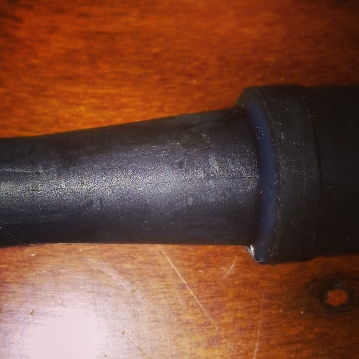

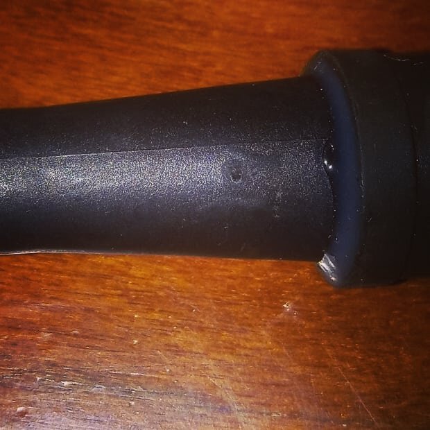

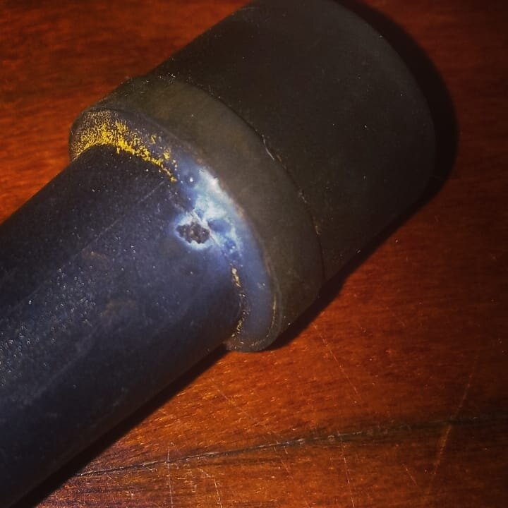

What I did see on bank 2 though was a spark jumping out of the boot onto the spark plug tube. Removed all three leads and all three boots have a burnt through hole on them which since I disturbed them seemed to have got much worse.

Don't know how old these NGK leads were but I do wonder if this has been happening for ages and maybe just not that noticeable if just one cylinder was down at low RPM?
Cylinder 2:
Cylinder 4:
Cylinder 6:
