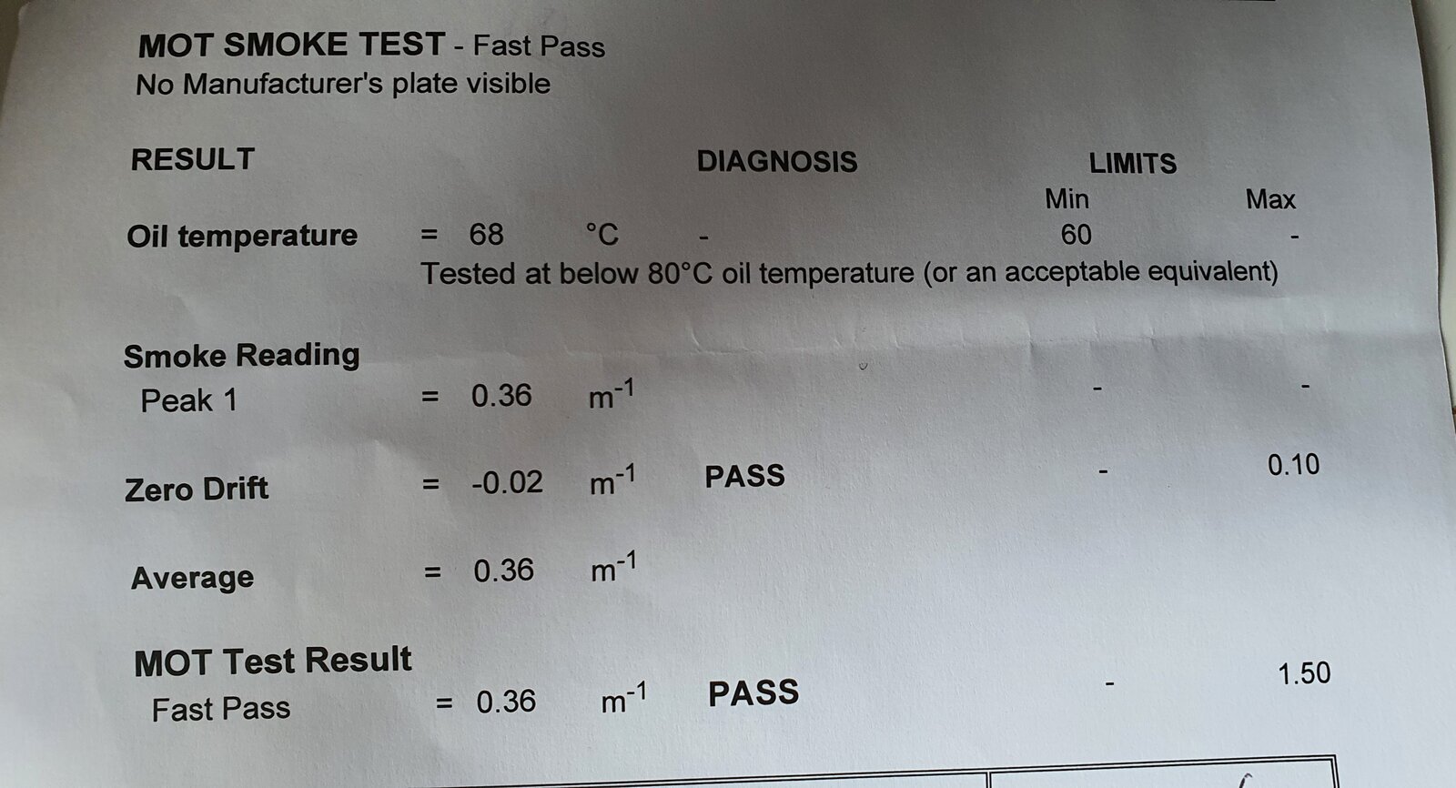

Here's mine - same car, same MOT, why does it all look different?
No idea Karl, hopefully someone who's MOT trained will spot this and give us the goods.
