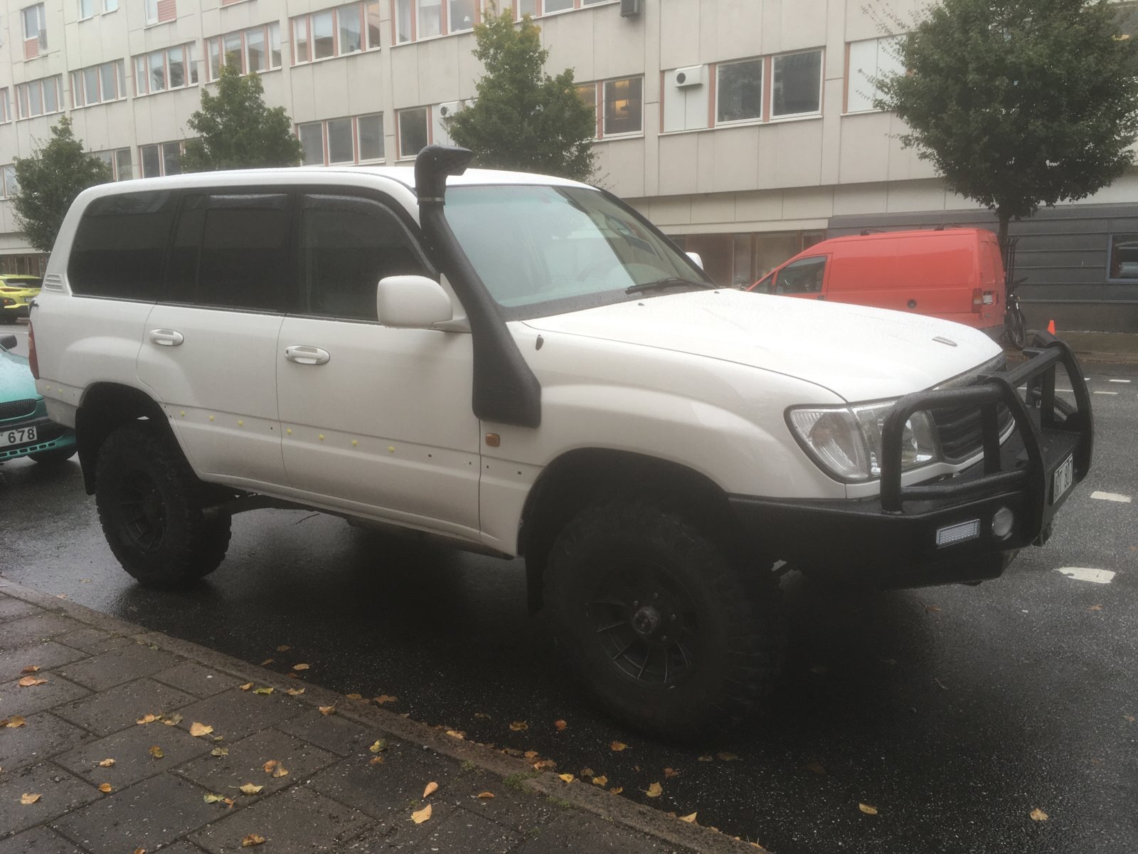

The car has been modified pretty extensively over the years with the following modifications done:
OME Suspension front and rear.
OME Steering damper
ARB Compressor with ARB air tank.
ARB Rear Locker
Hella Rallye high beams.
Vision X LED Lightbar
Vision X LED Work lights facing rear.
TJM T-13 Bullbar

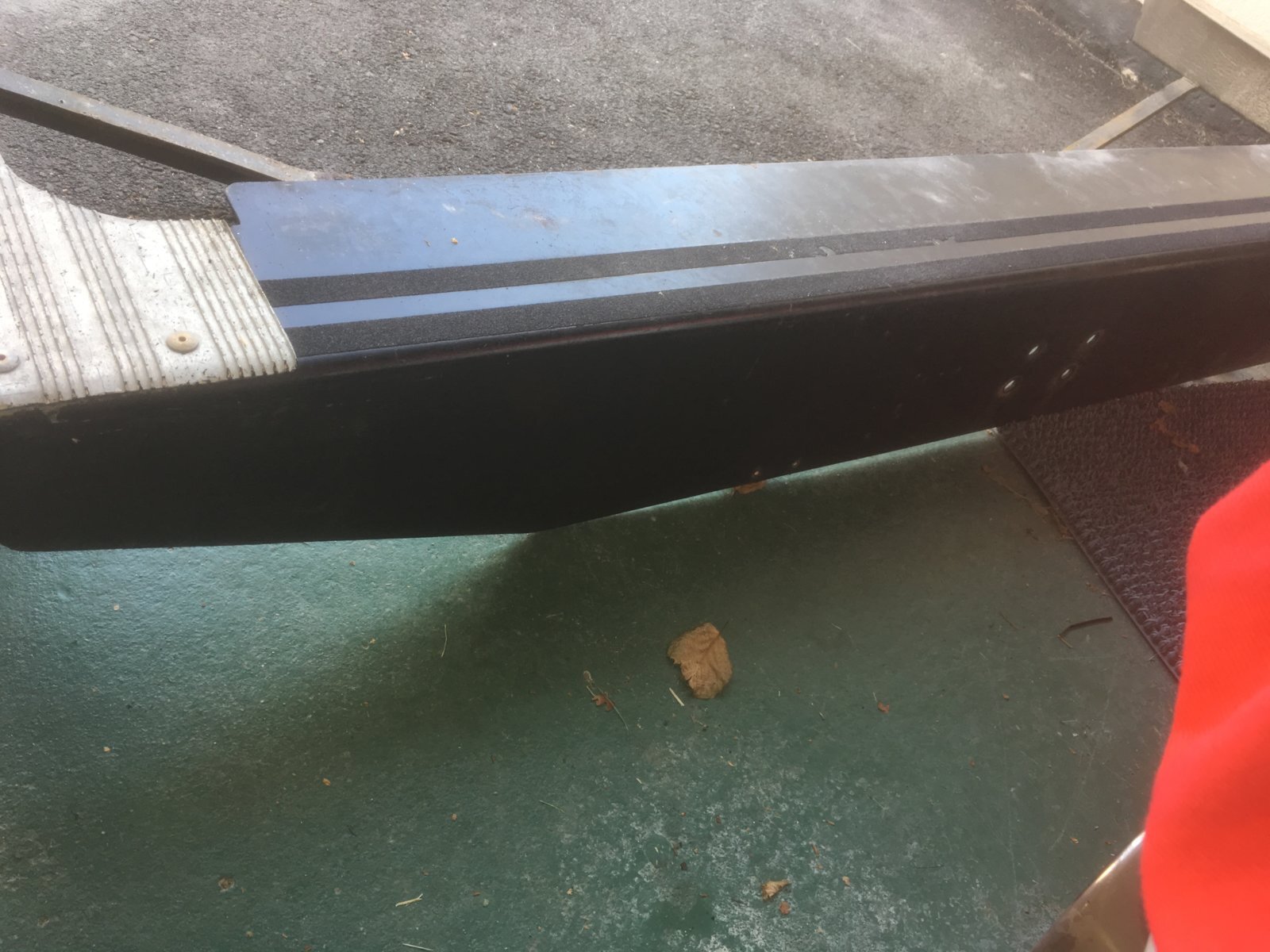

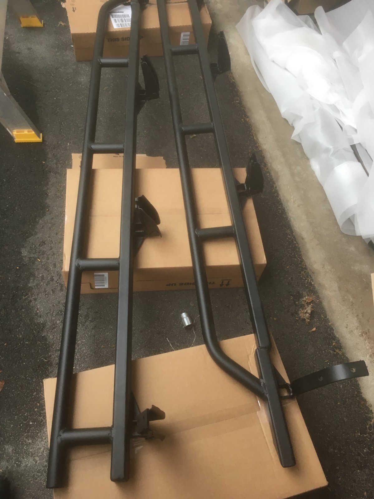

Home made side steps in steel (Just got these back form powder coating and looks like new)

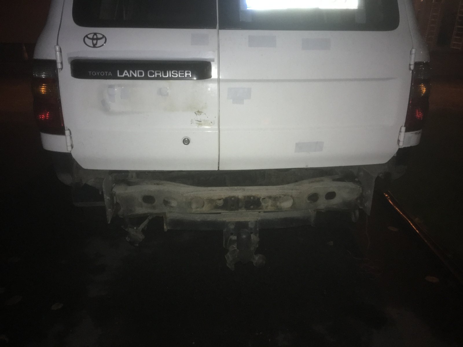

Home made rear bumper in steel (Just got these back form powder coating and looks like new)
Modified OEM roof rack (Also powder coated and about to get fitted.
The car had some minor expedition mods done like a folding table on the rear barn door
but I have removed this to get the car as "clean" as I possibly can. I have owned a Mazda FD3S
for a little over 10 years and I have developed an aversion for fiddly after market meters/buttons/stuff
and want everything as factory looking as possible.

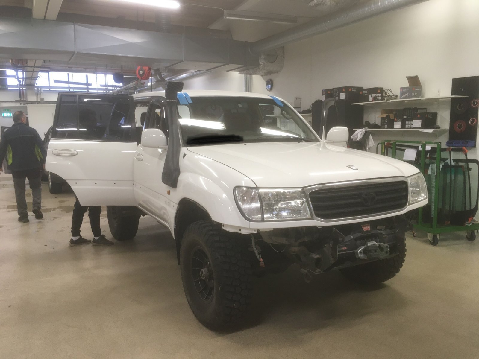

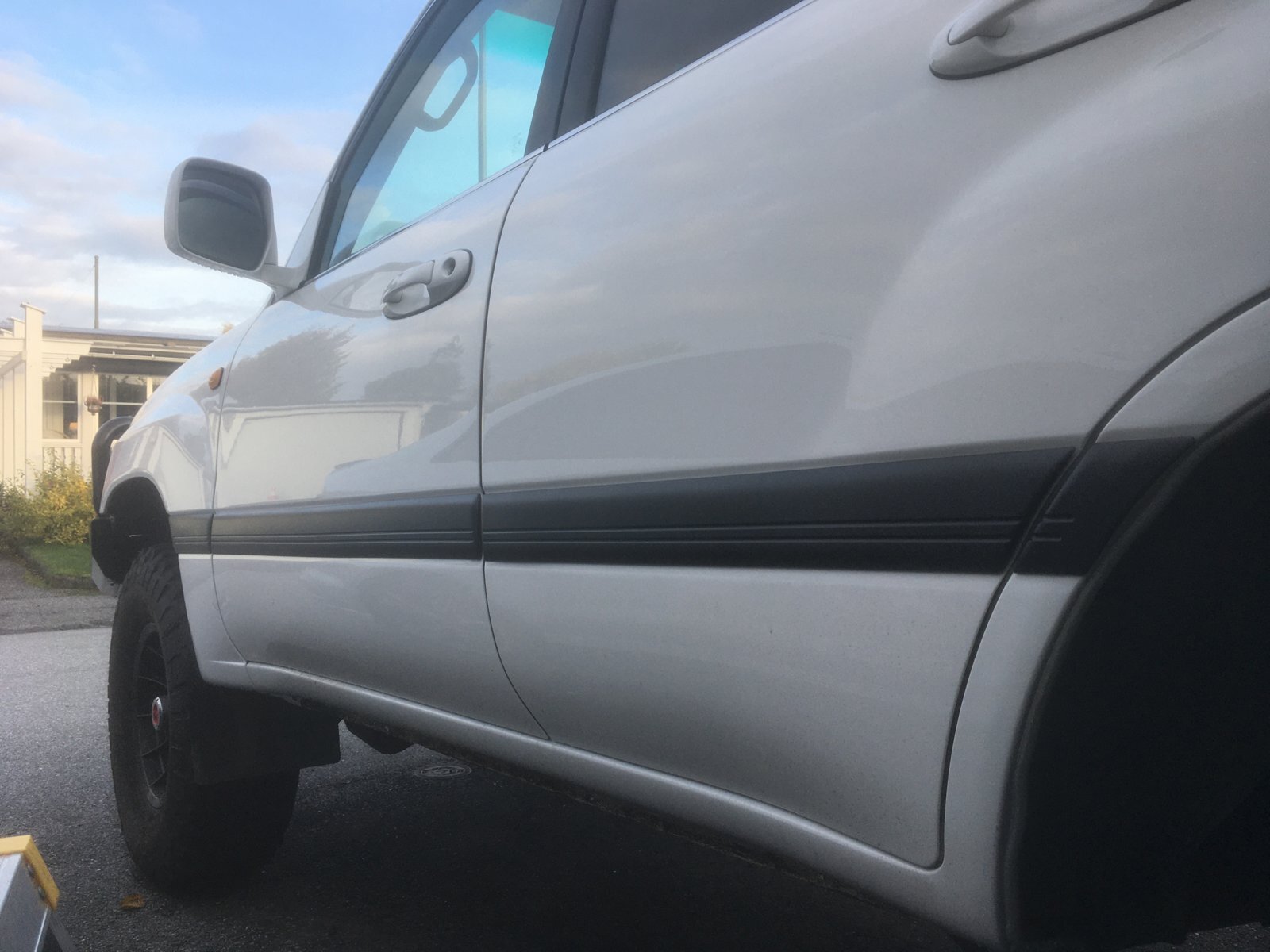

Here are some pictures of the repaint/powder coating before and after. Will sort better pictures as soon as I have a shot at a good spot and no rain.
The front fenders were very very rusty so I decided to get new ones instead of having someone trying to fix the old ones. Bodywork is insanely expensive in Sweden so unfortunately most things are better to purchase new. Although I am thinking of getting a welder and learn the easier bits myself.

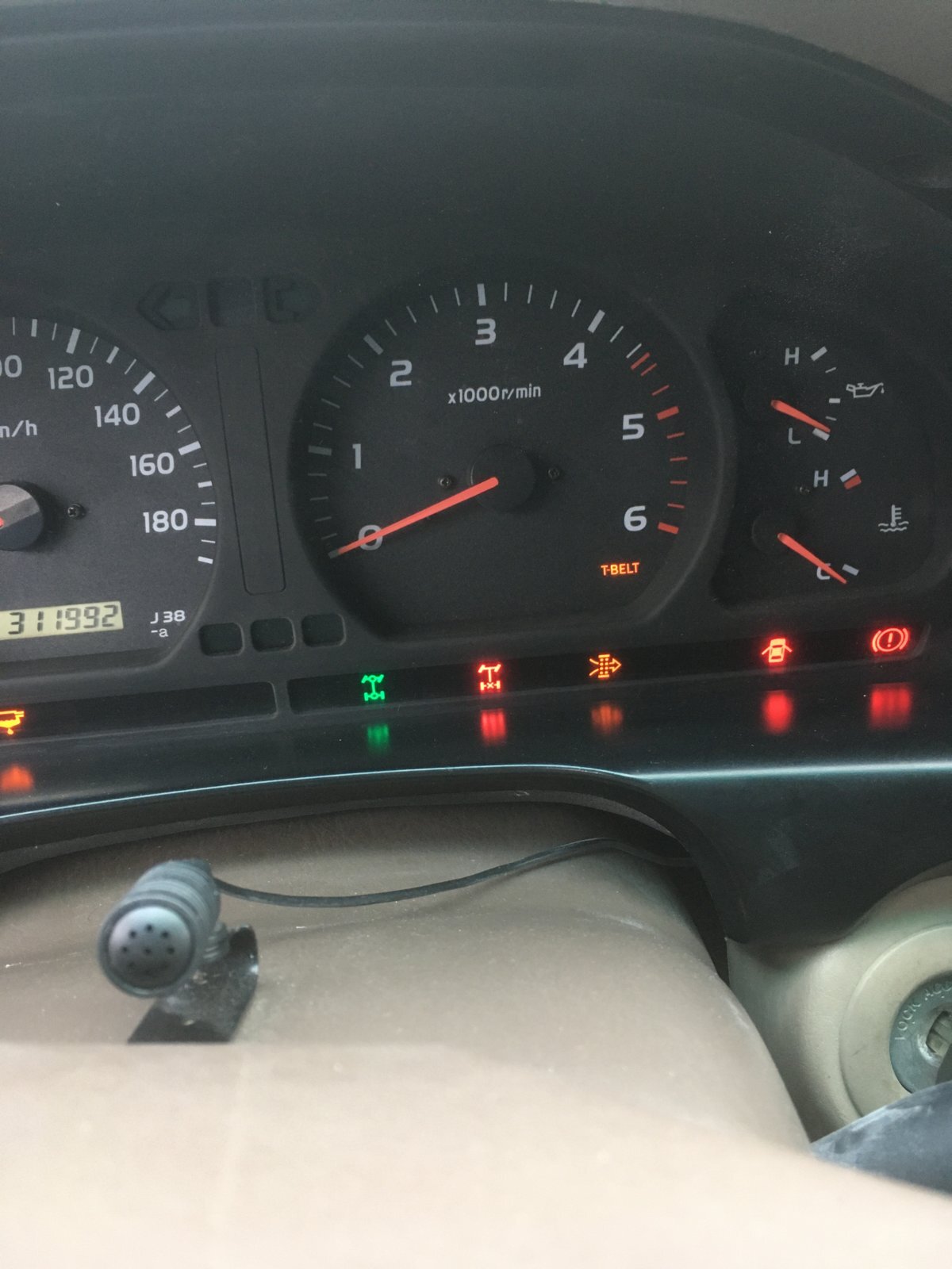

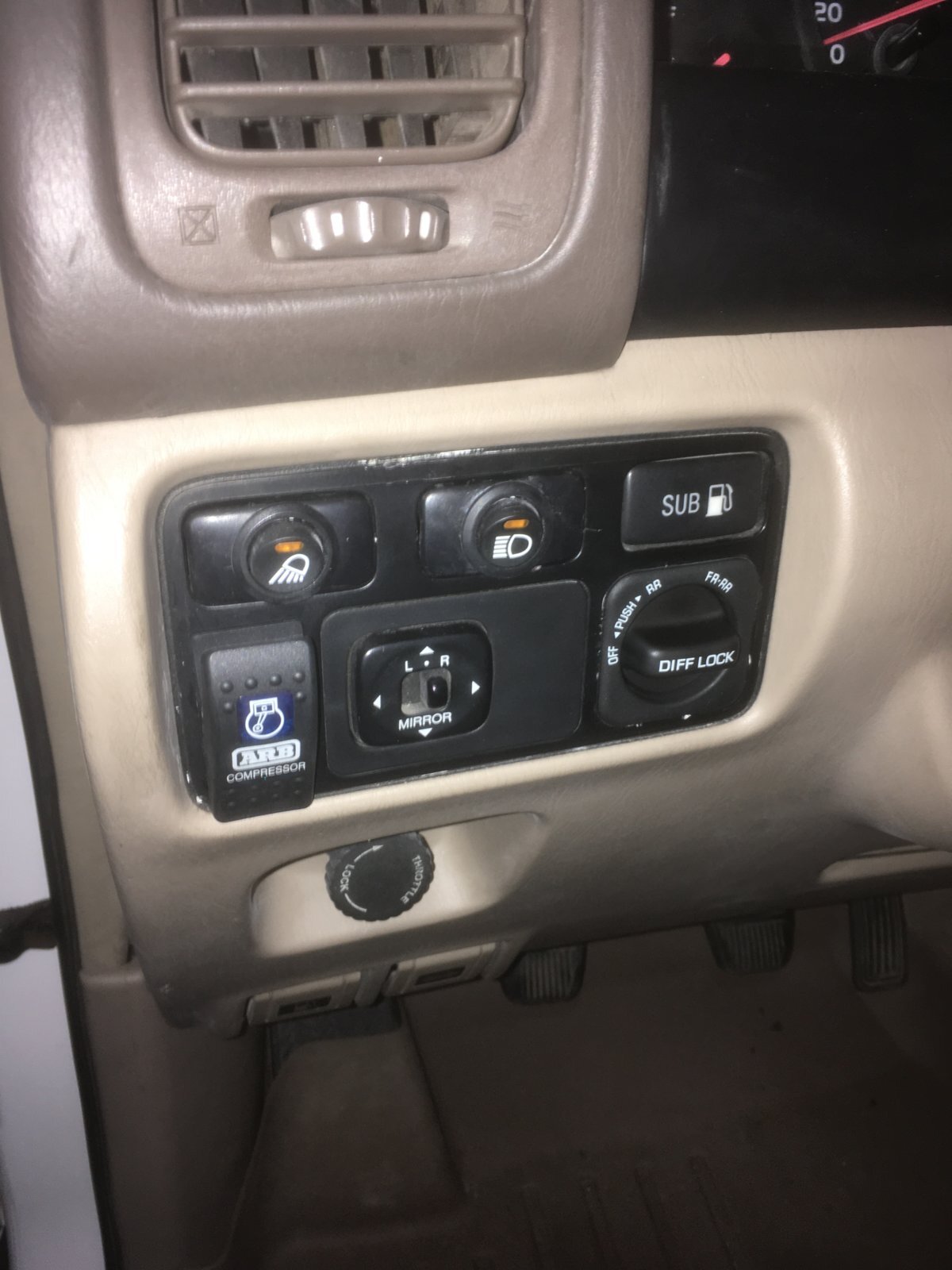

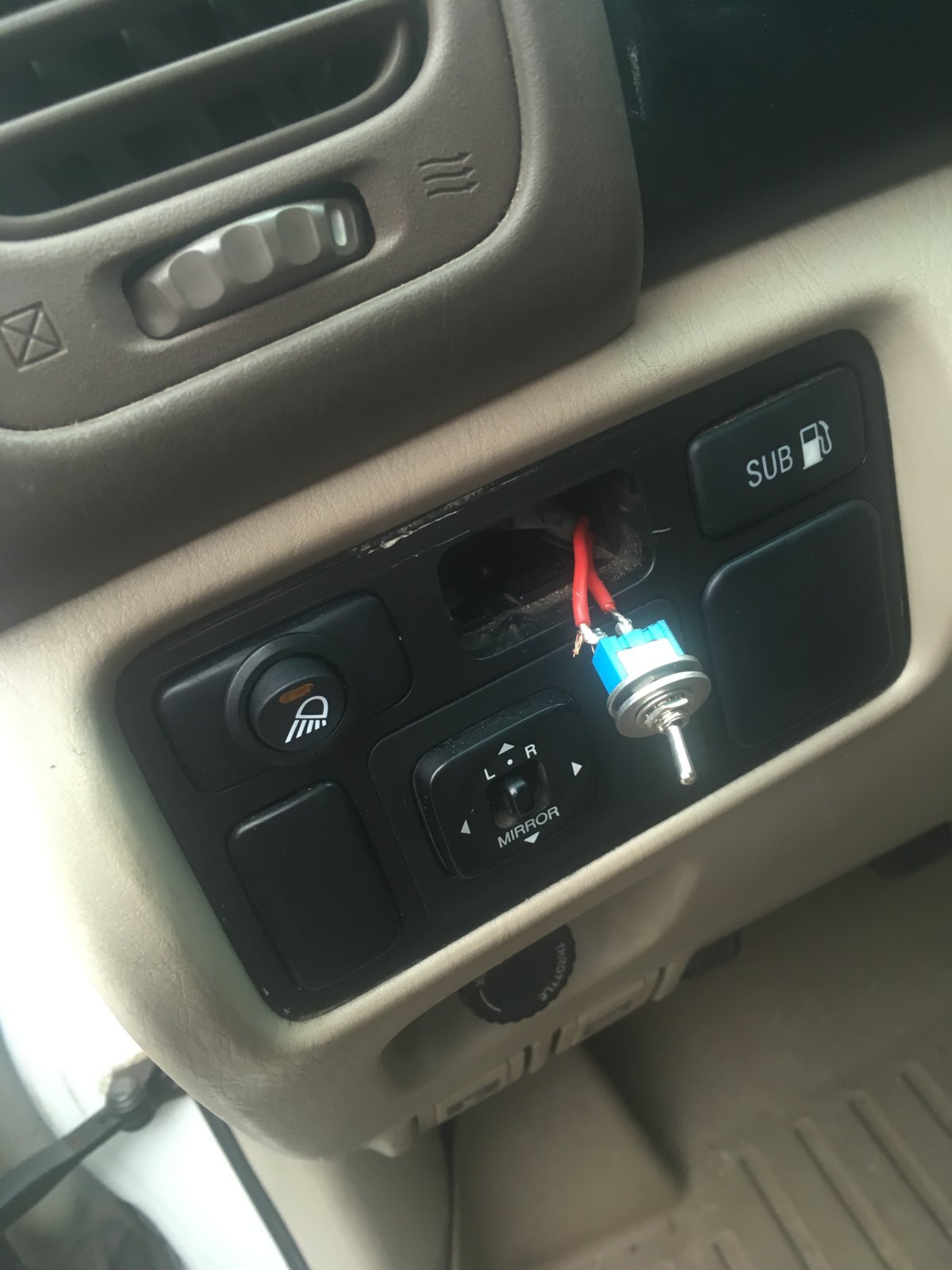

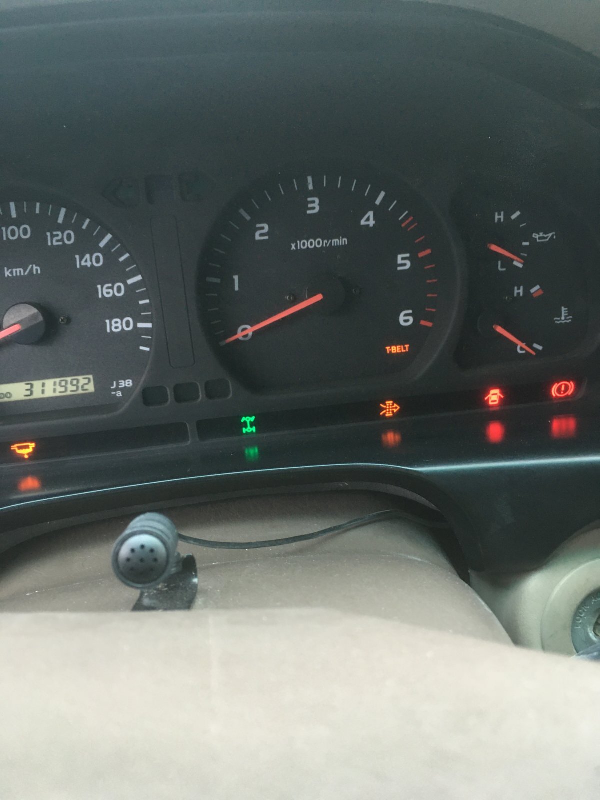

As mentioned earlier I don't fancy too many buttons and meters so I decided to redo some of the old ones for a cleaner look. Can't say I did a fantastic job on some of them but it's easy to redo and get a proper fit.
What I am most happy with is removing the Compressor and Locker button from the center console and putting them where the original locker switch is. This means I can air up the tires without having to climb into the car, and I have the instrument cluster lighting up when I engage the rear locker.
Seems I have done something wrong here as the locker itself isn't engaging but the solenoid engages and the compressor works. Will do more troubleshooting as soon as I get home from this weeks business trip.
Some before and after pics here, realised I don't have any on the factory locker setup but I guess everyone knows what that looks like already.

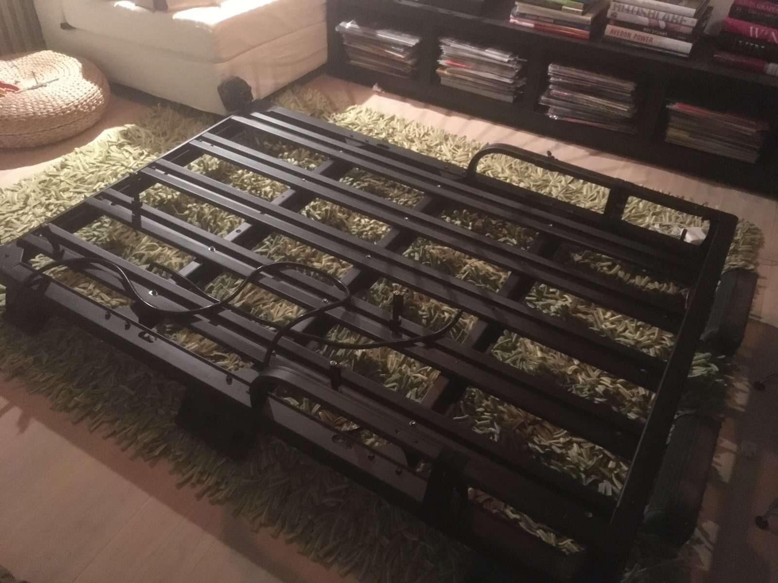

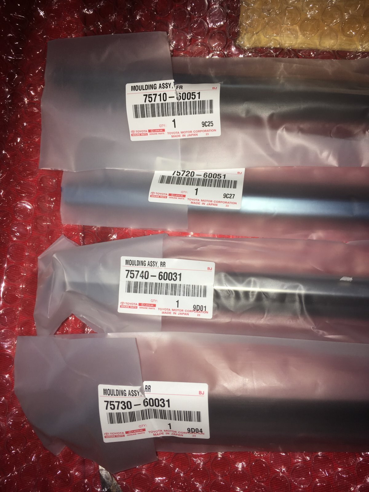

What's planned in the near future is sorting the rear locker, sorting the distorted parts from the powder coated roof rack in order and installing it. (Waiting for a few seals from Toyota to go between the mounts and roof of the car)

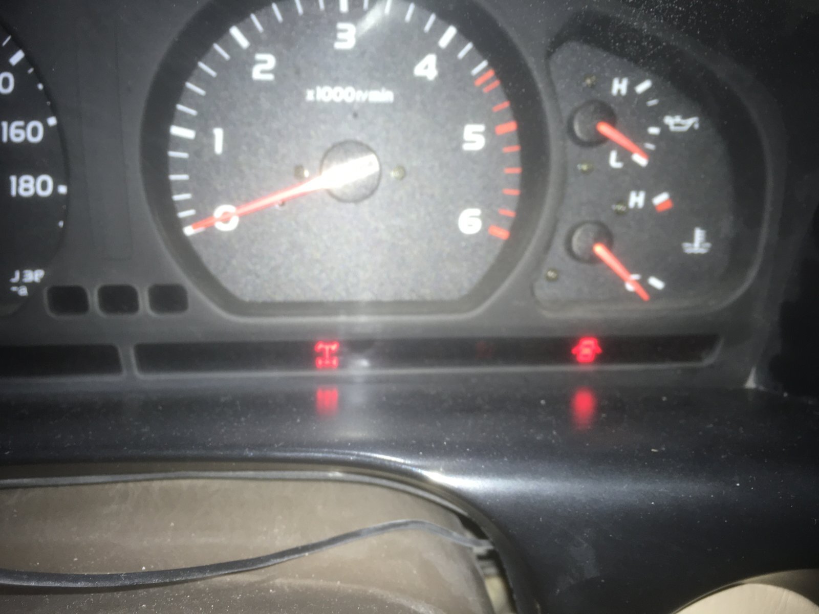

Did however get the rear locker indicator to work as planned on the dash. As well as fitted the new Rear/Front locker button as I accidentally ruined the old one when trying to remove it.

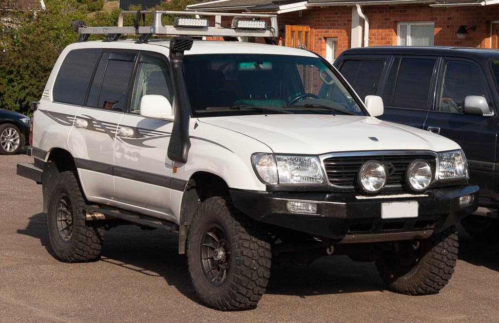

Complete list of mods is as follows:
2002 LC 105 (300.000km's)
1HD-T LC 80 engine swap with roughly 90.000km's done.
Repainted in original white
TJM T-13 bull bar
Custom made side steps powder coated in matte black
Custom made rear bumper with high jack mounts and 3part swivelling tow hook (pc matte black)
Custom made Toyota Roof rack, powder coated in matte black
AVM Heavy duty free wheeling hubs
OME Dampers front and rear
OME Steering damper
Custom exhaust with muffler in front of RR wheel
Safariland snorkel with KN filter
Twin batteries mounted under the bonnet
ARB compressor
ARB spare air tank
Outback TX-1 rims in gunmetal
Warn Zeon 10S winch

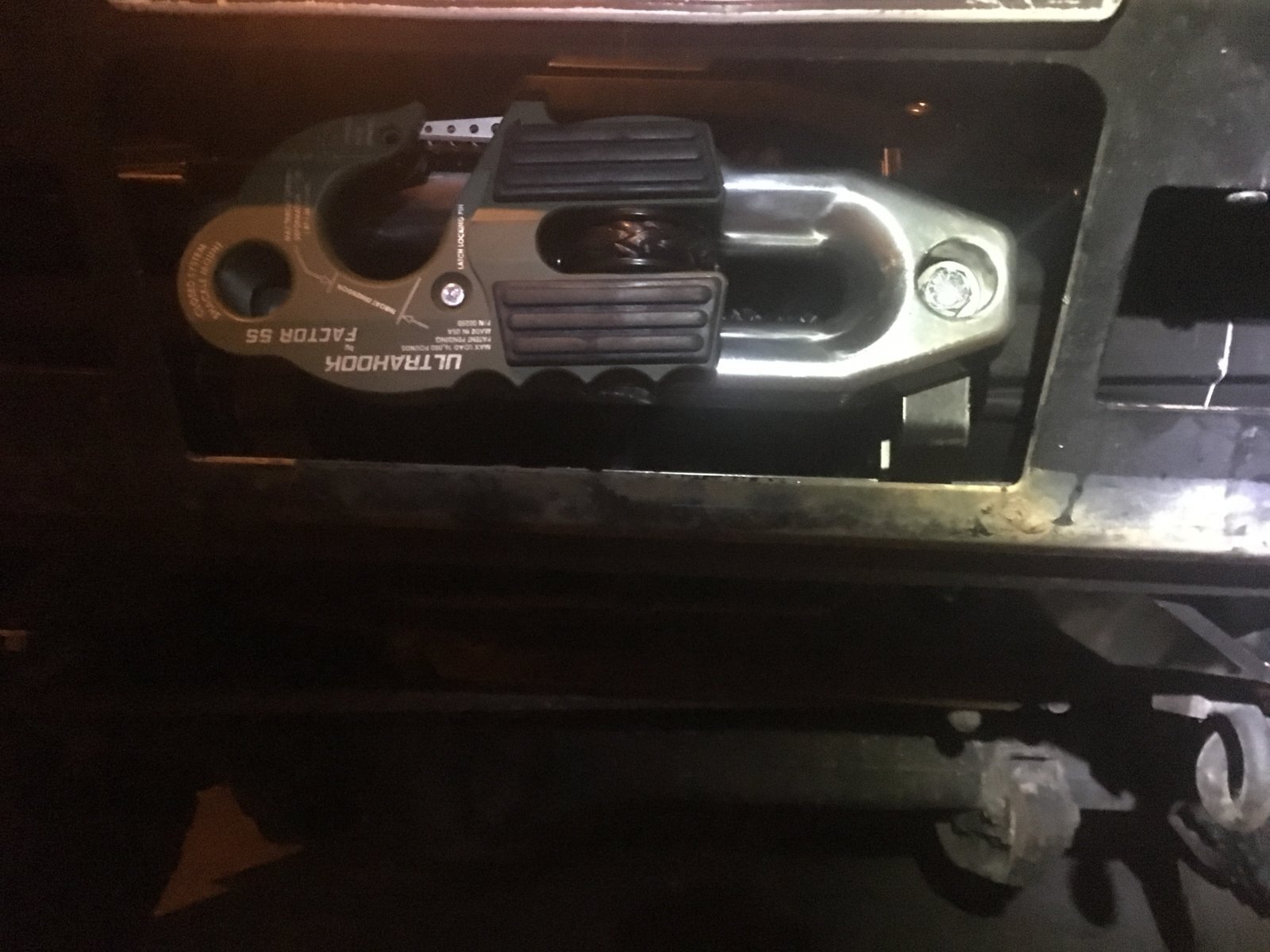

Factor 55 Ultrahook
Hella Rallye lights mounted on the bumper
Vision-X LED light bars x2 on the roof rack
Vision-X LED work lights facing rearward
KC under bonnet mounted work light with switch that shuts off when hood is closed
Foldable antenna for VHF radio (Roof mounted)
Maxtrax (OD Green mounted on roof)
Outback roof console
Icom IC-5022
Pressure gauge for air tank
ARB compressor switch
OEM Front/Rear locker Switch with bulb mounted to OEM symbol in cluster
Noname work and led bar switches
Ebay steering wheel cover in faux leather (Insanely easy to install so will try to get a better quality one)
Kenwood head unit with Camera/Aux in
Reverse camera mounted in spare wheel holder on barn door
Complete trauma kit fitted on rear barn door with quick release
To be fitted:
Redarc Manager 30
Cotec 1000W Pure sine inverter
Twin USB ports in center console
BRC diff/gearbox breathers
Fire extinguisher
To be ordered
Heavy duty tow points front and rear
Hella passengers map light
Steel rims for summer tires
Sure I forgot a ton of things but that'll get sorted as we go.

Roof rack almost ready to mount. Waiting for some seals that are supposed to arrive later this week or next.
Getting really excited to get it "complete" again.
