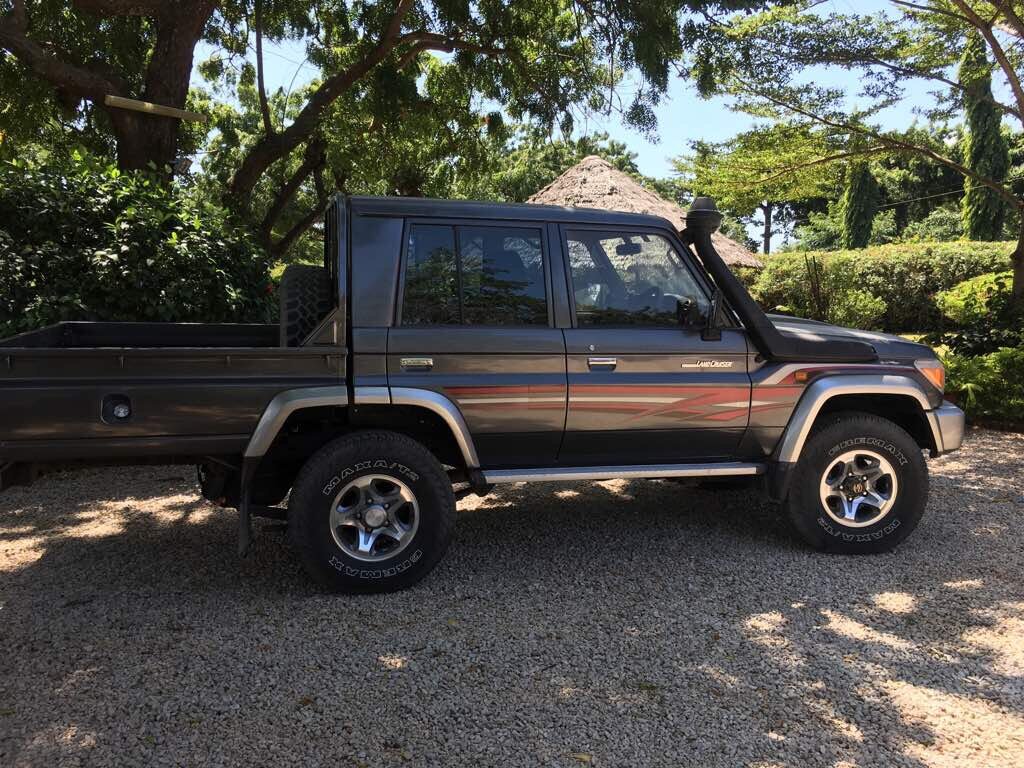

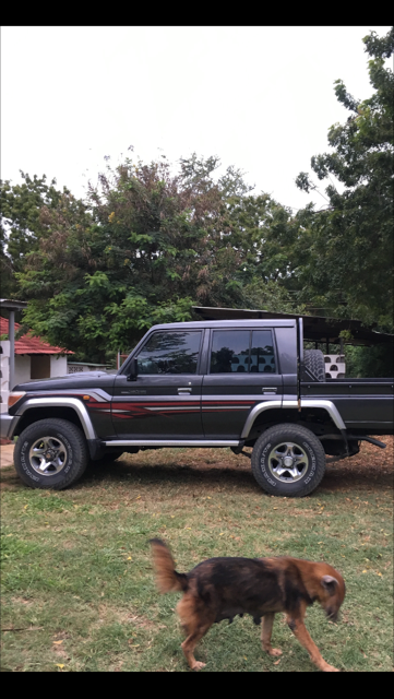

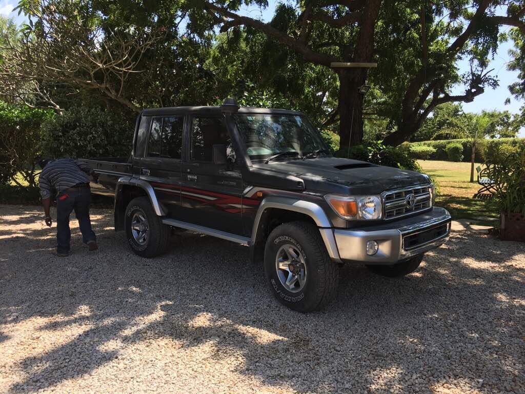

Time for an update;
1/08/2017
This morning my dad offloaded the vehicle, i'm excited is an under statement!:grin: It was sitting in its container at the port for the last few days whilst paperwork was being sorted but its finally home now.
My first impressions are very good and everything seems as described, the only thing i have noticed is how big the rear wheel flare's are. They start at the rear tub and come all the way up to the rear passenger doors, i;ve never seen this before and maybe some of you have an explanation? from what i have seen on other cars and on Google the flares normally end just before the passenger doors.
Also the tyres are 285/75/R16's which look a little big so i will probably get a size smaller once these are worn. Maybe 275/75 or 265/75 but In the mean time i'll be looking for an ARB or TJM bullbar for the front.
Since my last post and with a slight delay with the ship leaving Dubai, i've waited 4 weeks. Unfortunately as i am still out of the country these are the only pics i have until i get home end of August.
is that market specific? all the 79 DC's iv seen on pictures have a longer wheelbase, yours looks almost like a troopy converted to a pick up.
Also i notice the rear doors seem slightly larger/ longer. It almost seems too good to be a troopy conversion, or it could be that the flares were added on later.
I'm pretty sure it's a cut down wagon - if you look you don't have the blank in the rear arch cutout as there are in Ben's pictures, or in the white one next to it at the docks, which is why the arch flares run all the way round to the doors.
It can't be a chopped 76 series because if you look closely at a 76 series side on, theres no room between the two windows on the back to actually chop and add a tray. Also the angle of the rear doors are different. If it is a chopped job the finished job is very very good.
My dad confirmed it looks like a normal pickup, i.e no evidence of work carried out.
Rather weird non the less!
Check the chassis number - that'll tell you if it's a VDJ79 or VDJ76.
I've had a look and have found another one that looks similar on ebay, but all the others have the arch cavity filled as per the Toyota factory one, which is what makes me thing that it's a conversion from a VDJ76
Here's a side on picture of a VDJ76 and you can see the leading edge of the arch is inline with the quarter glass in the rear doors:
As Ed says, definitely a cut down 76. :ugeek:

06/09/2017
A month on i am finally back in Tanzania and driving said vehicle for the last few days. Loving the power!!
A couple of things to report on; i did some background digging and i can confirm the vehicle was originally a 76 series which has had a chassis extension and double cab tub added. The job itself looks to be perfectly done. More digging around and i found that its had a new engine fitted hence the low miles.
Initially i was obviously ticked off with the supplier as i wanted a double cab, he apparently had ''no idea'' about the conversion when i questioned / demanded answers.
I/m not sure how i feel about the whole thing but the car is slowly growing on me. In the next few weeks i will be chopping the chassis extension back to its original length and shorten the tub too. I think it will look better as right now the tub looks slightly odd. The other two options were to move the rear axle back or to convert the car back into a 76, both costly options and time consuming.
Looks worse in the pictures than it actually is. A local company who works in the Safari business who do vehicle extensions and modifications will be carrying out the work.
The stickers on the side will be coming off and the wheel arches will be colour coded to match the rest of the grey. I will also add a front bar with spotlights. Current wheels are OEM and tyres are 285/75/R16, vehicle sits high and proud lol. I must admit people almost look at me like what is this monster on the road.
I have already replaced the rear shocks with heavy duty Old Man Emu ones. Changed the oil and filter. Couple of things to come tomorrow.
There are some minor issues here and there which i am currently working on so pics will follow. My priority right now is to make sure the engine is running sweet, no boost leak etc.
Pic attached of intended look after the chop...
