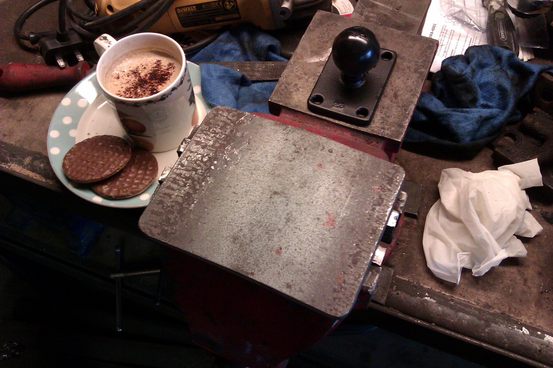

So I found a bit of 6mm plate in my scrap bin the right sort of size and put a slight bend in it because the dash curves slightly
[attachment=5:1dxp4i4c]IMAG0861.jpg[/attachment:1dxp4i4c]

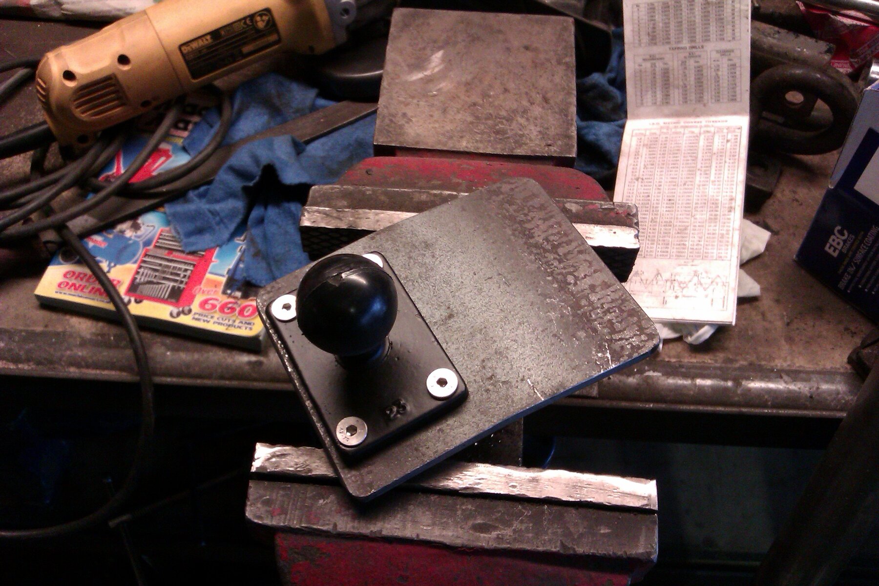

Drilled and tapped some holes to mount a ball
[attachment=4:1dxp4i4c]IMAG0862.jpg[/attachment:1dxp4i4c]

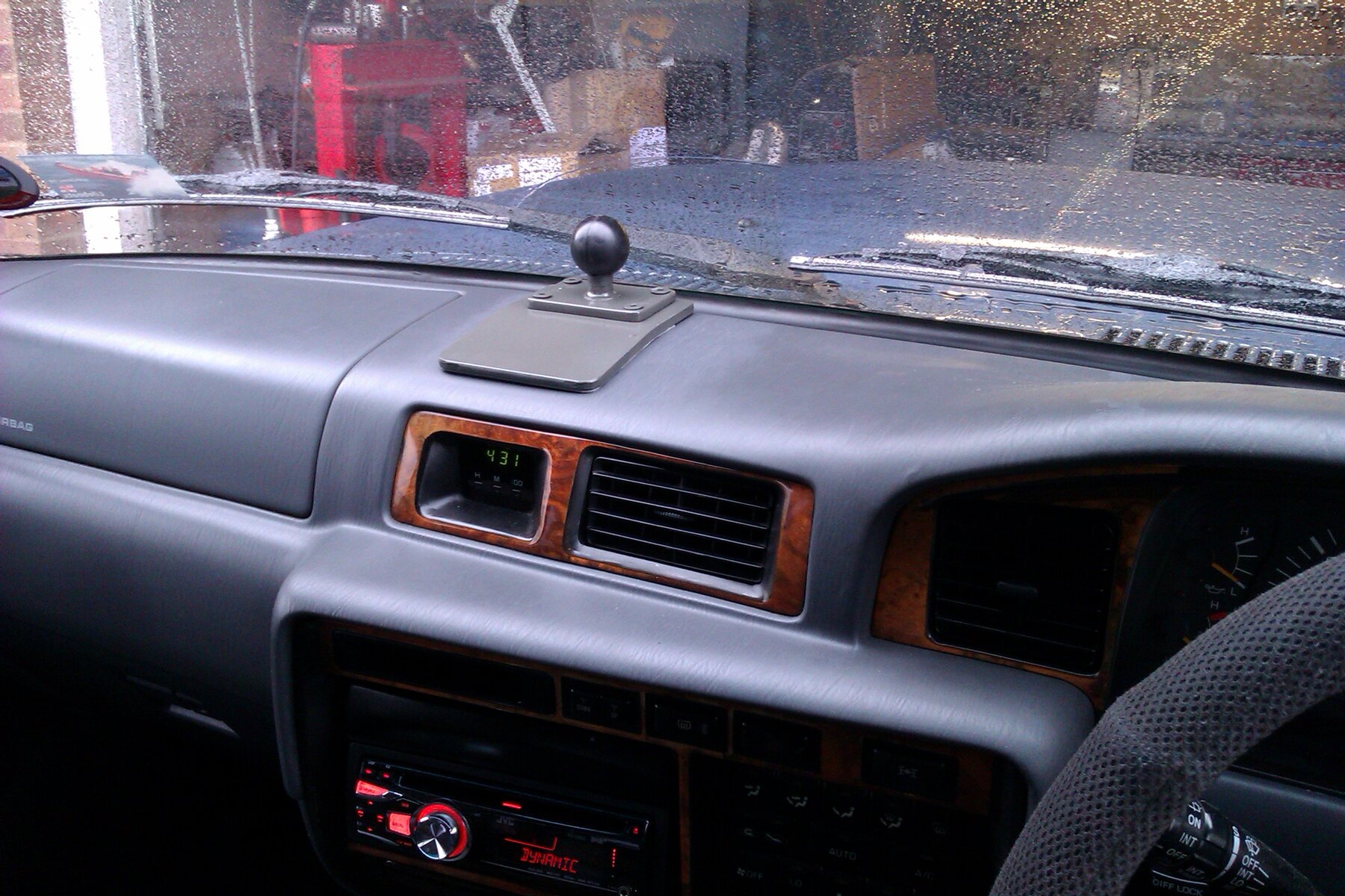

Painted it grey and stuck it to the dash with double sided sticky foam. Not exactly an OEM look :lol:
[attachment=3:1dxp4i4c]IMAG0874.jpg[/attachment:1dxp4i4c]

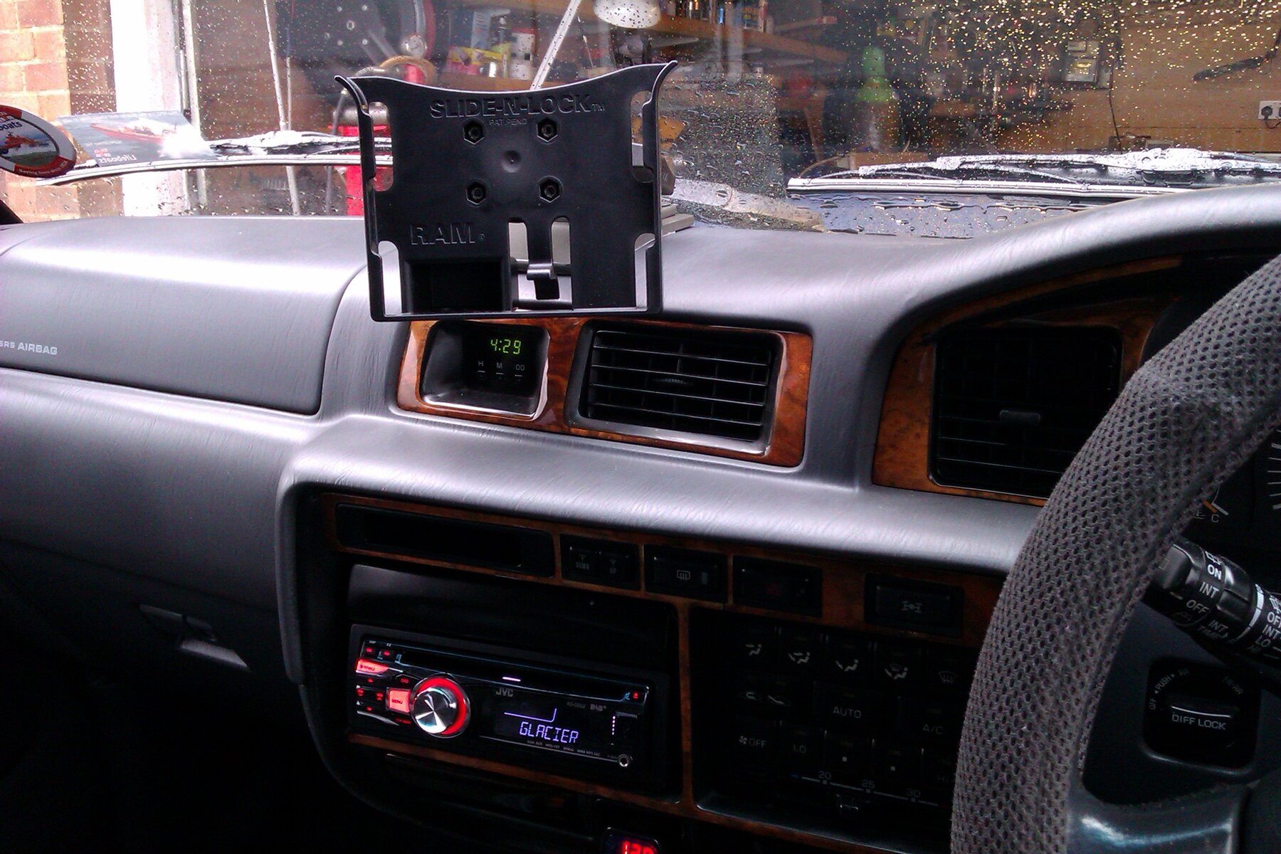

Added a short arm, another ball and a slide-n-lock for the monitor
[attachment=2:1dxp4i4c]IMAG0869.jpg[/attachment:1dxp4i4c]

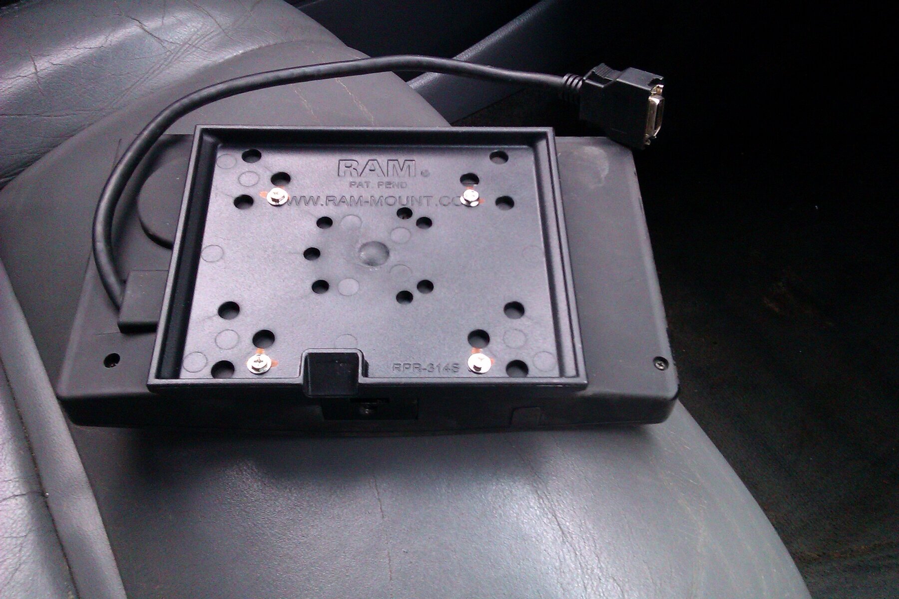

The other half of the slide-n-lock goes on the monitor
[attachment=1:1dxp4i4c]IMAG0871.jpg[/attachment:1dxp4i4c]
Then slide the monitor into place :thumbup:
[attachment=0:1dxp4i4c]IMAG0873.jpg[/attachment:1dxp4i4c]
All nice and solid and if there's any sign of wobble I'll adjust it till the monitor is resting on the dash :)
