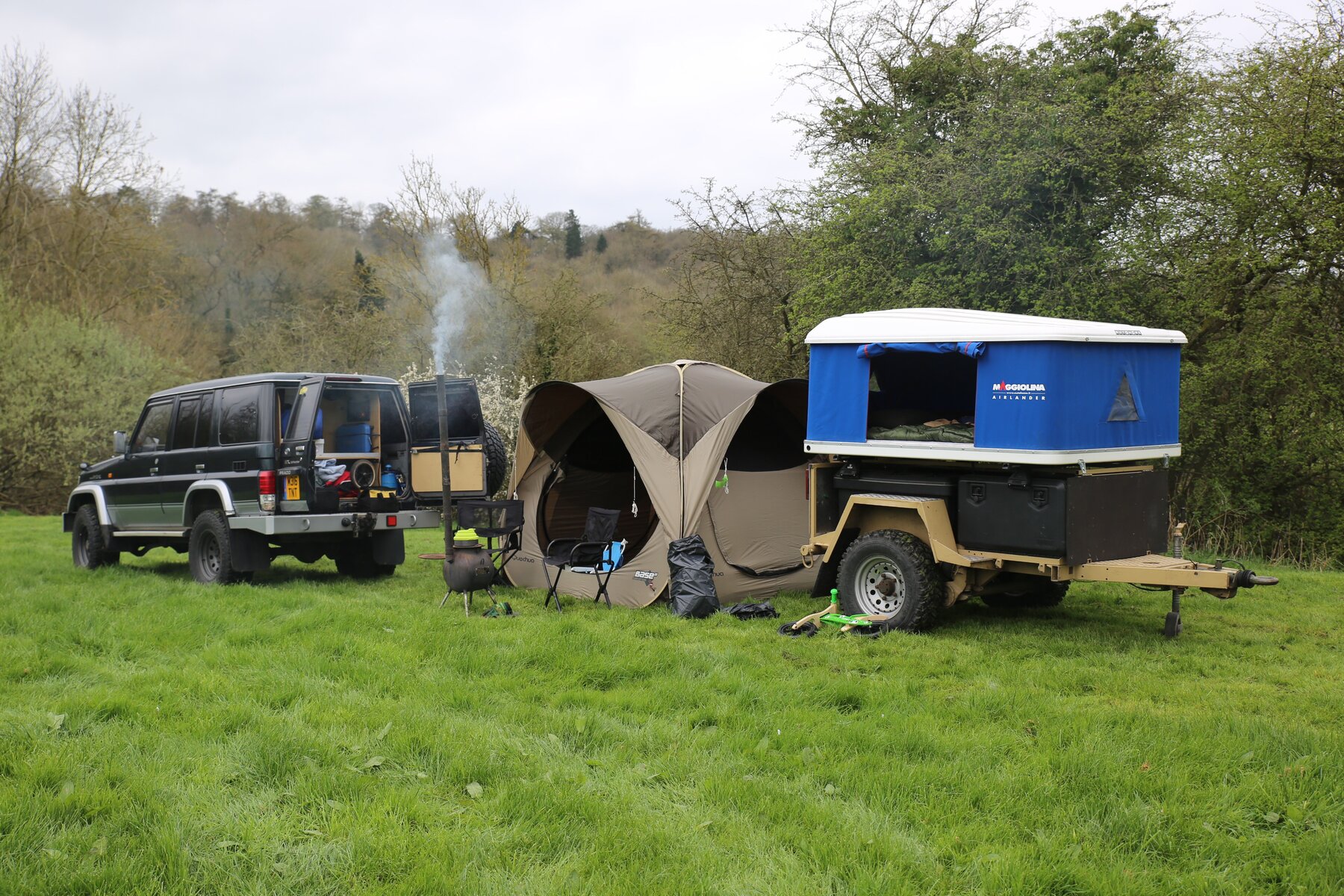

Should be strong enough to carry a kettle and a mattress i reckon .
Looks very sturdy, maybe a Porta Loo as well. :icon-wink:
git shayne they are the best mod trailer you can get. Can i ask what you paid? if your getting rid of the body they go for lots i think they are all aluminium.

Cost me double that but was a bargain none the less .
It's a Rapier missile trailer and for obvious reasons it tows better than anything i've ever experienced , it could be said that it behaves impeccably at 85mph but of course nobody is daft enough to test such a thing :whistle: Braking on my truck is actually improved while towing it :wtf: . The suspension is not height adjustable as many seem to think the mudguards are so high because the suspension can be collapsed to stack trailers for transport by sea or air . It does have a handbrake though its not obvious but from what i can tell the lever is removable so i will have to investigate how its operated and how it can be adapted to accept a breakaway cable .
Great trailer, the height of the trailer is adjustable, the military had two differant length link bars that you pull the pin out of one for it to tow behind a bedford 4x4 and a shorter one for landrovers. But as they all get lost you can cut and shorten the link bar to lower the trailer to your vehicle height.
Also i put the later wide track tow ring on mine because as standard they just come with that sring loaded one which can cause it to jerk back and forward when loaded and you get a reversing push down pin on a newer one.. My mate just bought one from up north for £450 from ebay.
Thanks Rich Bedford or Defender height makes sense i've yet to have a proper look at what i've got . I think it is a spring action brake the trailer is marked with T1999 so i'm guessing that's when the MOD sold it . Can't find much info at all about the Rapier so i would be grateful for whatever you can offer .
Had to save the pic to get a proper look at it coz its so big lol . I think i will keep the bedford height because my nato hitch is only bolted in place of my tow ball at a height i guessed but the trailer isn't ludicrously tilted . Should be able to get it to tow level without to much trouble .
