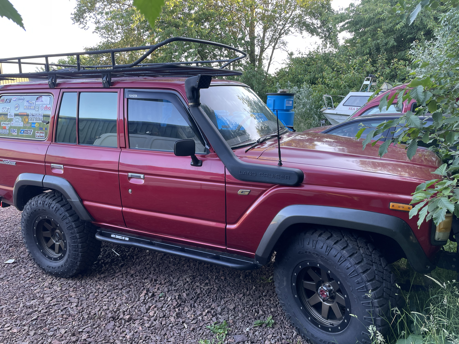

Hey Folks - just joined the group.
Im based near Edinburgh in Scotland.
Two months ago I bought a 1987 HJ60. It was imported from Honduras [LHD] and is in incredible condition, with virtually no rust.
However, I bought it without a mot, and was assured it just needed a few electrics sorting.
But..... It puts out a serious amount of black smoke - way too much to pass a mot.
My garage have investigated pretty much everything. The fuel pump and injectors have been sent to Allertons in Peterborough.
They said the pump is fine, but have refurbished the injectors. Im no mechanic unfortunately!
They are posting them back up and my garage will re assemble everything. Seriously hoping this will help / resolve the black some - or I'm in trouble!
Will keep you posted. Cheers.

The is a fuel screw that if turned can produce incredible amount of smoke, is it a 2h engine?
Hi Iwan - I believe its a 2h.
Thanks, I will mention this to the garage. They are going to fit the fuel pump and refurbished injectors back in hopefully this week. Praying for less smoke!
Sounds awfully like overfuelling, and/or poor air supply.
Black smoke is improper;y combusted diesel. Make sure there isnt a blockage in the air supply, especially of the engine has been pulled apart a bit
Thanks Yogi - Its in way too good condition not to have this sorted one way or the other.
I will make it over to my 60 tomorrow and take a picture of where the real fuel screw is on the 2h for you... and add it here. :thumbup:
Thanks Iwan - that would be really helpful.
Cheers Adrian
