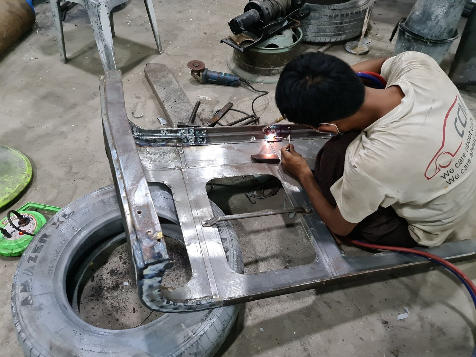

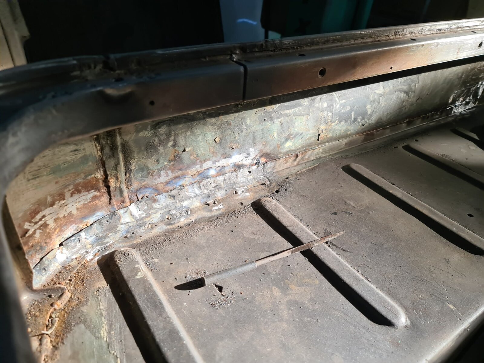

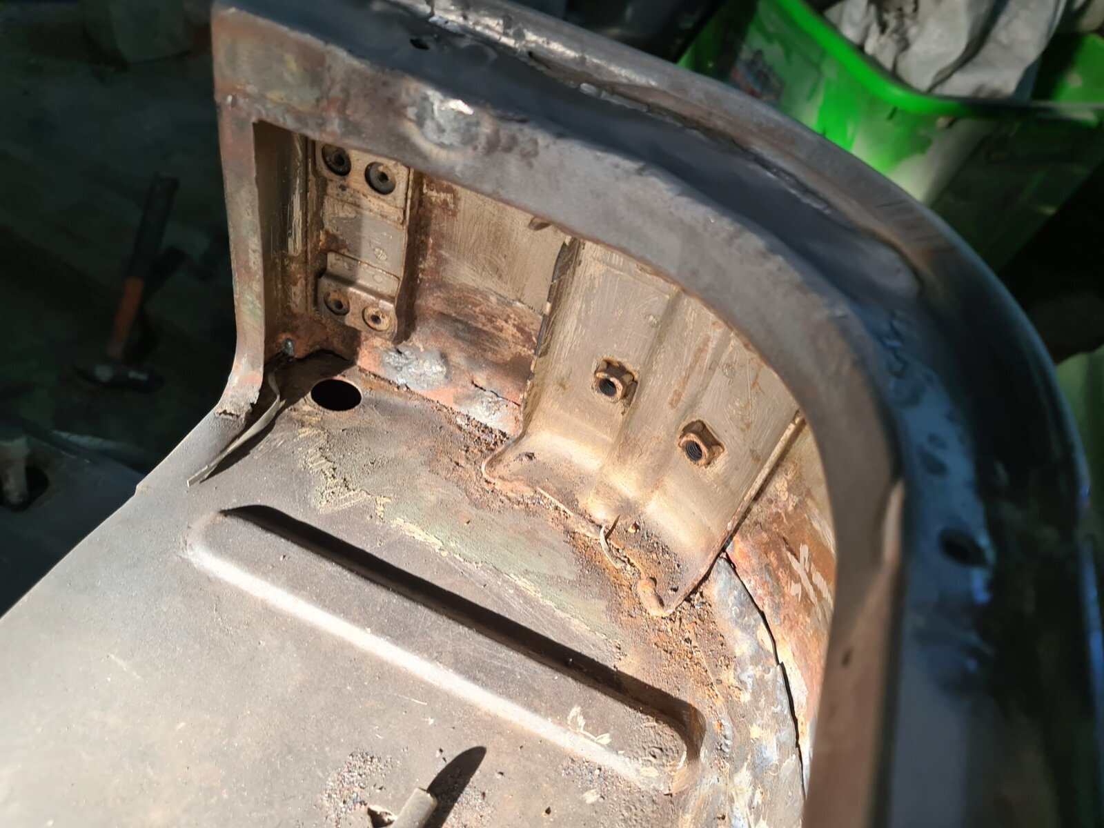

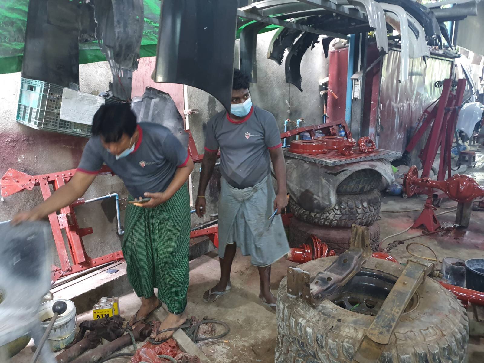

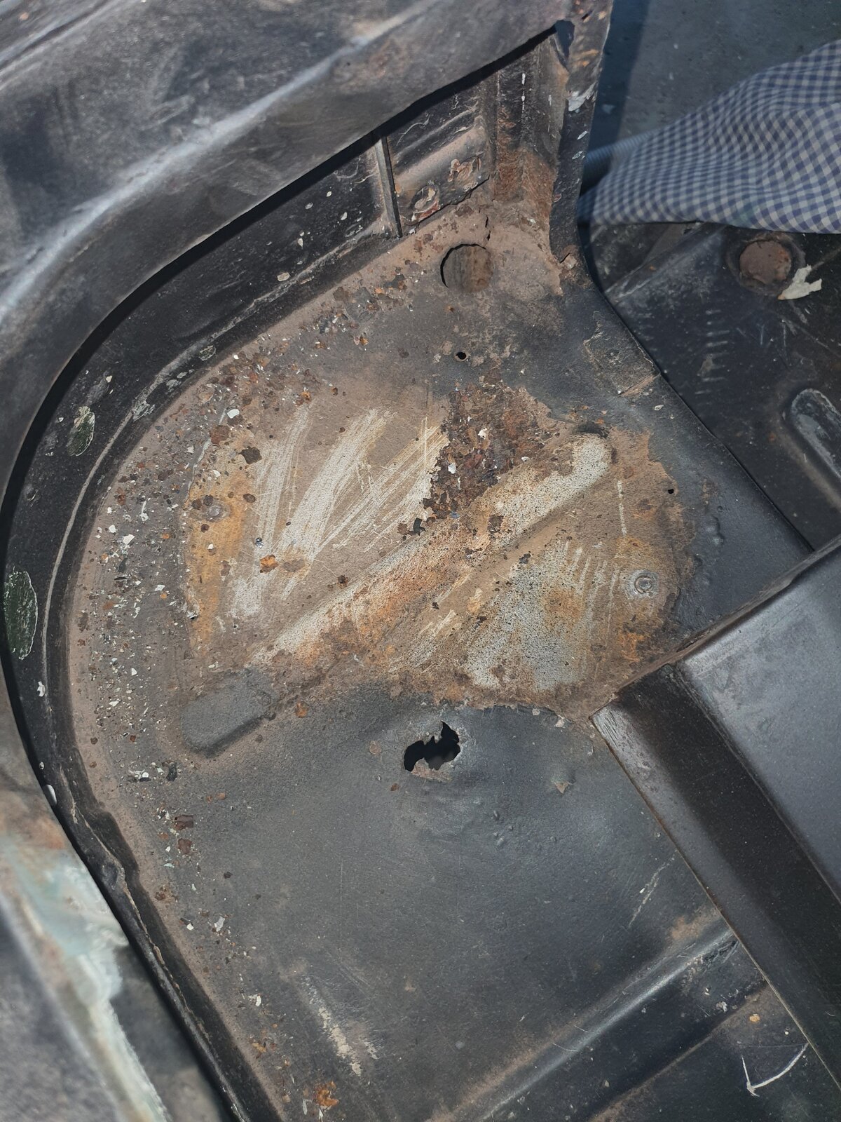

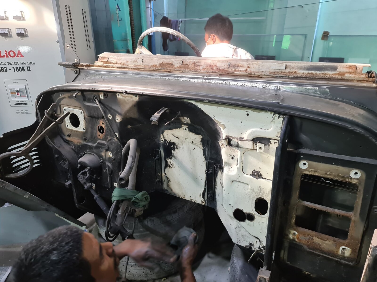

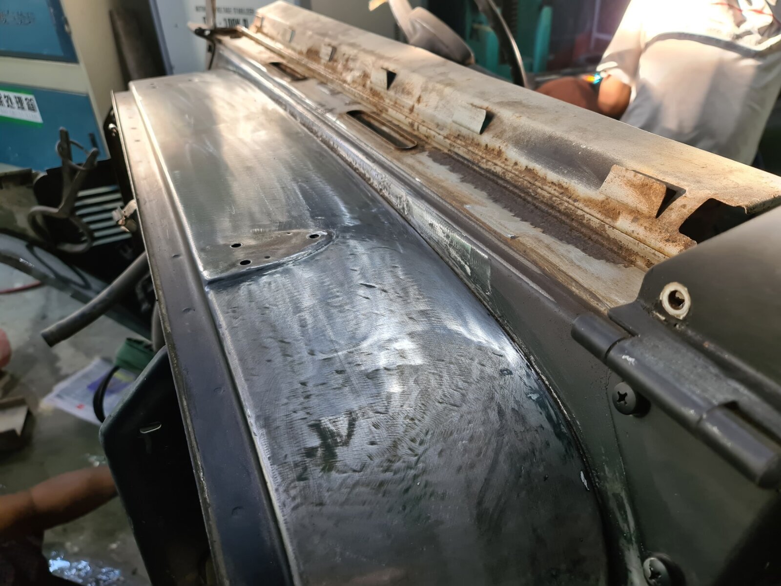

Well the second picture of this latest batch got me all fired up as on the LH side of the photo it looks like the front body(tub) mount has been raised up. Luckily a photo later on enabled me to get my heartbeat back to normal!!!!
Yes the workshop do need to remove that false cross member that's been added to the front member and new body mounts should eliminate the problem
Regards,
Rodger
Already told him and being cut off and steel ground and primed.
Myanmar is famous for improvising and do funny things, so not surprised that things pop up.

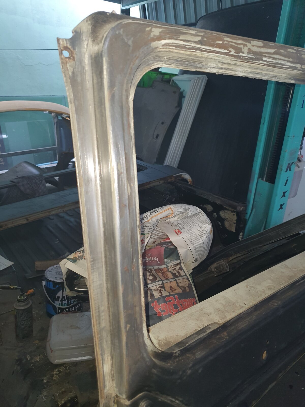

Hi,
It will be interesting to see how the new wings turn out.
The guys are pushing along quickly with the rebuild and I'm emjoying your photos.
Regards,
Rodger
Will post until finished and appreciate any comment along the way.

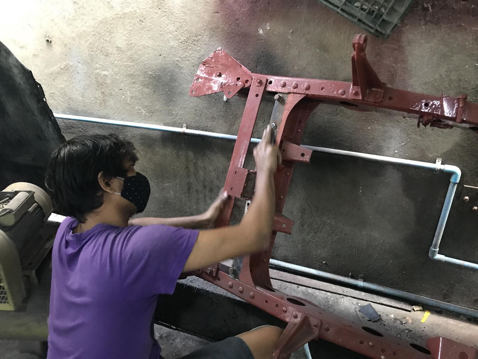

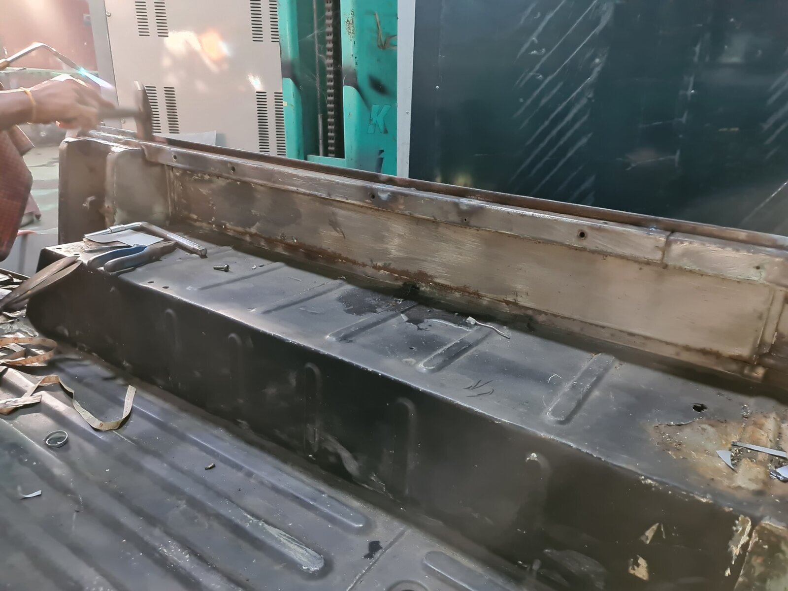

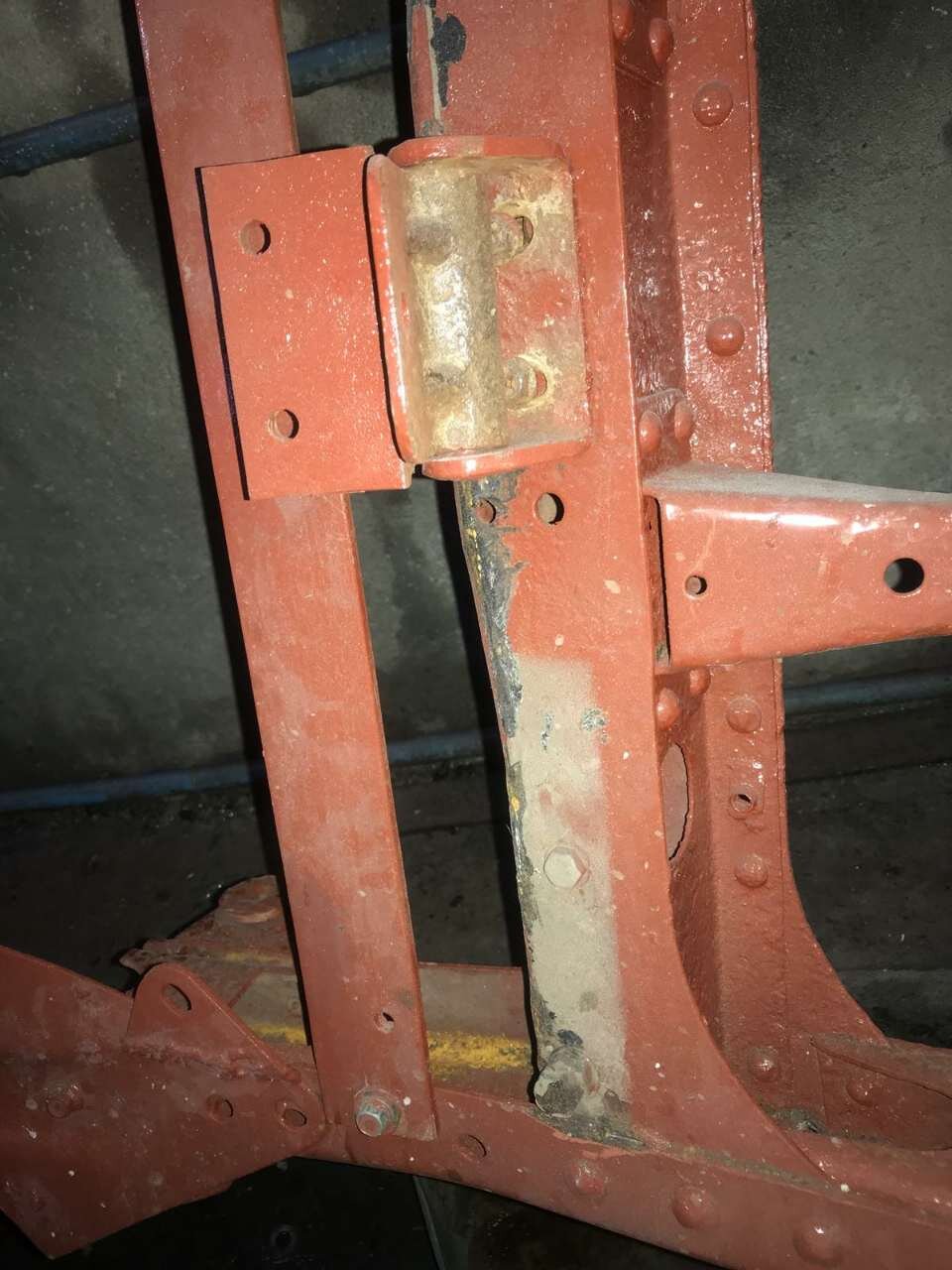

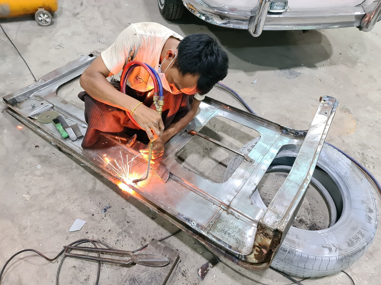

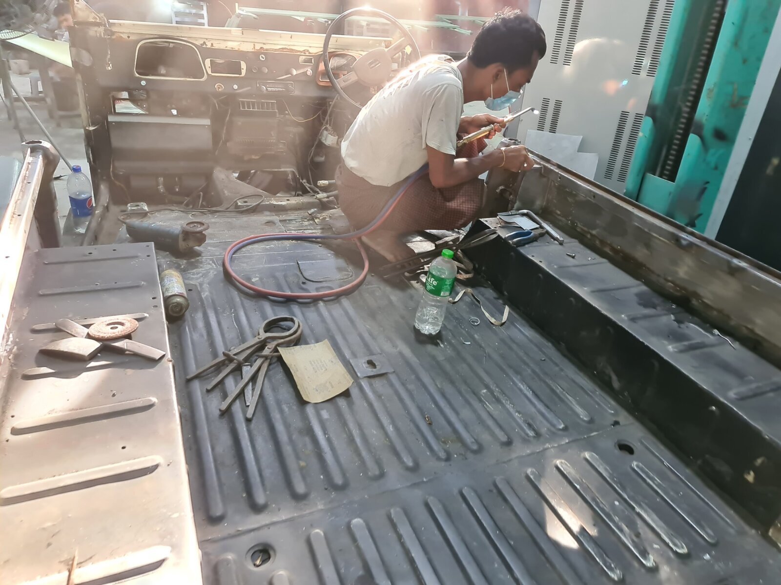

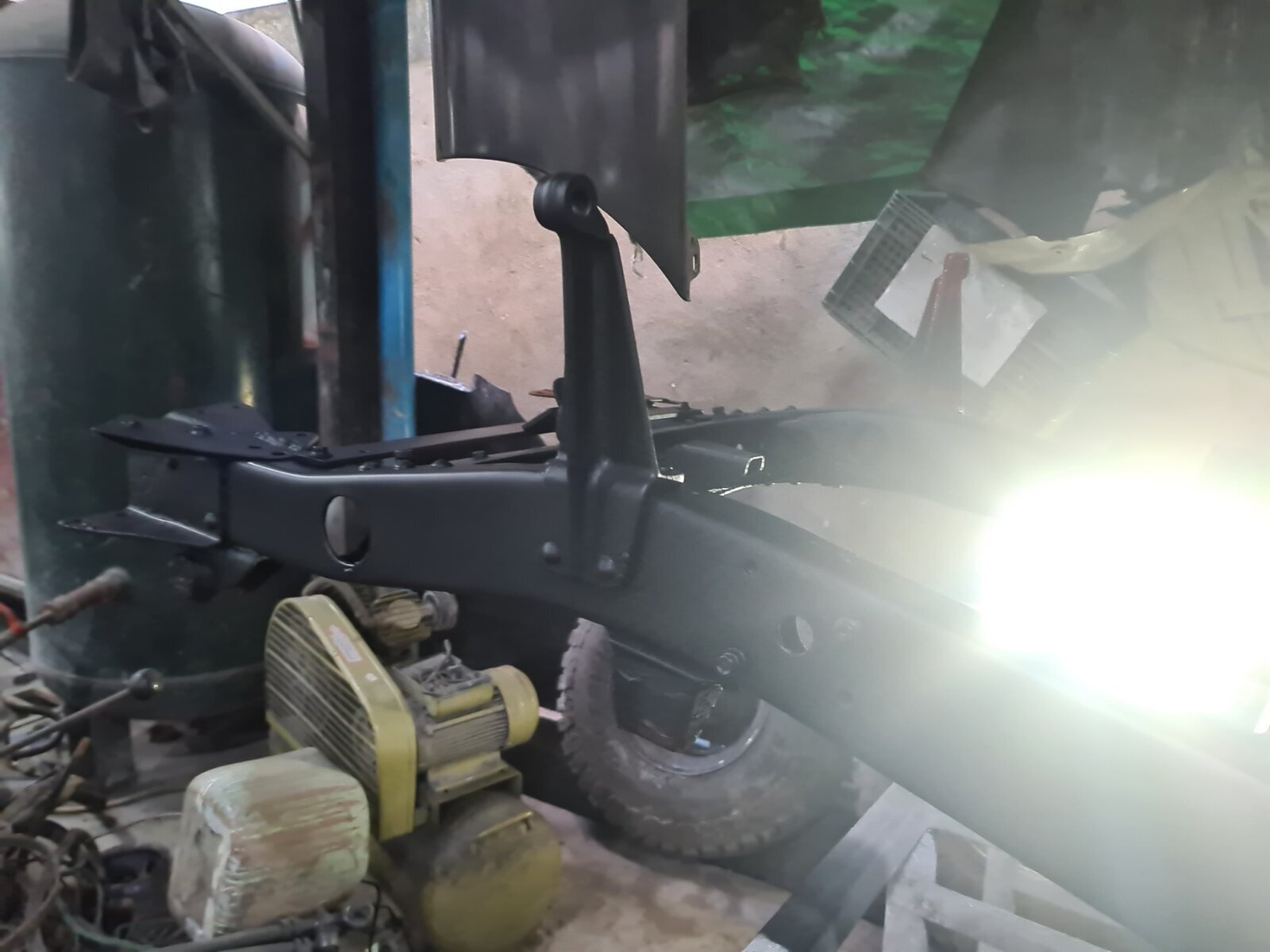

Today the steel bar on front frame will be removed.

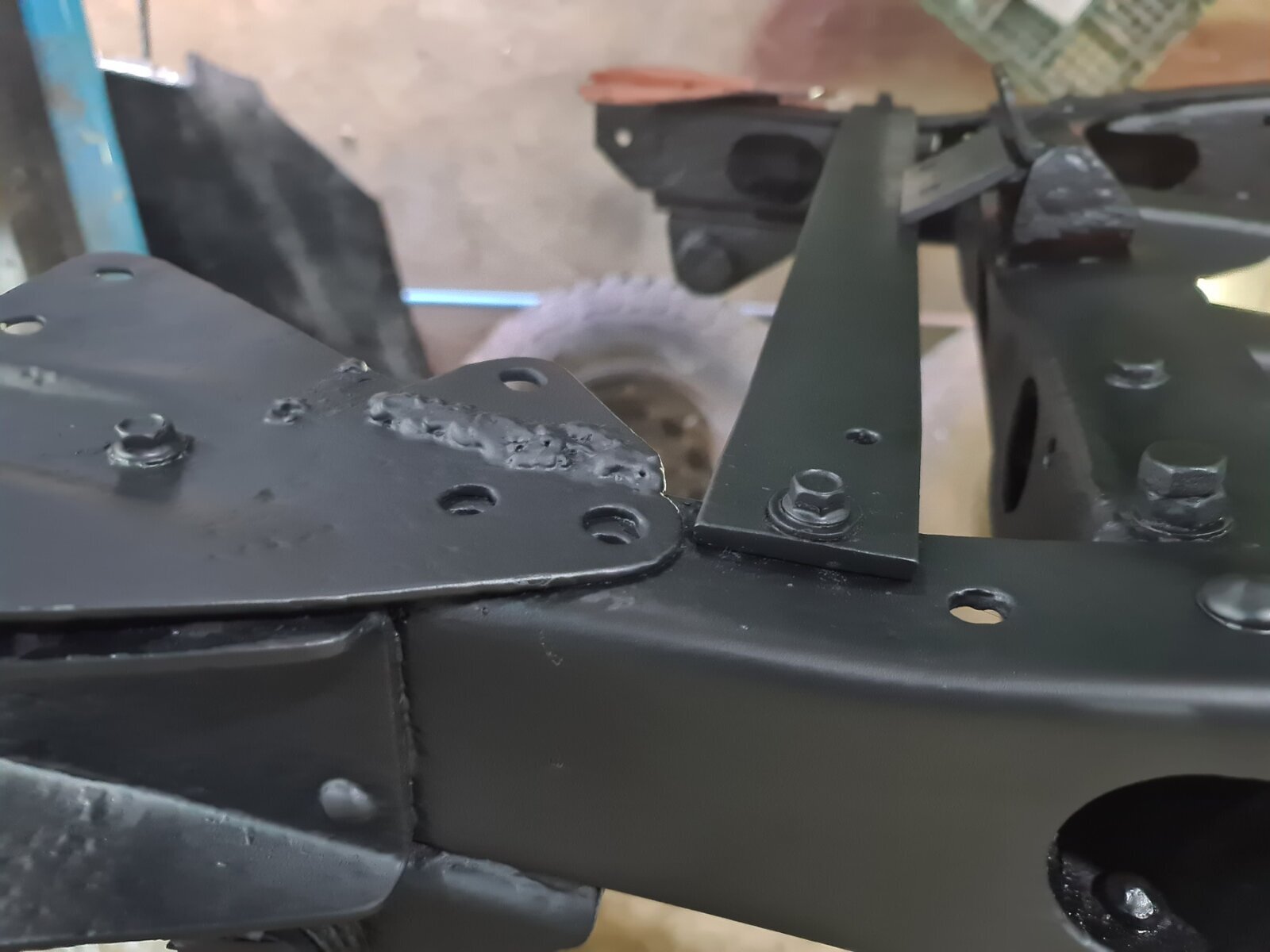

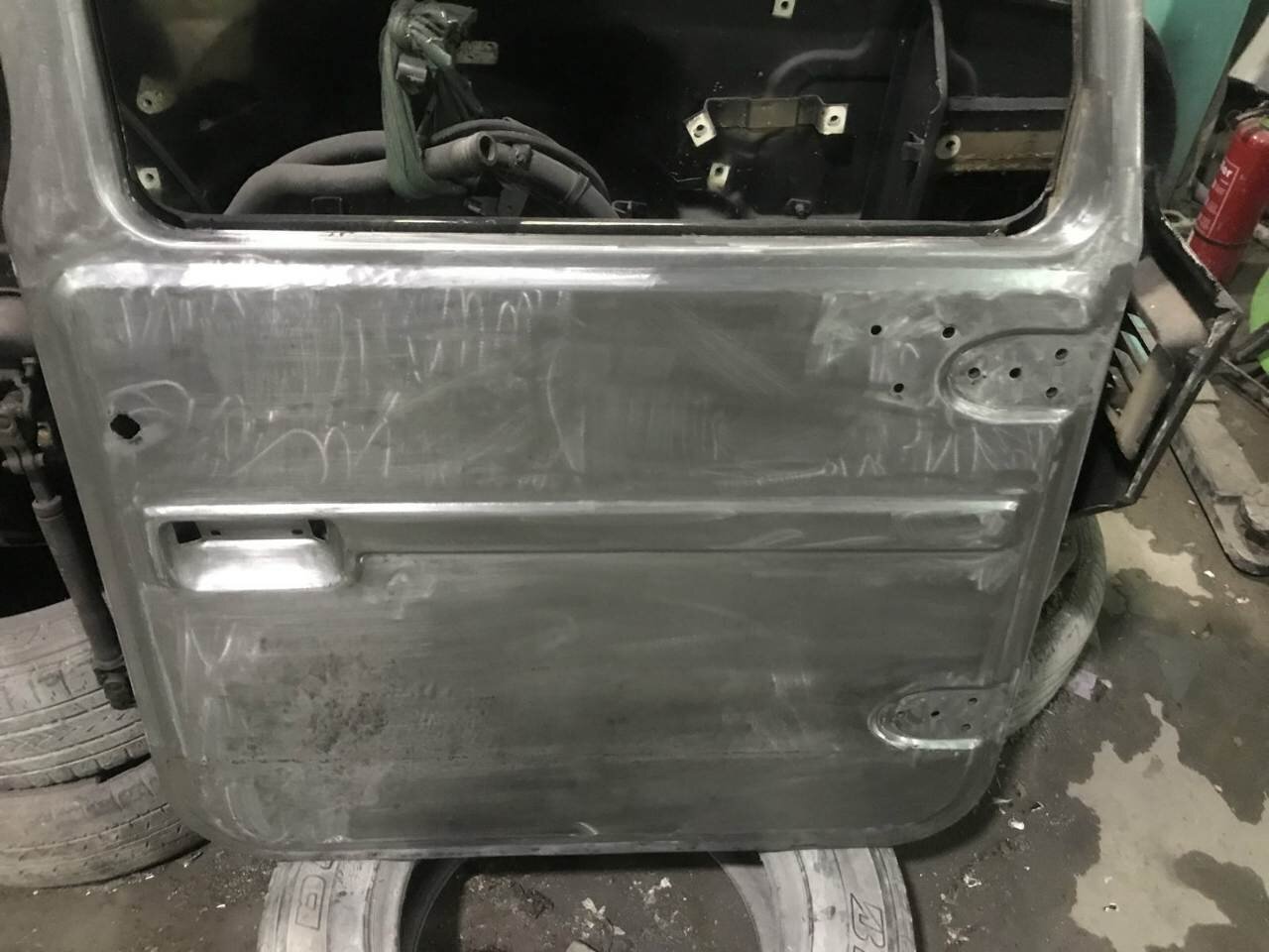

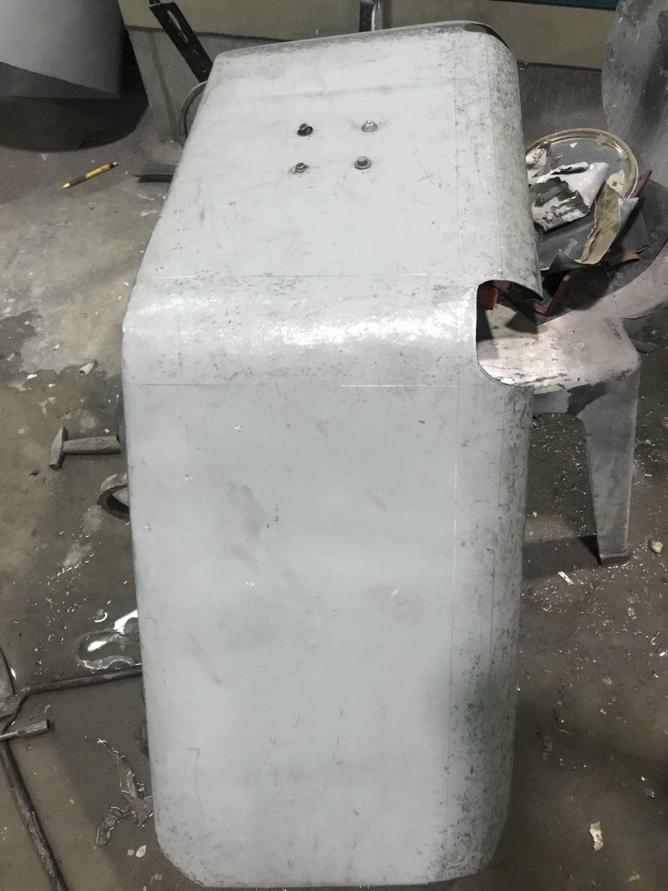

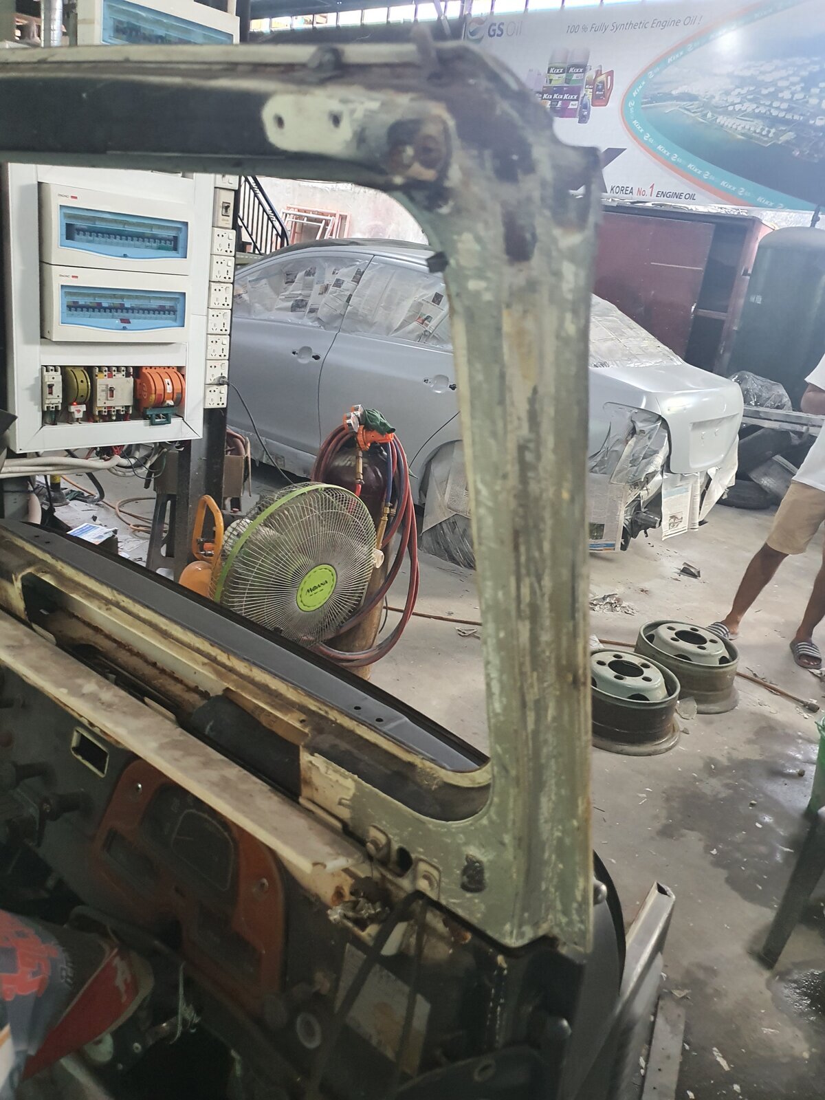

Does the bracket/hinge on top of the bar go onto the main frame or is this one not part of the original car ?

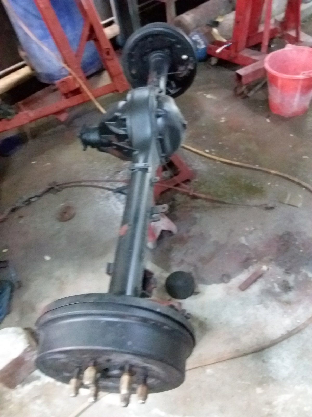

Tomorrow frame will be turned for clean up and painting and starting to clean up engine and gearbox.

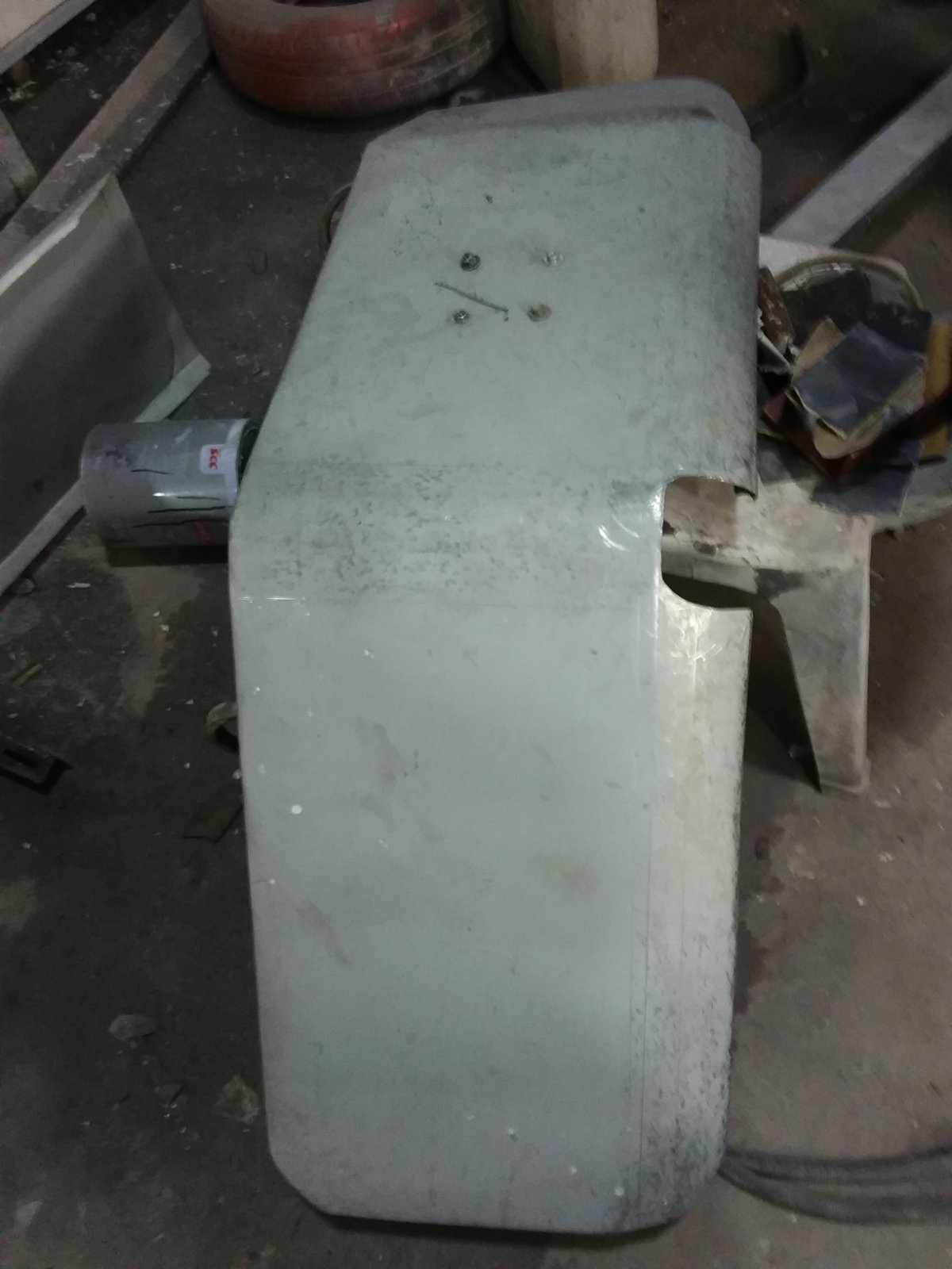

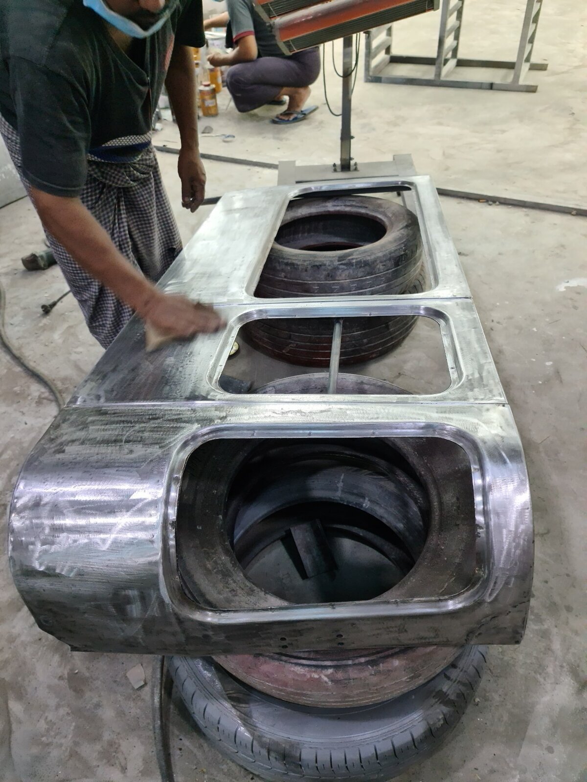

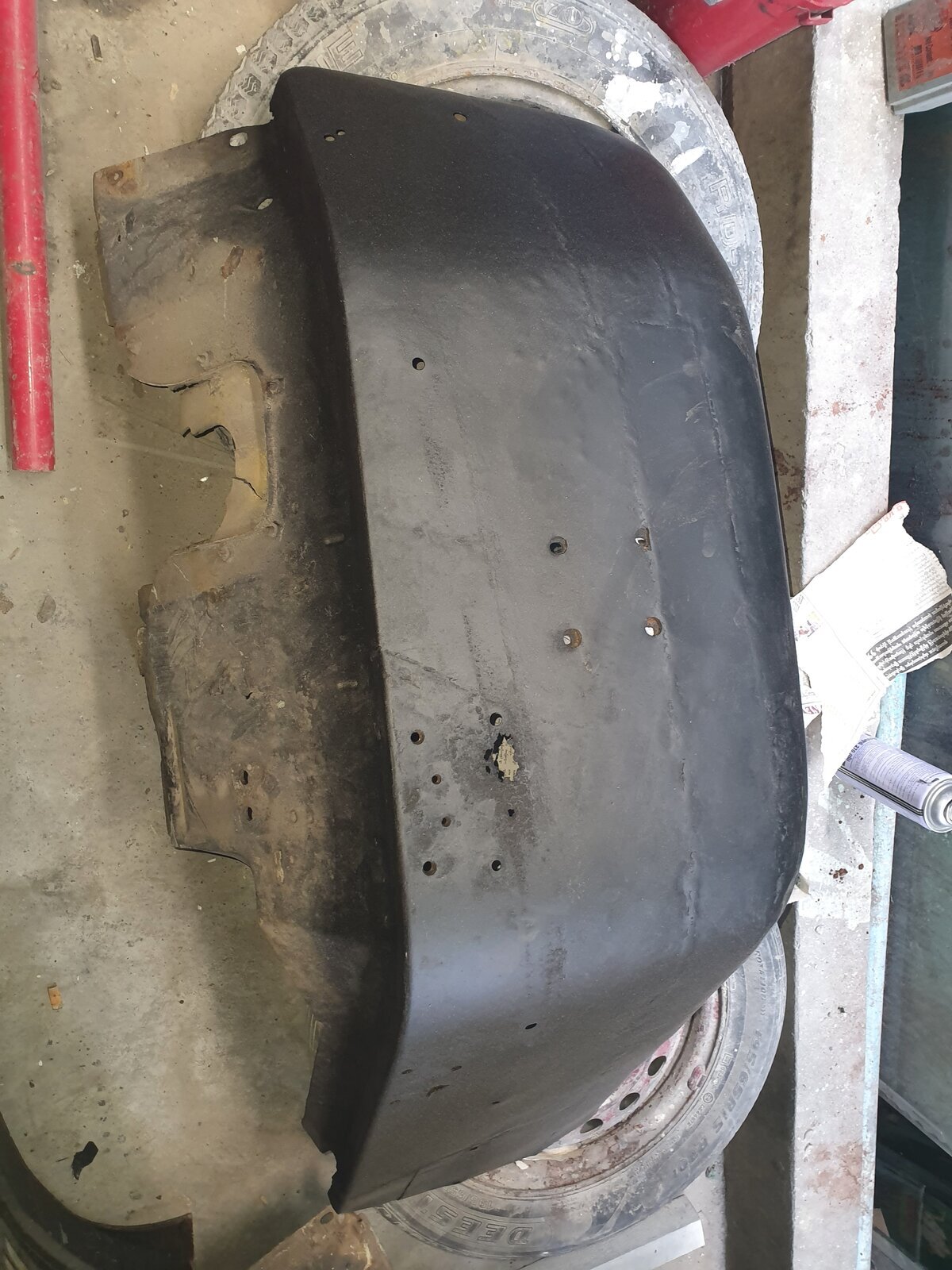

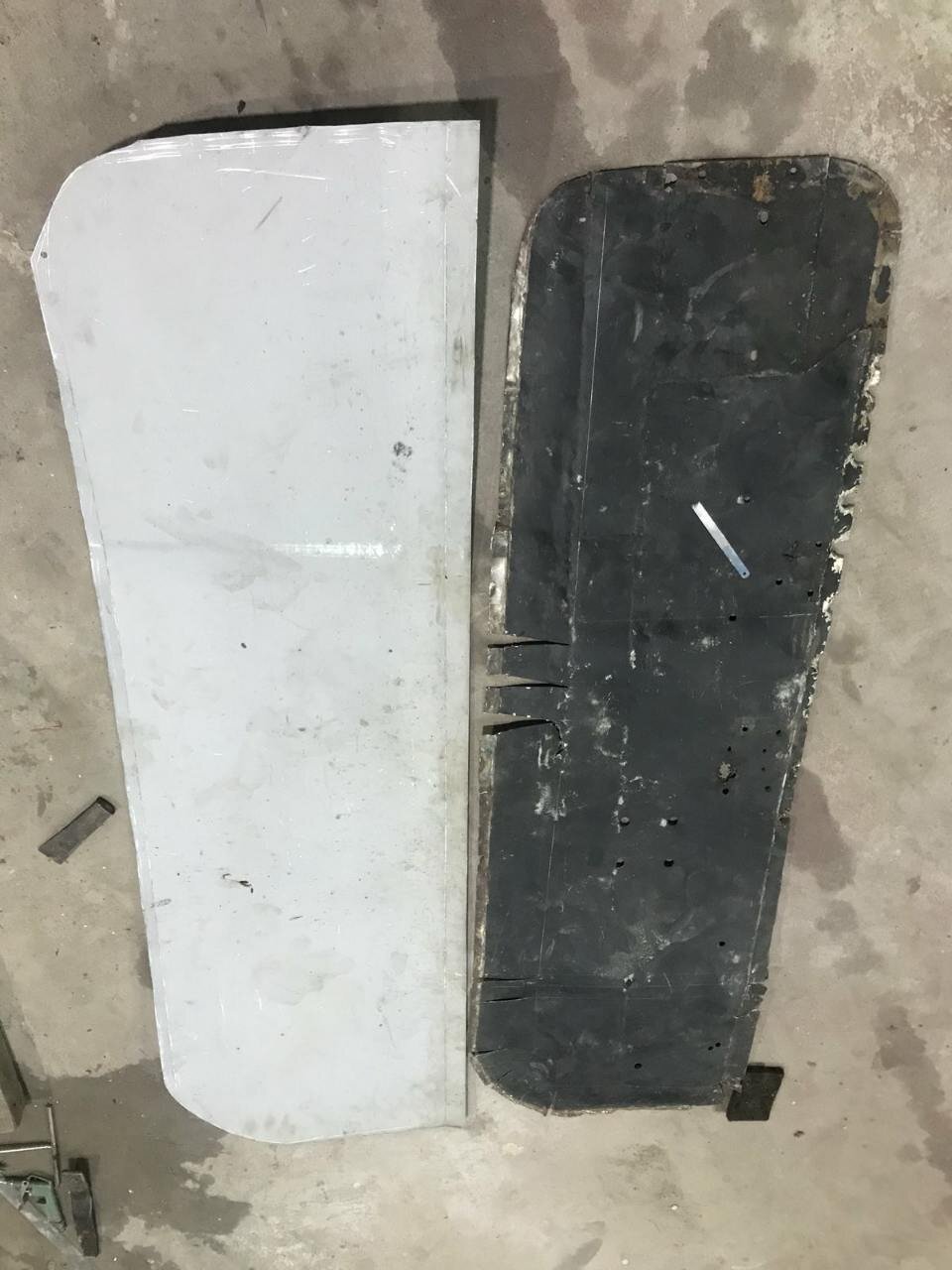

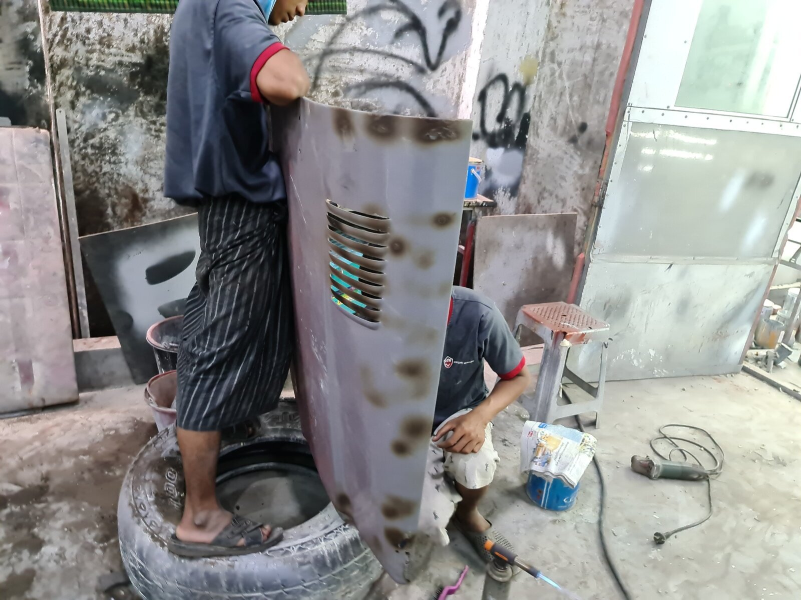

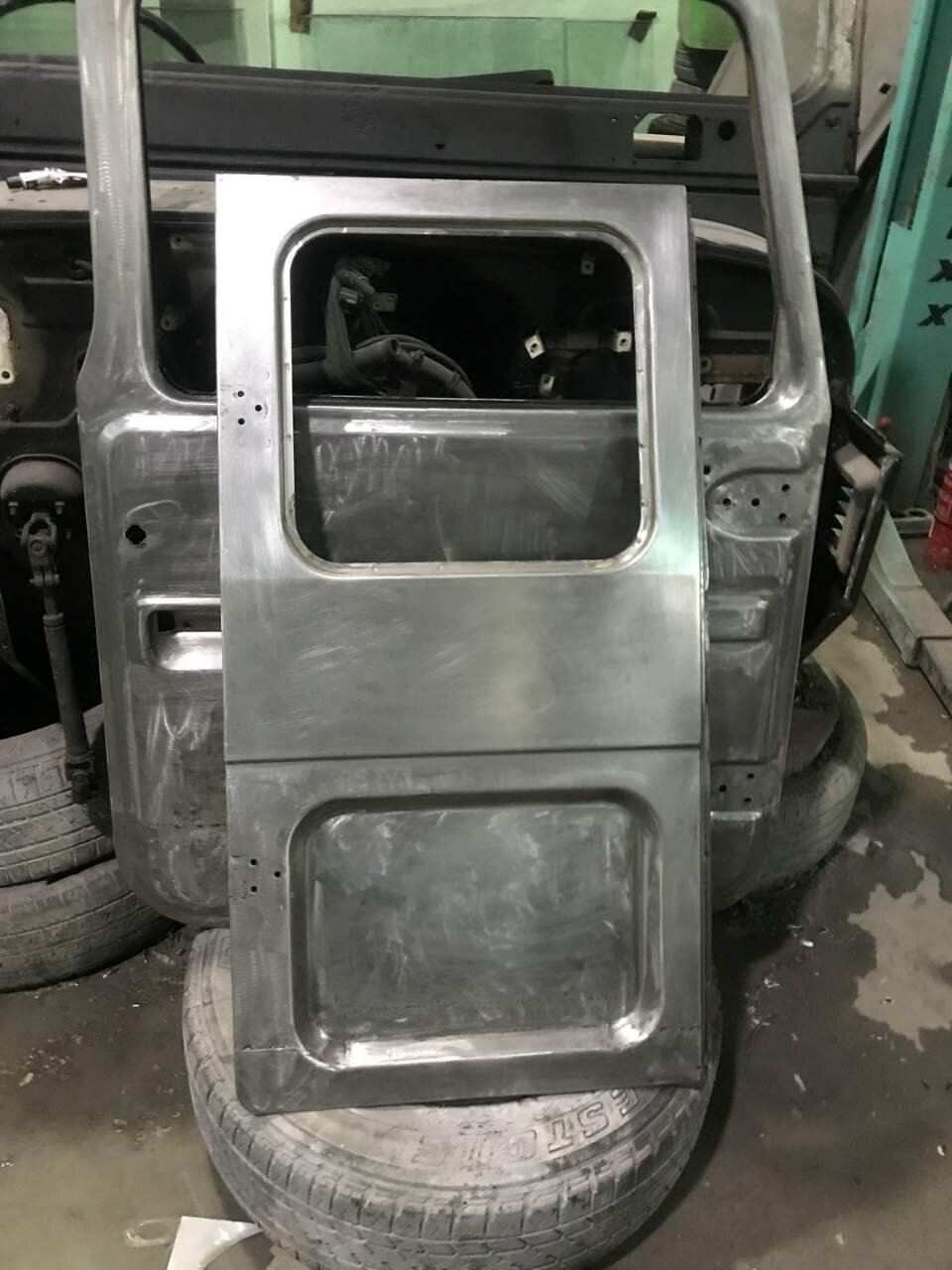

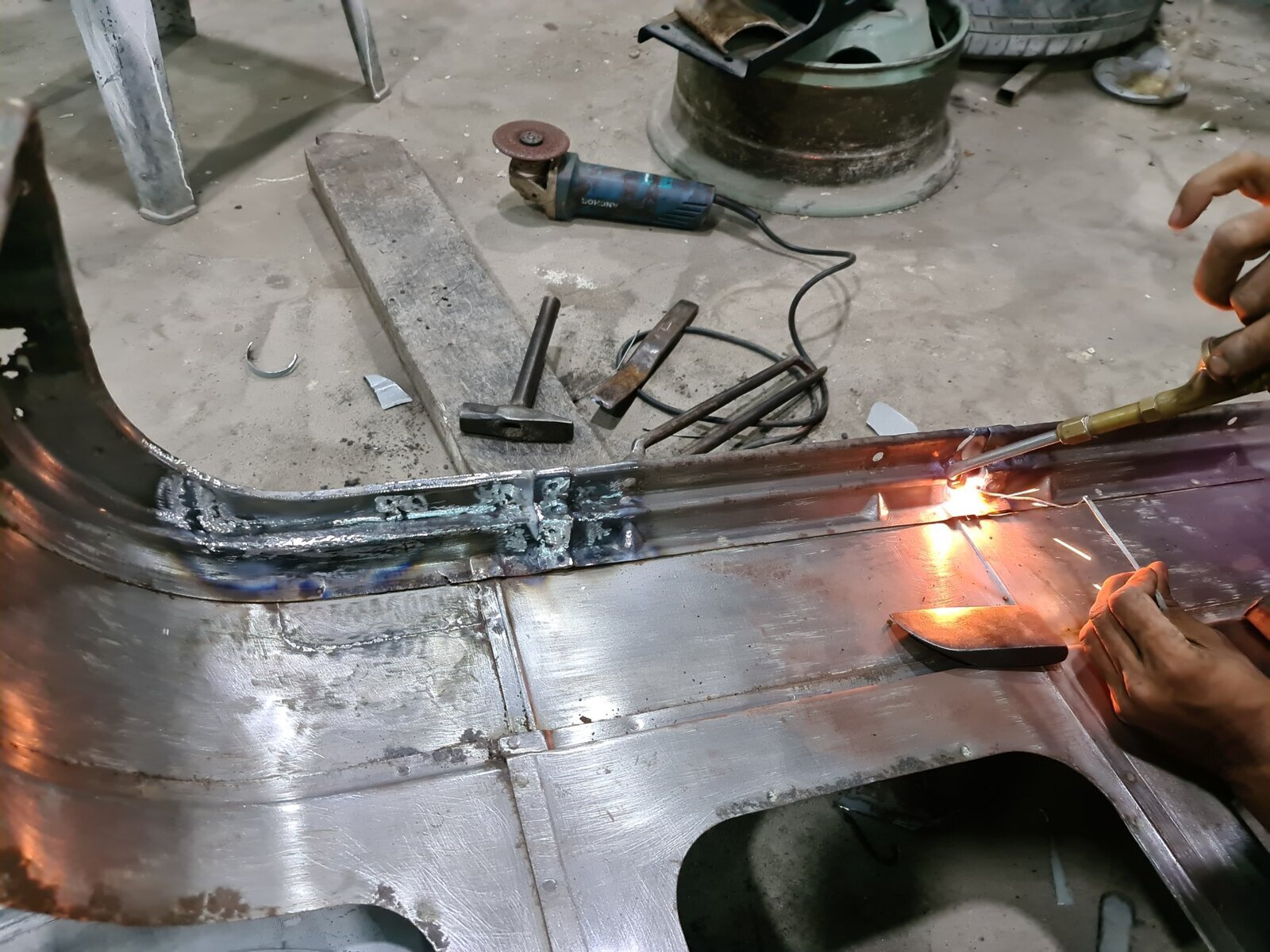

New fenders are being made since they had too much rust. But, being made on no cure, no pay basid and I have a set at hand that s in fair condition that can be used if it fails.

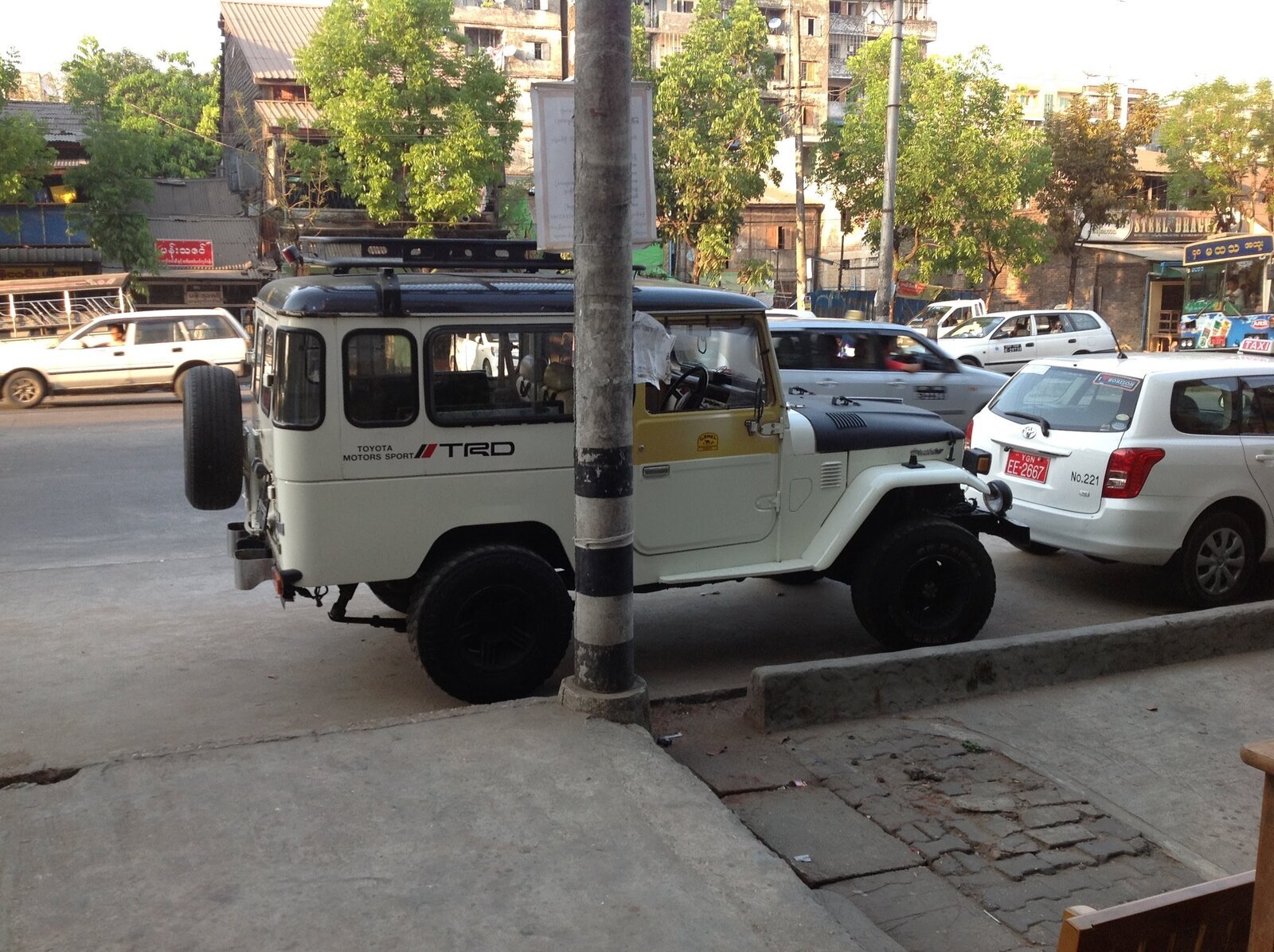

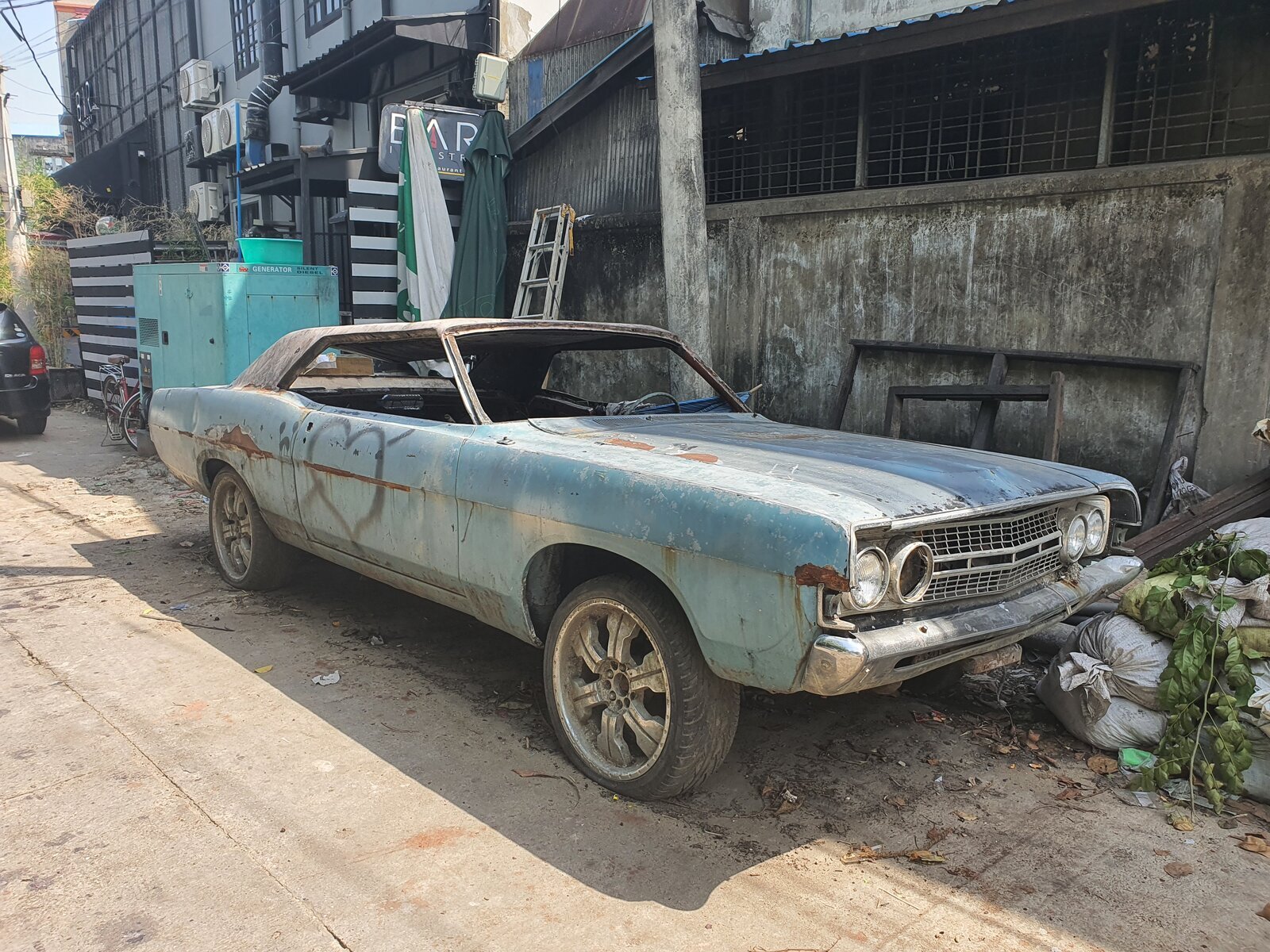

Quite a few older cars littered around in Rangoon, like this one.... looks like an early 70 Ford

Hi,
The bracket shown in photo 3 mounts to the original front cross member and supports the bottom of the front valance. Your bracket has had a new top piece added that has square corners whereas the originals have rounded corners. The positioning needs to be exact for the front body alignment but I suspect that when the extra bar is removed the original placing will be visible.

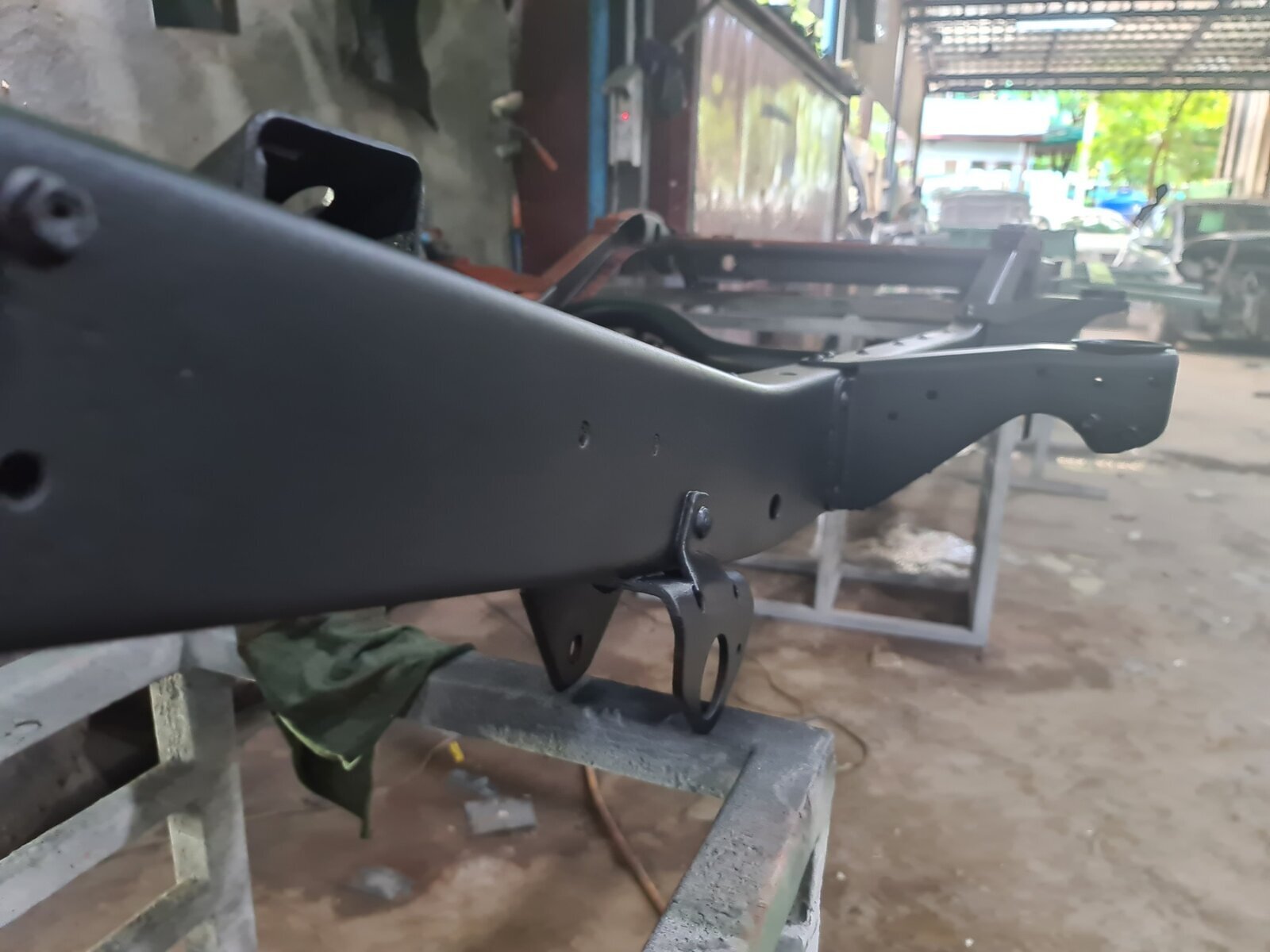

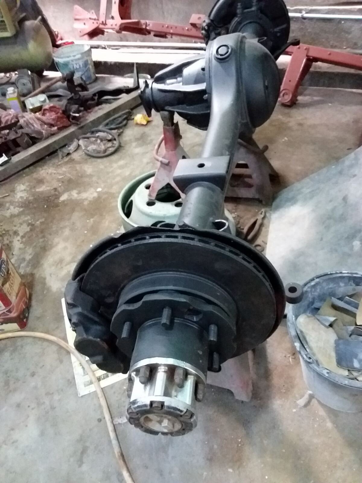

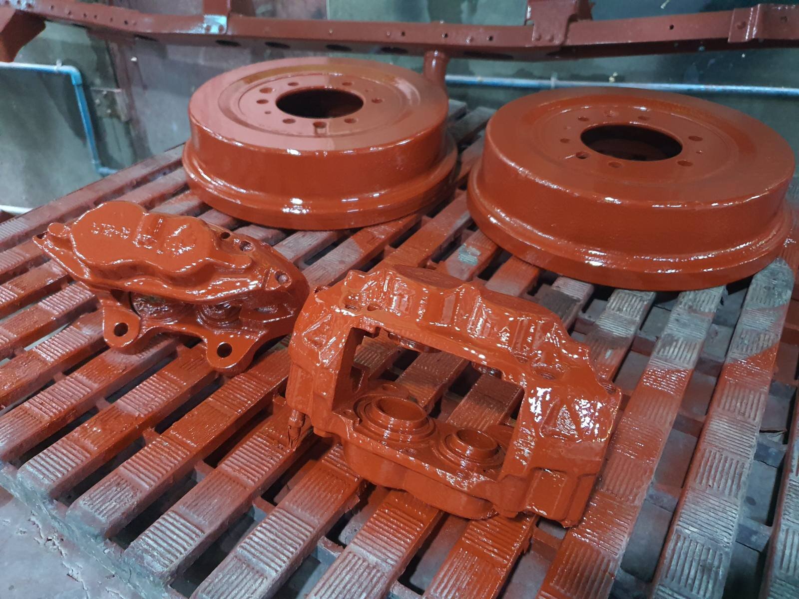

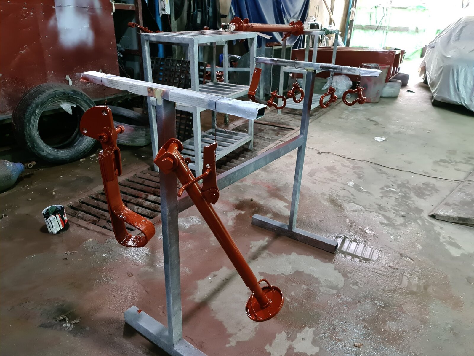

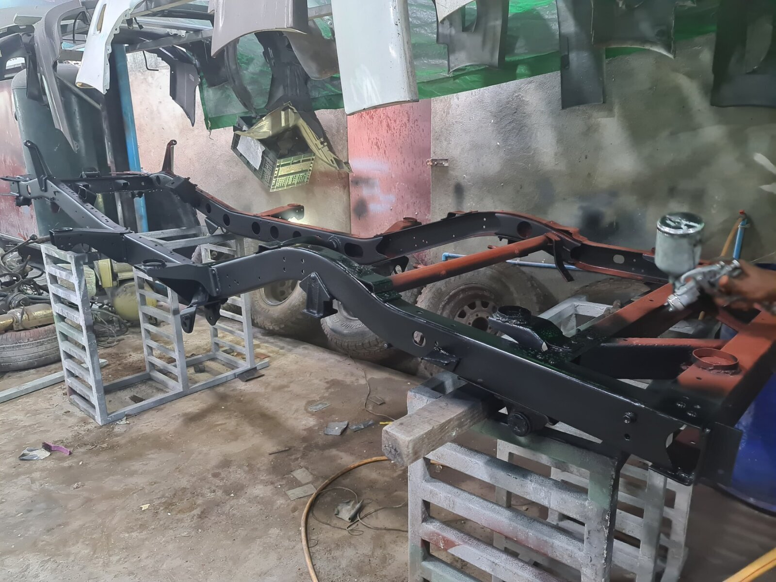

Things moving forward. New bumpers made in same steel thickness and shape.

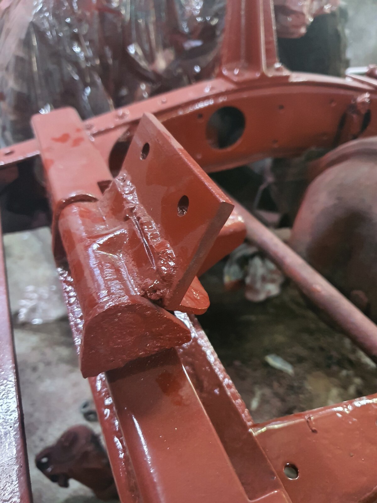

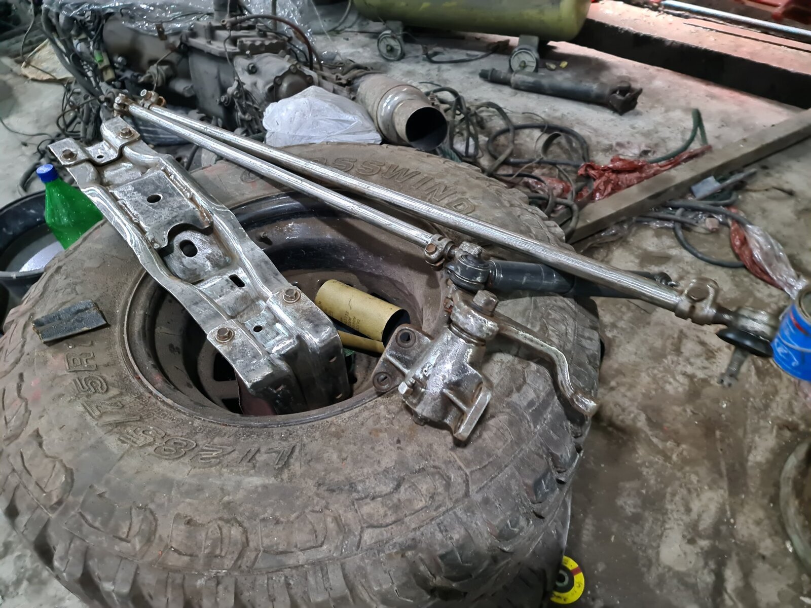

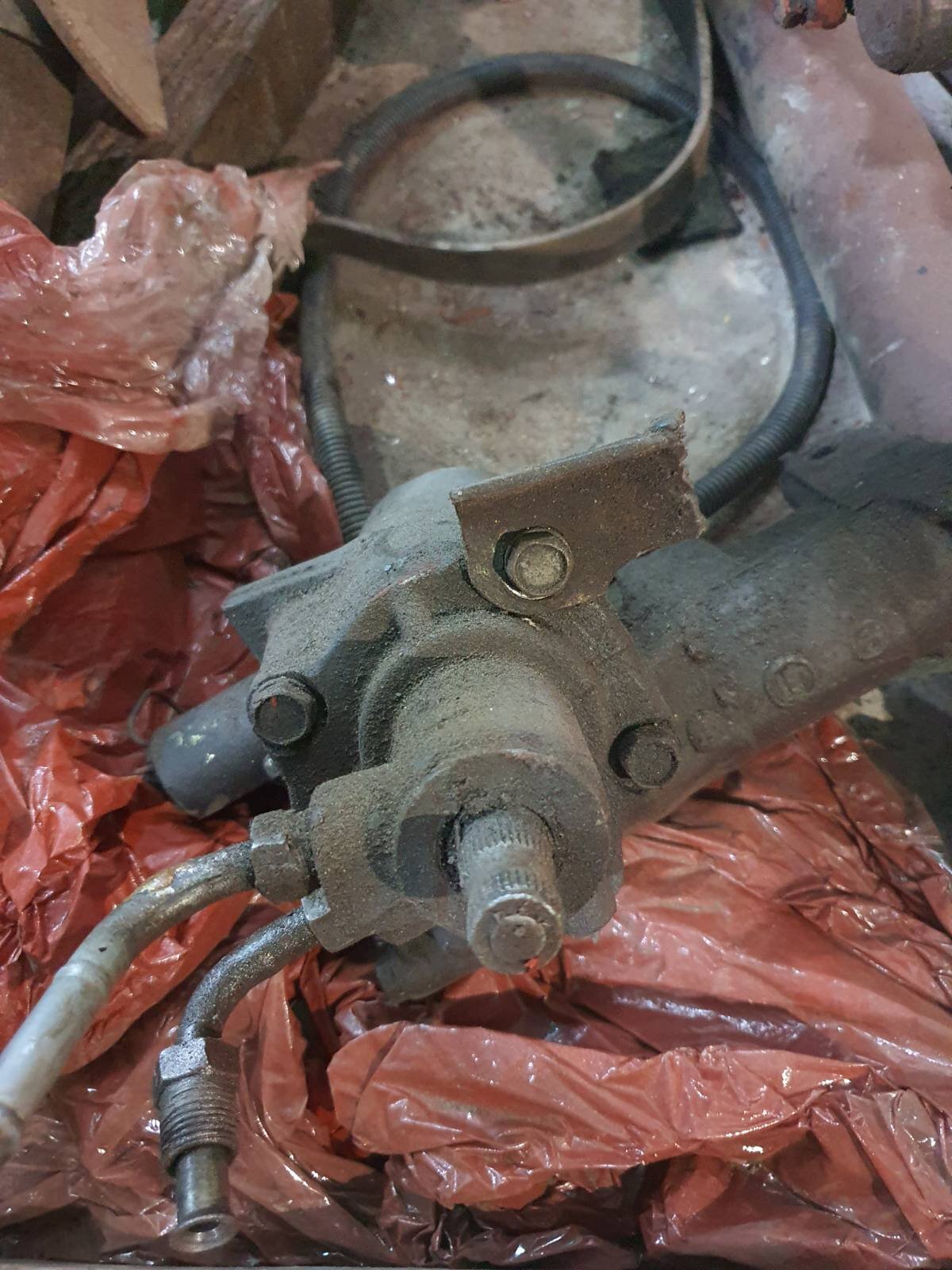

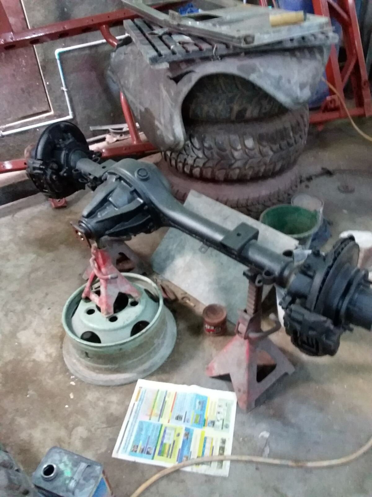

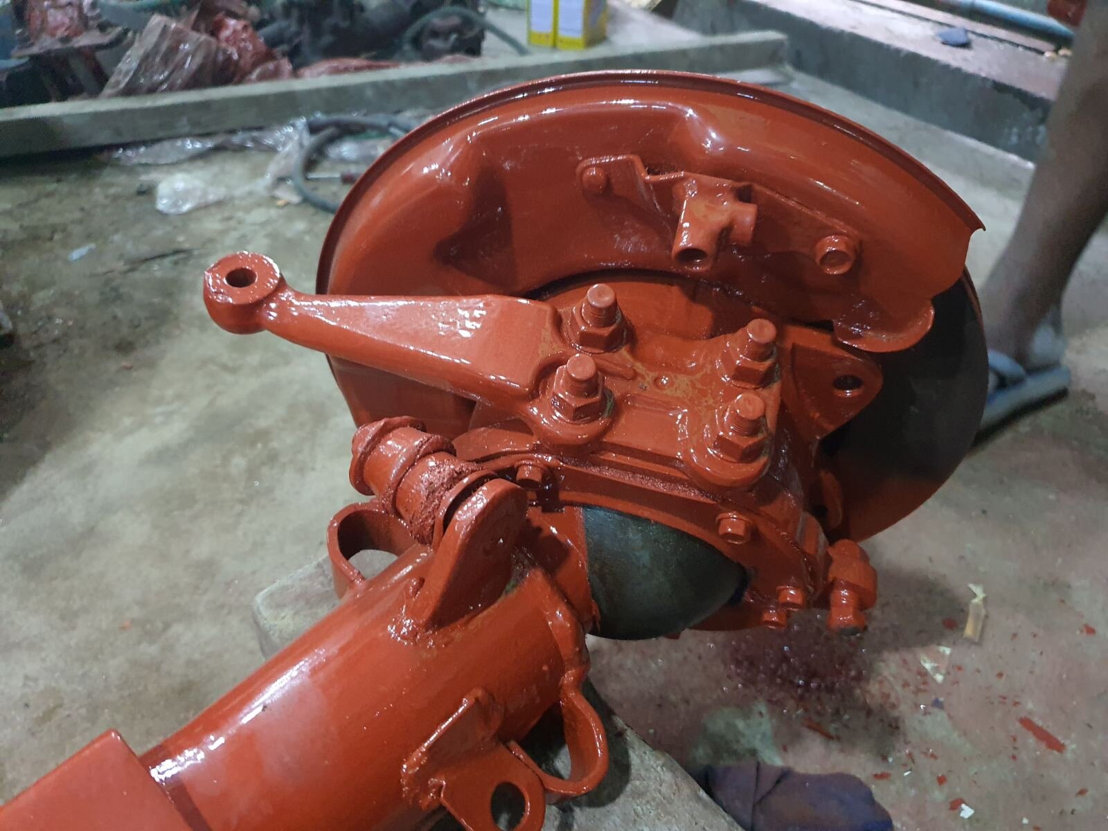

Looks like the steering unit has a broken bracket, that have made some damages to the attachment point on the frame.
Doors and other parts being stripped for paint and work in engine (runs perfect, so just need to replace some hoses and other.

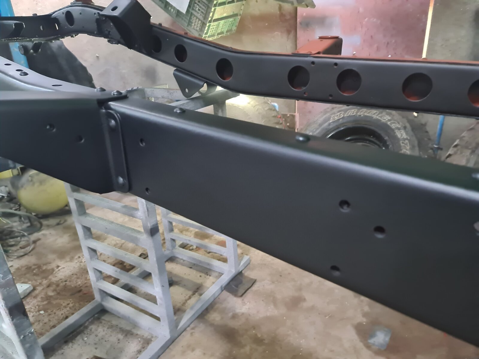

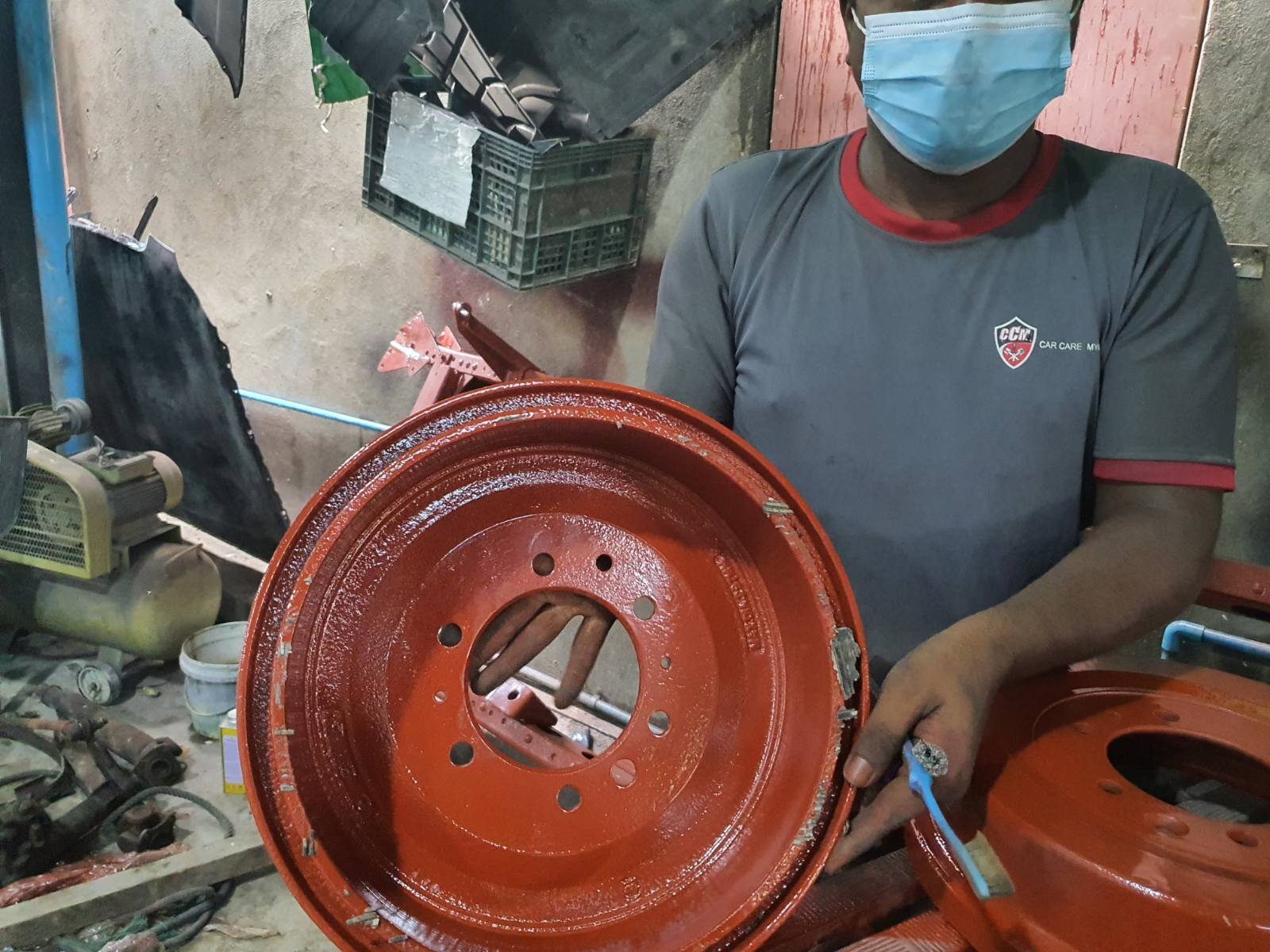

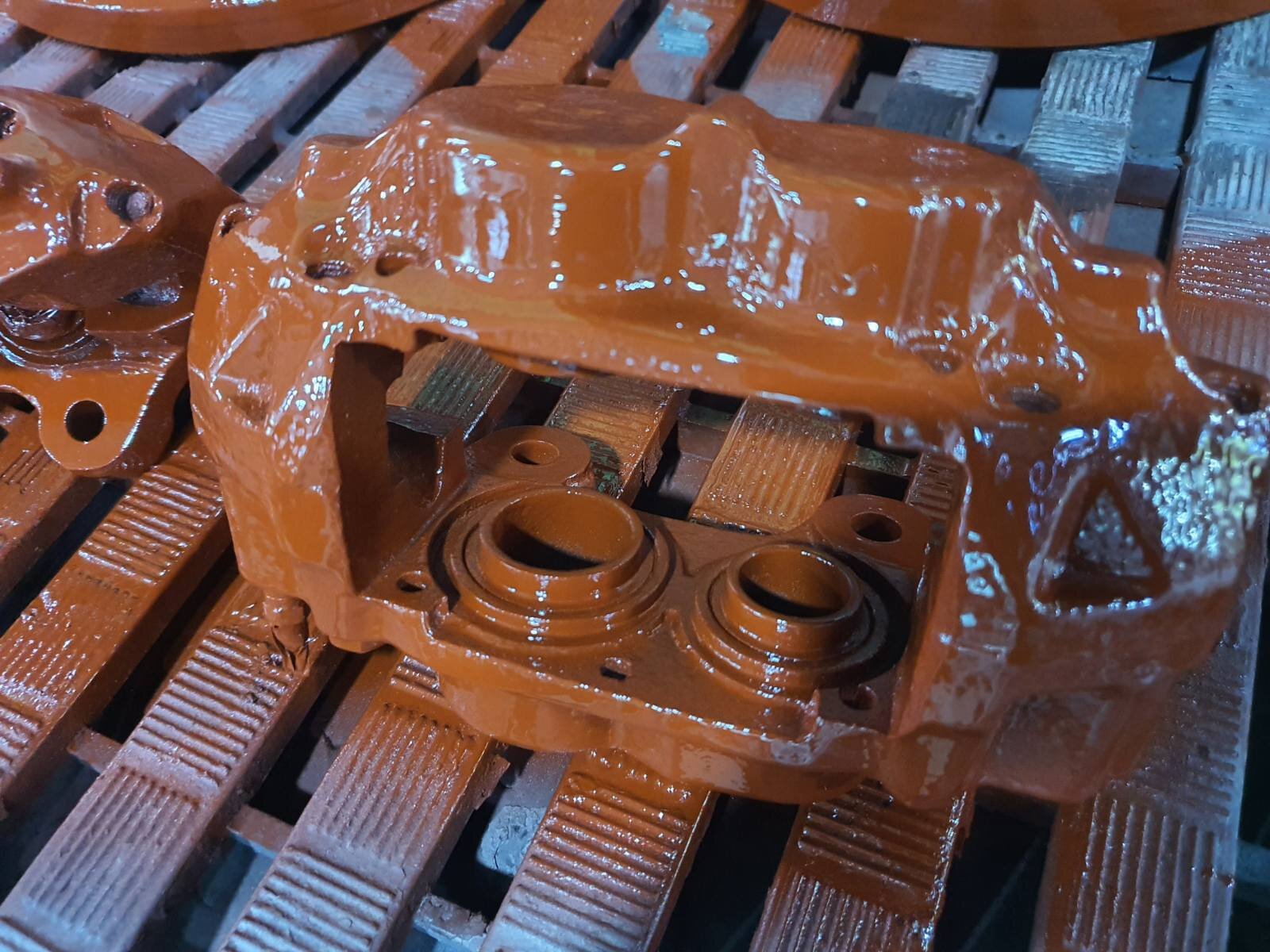

A bit generous with the paint maybe, now 2 layers of epoxy and next is all in black color.

Hi,
As you say, perhaps a little generous with the epoxy but no matter except where the pads and shoes for the brakes are going to be in contact. Also on the caliper pistons as the paint will get broken up and therefore suseptable to water ingress which would undermine their work. Also, I think, it would make your brakes a bit odd until the paint is worn through.
I am still amazed at the condition of the bodywork - just so rust free!
I think you have found why the steering was so erratic with the broken mounting bracket and the damage to the chassis but both are repairable or in the case of the steering box, replaceable.

I will have the excessive paint matters taken care of and thanks for advising.

As for the excessive paint, they will fix this up and remove. Great to have eyes watching and guiding :)

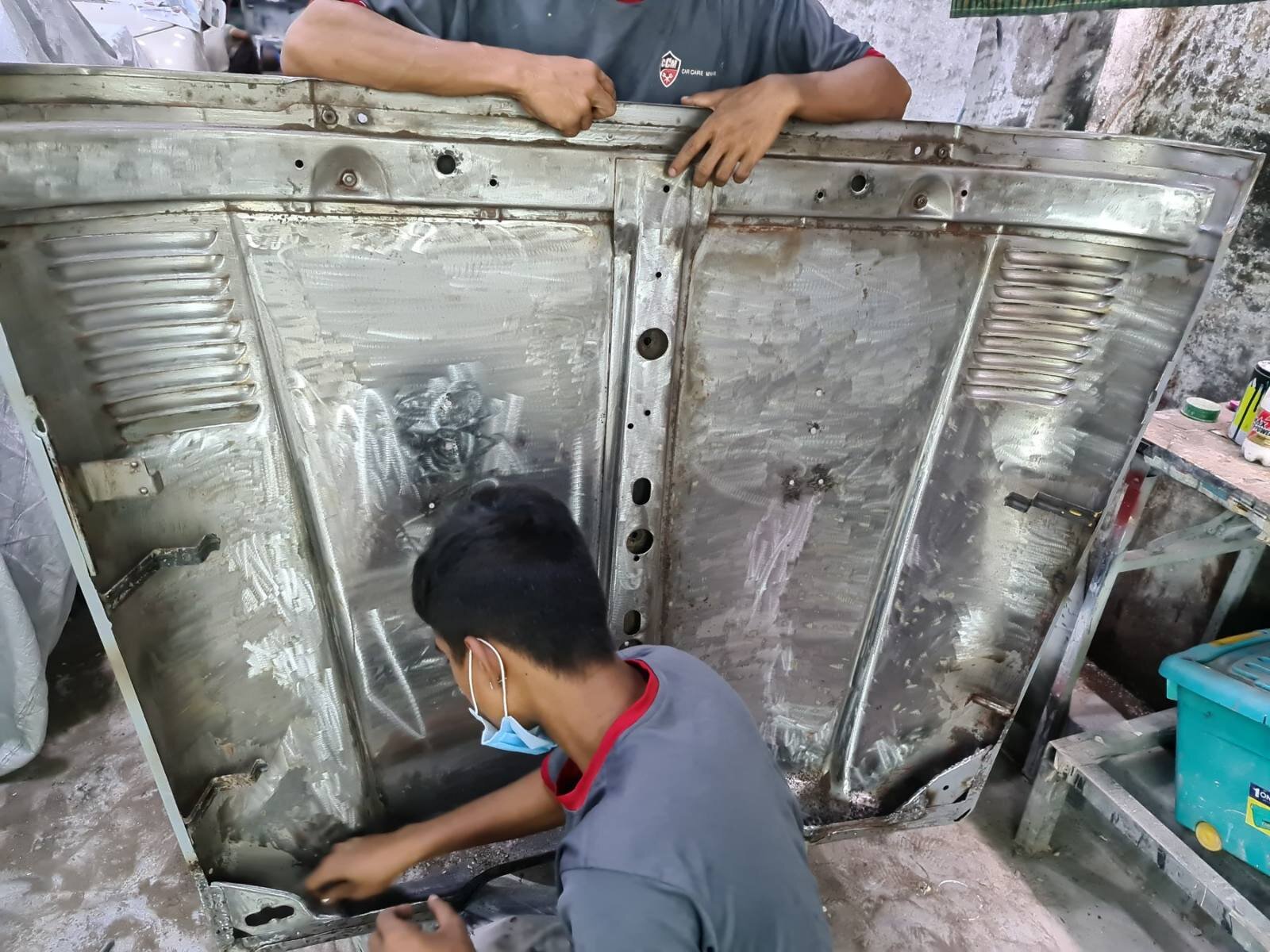

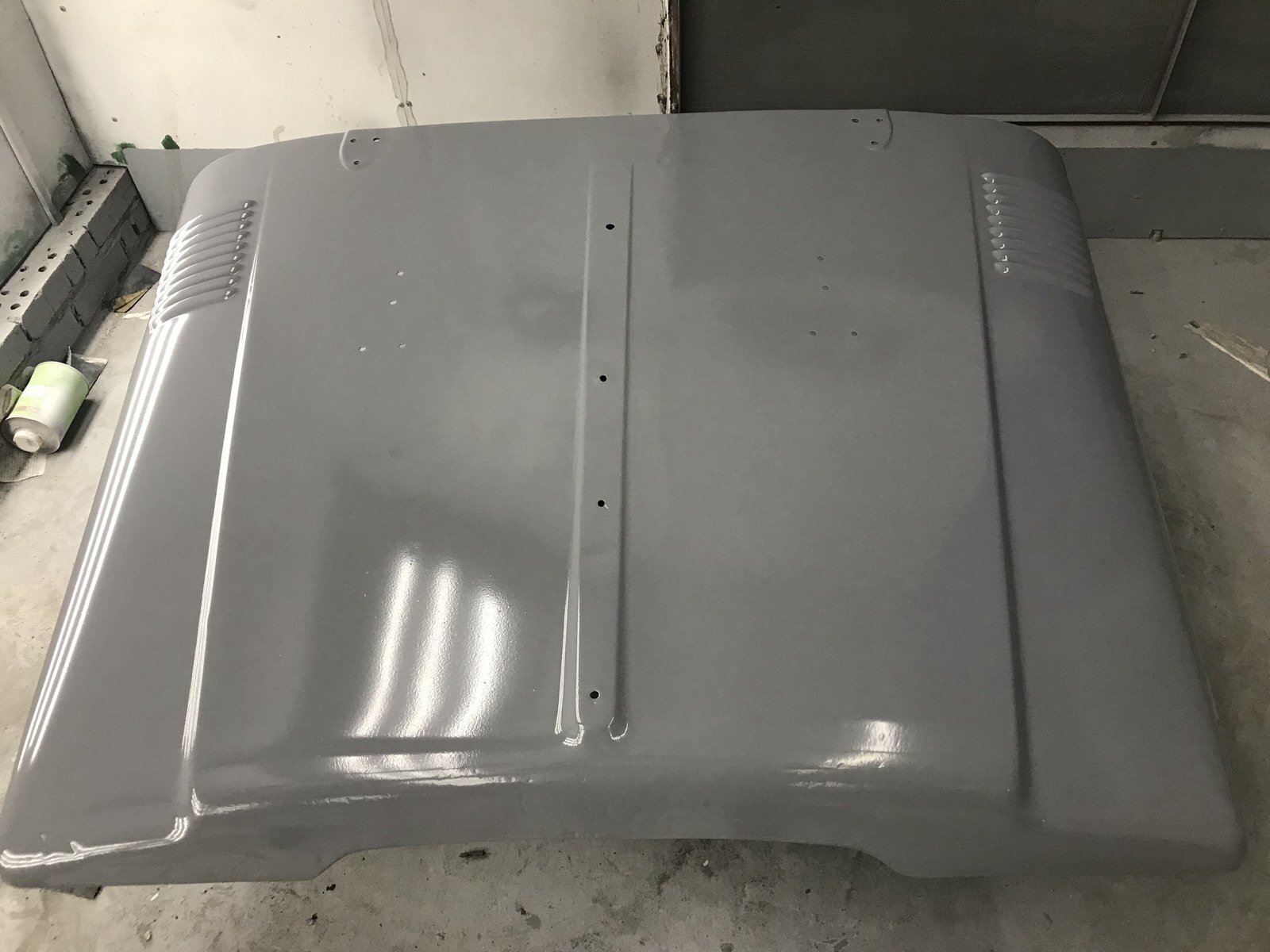

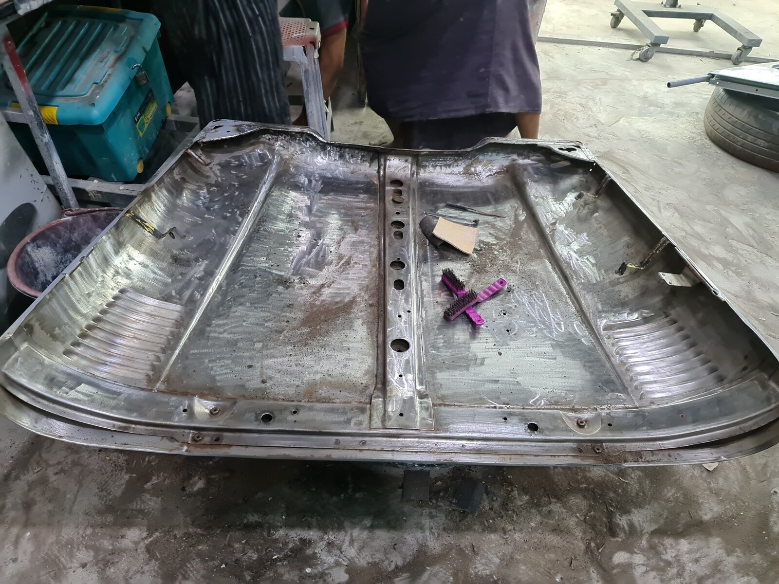

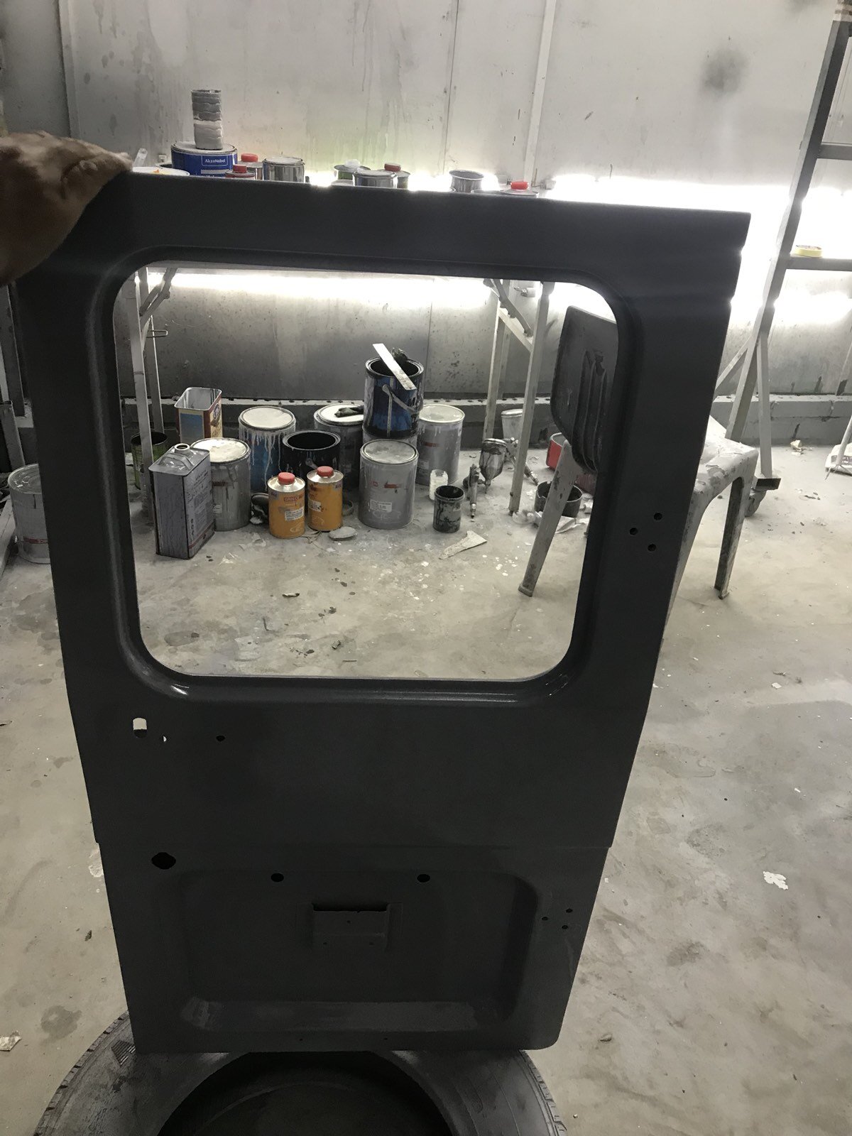

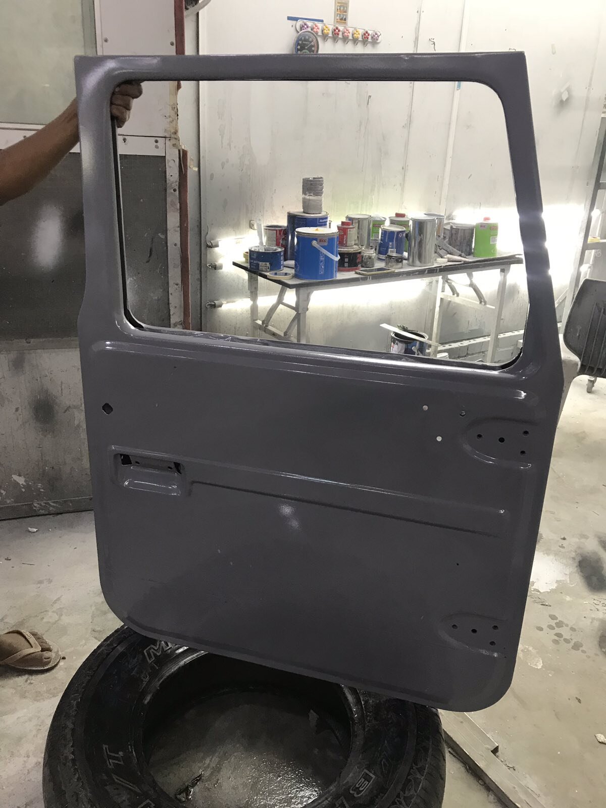

Progress despite the COVID lock-down we have. People work from home also here, but the guys doing the work live on the same street and doing car restoration from home is not so easy....
Now doing priming of doors, bonnet and other parts.

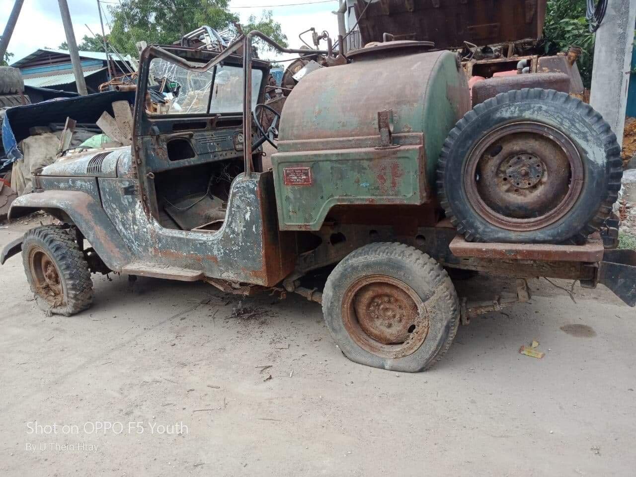

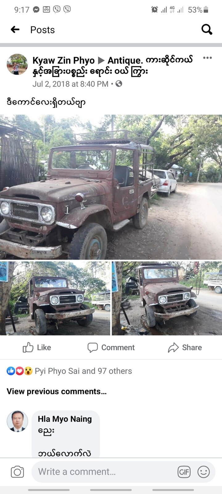

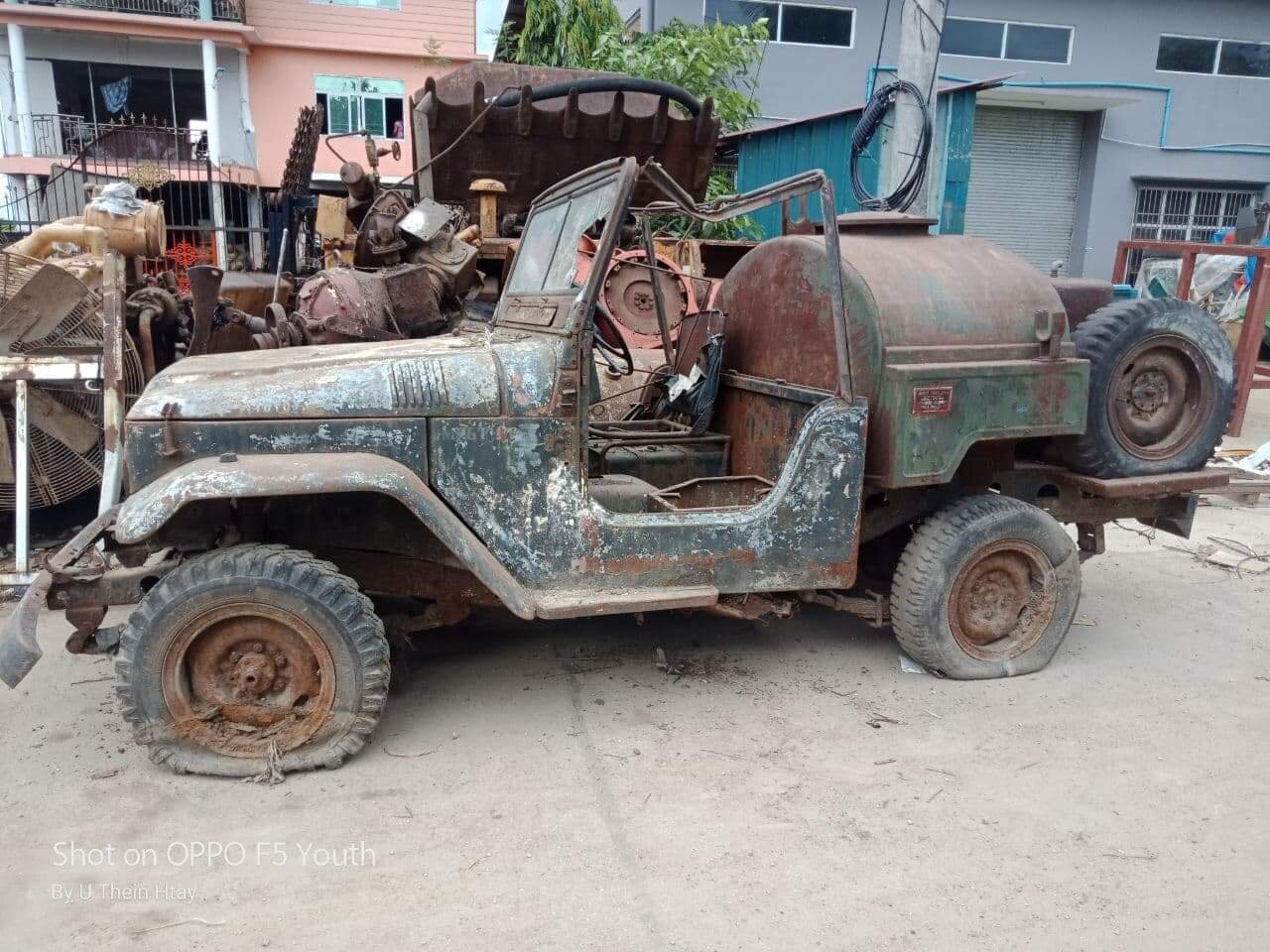

Another couple of Landcruisers in need of some TLC. Owner asking 850 USD for the one on the Facebook picture.
The other one with the funny tank at the back a couple of hundred USD.

IMO the one with the tank on the back started life as an early factory soft top, going from the shape of the rear of the door opening. Quite rare I would think but undoubtedly a lot of work needed but the price is right.

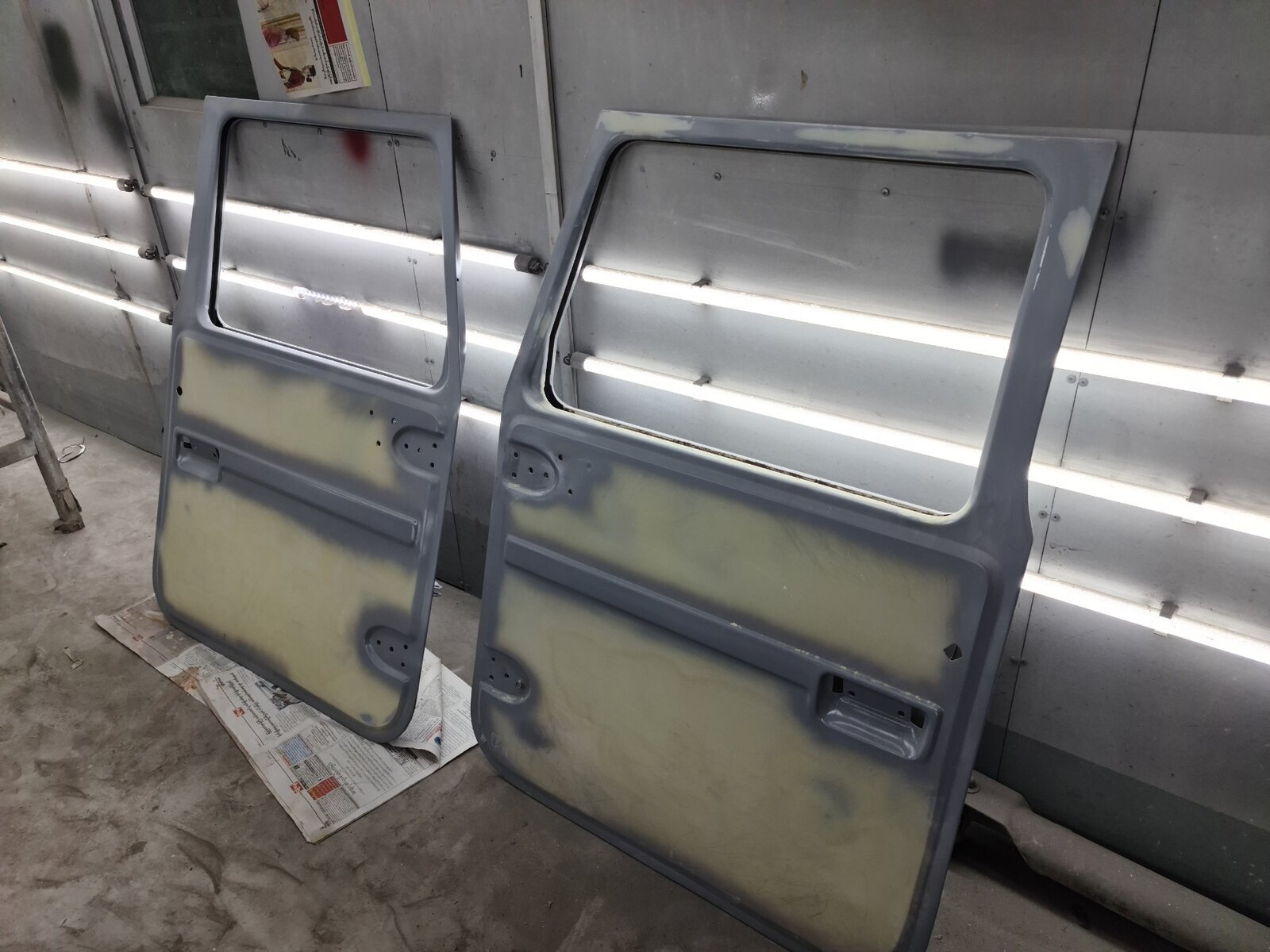

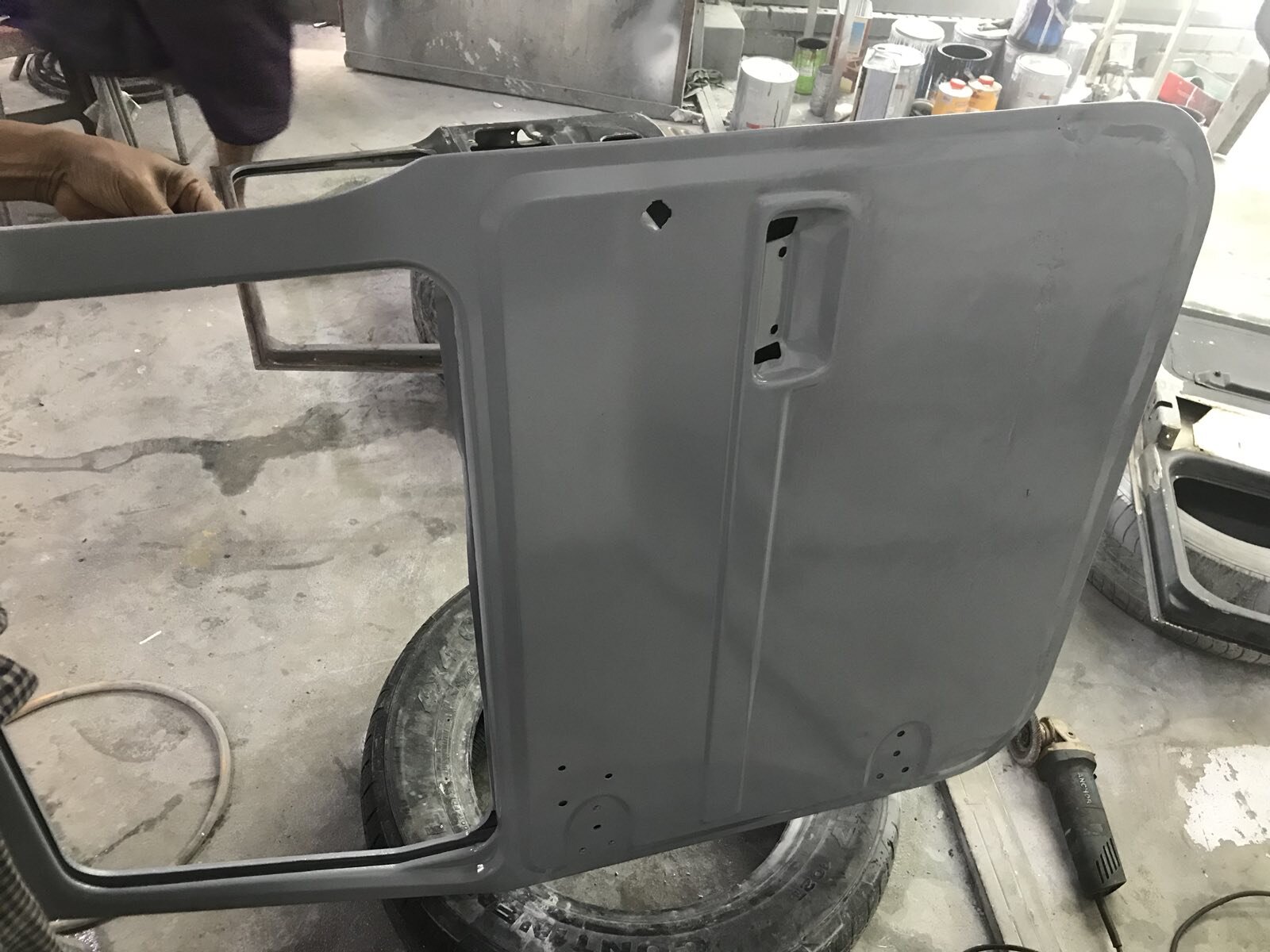

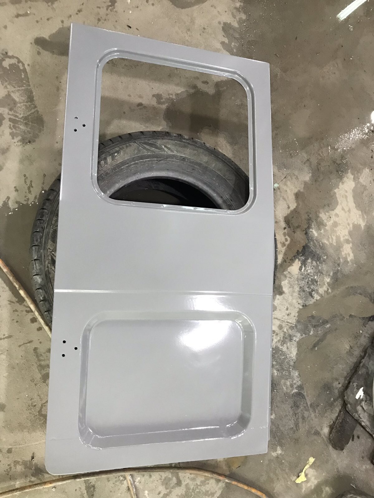

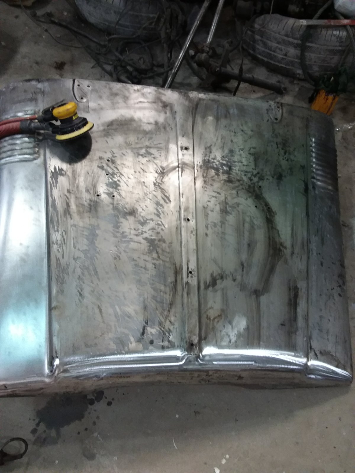

They don't intend to use any putty, but say that high sold epoxy paint and primer surfacer can fix the damples.
Yes that's good. The less bondo/filler/putty that is used the better.
Quality high build epoxy primer is good stuff.

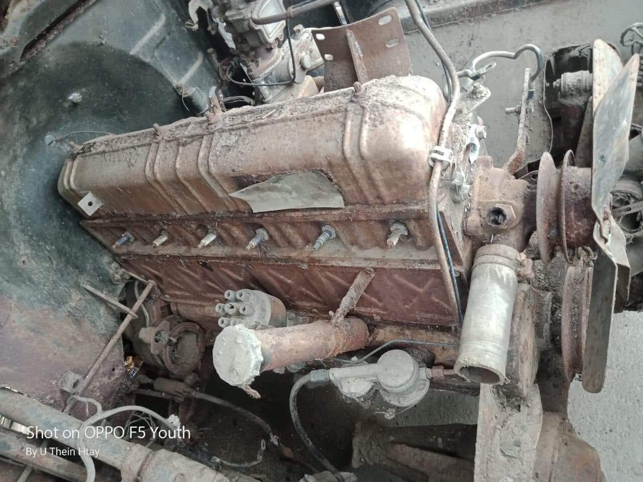

The B engine runs like clockwork, but not much power there. Should I consider to put something more powerful inside ?
Or put back in the 2B engine that I have found with previous owner. This one can handle a turbo, which the B engine cannot I think.
IIRC you said the B runs well and reliably whereas your 2B was a bit up and down. There is only 8bhp and 10ft lbs more in the 2B. I cannot comment on the merits of either with a turbo because I have never had one as my 40 has a 2H.
