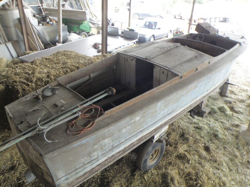

Mate that sounds a very nice life just let me know if you want to swap! Not sure what your knowledge is like on classic USA boats but have you heard of Garwood? Anyway I found one a few years ago in a barn its from 1928 and was even used in the war. It needs everything doing to her maybe one day I will do a full restoration of sell her to a collector

the trailer it is on is an WW2 anti aircraft Bofor gun carriage, but more interestingly than that the 93 year old guy I purchased it from said it was used in operation Dynamo, I have not checked but apparently in the British Maritime Museum there is a special list that names the 700 private boats that took part in saving the British troops of the Dunkirk beaches.
I was wondering if that was the operation the boat was used in. I would like to share the boat and it's story with my friend. JLP

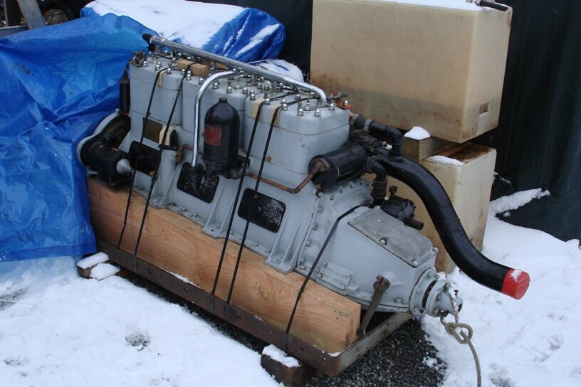

yeh would love to see her restored but not sure my pockets are that deep. I have got the engine and its pretty much restored, its a 208hp Scripps 6cylinder twin spark.

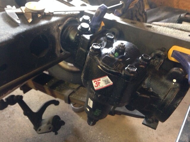

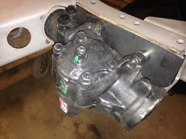

Body shop has made progress on the body prep. We are fitting the seats, seat belts etc... to make sure all the right holes are in all the right places and patching all holes for past roll bars etc... The frame will be ready for welding up the brackets for the power steering upgrade this holiday weekend then off to powder coat. I purchased a sand blast cabinet tonight and will finish up on all the small drive train parts this weekend. It is going to be a FJ40 holiday weekend. Pics to follow!
Power Steering mock up using mounting kit from Cruiser Outfitters utilizing the GM Saganaw steering box and pump.

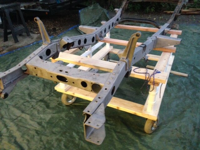

Built rolling stand for the frame. A little more blasting and it is off to powder coat.

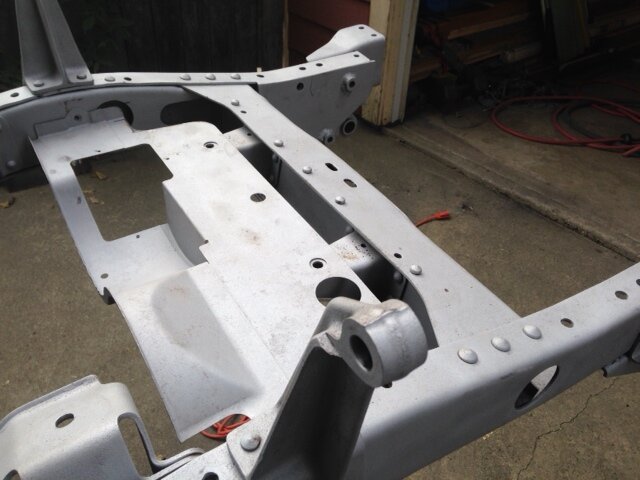

Finished sandblasting frame, mock up complete for the power steering upgrade. To the body shop tomorrow for the welding of the mounting plates then touch up the sandblasting and off to powder coat.

While waiting for the frame to be powder coated I have been sandblasting the front drive line parts and painting them. I have ordered parts to rebuild the front brakes should be here tomorrow. It will all come together..... I will try and post some more pics soon.

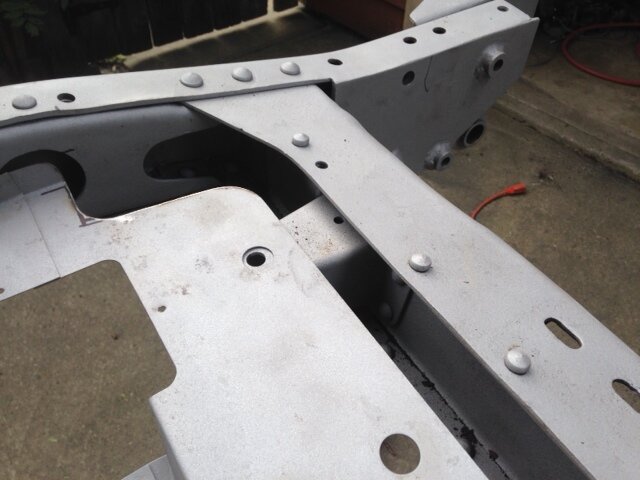

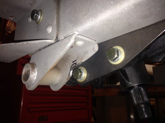

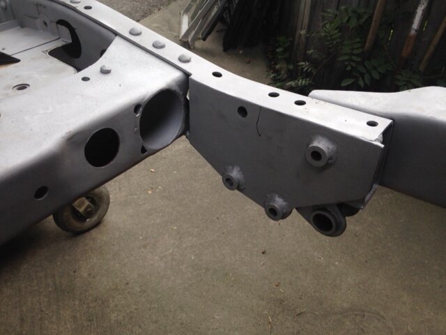

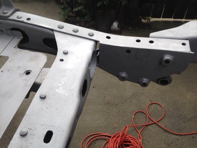

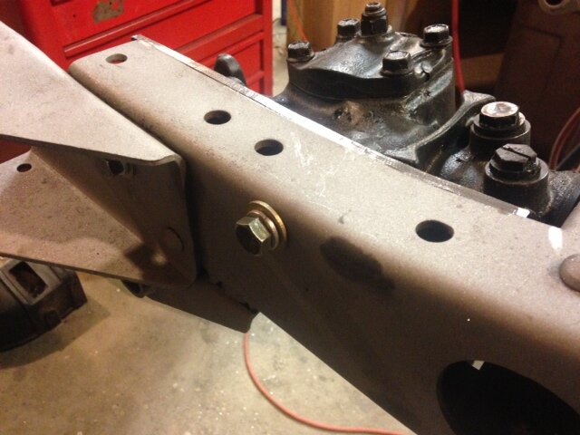

Final details and ready to go to powder coat!
It has taken more time than expected, as usual,:icon-wink: to get the FJ40 frame ready for powder coat. The final stages were getting the power steering upgrade brackets and tubes welded to the frame, grinding and re-blasting those areas and then mocking up the steering shaft so as to allow for modification of the front pan. Most of the upgrades that I have seen do not use the pan but I wanted to keep it so modifications were necessary. It is scheduled to go to powder coat on Tuesday. I have completed the rebuild and painting of the front axle assembly and will start on the rear later today. I hope to be ready to start re-assembly of the drive line first week of October.:think:
