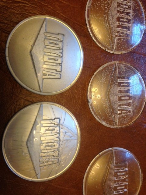

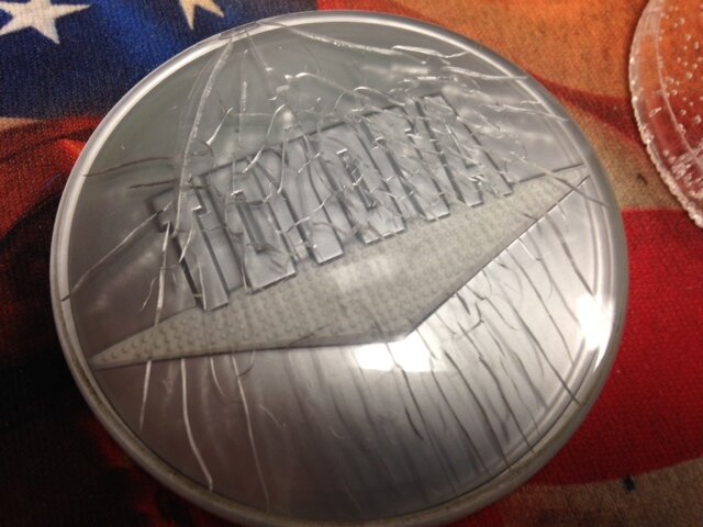

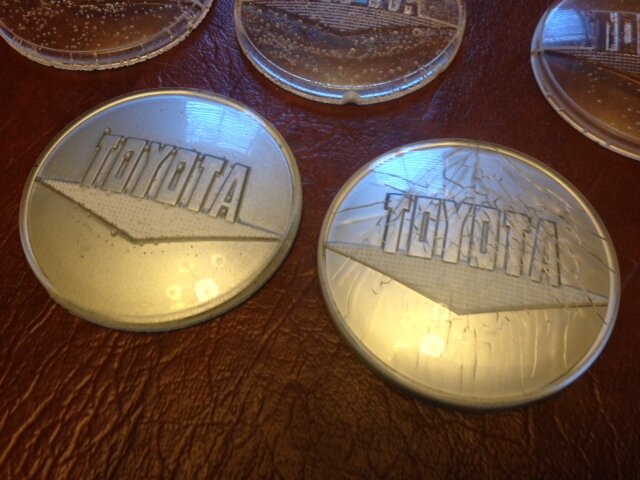

This is my starting point. I will cast my mold from this original part. It is in good condition with the exception of the crazing of the plastic.
Won't the crazing reflect through to the mold?
You sound like you know what to do, but I'm interested to know too...:icon-biggrin:
The crazing can only be felt with your finger nail in a couple of places. The fix will be to cast one part then polish any imperfections then make a new mold. This will end up being a defect free mold for future casting and the first part will also be usable once polished.
First test part cast!
I have cast the first test part. The mold is great and the part is great with all of the fine detail.:thumbup: I will have to buff the reproductions out or buff one out and make a new mold due to some slight transfer of the crazing. The next step is to build a vacuum chamber that creates a minimum of 29" of vacuum.:icon-surprised:This will make the part crystal clear with no air bubbles.:clap:
This is the original and then the test cast.

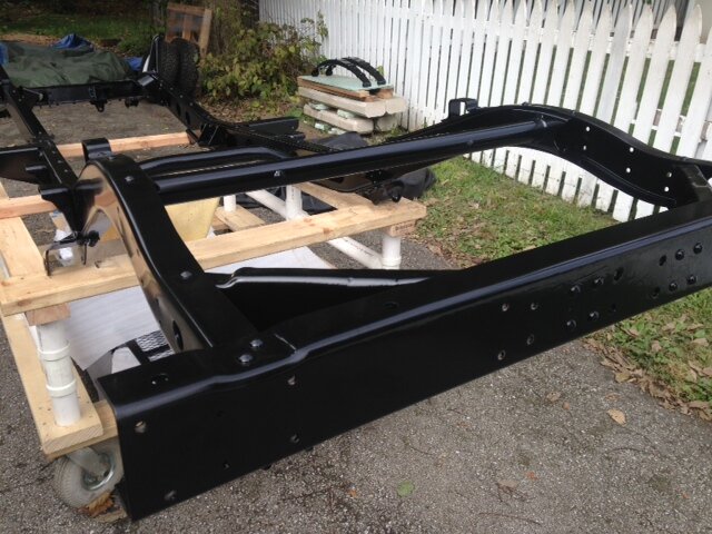

Frame back from powder coat!
I just picked up the frame and parts from powder coat.:cool: I am as giddy as a 16 year old seeing their first car! I will post photos soon.:greetings-clapping:

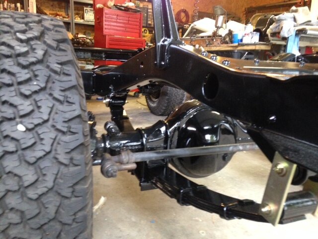

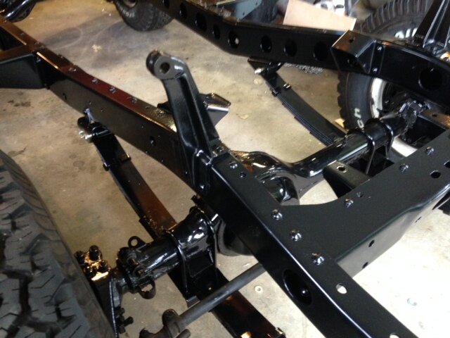

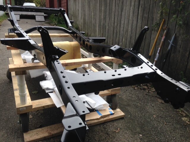

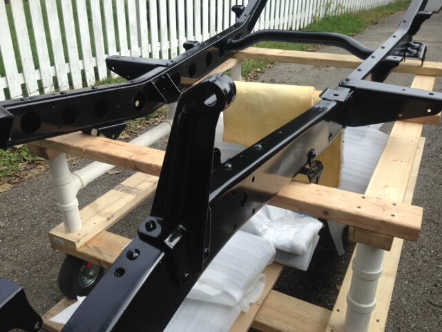

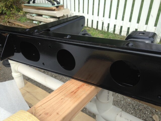

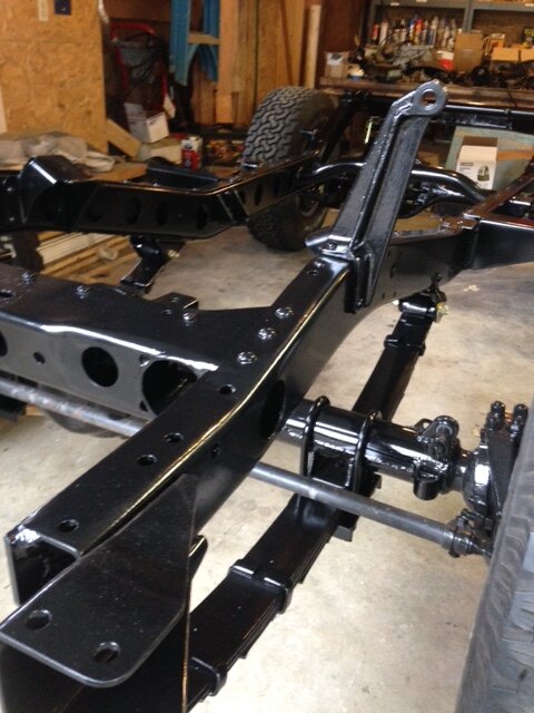

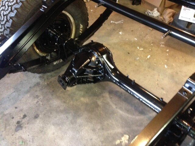

Photos of the powder coated frame!
Here are a few photos of the frame back from powder coat.:happy-jumpyellow: I just finished blasting and painting the rear differential and springs (soaked on the black gloss paint). Will start assembly tomorrow, back to a roller!:eusa-whistle:

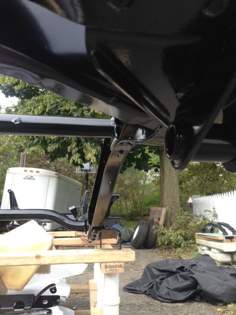

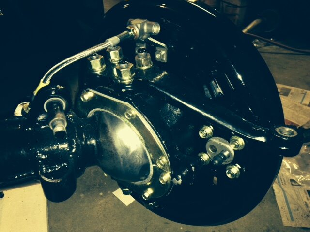

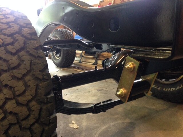

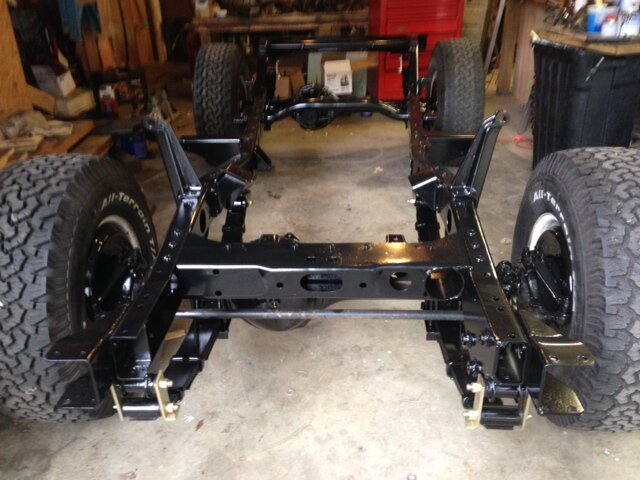

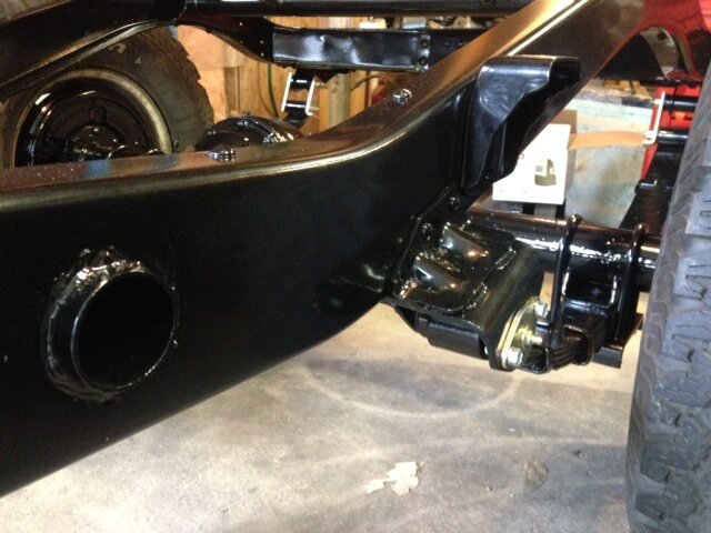

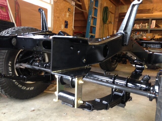

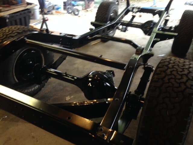

It's a roller again!
Good day today, had the day off and was able to get the springs and axles back under the frame today.:crazy: All new bushings and new shackles and pins with grease zerts.:icon-cool: Engine in by end of week???:eusa-whistle:
image (2).jpegimage (3).jpegimage (4).jpegimage (5).jpegimage (6).jpegimage (7).jpegimage (8).jpegimage (9).jpegimage.jpeg
As you can see in the pics I have not restored the tie rod yet. I did not want the front end flopping around. I will order the ends and new tie rod and pitman arm once the engine is in the frame down on the suspension.

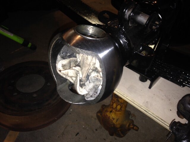

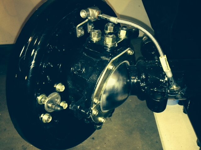

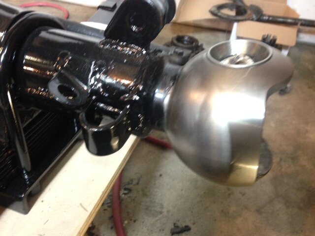

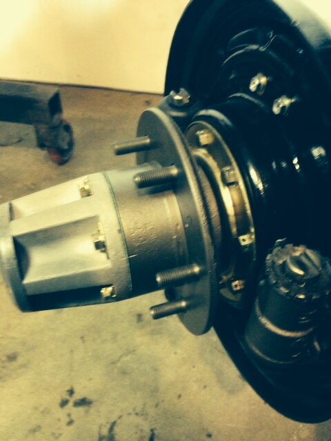

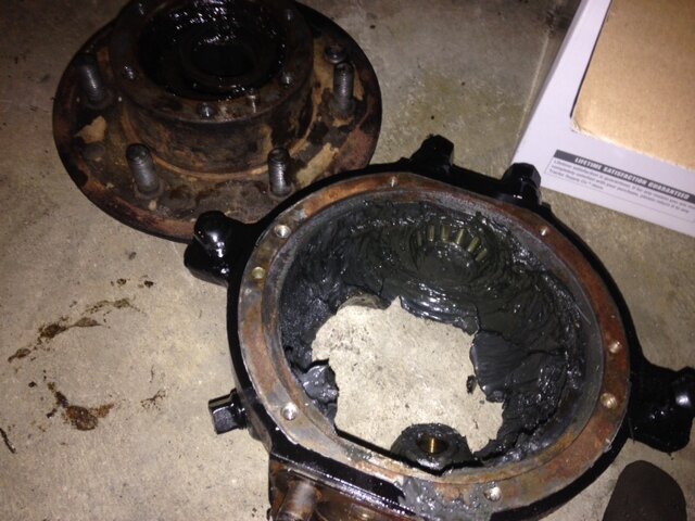

Rebuild of front axle knuckles and locking hubs.
Now that the axles are back on the frame I disassembled the right front axle knuckle and locking hubs. Ordered rebuild kits for both the hubs and knuckles. Ordered all of the brake rebuild kits, brake lines, stainless hard lines and stainless hoses for brakes and clutch. Ordered all new grommets for the fire wall.

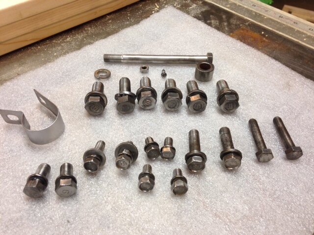

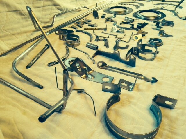

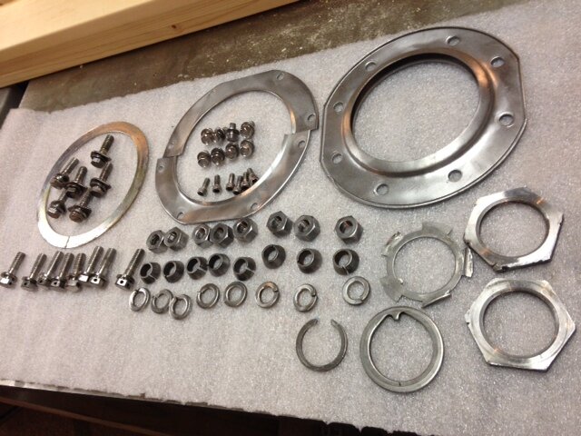

Zinc Plating!
Started the long and time consuming process of wire brushing all of the nuts, bolts, brackets, etc... for zinc plating.:shock: This will take at least a week if not two.:pray: Then off to the plating company. Here are some of the parts readied today!

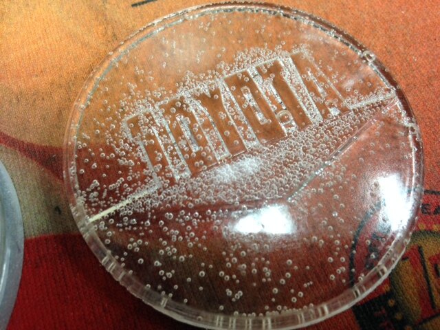

Progress on the Horn Button reproduction!
Not the final product but this is my first example after using the degassing chamber. Still a few air bubbles but I went ahead and painted it to give a good idea of the progress to date on this project. You can see casting by casting the improvement.:icon-wink:

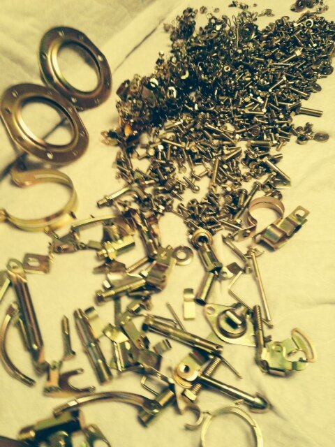

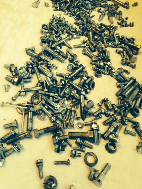

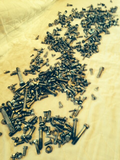

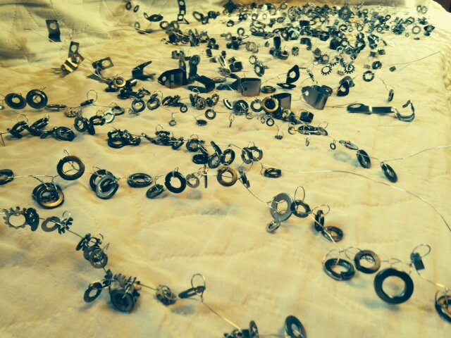

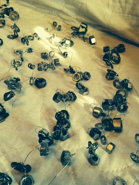

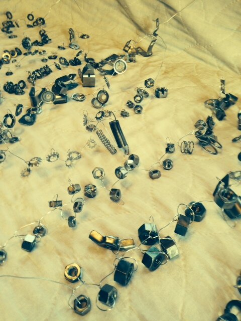

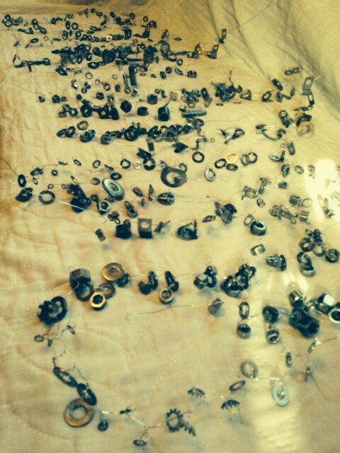

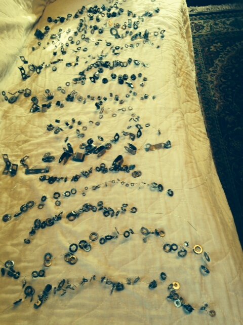

Nuts, bolts, washers, fuel lines, and brackets!
Here are 90%+ of all nuts, bolts, brackets, fuel lines etc... media blasted, wire brushed and ready for zinc plating. I am glad to almost be done with this chore but well worth the effort. All small parts daisy chained with wire to keep them from getting lost in the platting process.
image (3).jpegimage (4).jpegimage (5).jpegimage (6).jpegimage (7).jpegimage (8).jpegimage (9).jpegimage (10).jpegimage (11).jpeg

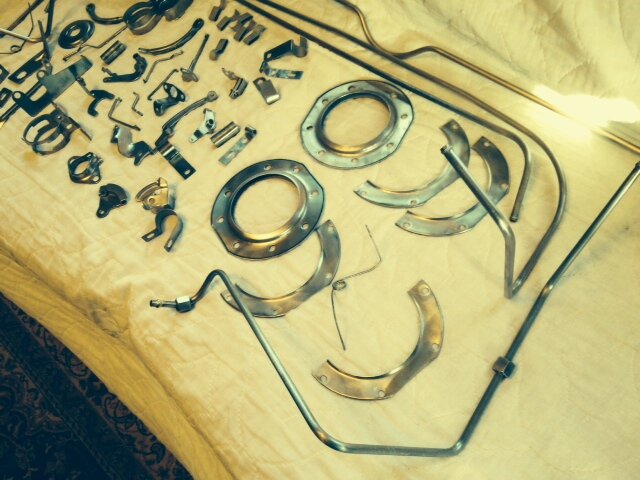

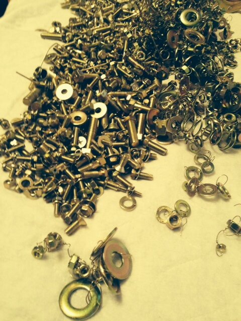

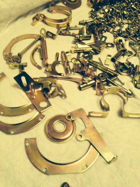

Back from plating, now sorting time.
The plating company completed the job in just one day!;) Now it is time to cut the daisy chains and sort all of the brackets and fasteners. I picked up a can of plasti-dip for the frame rail fuel line, wiring, and brake line brackets. Great look to have the fresh yellow zinc with black plasti-dip on the tube end of the bracket. I will post some photos tomorrow. But for now here are the parts just back from plating.
