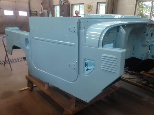

I probably have over 200 hours in the blasting and brushing of the nuts, bolts, brackets and washers. The acid step is bypassed by my processor if I bring them in prepped the way I prep them. I have found that they come back with a extremely smooth finish thus less opportunity for corrosion. Maybe waste of my time but my vendor said that time up front makes for a much nicer outcome. I dropped off the remaining parts for powder coat this morning. I switched to powder coat on the headlight bucket parts rather than the original yellow zinc. I believe that this will hold up much better. I did find a place to rebuild the brake booster once I get it back for plating. Hopefully it will start coming together in the next few weeks if the finances hold up. The smalls are killing me. I have been selling off all of my extra Datsun parts on ebay the past couple of weeks 2K so far toward this project. I plan to list a few of my, already accumulated, extra FJ parts in my next run at ebay. I started blasting and priming all of the pewter interior parts and outside mirror brackets last night. Probably put some paint on this evening. Thanks for your interest in this project. JLP
