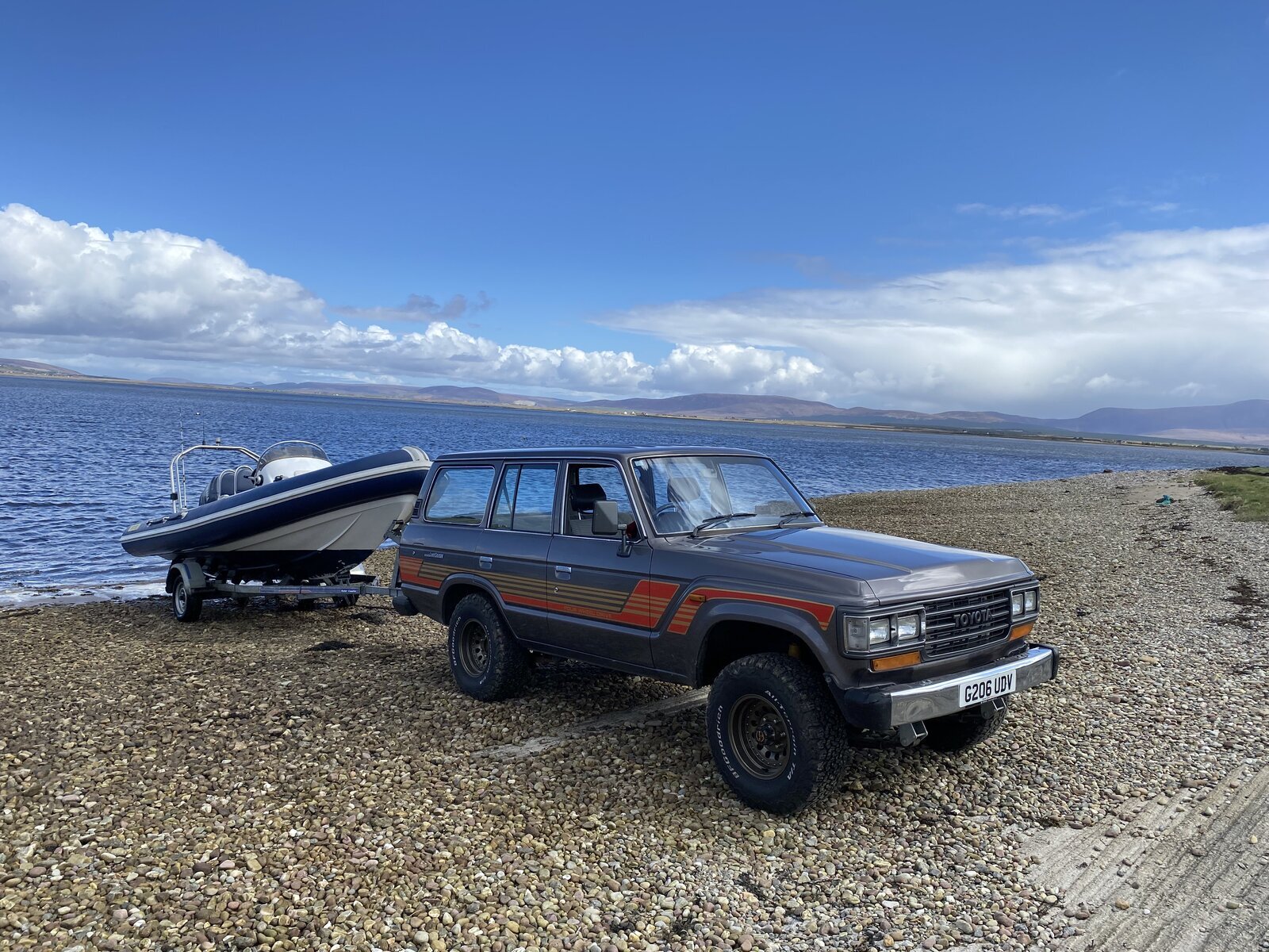

Yogi my brother in law lives near Kells , I have a place near Belmullett and am regularly over with the 60
I used to hunt with the County Meath Foxhounds, Kells is about an hour away from me! Belmullet is lovely
Yogi it’s wild when the wind and rain hit land coming across the Atlantic

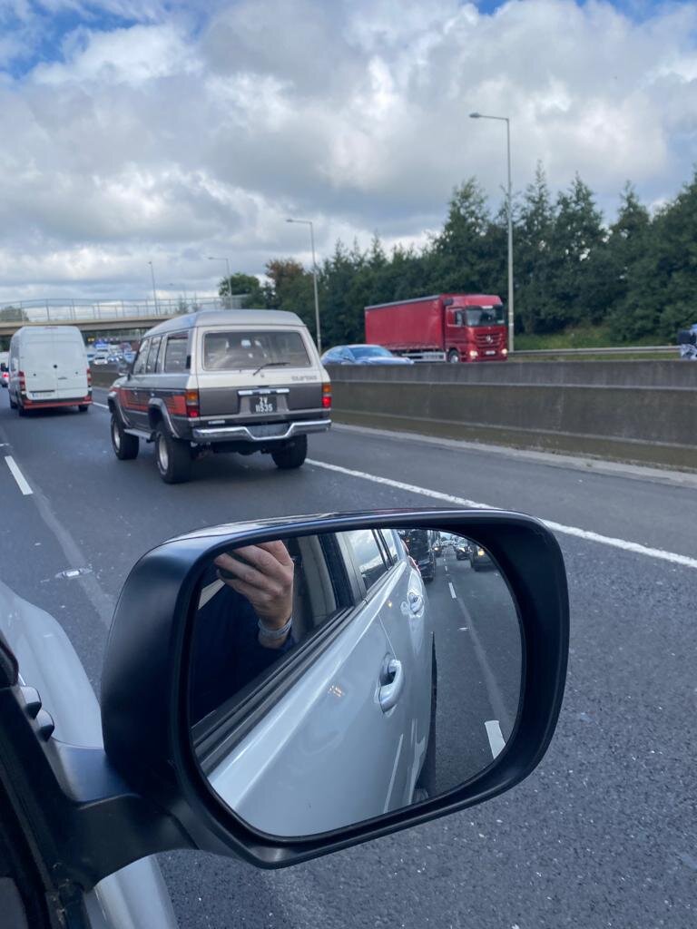

A mate of mine saw one the M50 the other day. Looked great. I'll try put up a pic.
