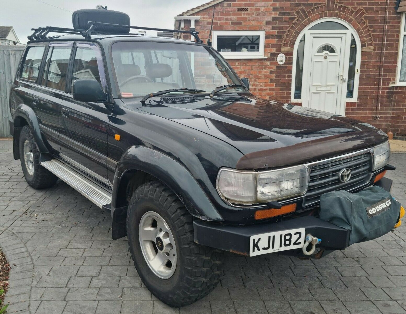

To allow me to lay up my 4.2 TD80 for a while, I picked up a 4.5L 24v petrol LC80 last week (189,000 miles - Jan 97 Reg) - generally it is in acceptable condition for its age and seems to be running fine. I am more than happy with the price I paid for it - none of this nonsense that seems to be happening on ebay right now. It has a fantastic service history, the LPG works faultlessly (which even has an inspection certificate!) and a few goodies (TDS winch, steel bumpers, Goodies KM2 etc). It is like comparing night and day regarding the driving experience and handling of my "offroading" diesel manual and this "roadgoing" version.
Of course there a few niggles to set aside, the rear diff lock does not work (the front one does) - I will investigate further when the centre diff lock switch arrives to give me proper selection in high and low. Some body work cosmetics bits of minor trim damage repair and a dam good clean needed. The biggest work I have currently spotted by far is the front swivels needs some work as they are leaking like a Land Rover (the epoxy resin paint I added 10 years ago to my diesel is still going strong and leak free, so I will be repeating the process).
Fitted a new double din radio - something almost wrong with apple carplay/android auto with DAB radio in a 24 year old motor! During the dash strip down to fit the hands free microphone and DAB radio aerial I came across something that I believe could give me an issue in time to come:
The ignition barrel was replaced recently (old one in the glove box still) but for some reason whoever installed it didn't get the barrel rebuilt and just bought a plain key version and decided to place the 'reluctor'? ring that reads the old keyfob and must unset the alarm? so they have tie wrapped the ring and old key together behind the dash so they are always together. I cant stand such a bodge and would rather remove the ring and key all together - my question to you guys is how involved or difficult is it to remove the factory isolation/alarm all together? I have declared on the insurance it has no alarm, which at the moment is no issue, it is stored very securely. Although I will likely add an aftermarket one when the factory one is removed.

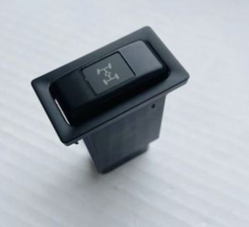

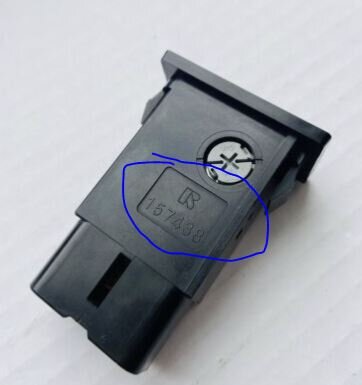

A bit of a win with the centre diff lock mod today - I took a chance on e-bay and ordered the centre diff lock out of a RAV4 SXA1 that was being broken - £15 all in.
It was listed with the number off the moulding on the case - 157438 and not the proper part number (not sure what the moulded number on the case is).
Exactly the same component as the Landcruiser Switch 84725-60040
