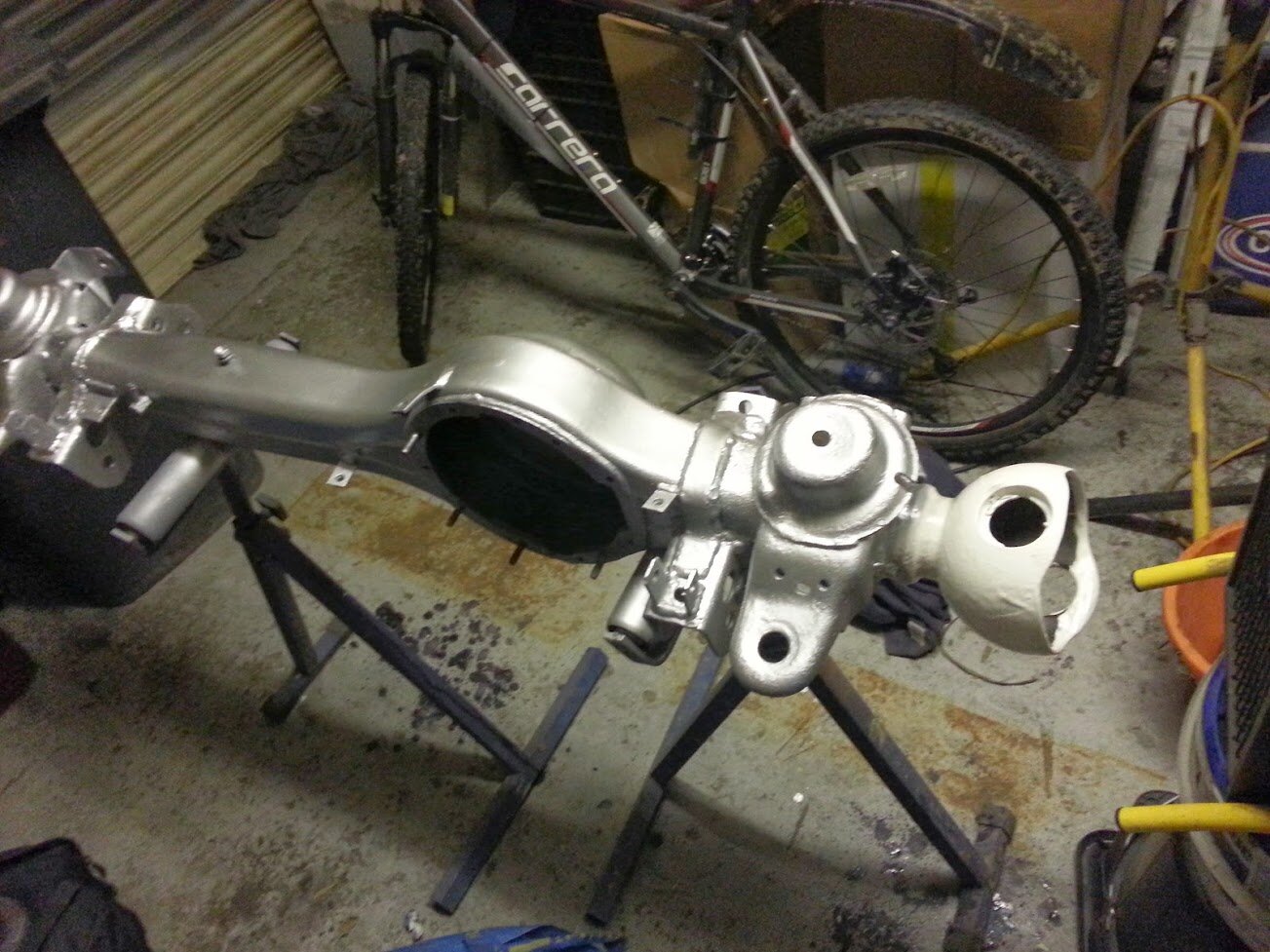

The only image I can find is one in mid-prep before rubbing down and smoothing the epoxy paint (shame it was white!) - took about 8 yrs to become a nice shade of grey....
Its coming back to me now - the axle was off because I tore the radius arm brackets, so I remounted them a little for some castor correction and then re-enforced with some 30x6 flat over the top. It seems to have stood the test of time.

Ah right , epoxy probably work out better as a smoother finish I’m thinking? There is always something to be done!
