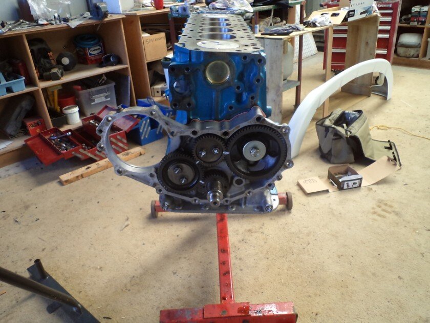

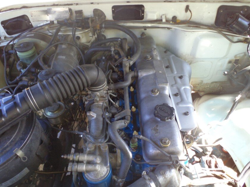

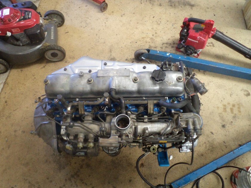

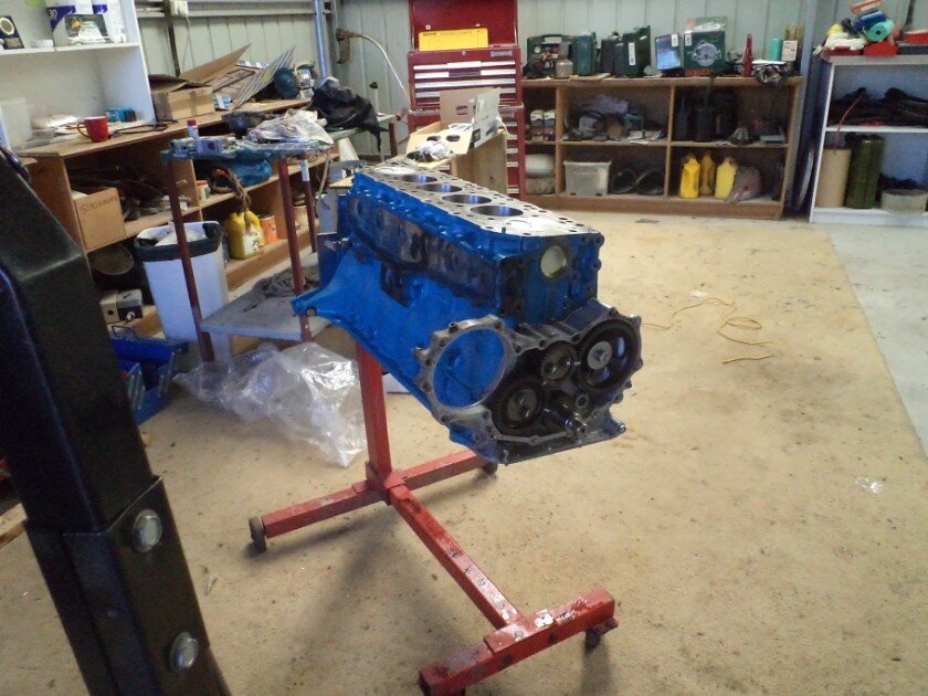

Hi Guys, Just registered here, also registered on mud, thought id join up and have a look at everyone elses rides. Looks like i need 15 posts before i can link my pics :cry:

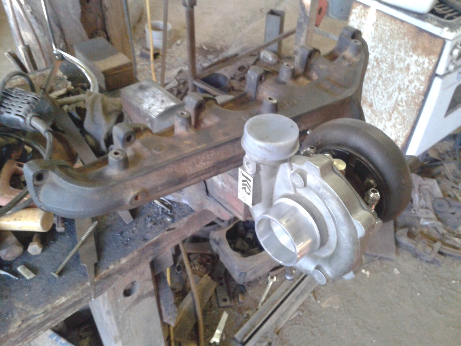

I own a HJ60, which i rebuilt the motor in, just a 2H, which im in the process of turbocharging atm
anyway, I look forward to getting to know you all and checking out some more cruisers
Gareth

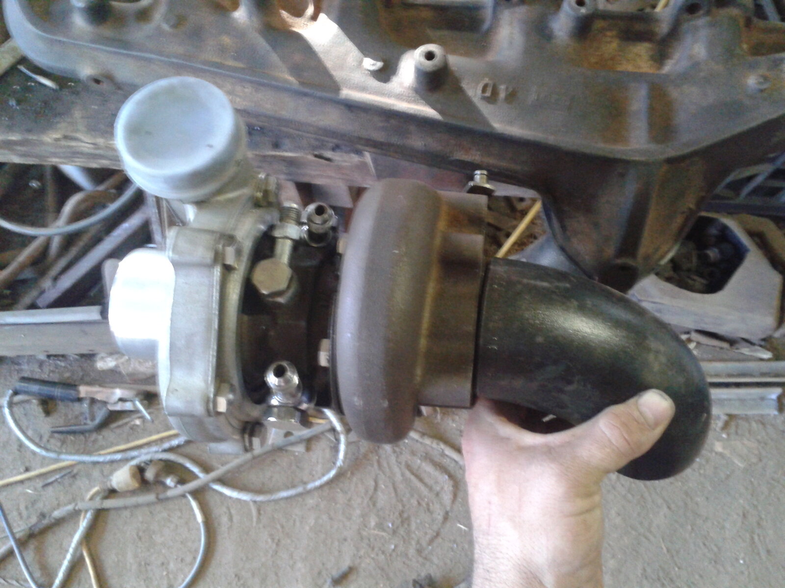

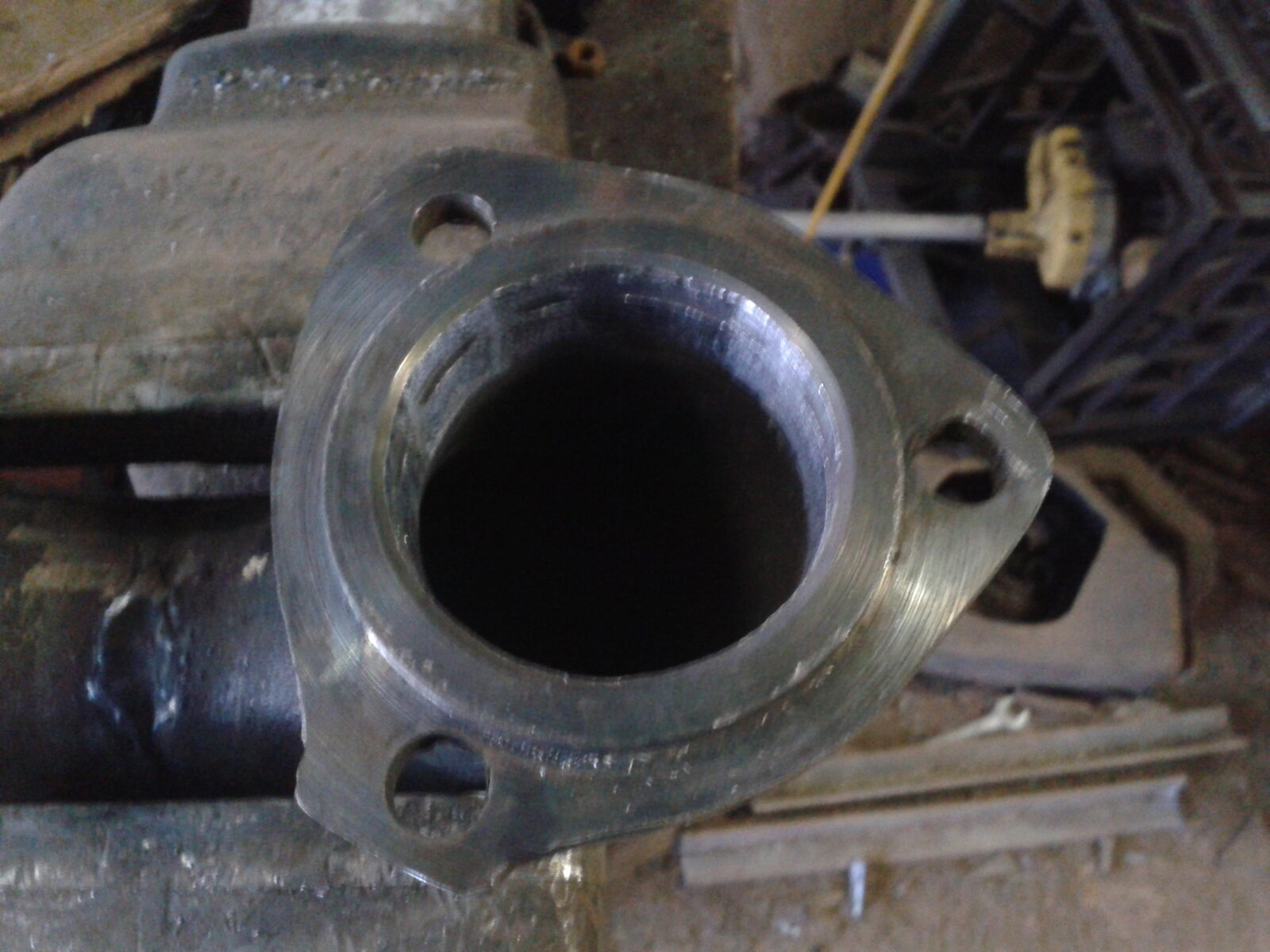

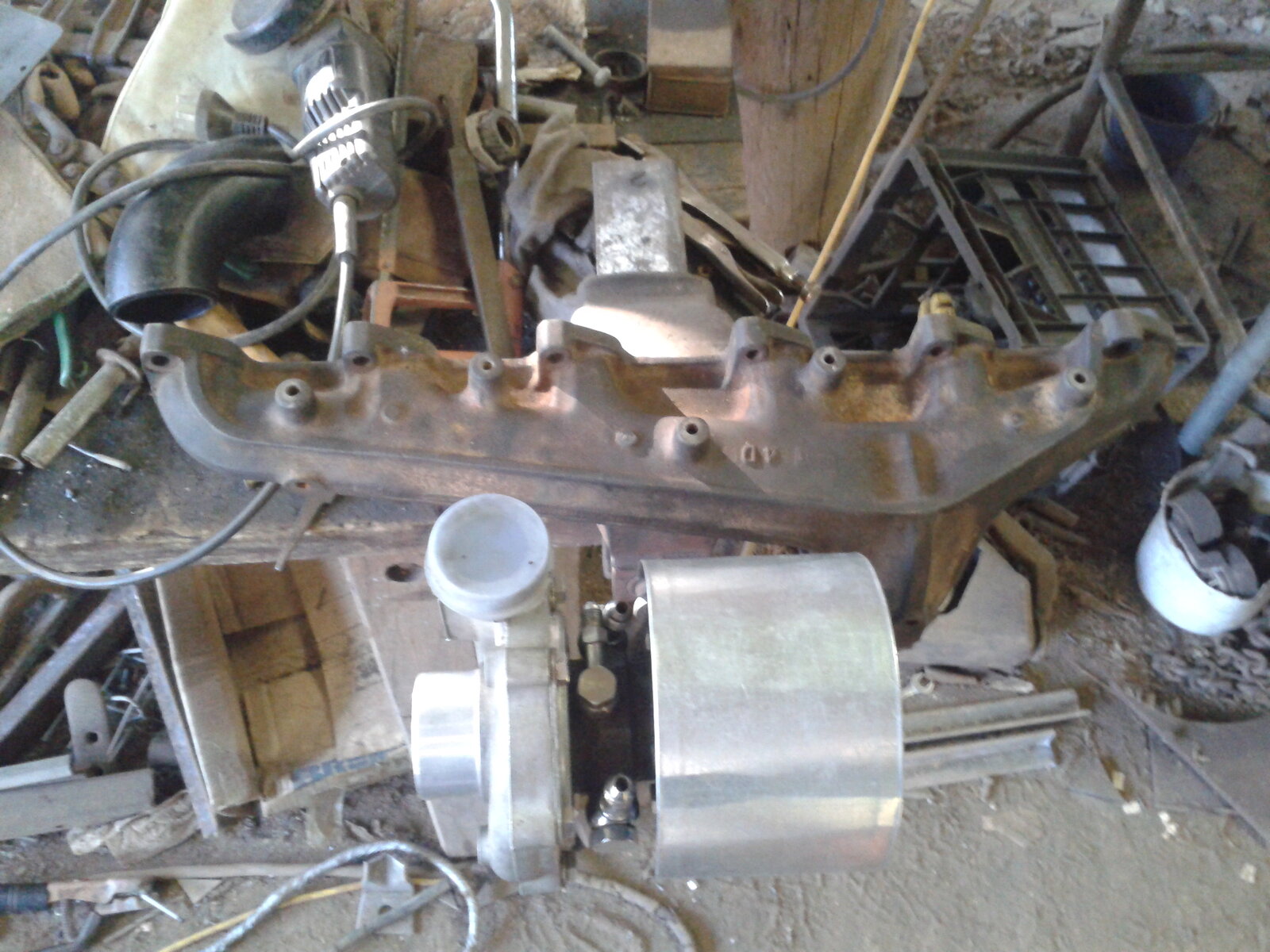

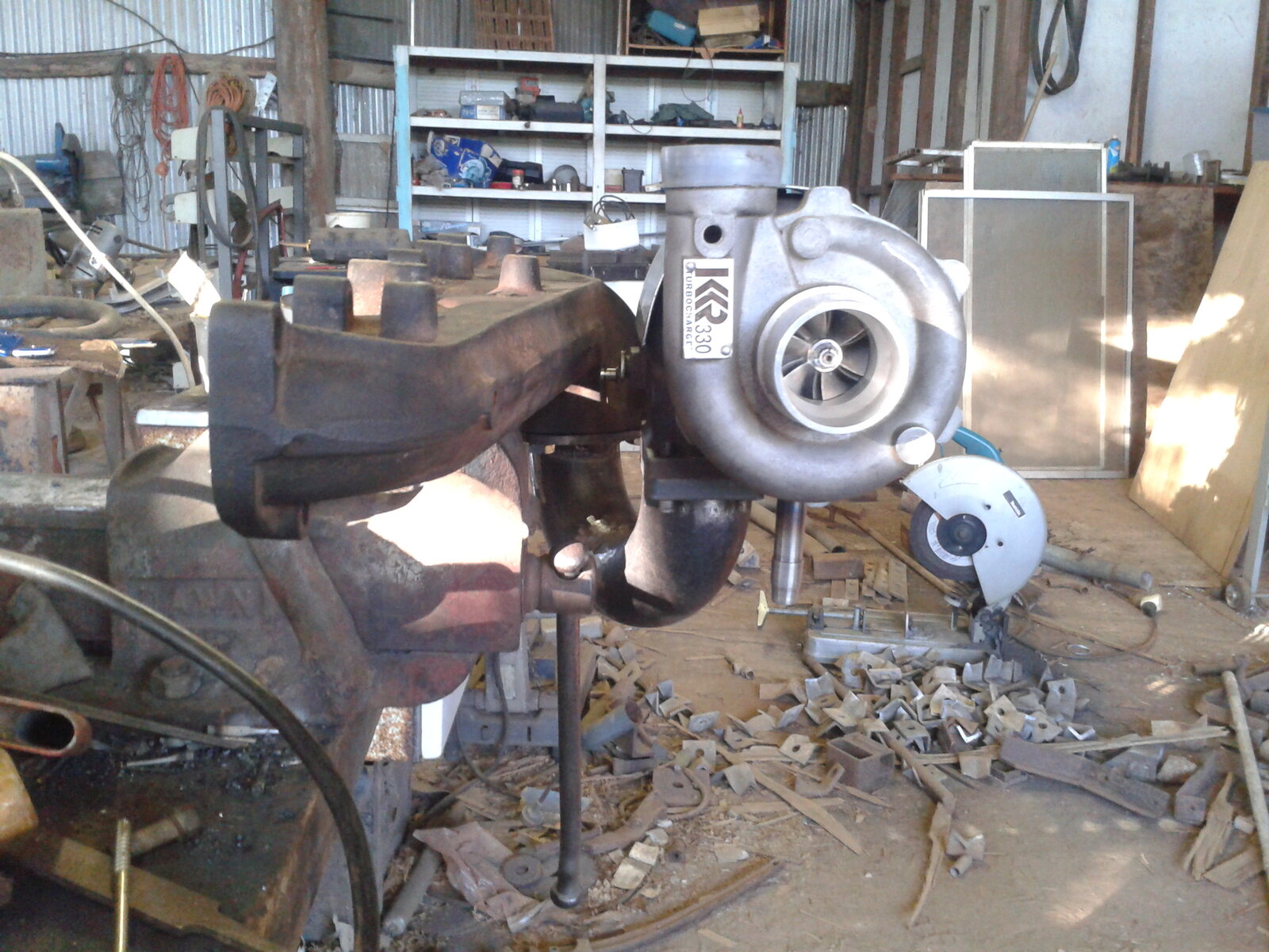

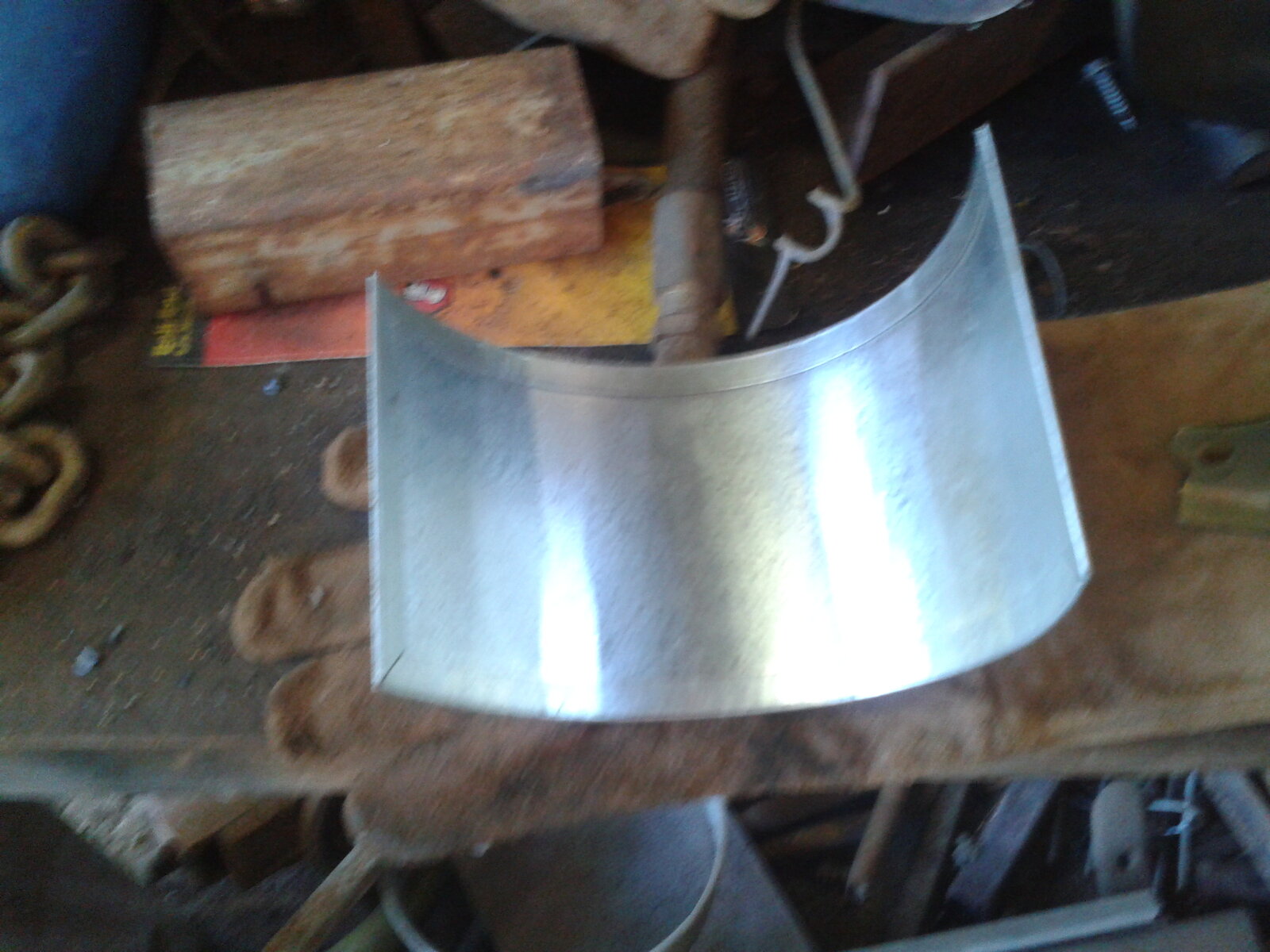

Some pictures....everyone likes pictures:thumbup:

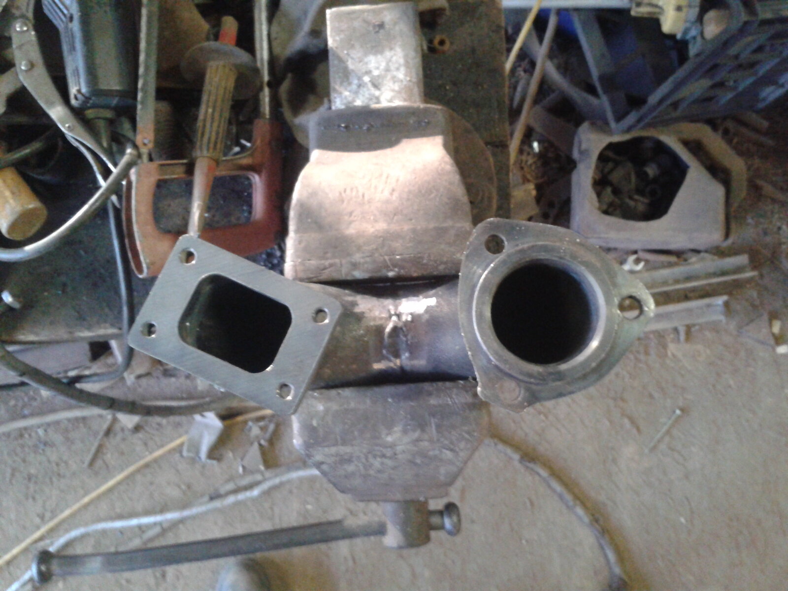

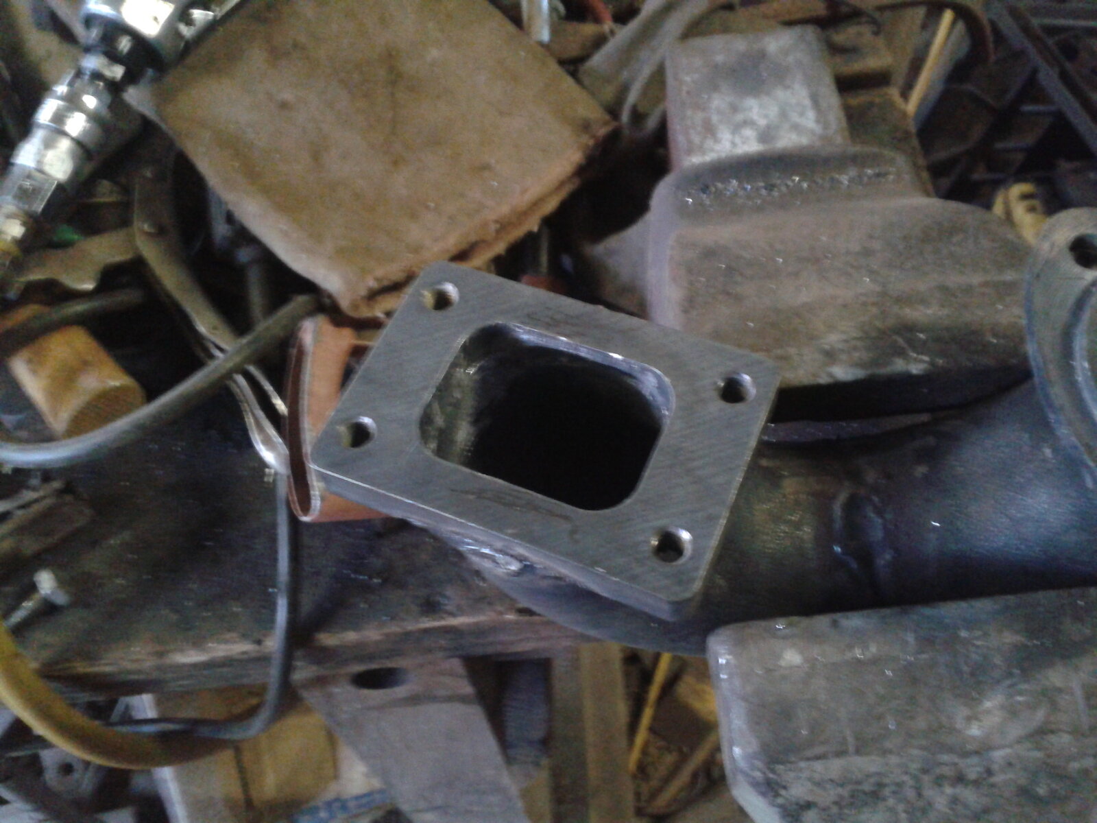

welding up a turbo adapter
Welcome along Gareth - nice to see another 60 on the forum :icon-cool:
:doh:Sorry Gareth, Ignore my post on your intro thread. :doh:
Great pics...
Real nice! Looks like a decent rebuilt on that engine!
So jealous when looking at pics from where you life..... The only part off off-roading where I life will be the side of the road :icon-mad
Good to have new 60 minded members!
Great looking truck
Welcome to a brother 60 owner, truck looks great but the thing I'm really jealous of is the workshop because it's just what I need.
Mike.
