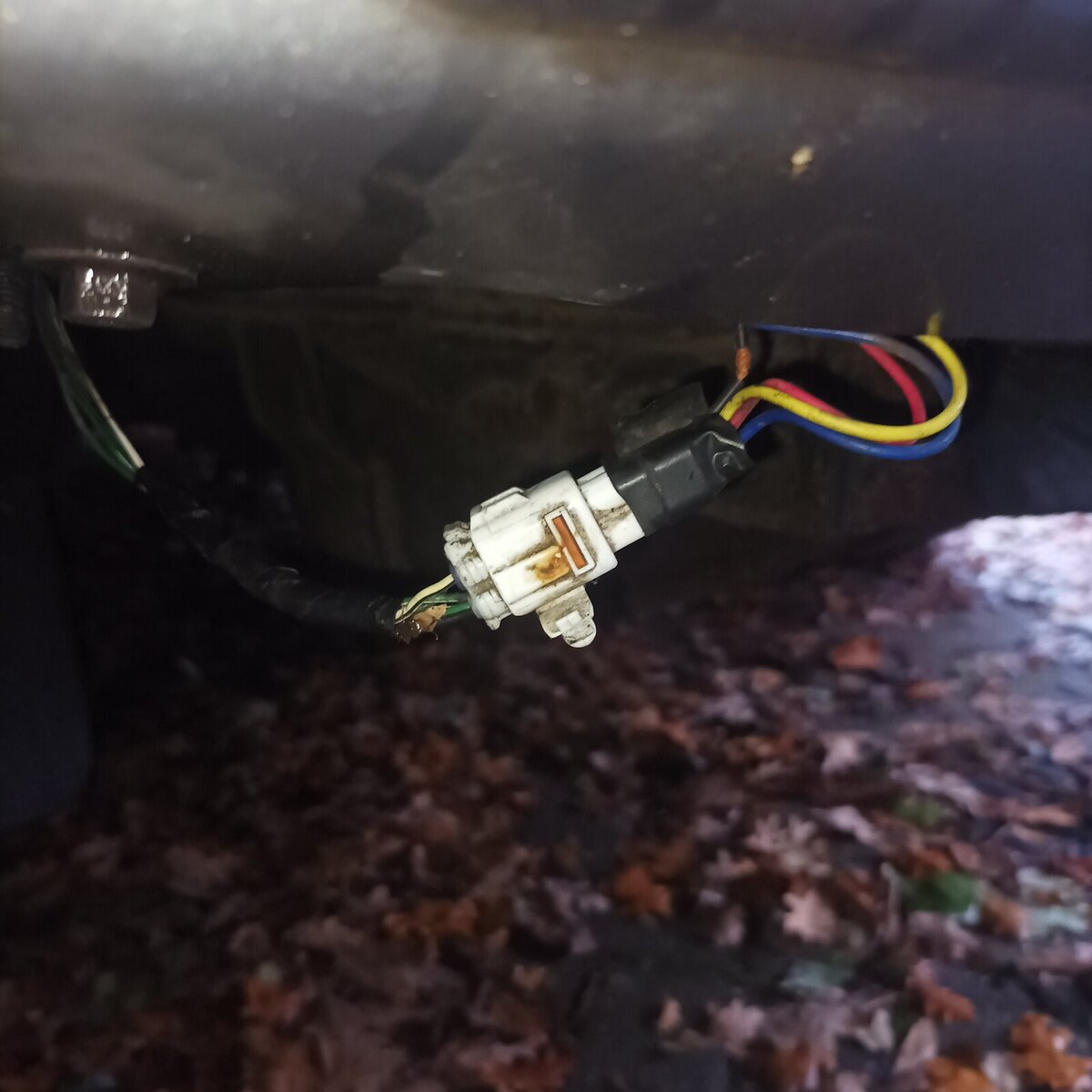

As the title suggests my rear lights in the cluster have stopped working other than the fog light.
The garage I took it to said it's the rear light wiring loom and plastic connectors.
I can't find any anywhere, and I don't really know what I am looking for.
I have taken a picture of what I think I need, if anyone can point me in the right direction please.

The upper rear lights on the body only house the foglight on the right and the reversing light on the left as standard on UK supplied vehicles. The tail/stop/indicators are in the light units mounted in the bumper. Some people modify the upper lights by fitting new lamp holders and bulbs, many threads on here about it if you have a search. The bumper lights are notorious for rotting to bits as they are in the spray from the wheels. Tow bar electrics suffer a similar fate.
I'm not sure about the connector in you photo. The wiring and plug on the left looks like Toyota original equipment but the wiring on the right looks like towbar electrics from the colours. My towbar electrics ran all the way up into the body to the light unit behind where the jack is mounted in its compartment in the boot, I had no external joint. Have a look where the wires go.

As MODVRS,. Towbar electrics are the cause of so many unrelated electrical issues, and the black plastic heatshrink /rubber boot has been poorly done, allowing a funnel effect to dump water straight in the black connector.
