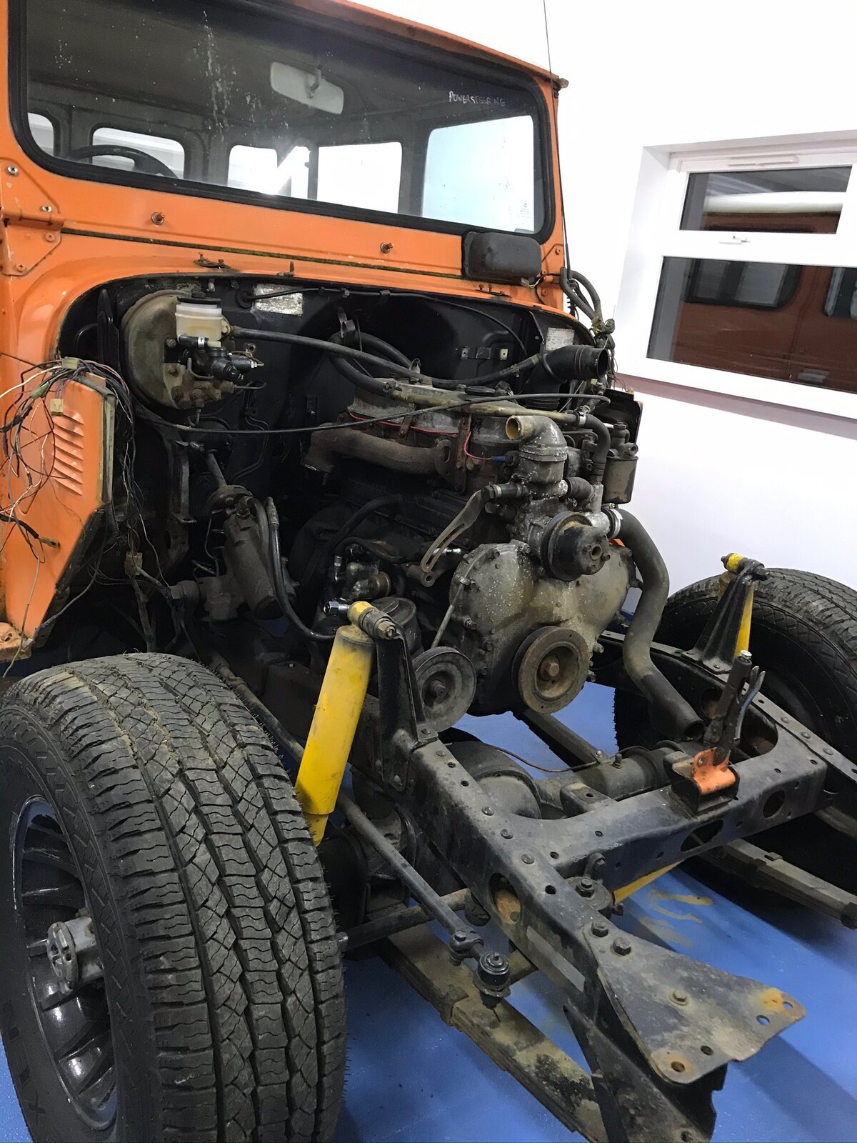

The welded on box section on the axle could this be a jacking point if the diffs are offset would make some sort of sense to stop the vehicle going on the piss especially when loaded tis a thought
Good point that Steve, I will be cutting it off when I’m next working on the axle.

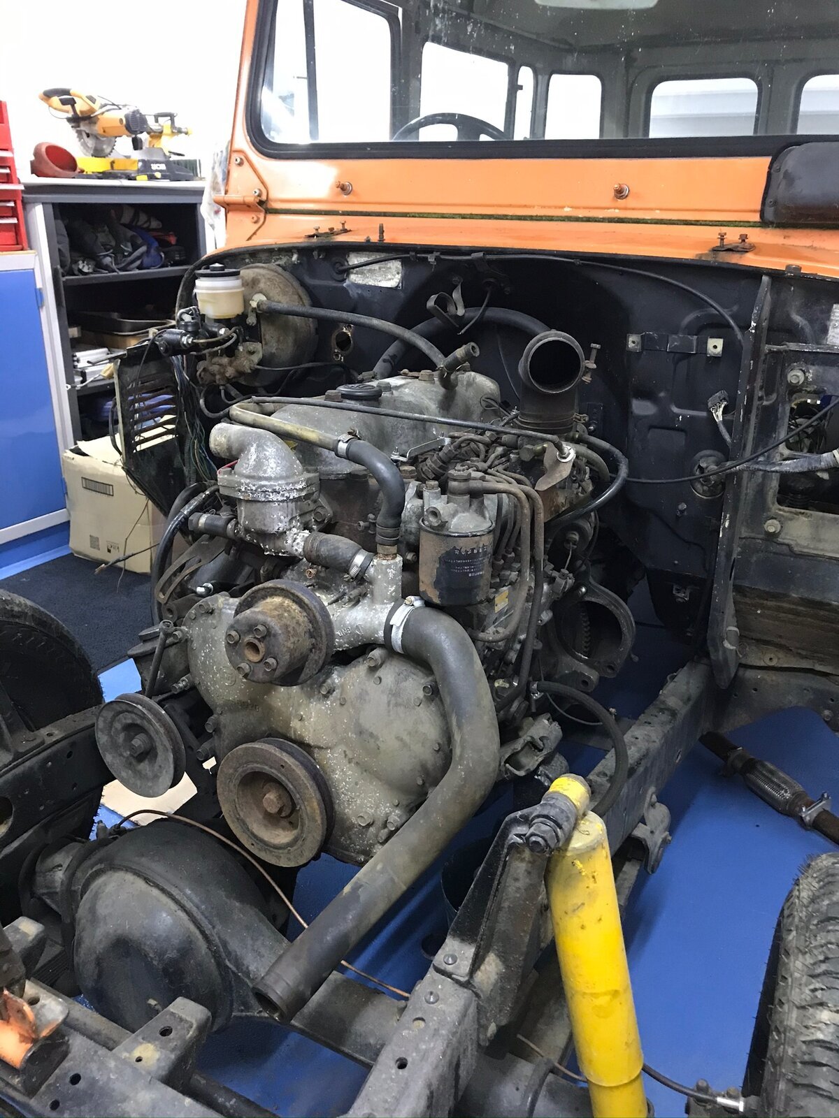

I have looked into the Colorado engine, but the gearbox from the Colorado would cause more work as the front prop exits at the n/s. Mine is a 4 speed gearbox so if the Colorado engine did bolt to my gearbox I feel the 4 speed would be a compromise.
The 3.1 Isuzu trooper engine and box would fit reasonably easy with no Ecu worries , the 3.1 is bulletproof so I have read
The BMW m47 2 litre or m57 3litre, some have 5 speed and some have 6 speed, both have more bhp and torque than I already have and there’s a uk company that make adapter plates from the bmw gearbox to a land rover transfer case, they also adapt the engine ecu to be a stand alone unit, all sounds a little messy.......
I have also looked at the Daihatsu 2.8 turbo, the transfer front exit is on the right hand side and I have read this is also a bulletproof engine,
I thought mine was a 2B, having checked it’s just a B engine, I could freshen it up and have the pump and injectors overhauled and look at fitting a 5 speed gearbox. The B is also bulletproof and will go for ever if a little slow.
Any advice or suggestions appreciated and anyone selling and engine and gearbox give me a shout
Thanks
Darran.

To use the 1kz from a colorado you would need to use a kzj/ lj70 gearbox with the engine. The Daihatsu 2.8td is based on the B engine and there's lots of them around for sale.

Hi, a Colorado engine and a gearbox from a J70 could end up been costly, more than I was looking to spend.
I have also noticed some of the earlier hilux pick ups and surf vehicles have a gearbox that would suit my setup.
I’m thinking the easiest way to do a conversion is to buy a complete vehicle that is been sold as spares or repairs and use the complete engine and gearbox.
We will see......
