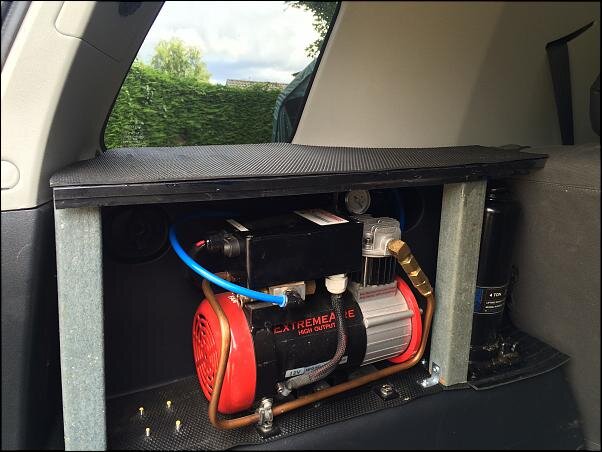

The big thing to look at over brand is duty cycle. Smaller unit typically only have a 33% duty cycle, i.e. in a one hour timeframe you can run it for 20 mins. Look fora unit which is 100% duty cycle.
I have an Extremeaire unit
