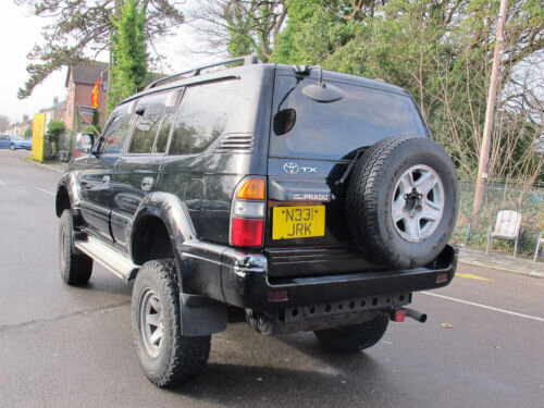

It does look odd. Claimed to be a factory fitted lift. Also it has a front wheel drive option as well as the more normal choices.
Nope it just needs bigger tyres and wheel spacers or negative offset wheels to keep things in proportion . I won't go any higher because i can't go any wider without needing some major modifications .
Looking at the bashplate and rear crossbar i'd say that its an inch higher than mine , or it would be if i didn't gain 2 inches on it with my tyres .
I don't know how they figure it has 24" ground clearance, the wheels look standard to me, I wonder if they supply an entrance ladder. :think:
Oooo, all those guaranteed motorway miles, (mainly in japan......)

I'll bet it has had much bigger wheels and tyres on at some stage. Can't see the point in having a lift that big for "mountains and ruff terrains" and fitting standard wheels and tyres.
Def has a body lift in addition to the SL - looks like a 2 inch/50mm body lift minimum.
Mines had a bodylift, 2", thats way more, maybe 5".

I recon the photos are out of ratio as well. The whole truck looks too narrow for its body height. There isn't a straight side-on view unfortunately. That would clinch it because the wheels would look oval if my hunch is right. :icon-rolleyes:
Photos 3 & 4 show how high the body lift is. All that chassis hanging low to the body at the rear and the big gap in photo 4 between the chassis rail and the body in the wheel arch. You could get your hand and wrist through that gap, 4 - 5 inches I'd guess.
50mm coil spacer lift and 50mm body lift is my guess but it has +15 offset 17" wheels and 31"tyres .

The rear cross member you can see in this pic is about 4" deep and is covered totally by the bumper when standard. The only way to lift a truck to expose that x member is a body lift so 4" body lift minimum but I reckon that is probably it. Judging by the LCA's in the pic of the front the angle looks standard to me.
