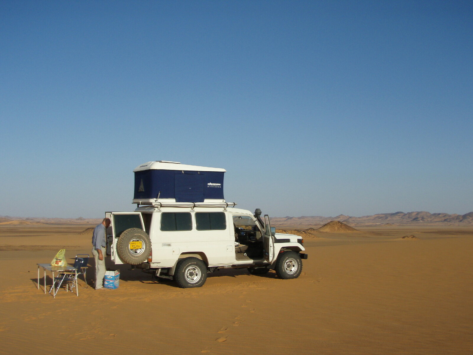

my car was nicely fit for desert trips , but the roof tent was well used after 10 years , and when cold and wet weather was around , it was OK , but not really confortable
this is how it was fitted .
I live in Italy , and unfortunately no one was doing these pop up roofs .
only in Germany , Switzerland ,Austria , there are some small companies doing them.
but....price very high , minimum over 10.000 € complete, better version go up to 13.0000 € ,
timing , they ask always 2-3 months for the job , and they were at least 600-800 km away from my home town .
no DIY kits aviable either .
so i decided to make my own pop up roof .
many designs , ideas come through my mind , at last most of details and spec were decided .

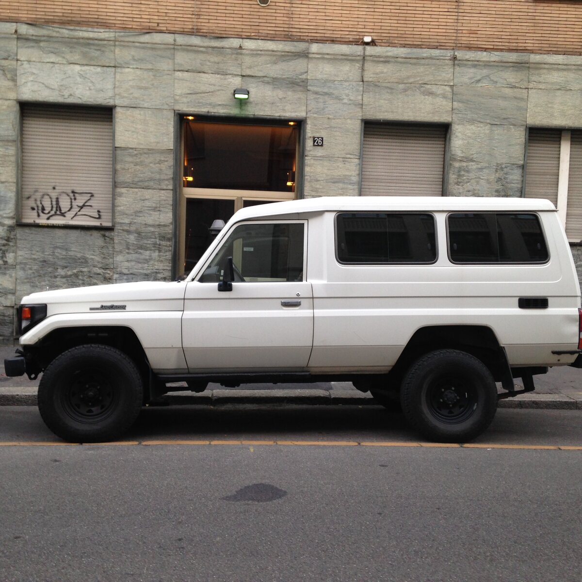

this is how my car WAS !!!

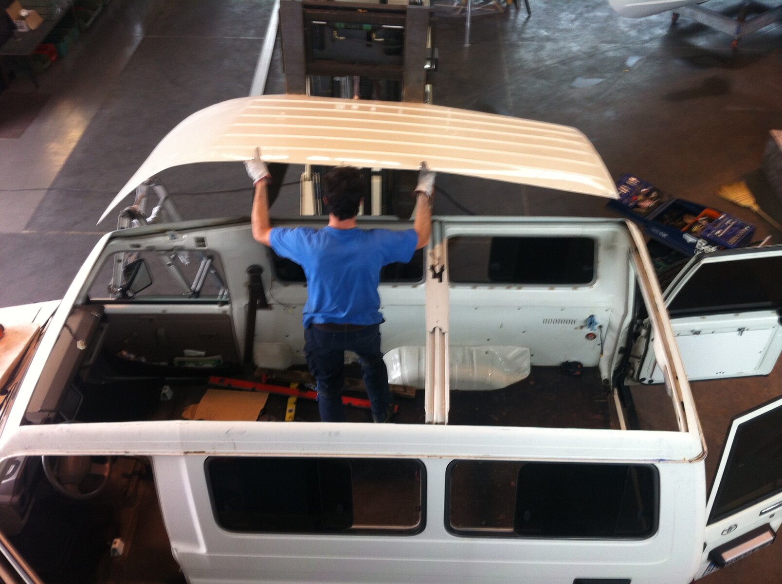

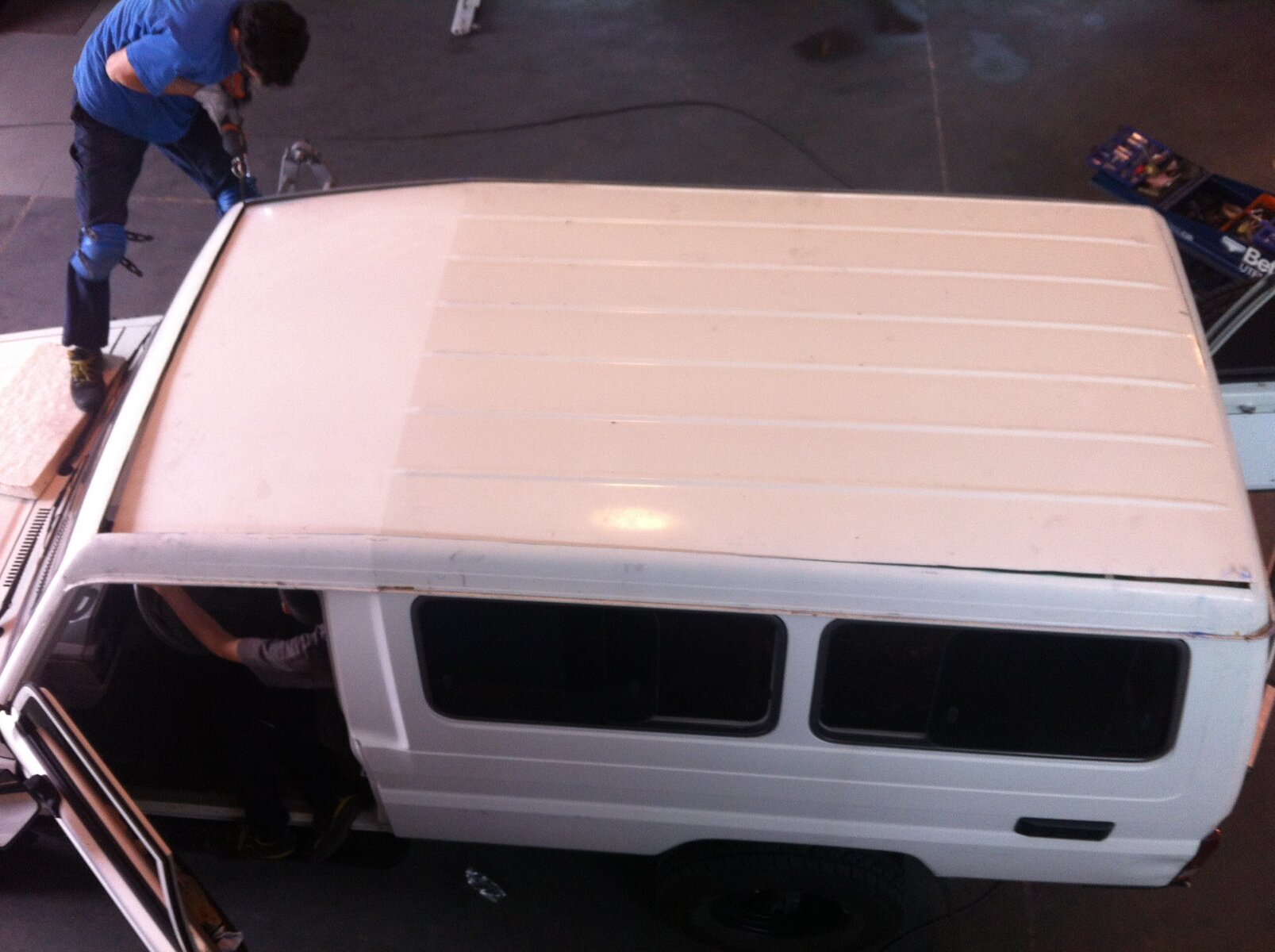

so with out going too far , we decide to start the JOB !!

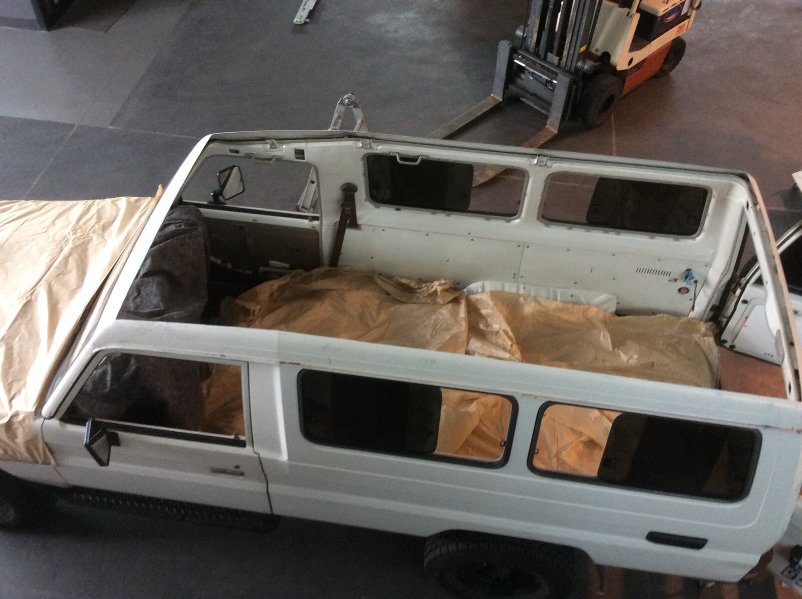

the following pic are just before the hair cut
and at the barber shop!
I was first shocked , and then sad , after the roof went .:sad-fever::confusion-seeingst:

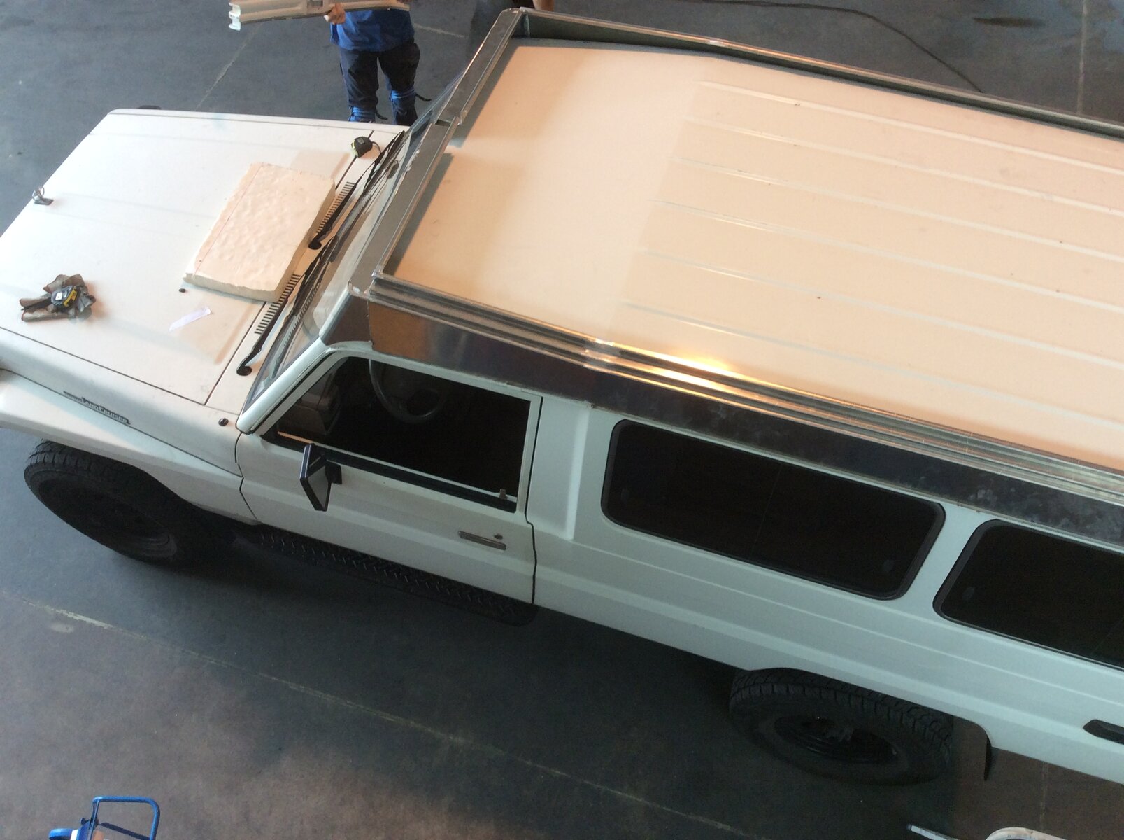

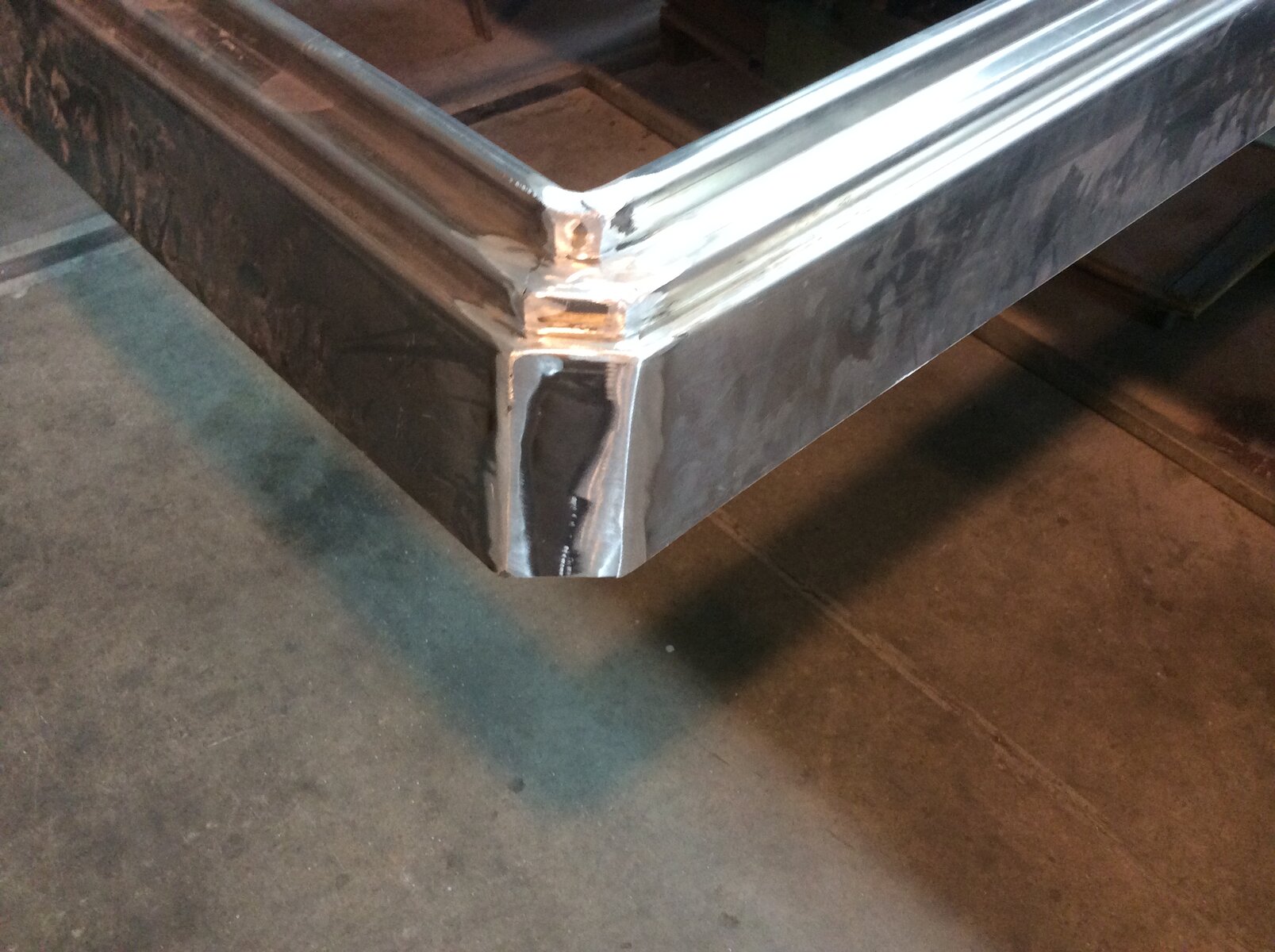

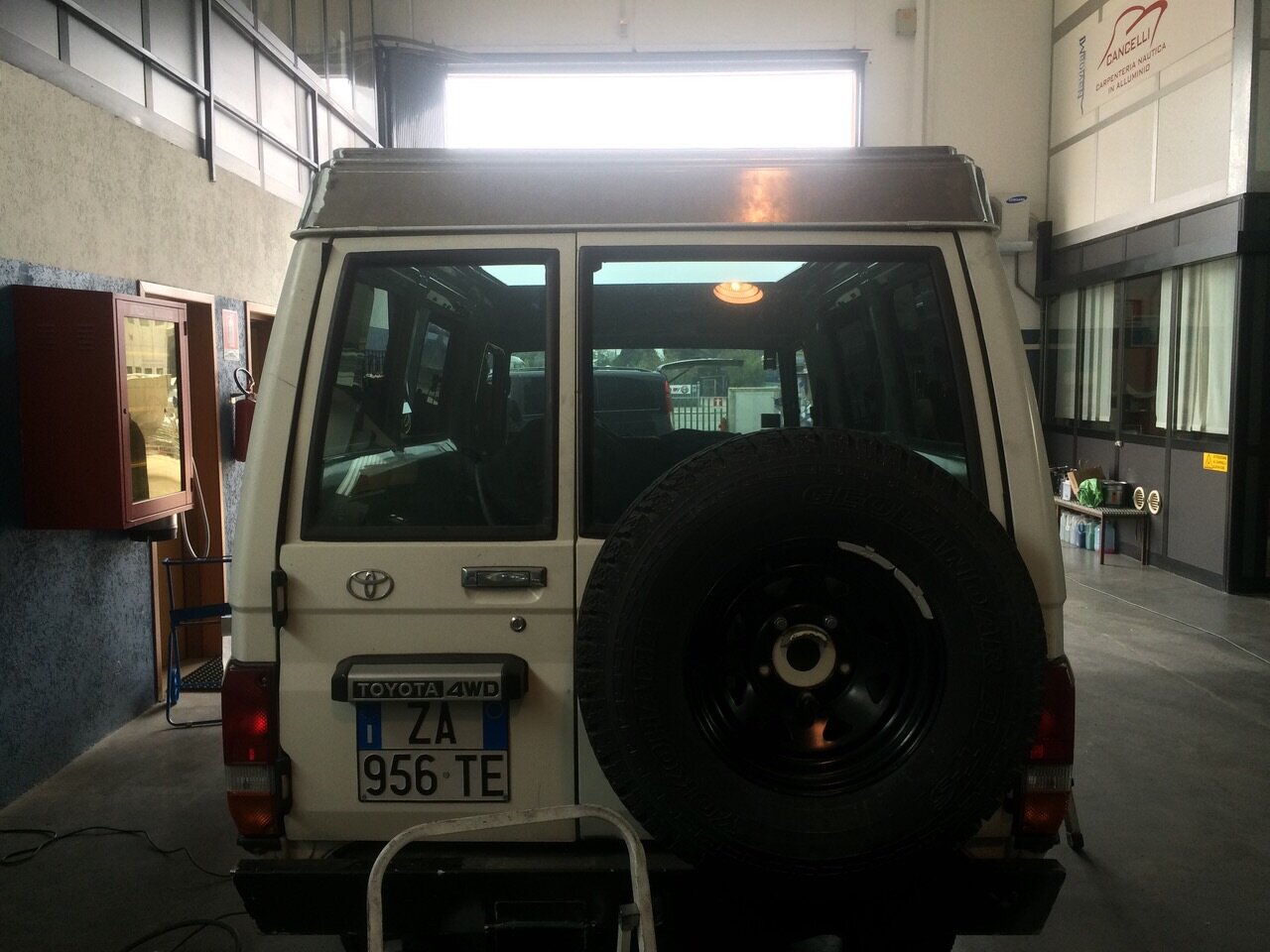

above is the whole base made up , it took aprox 4 days .
cutting , folding , grinding , welding , cutting , grinding , welding , grinding
the problem is that you start with a rough idea , but you are not certain till all pieces are weld together .
the first stage was quite nervose , on unknown ground .
back side corner , trying to simulate the corner of the car .
the first step is to allocate a rubber seal , that should keep out air and water when the roof is closed .
the second step is to allocate a pressure pump piston that will lift the roof , and keep it in position while open .
the third step is to fix the tent on the bottom frame , and out of the mechanism of lifting and closing rear view .
I tried to keep a similar line to the original form .
we will see at the end is it will look as a box on top or a decent roof .
I am still a bit worried .
