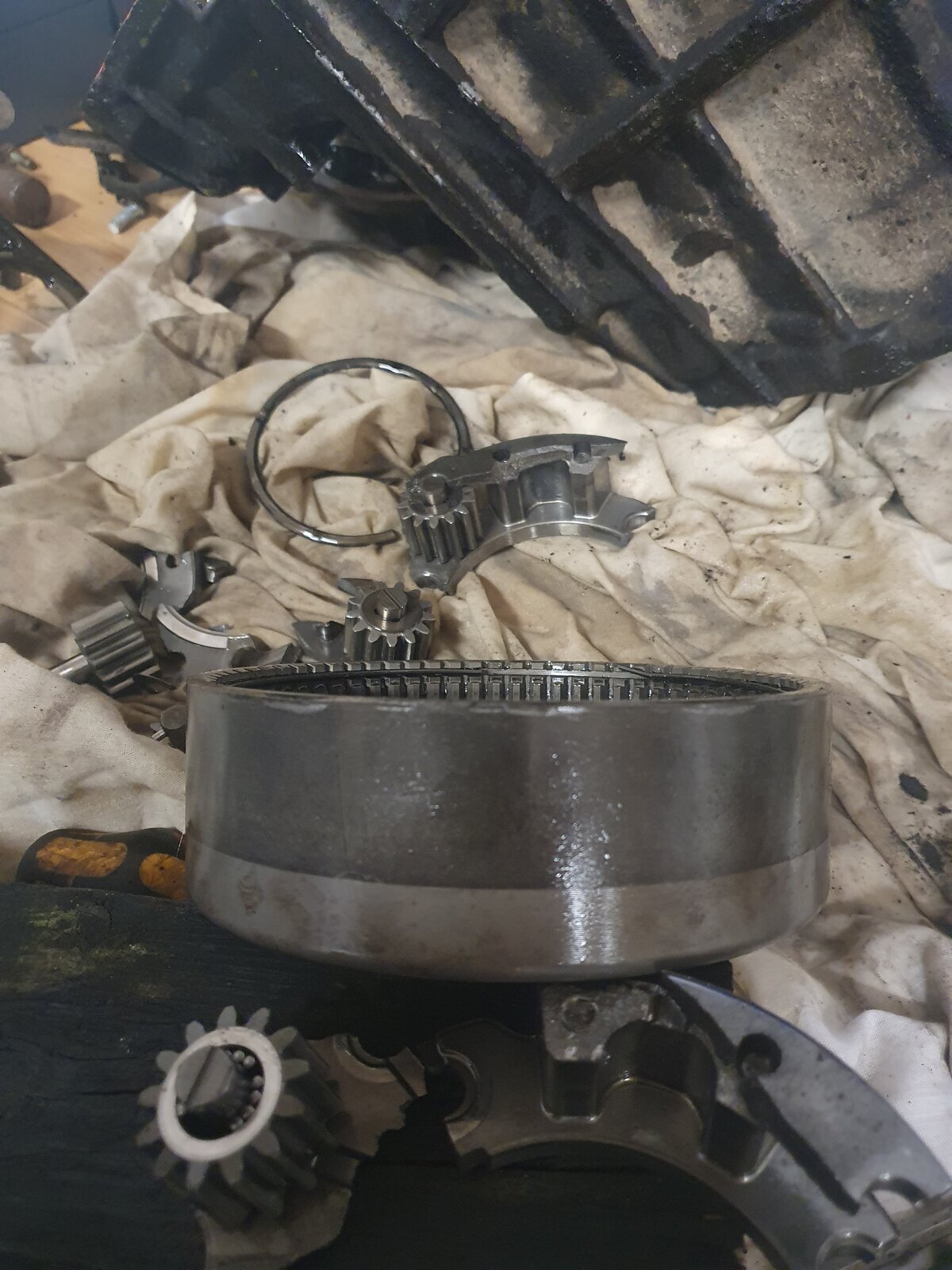

Hi Bob I tok the TB off today and took it apart its broken the diff lock with all the planetary gears in are cracked (no wonder it wouldn't come loose by it self) can you help me?

Hi again sorry for the many questions do you know if it's the same TB on a 2000 model with a 1kd engine as the 1999 model with 1kz-te?

Simon,
I believe the Transfer Boxes are the same (remembering that those from an 'Auto' are different to those from a 'Manual') - but I have never had one from each side by side to compare.
You have your box apart and the Centre Diff Lock Planet Carrier is broken (not uncommon), why not just fix the box you have ??
The last new Planet Carrier I bought came from Amayama in 2015 and cost £148 - so not enormously expensive.
There will, of course, be other components that you may wish to replace, bearings, gaskets, the Hi-Vo chain and so on but if your TB is basically good it shouldn't cost a fortune. The really expensive ones I've done were full of water and rusted-out inside !

She is pretty messed up. It's my daily driver so can't really

Hi it's pretty messed up. And it's my daily driver so I can't really do without it the Planet Carrier and house, washer all is pretty toast. And parts are really expensive in Denmark maby some day I will rebuild it I found one with "low" kilometers on it and one year warranty for 7500 dkr
