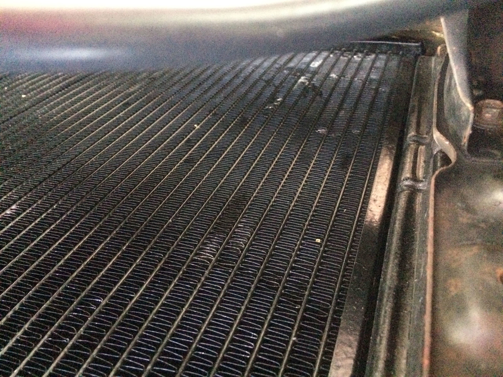

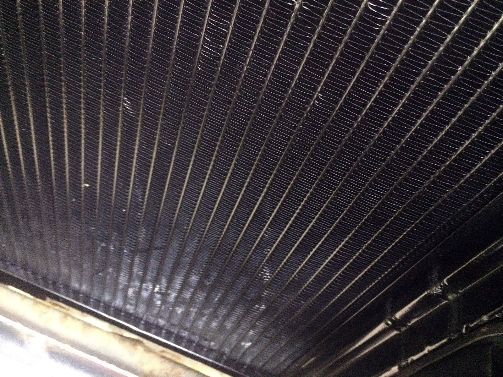

can you post a picture with the radiator? I'm want to see how the cooling fins look like on the new core.

Hi Alexy, I've already installed the radiator and its not easy to get a decent photo of it as the grill etc blocks the access. I will have a look and see if I can get my camera phone in there for you. Its a three core recore and its like new. If yours is not working have you any redress on the person who did it. There are a lot of cowboys out there especially in my part of the world.
Here you go. Not best shots Alexy but hope you can get something from them.

hey , thanks.
clearly the fins on mine are less frequent and that could be a problem, theres less surface.
Ill have injection pump adjusted first, see if egt temp drops. if not, Ill look for another radiator.
