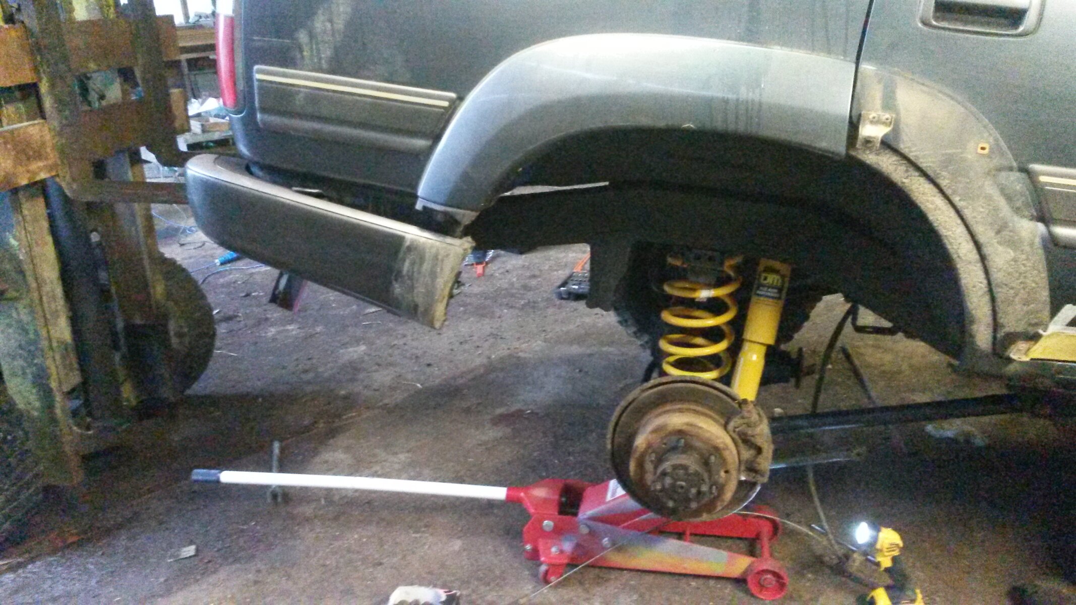

Comparing pictures of my kzj71 and hdj81 they are the same set up.
Kzj71. .. only truck Ive managed to blow up towing!
Hdj81. .. real deal tow truck!
Looking certain that the 90 uses the same setup.:thumbup:

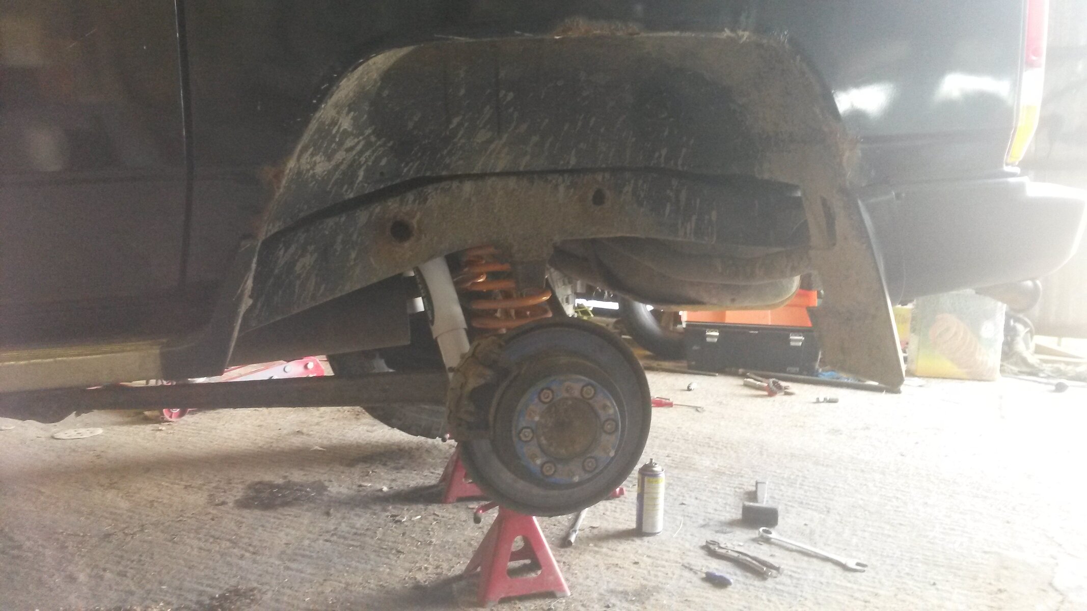

Yup...
My replacement pic for comparison
P.s....interesting jack under the back of the 80!!!
