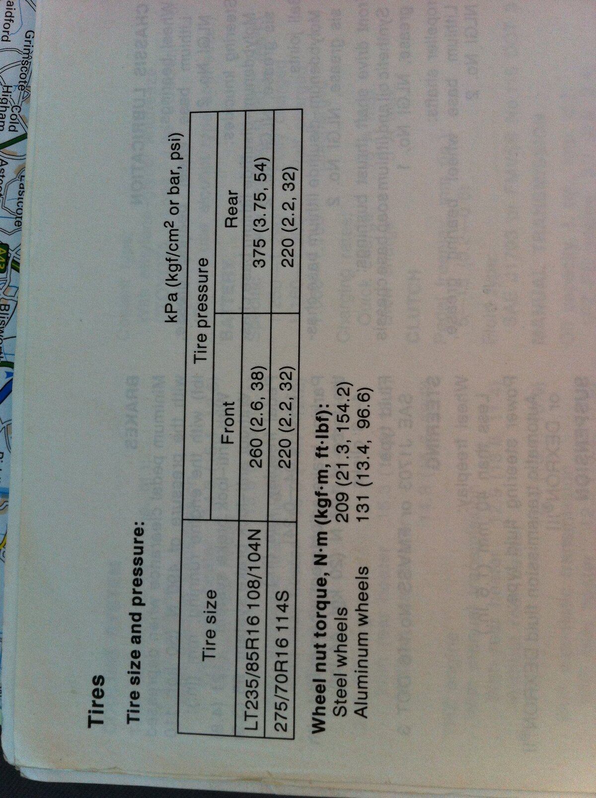

My owners manual (pictured below) shows that my 105 was originally available with one of two tyre sizes, 275/70/16 or LT235/85/16.
I have seen 105s with different wheels which have different rim widths in some markets, the rim width has a bearing on what width of tyre can be fitted. My 105 has 8" wide rims. What width are your rims?

My 105 has 275/70/16 fitted as standard .
