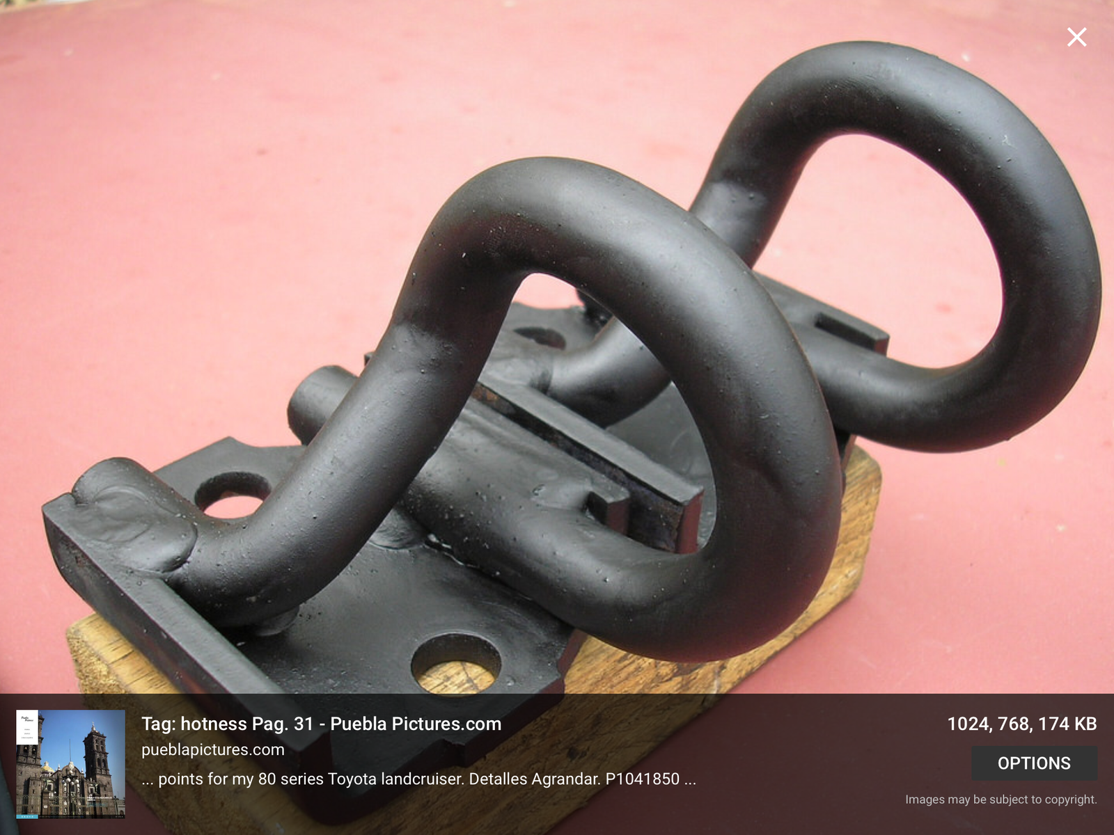

I'm in the process of looking for suitable recovery points for my 80. I currently have nothing on the front as both hooks have been removed and on the rear I have a tow bar with a combined ball and pin hitch assembly. I was worried about using that as a recovery point. Are my concerns justified? I know using the ball is strictly no as they can have a tendancy to shear off and become a cannon ball. I was on about using the pin hitch.
For the front I was looking for a bolt on eye or loop type fitting that I can attatch a shackle to but so far I can't find anything thats suitable. I would prefer this type as it means I can attach a strop without the risk of it sliding off or coming adrift. I only seem to find the hook type recovery points but not sure if these would have the correct bolt hole spacings for my chassis and I also can't find one thats rated more than 3500Kg with a clip to keep the strop secured. Can any one recommend anything that will do the job or know of somewhere that could make me something up?
For the rear I have been looking at the QT Services swivel type recovery point to attach to the four holes in my rear bumper. One thing that concerns me though, is this area strong enough to withstand a kinetic rope recovery? If not then how could I go about strengthening that point or can someone come up with a better solution.
Eventually when funds allow I will be buying a winch bumper for the front and a HD bumper and swing away wheel carrier for the rear. These will be complete with recovery points. However, i the mean time I need to find an alternative solution.
Any help will be greatly appreciated. Many thanks in advance
