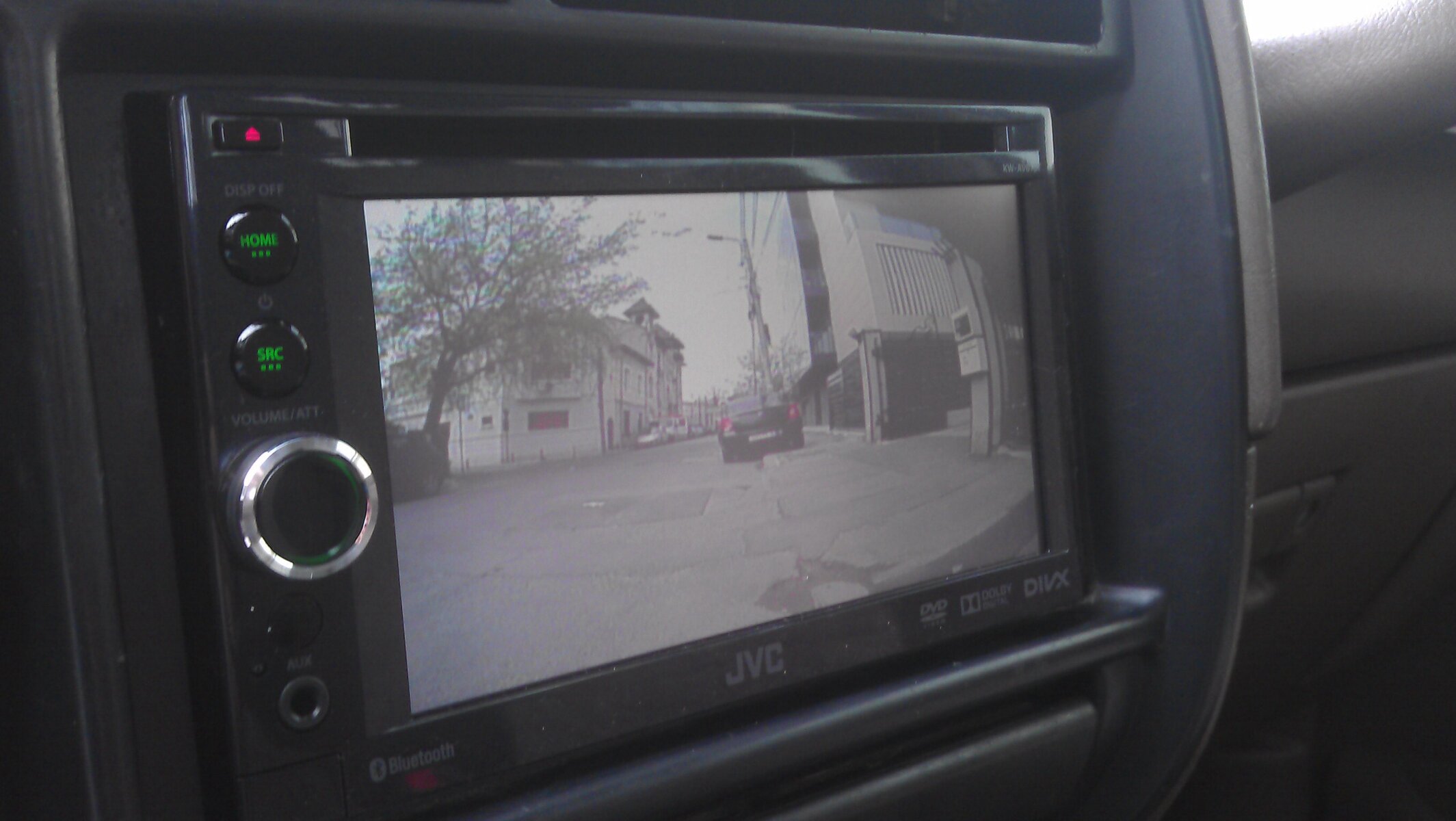

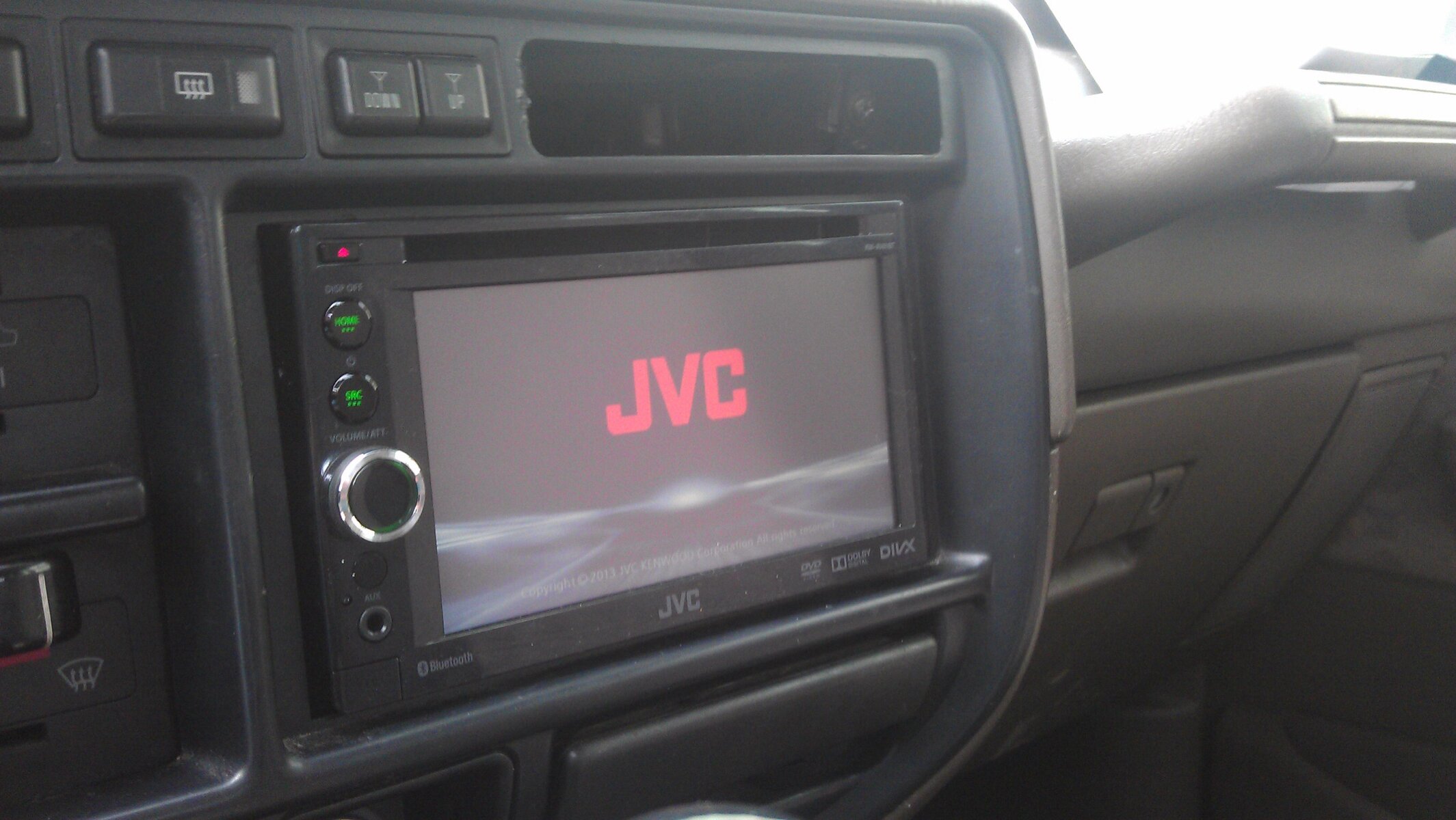

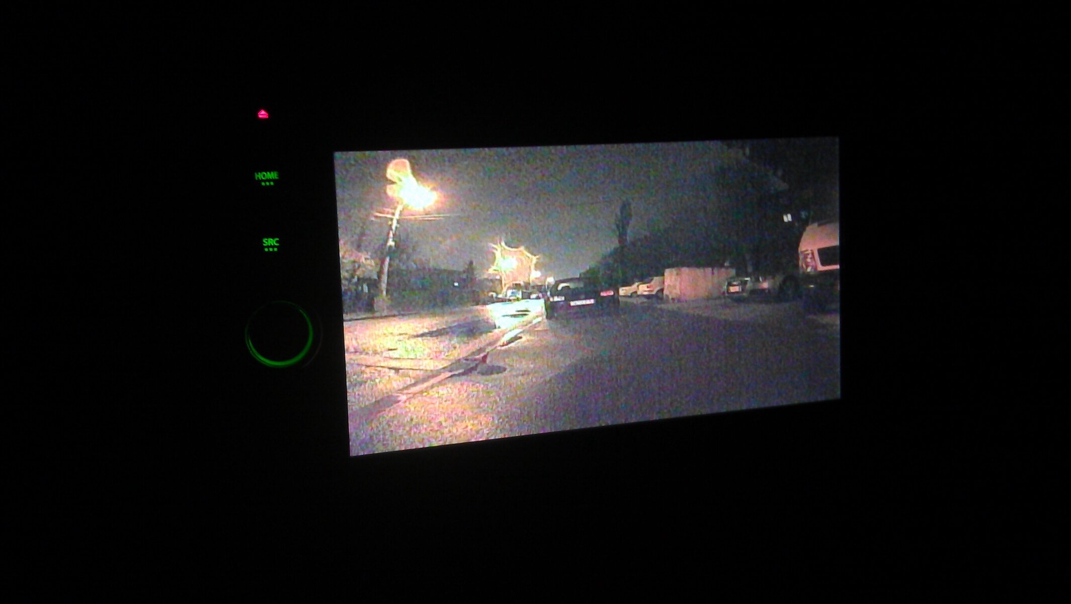

My old European spec 80 has a radio with a blanking plate beneath it, suggesting enough space is available for a double DIN unit. The radio is sh!te and I did away with the non working aerial when I re sprayed the car. I'm tired of the low quality sound coming from the Parrot playing USB mp3s and after a few incidents, I also fancied a reversing camera.

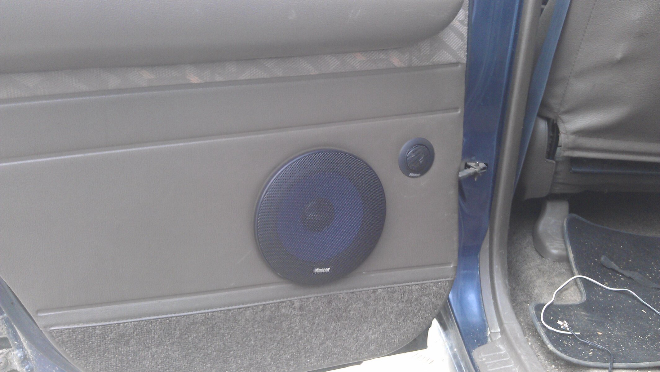

So what was the answer? Fit a double DIN unit with a half decent amp, USB compatible, reverse camera input, DVD/CD, all I could wish for, not wanting a radio, even though it is a radio receiver as well. Also shelled out for some decent speakers.
I left the truck with my trusted jobbie mate while I'm away, so I haven't seen or heard it yet, but he sent me some pics for those interested...

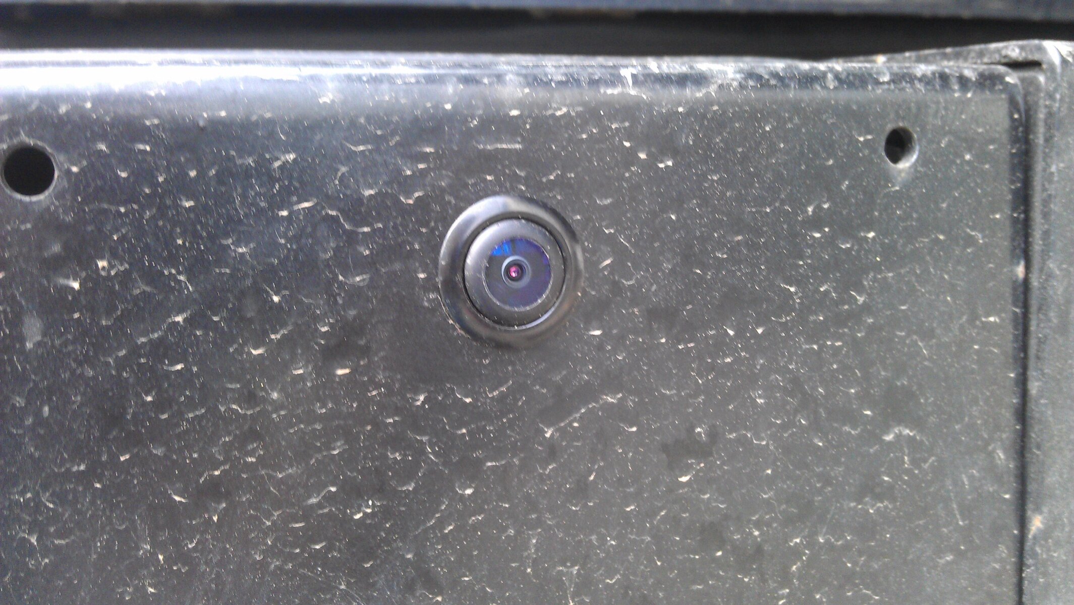

So I confess to no more (there is more :whistle:) than "needing" some assistance from a reverse camera, and with luck, I've killed a few birdies with one JVC, so to speak. :icon-biggrin:

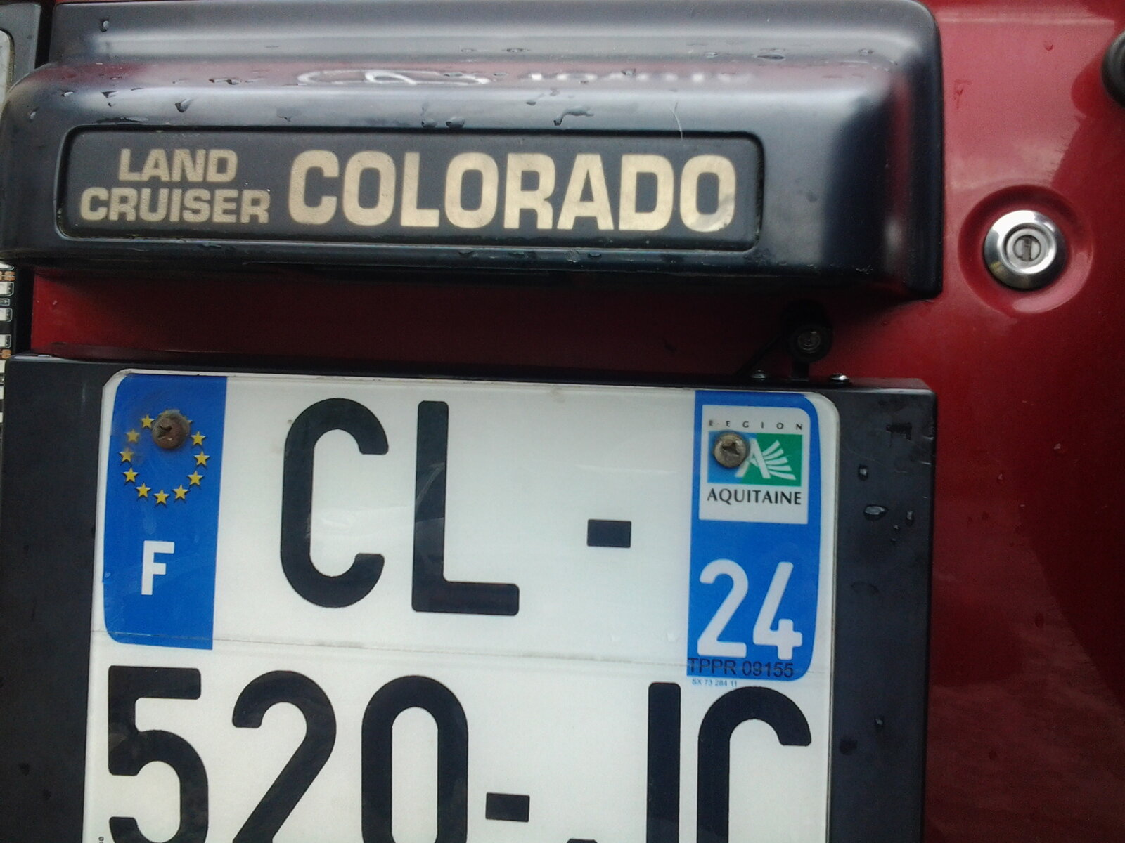

Little camera turned up today and was fitted (in the Dordogne rain)
only place I could find to mount the camera - took a live from one of the rear wiper motor plugs (live when Ignition on) and used that, earth to bolt in door. Drilled a hole in the rear door behind number plate mount, poked it all through and mounted camera.
As its wireless, thats it for the camera end!

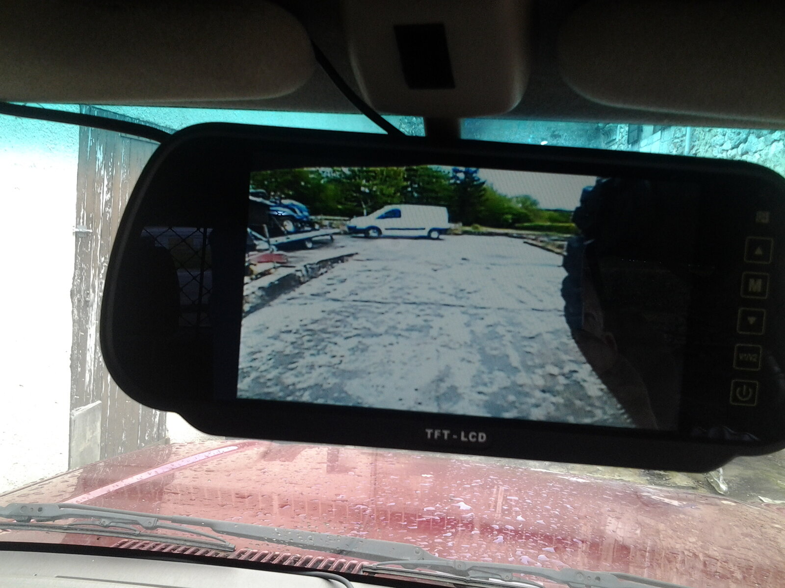

Mount the tv on the mirror - just spring clamps that may well ping off on rough terrain!
wire up with the wireless! receiver to tv and we are away! I hid wires as best I could....
OK OK, there's a great chunck of Cooper ST in the way, but my tow ball is only just out of view, and you can see feet if I hide behind the tyre! May have a re-think about camera position if it proves to be a PITA.

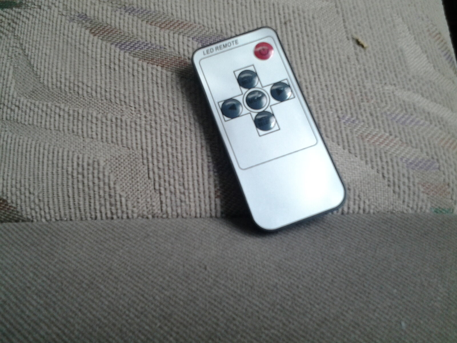

Happy with the quality of picture though - for the moment its on when the ignition is on - that way I can see if the feds are chasing me! It even has a little remote if you cant be bothered to reach up a bit!
It has another input if you want a watch a video or something too ;)
Hey, that's neat enough Steve! :icon-biggrin:

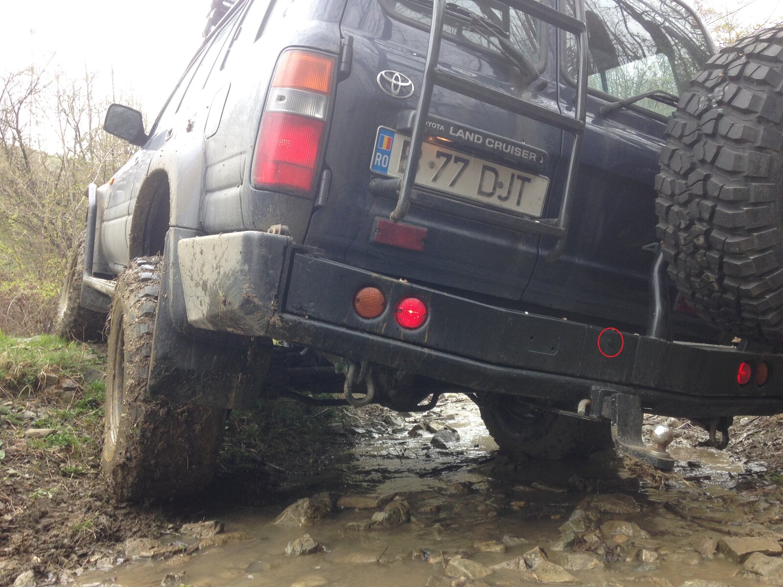

I also have a segment of BFG Mud in the top right hand corner but not as much a problem as you have!
