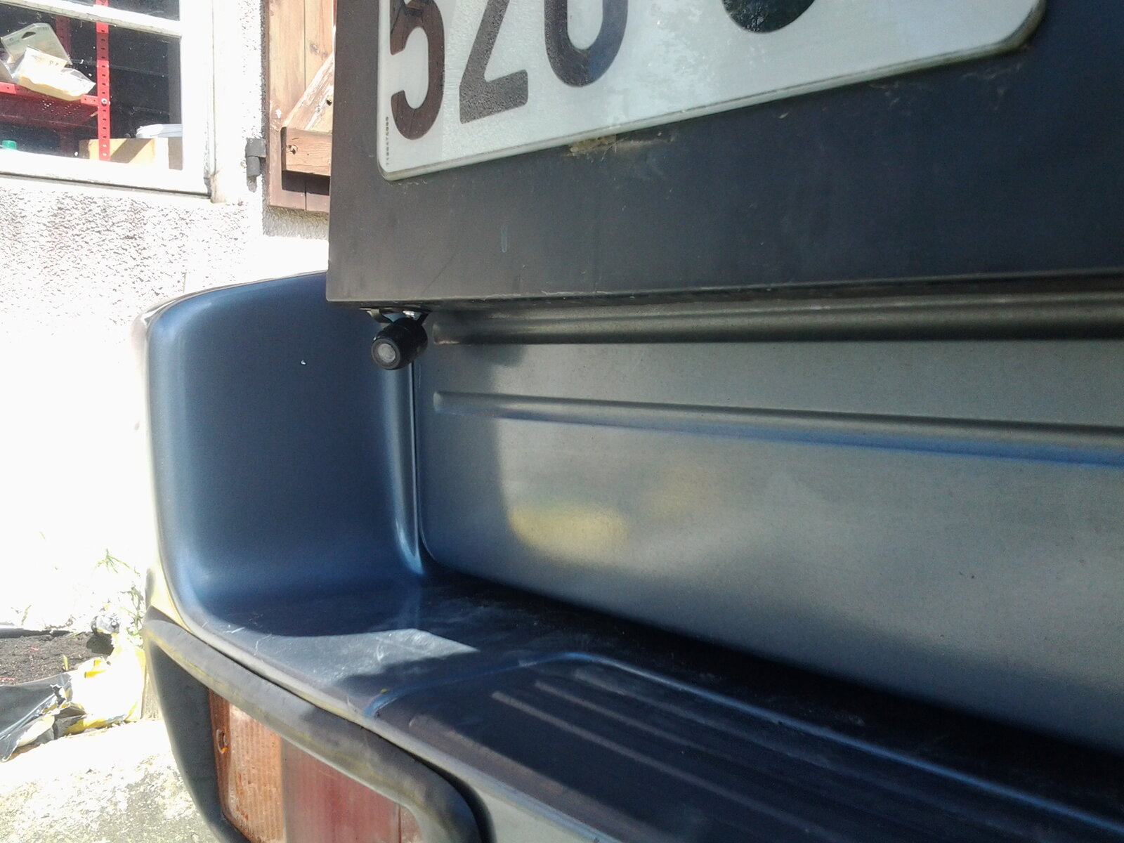

Quick camera reposition & much better now:
camera angle just gets both corners of rear of truck, or at least within a couple of inches![]()

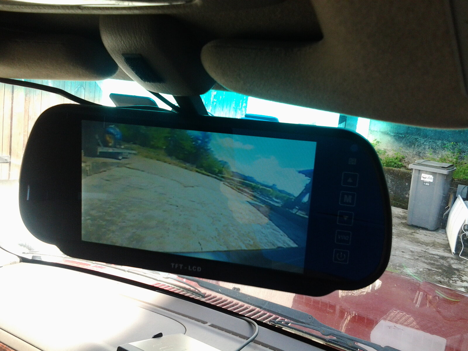

Change of plan with my wiring now ive started to put it all together !
Earthing the handbrake wire for passenger entertainent as decided before but now im not going to put a switch on the reverse wire for the headunit as I can just run the camera to the "rca aux in" socket and switch the headunit display when needed. Not only does that mean I dont need to run a wire and switch etc but it also means I can get the camera power from the rear of the vehicle so dont need to run a wire front to back too![]()
