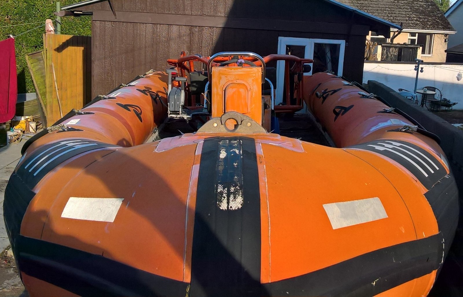

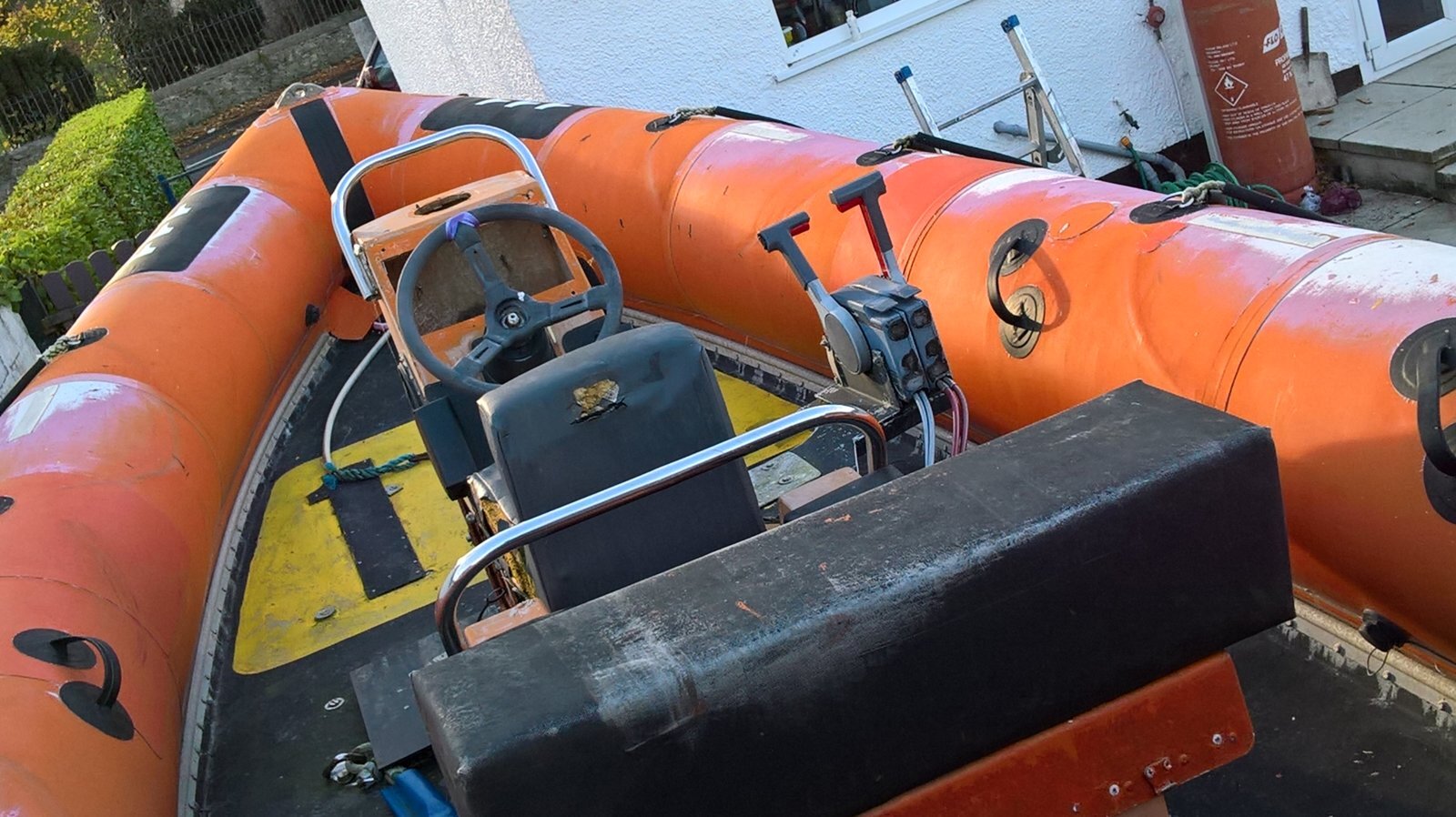

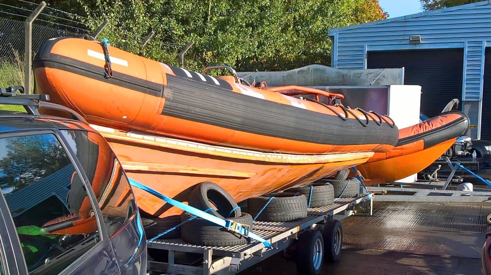

The RIb is a Halmatic Arctic22. I may be a bit biased, but imo these are the 80 series of the rib world! Built like 'alternative' brick houses a bit heavy and bit slower than mainstream but you can add plenty of HP as you wish as the construction is extremely strong. They are only available new to MOD/Services and other specialised commercial operators. This particular one was ex oilrig safety boat on a supply vessel and has self righting capabilities along with a flush transom. The coastguard drop test them from 3meters at varying angles and the military deploy them out of aircraft ( albeit with a parachute I think).
I fancied doing some around the islands off the west of Ireland and Scotland so wanted a really seaworthy rib with good seakeeping qualities and couldn't believe it when this one came up locally so I just had to have it! It don't have engines but decided to keep with twins for reliability. in the event of using twins I wanted 2stroke because the are significantly lighter if not thirstier, but then smaller hp would do due to the weight saving. I believe the boat was originally fitted with twin 90s but figured I would go up to twin 115s and still get a range of a bout 230miles with twin built in tanks. There is an identical version to the arctic which is the pacific and the only difference being that it is fitted with a diesel inboard (4.2 yanmar or yamaha) coincidently but its too much to convert from outboard to inboard as opposed to the reverse
Overall its not in bad nick. tubes need a clean and some wear patches added but do not leak. The Gelcoat needs a polish all round and the console require some tidying. I will add 6-8 more seats and repowdercoat the A-frame etc. Maybe the cruiser needs a matching paint job!

Looks like fun :thumbup:
While island hopping i imagine you will encounter a lots of potters which can mean lots of floating rope , with that in mind i think i would opt for a main engine and a backup to be kept raised . Easier to find and easier on the pocket maybe .
you are right Shayne and if the boat cannot plane on one engine then it is better just to have a 10-15hp trolling motor. If I go single engine then four stroke will be the way. just thought I would try for a matching pair first before going down that route..anyone been offroading with a rib befiore?

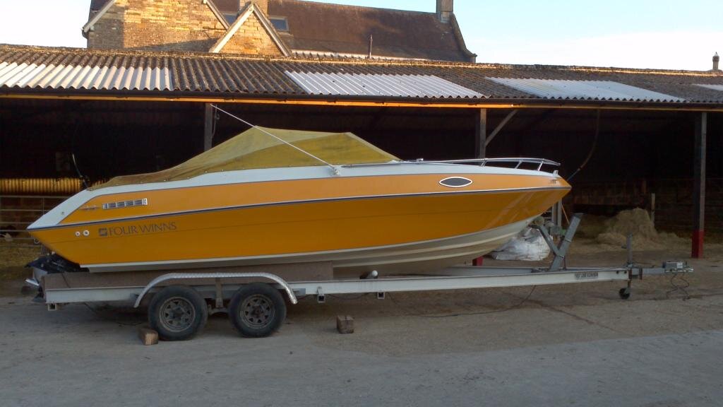

Had a rib in the past but now have a 22ft Four Winns with a V8 :) She's very yellow though, a bit of a classic, we launch from Poole & do trips around the coast or IOW area.
