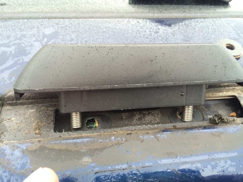

Finally the roof bars arrive, and guess what !
The front brackets do not fit :(
THis picture shows the front bracket, with bolts not lining up :(
THe Middle BRacket Fits (hole centres 80mm) the rear bracket fits (hole centres 80mm) but the hole centres for the front bracket need to be 70mm ?!!
The brackets are For a Corrado ! grrrrrr
Are they all like that? The front holes alongside the sunroof have a different spacing and are not used. The holes just behind the sunroof are the ones you want and they are covered over by the black trim piece so you need to take that off to gain access. What model does the packaging say they are for, or what part number are they?
Jon.. you are a star !
I just had to go out in the rain and check, I pulled up the gutter trim which is black stainless steel. About 5 inches to the rear of the existing front holes, there is another two holes ! Yes 80mm centres !
Problem sorted !
Thank you !
