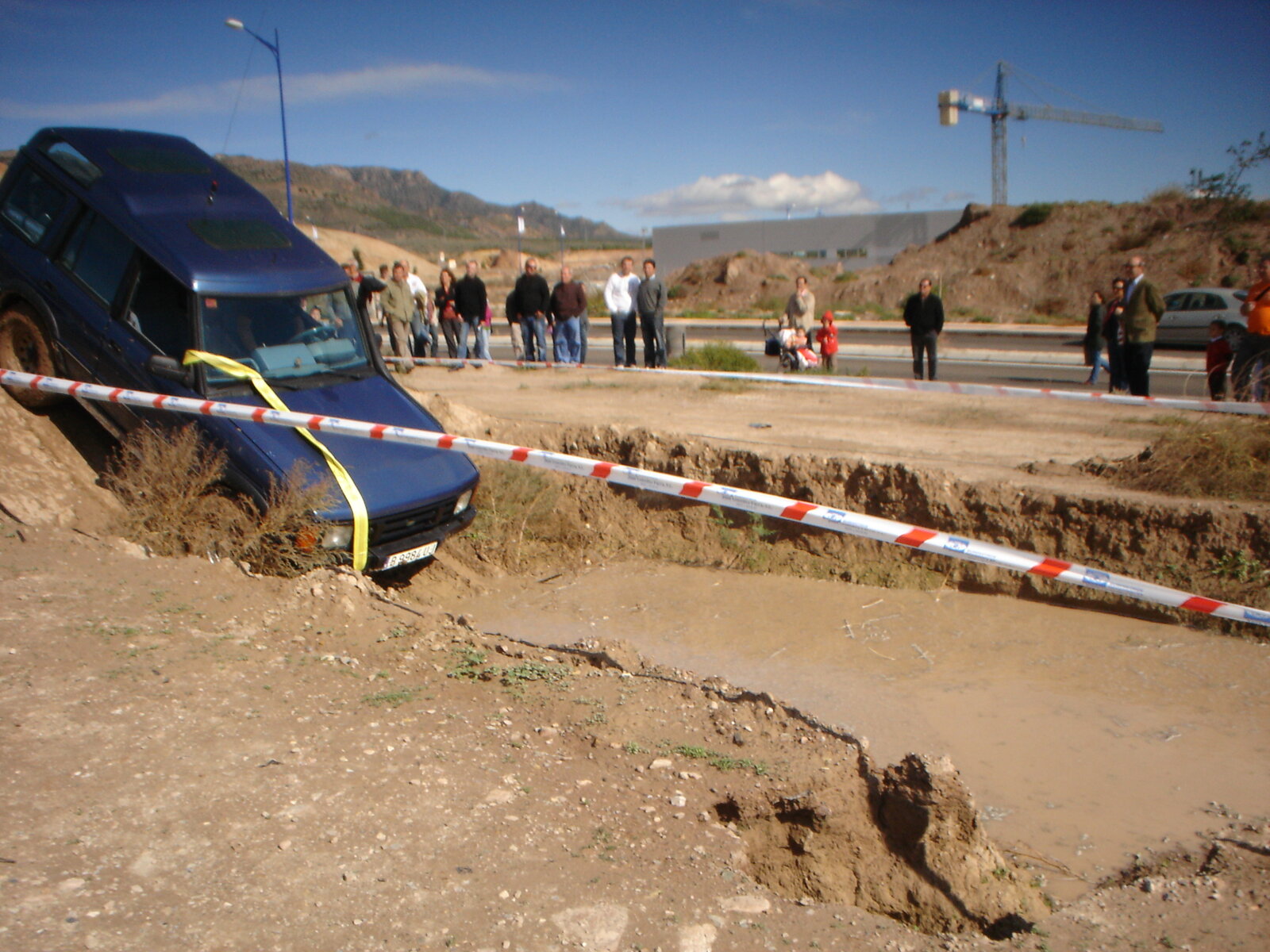

Showing off now in my Discovery, last lap before taking first prize at the SOL ROAD challenge at the Land Rover Site in Lorca Murcia 08/2011, water is 'only' about a metre deep!

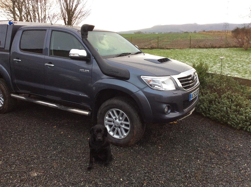

I don't like snorkels at all and with the underside of my wheel arch being about a metre high i figure going deeper is asking for trouble . But if i was going to Iceland i think i would ignore my dislike of them and fit a snorkel . I imagine a landscape made entirely of water in various states of frozen must be ever changing so even on a guided tour the risk of getting deeper than you want to is very real .

That vehicle was obviously prepared for artic conditions yet they didn't think a snorkel was necessary. :think:
I was wondering why there was a line on the rear, then I realised they needed it back for the next truck. DOH! :oops:
Those arctic trucks are running 45inch tyres though lift etc etc.
