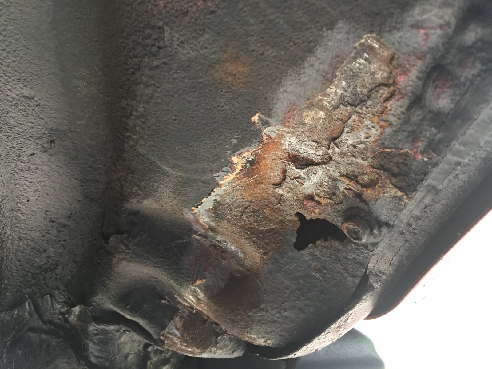

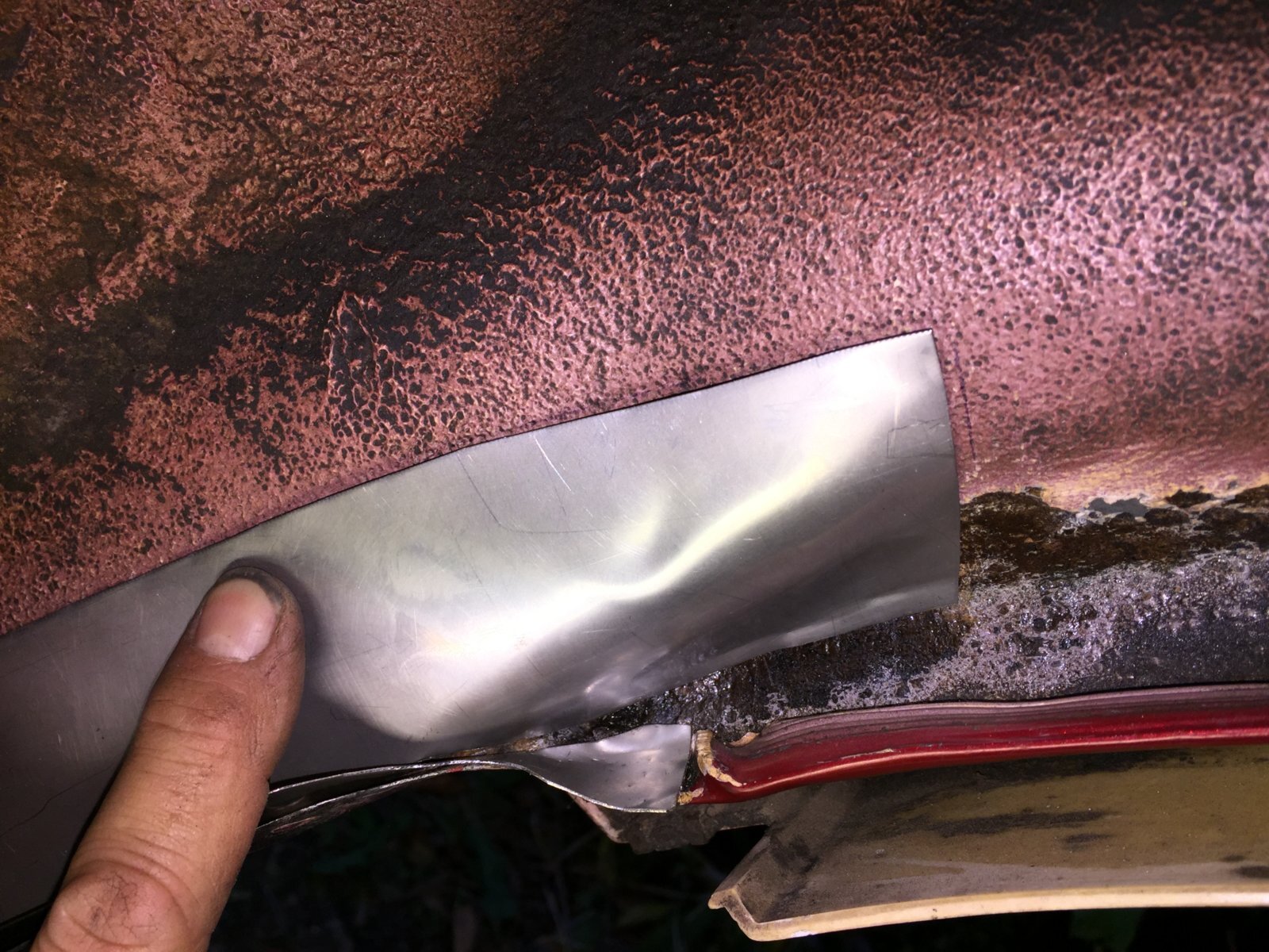

Just building on part two, I managed to find some pictures of another Cruiser where the rear arch had gone through. This is a common issue - to varying degrees. Dirt and moisture gets trapped in the inner edge of the wheel arch which doesn't help, but it's my personal opinion that this corrosion is mainly caused from the inside. There is a tight seam where the tub meets the quarter panel and I believe that condensation that develops on the inside of the bodywork runs down into this gap and through capillary action works its way in. As it never really gets warm in there, it remains damp.
It's not that hard to mend really and done well shouldn't really detract from the vehicle. In fact having it repaired is probably a bonus.
Here's the view from inside the arch; it's pretty shocking and needs cutting back to good metal.
Here's the inside after the repair. The outside got painted up with stone chip and the inside got a good coat of cold galv spray and some rust inhibitor

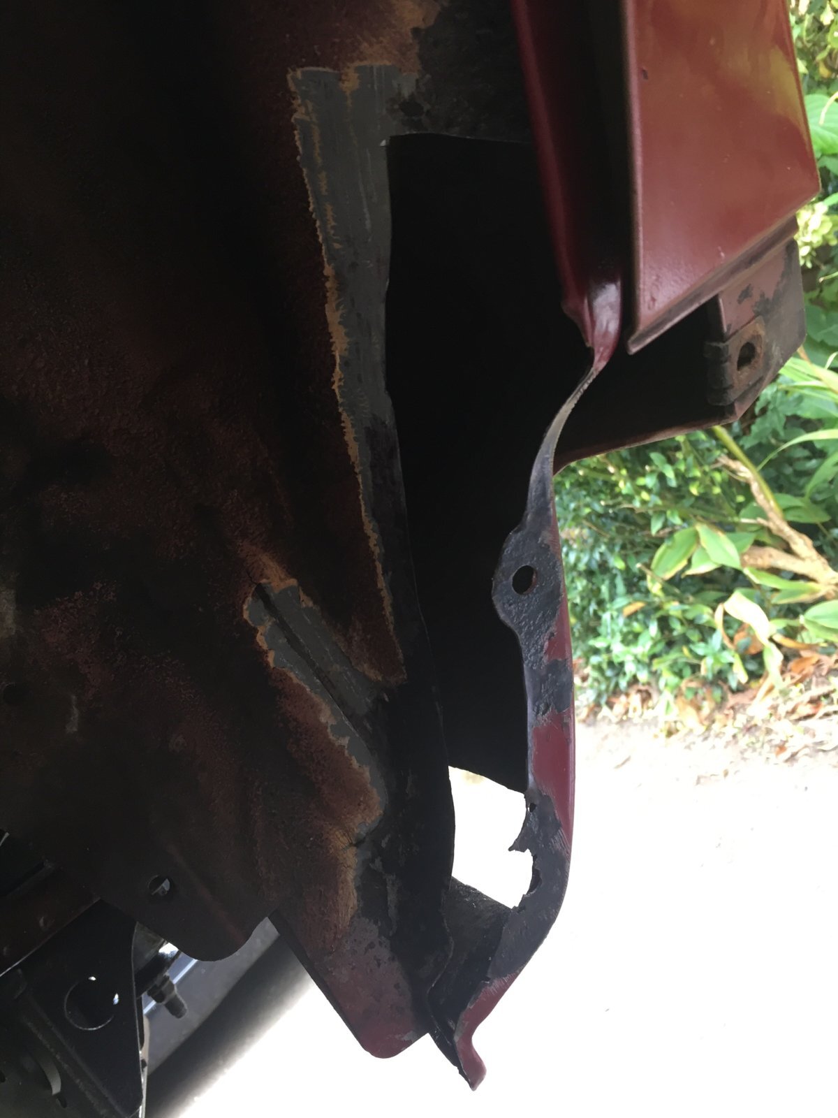

To add to that Chris, the cover in the near side rear arch for the fuel filler pipe tends to be a trap for mud and dirt that is easily missed. Three bolts and its removable but mine had gone through behind and then started eating from the inside at the base of the rear quarter. Something that goes unnoticed but can be felt with a hand up between the bumper and body just behind the arch. No big deal really but worthy of note.

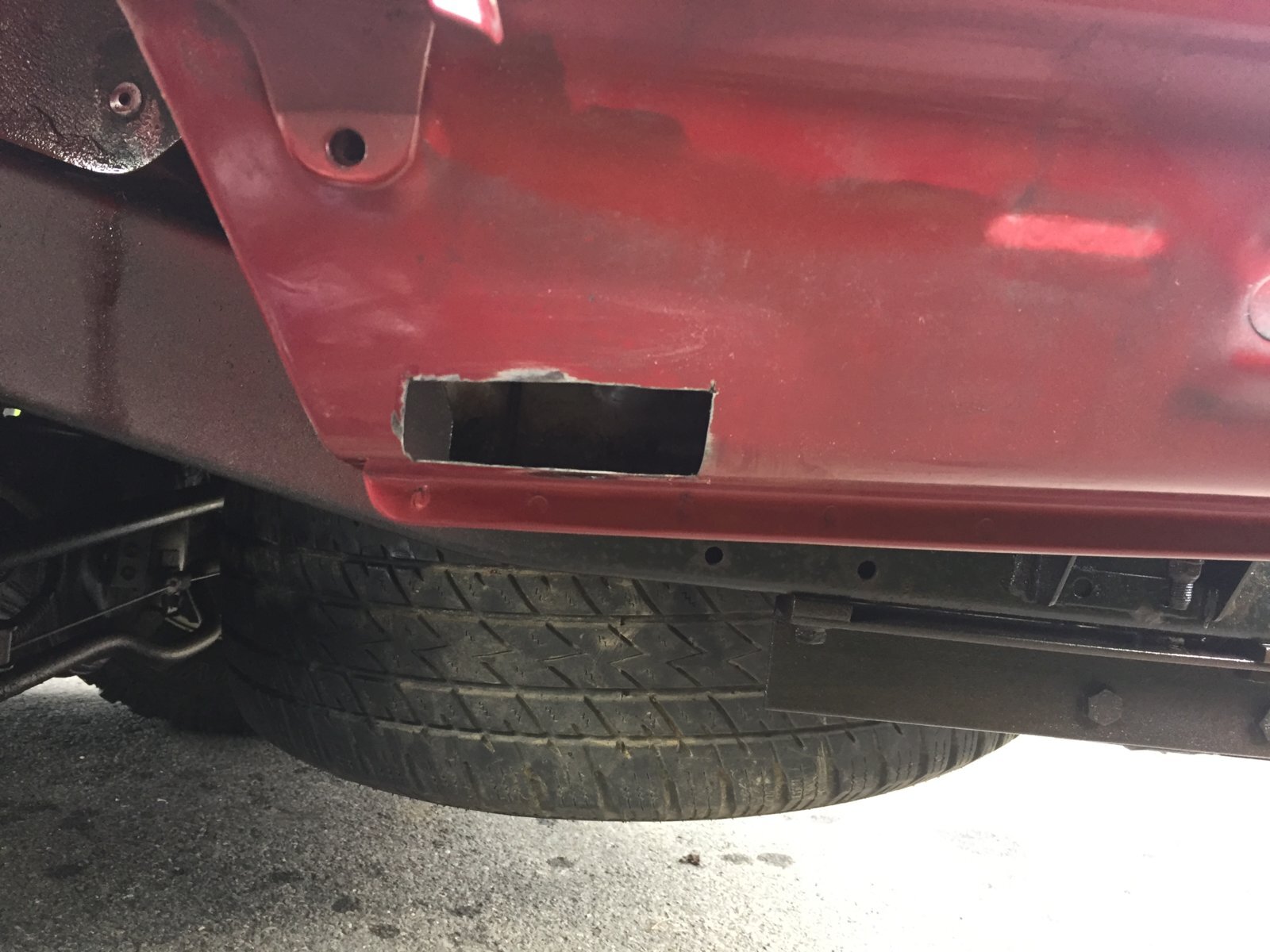

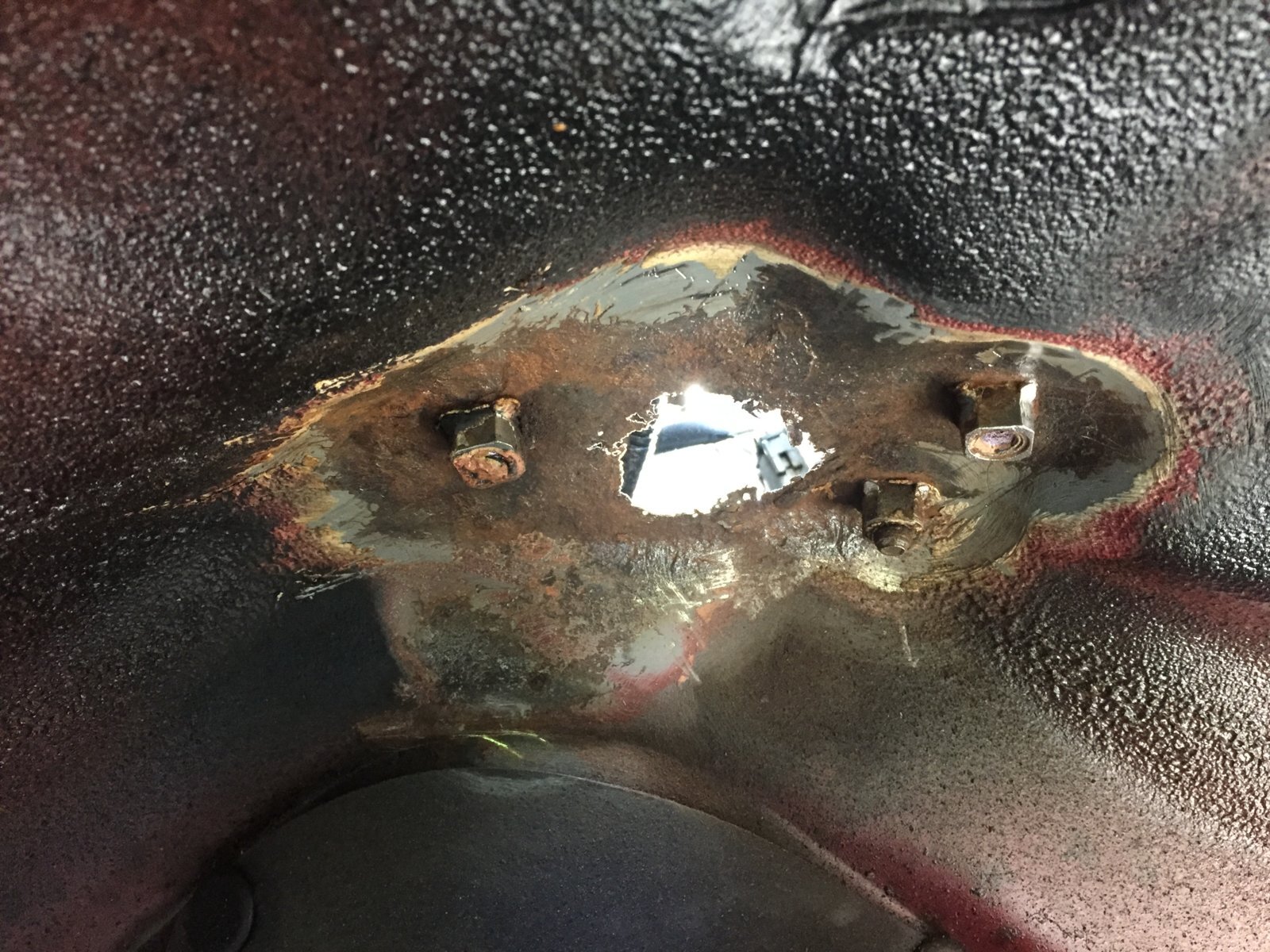

I've also had the front wheel arches go along the edges and at the front where they join the cross member. Again, all treatable. Another area to look for is around the various bolt holes in the front tubs.

Thanks Rich, yes that filler flap section went on mine too despite the presence of diesel dribbles. The bottom corner ends of the sills are a classic spot. Especially if the drains have been bunged up
