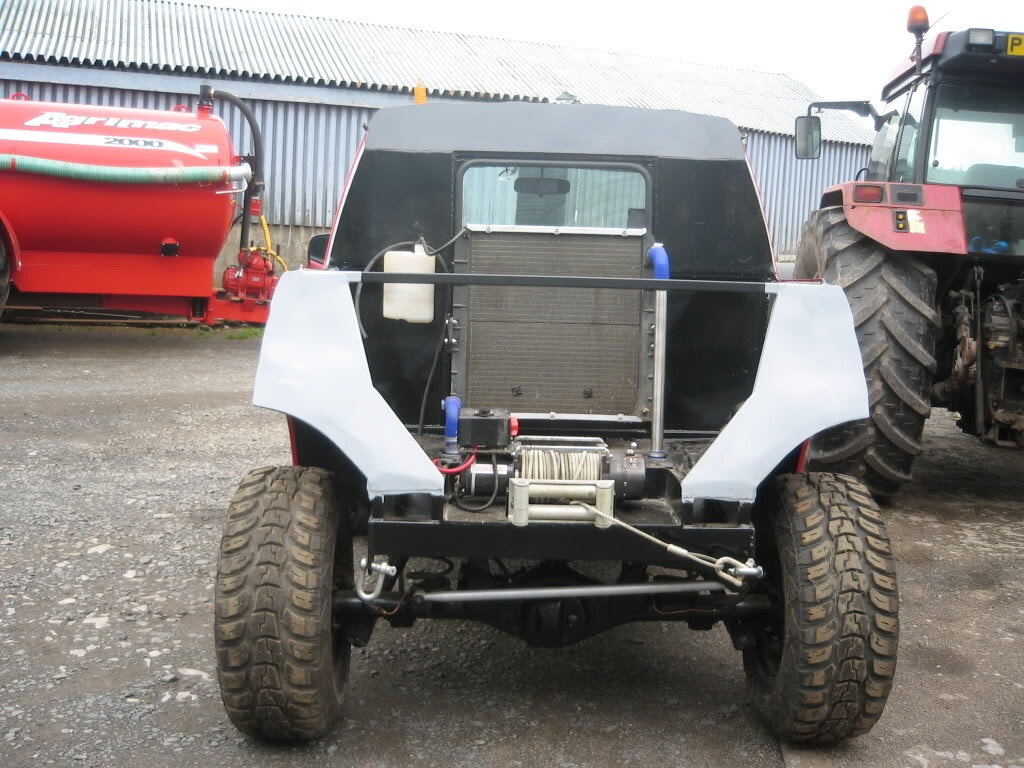

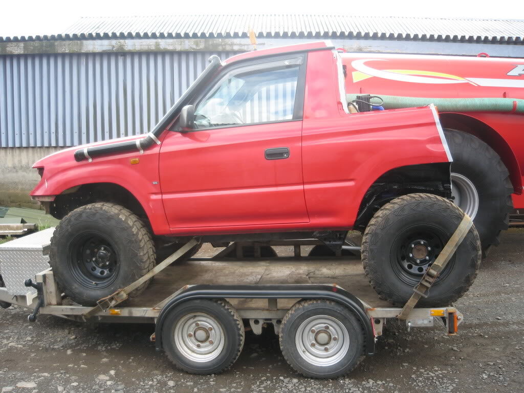

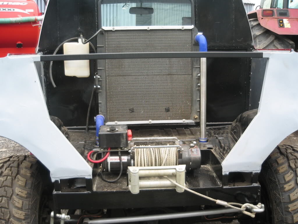

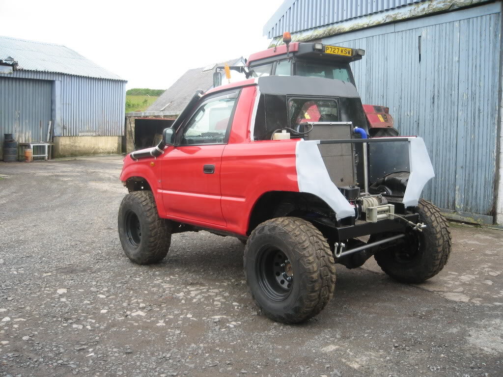

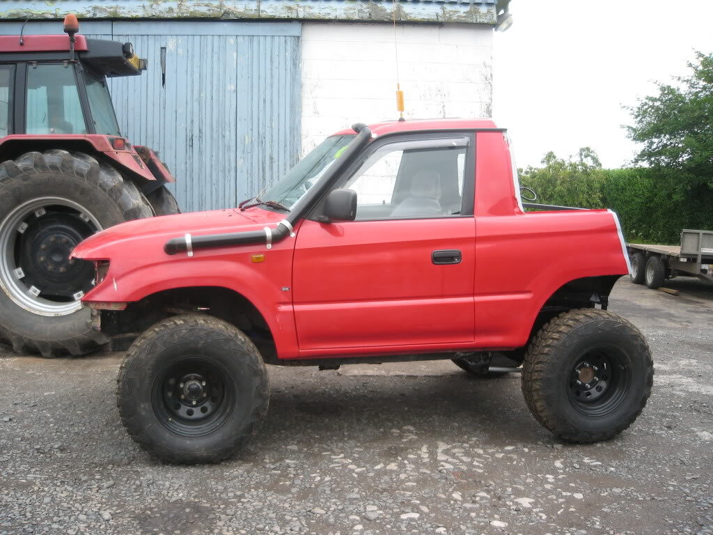

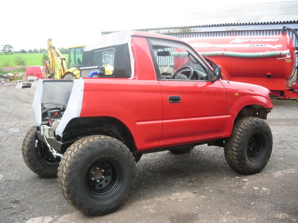

JUST SOME PICTURES FOR YOU LANDCRUISER TYPE PEOPLE TO BROWSE ON :geek: :geek:
STILL UNFINSHED BUT GETTING CLOSER TO THE MUD EVERY DAY, NIGHT, SUNDAY. :D

Pete, very tidy work mate. Almost unrecognisable now as being a 90 SWB to be honest. Is it pretty much standard underneath in terms of suspension etc? I mean you haven't fitted a solid front axle have you?
One major question, and I really don't mean this to sound rude - but is it any good? It looks great, but in terms of showing the Rangies and Landies etc how to get it done, does it do the biz?

WELL CRIS I HOPE ITS GOING TO BE BETTER THAN BEFORE. IT WAS REALY QUITE GOOD IF NOT I MIGHT LOOK AT SUSPENSION AND AXLES. ILL JUST GO TRY IT BREAK IT FIX IT. IM INTRESTED IN DIFFLOCK FOR FRONT AXLE HOW MANY ££££ INVOLVED CHEERS MATE

I assume the rad in the back is the only rad ( :?: ) in which case there doesn't appear to be much scope for airflow.
I have a neighbour who is into all things LandRover and (amongst about six other things) he has a Comp Safari Racer - his rear-mounted rads are high up and sloped - with Kenlow fans blowing air up from below. Of course, he is using a 3.9L V8 and it gets 'the berries' so generates a lot of heat.
Does yours have a fan in behind, with some ducting from the cab ???
Just curious.
Bob.

Im guessing its got an electric fan as i can see the clips that go through the bottom half of the rad.

I put the biggest kenlow fan i could get behind the rad its a two stage thermal control job. put it on the face side sucking first but was not happy so tried behind and found it was better and tidyer. the kenlow fan is spec for around 500horse power and the rad is off a ford cargo 7.5 ton truck,an alloy one i used cos a mate of mine who has done a good bit of racing/engine building told me it would help to to the tune of about 20%. its in my friends workshop today getting a new stainless steel exhaust and water pipes connecting the rad to the engine (no silencer and vertical pipe HAHA :lol: )
and as for a roll cage ive got a pile of tube and a bender at the ready for when i get to that stage.I cant decide whether to make it inside or outside of the cab :)
