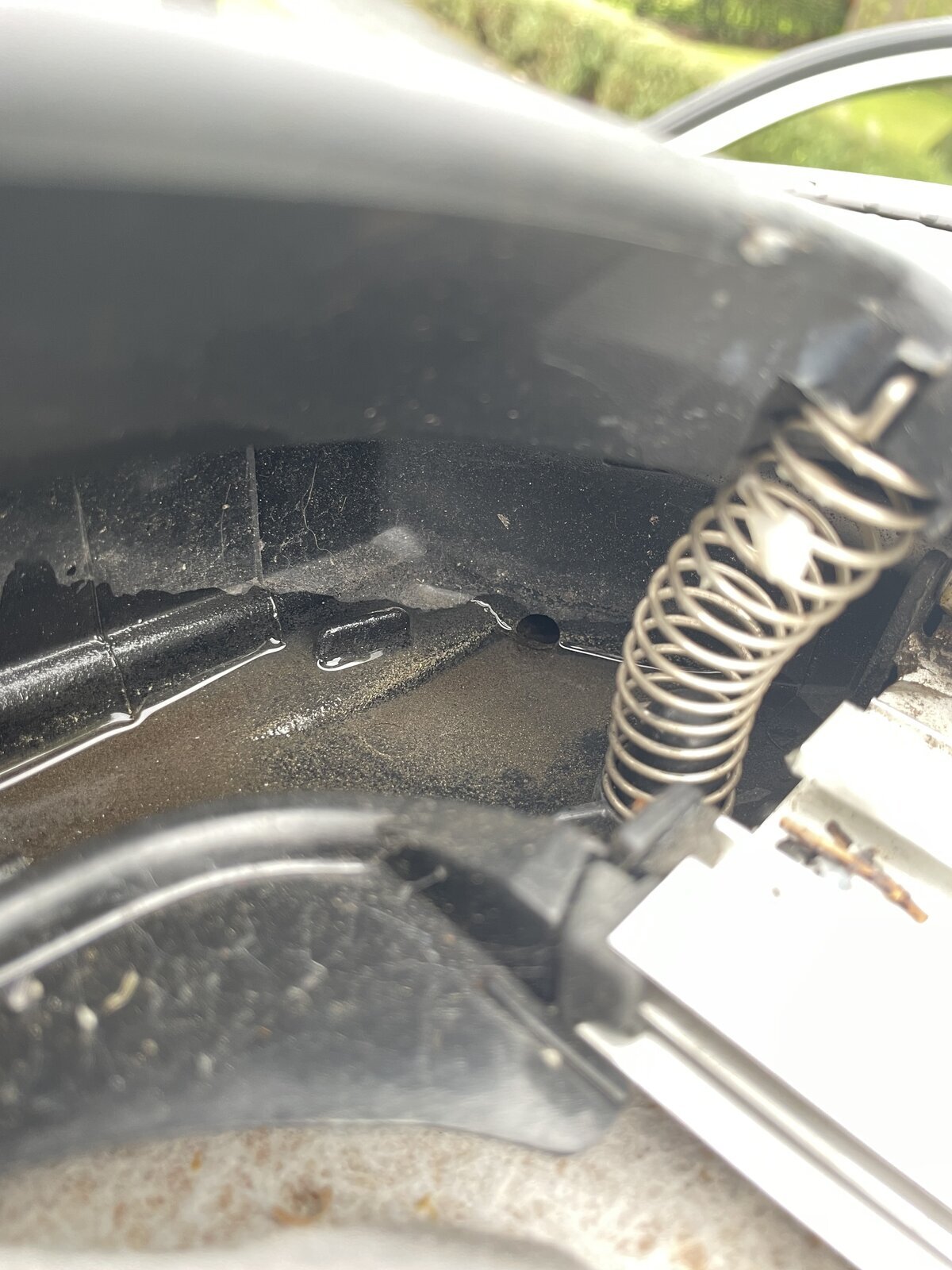

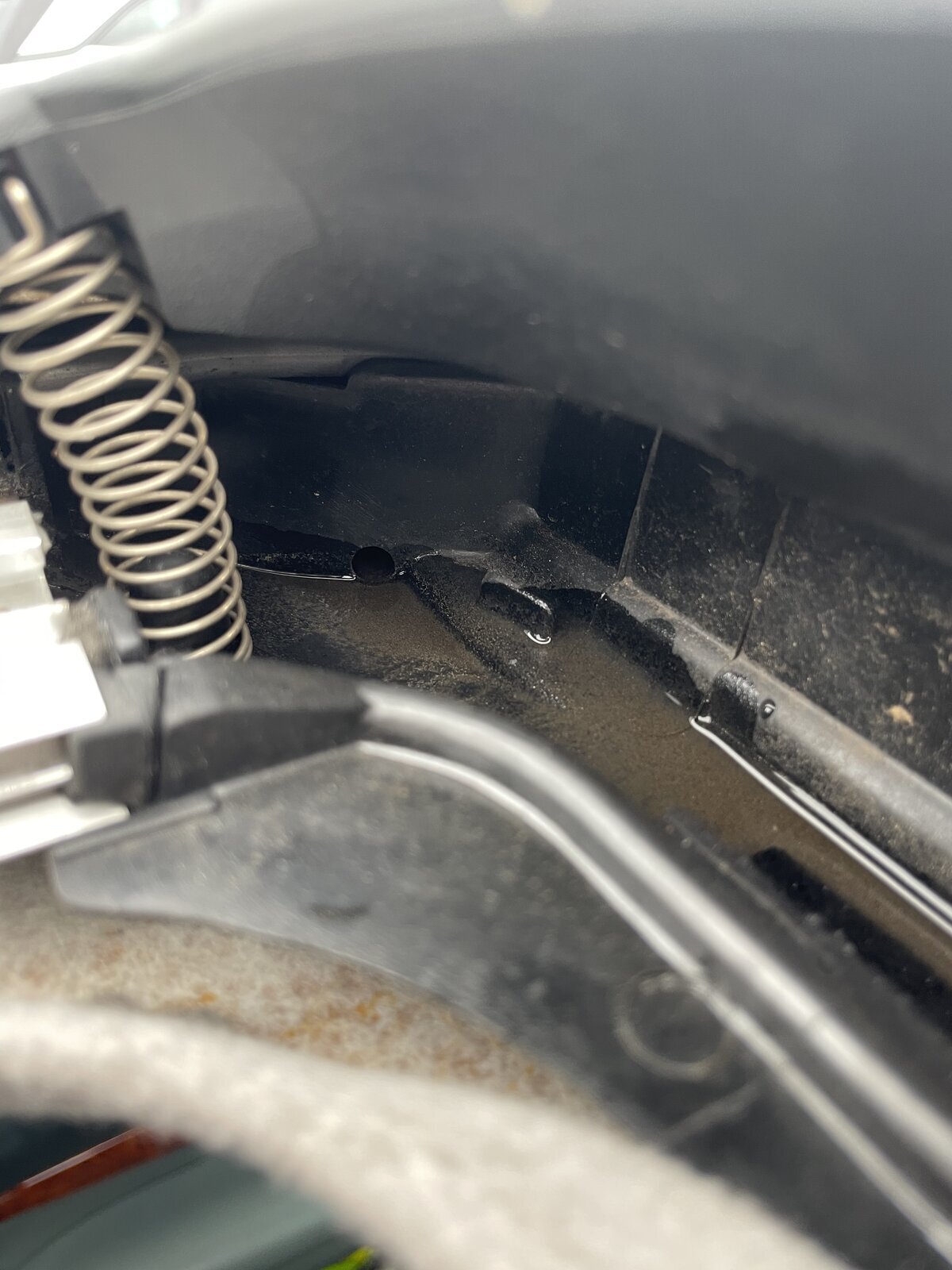

I’ve noticed my car is Steaming up when raining…I’ve not looked at anything yet, but can’t see any wet patches in the carpets. Is it most likely to be the sunroof drains or are there other common areas to look at, and if so what?
Not sure if it’s relevant but my car doesn’t have working air con as I’ve replaced pretty much the whole system and it’s still leaking so it’s back to the garage next week to find and fix the problem there - don’t know if that would cause the car to steam up?
thanks

Where are you seeing the condensation? The window its at might give a clue.
Check the windscreen scuttle and the drains underneath. Have a look in the holes by the wipers with a torch - you can often see if water is pooling up in there; if so it will find its way in. Its not a big job to take the scuttle off and clear/check the drains and make sure its all OK - I do that once a year - otherwise you end up with leaves and all sorts of shite in there.
Check the sun roof drains as you say - I use a line from a garden strimmer to clear mine out!
The rubber bits on the roof under the roof bars - check they're all in place and water isn't getting under those and finding its way in via the roof bar bolts.
Check the door rubbers look OK, including the one around the back door.
Check the window seals - the rubbers are now quite old on these cars. I had the same problem and replaced all the lower outer window trims all around, and that fixed it.

will check all the bits you’ve said - if it was the roof bar bolt holes would it show wet patches on the roof or channel down to the carpets?
Does it mist up when its raining, and nobody is in the car? If so thats a sign of a leak.
You might get damp patches on the roof it just depends what route the water finds.
TBH though, any car is likely to mist up on a wet day if its full of people and there is no aircon on to dry the air out!
Not that I’ve noticed but I’ve only paid attention to it with being in it whilst raining - not done that for a while. I’m hoping it’s that and once (if) the air con is fixed it will be sorted
No wet patches on the carpets and sunroof drains look clear and got strimmer wire down them no problem.
will get air con sorted this week and see if it is just that
