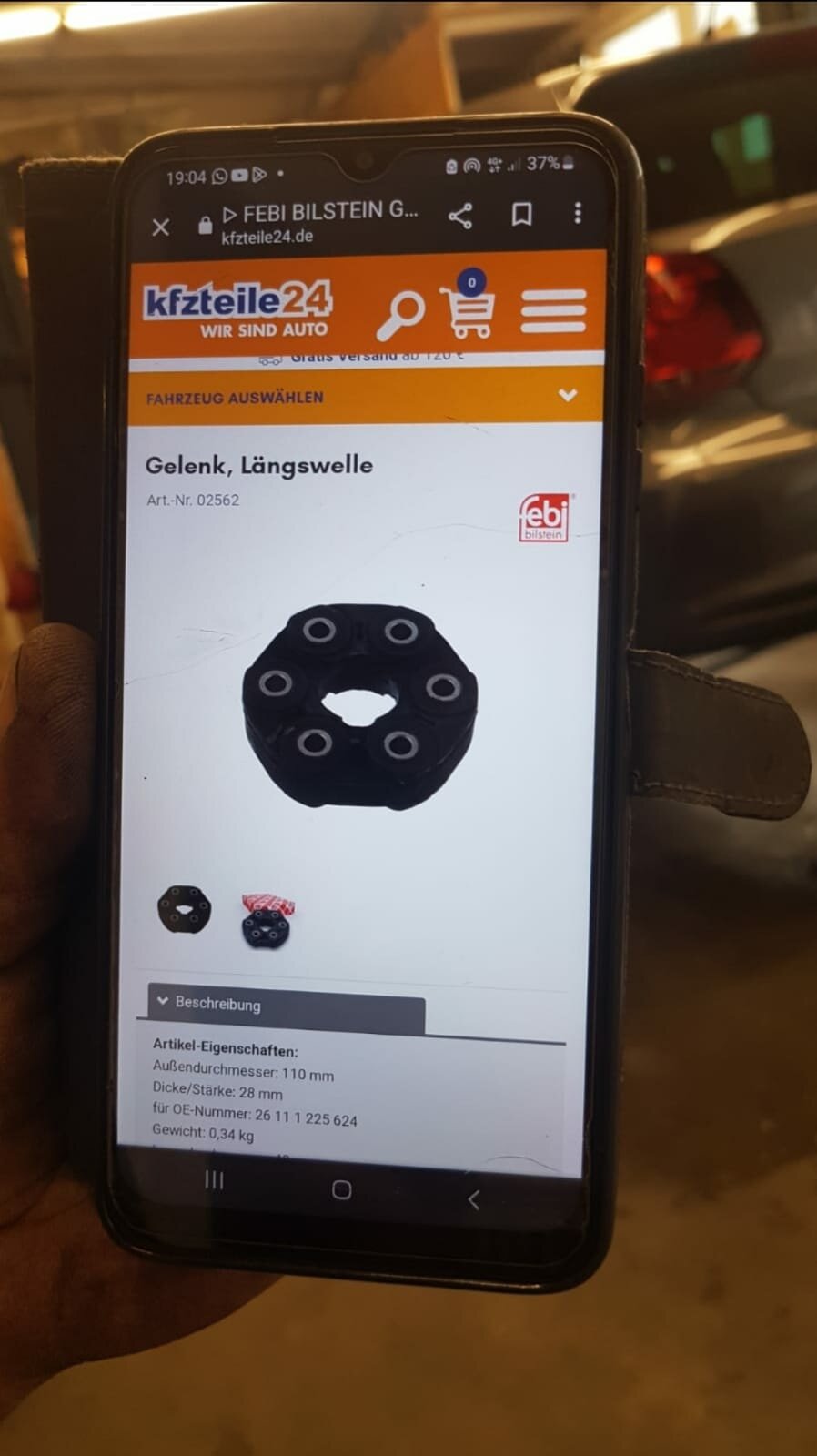

A friend told me that it is possible that this part is broken, but I have no idea where it can be and how I can tell if it is really the fault.

That's a propshaft component. Presumably since your problem occurs when you are stationery this rules out the transfer case, propshaft and axles.

I understood, as I said above, as long as I accelerate a little, even if the car is in P or D, the vibration disappears.
The 4x4 lever can be seen vibrating. But the engine works perfectly, I was thinking that maybe there are some used supports that are the cause of this problem.
I changed them, but I was thinking that maybe there is another support that holds the engine somewhere under them?
