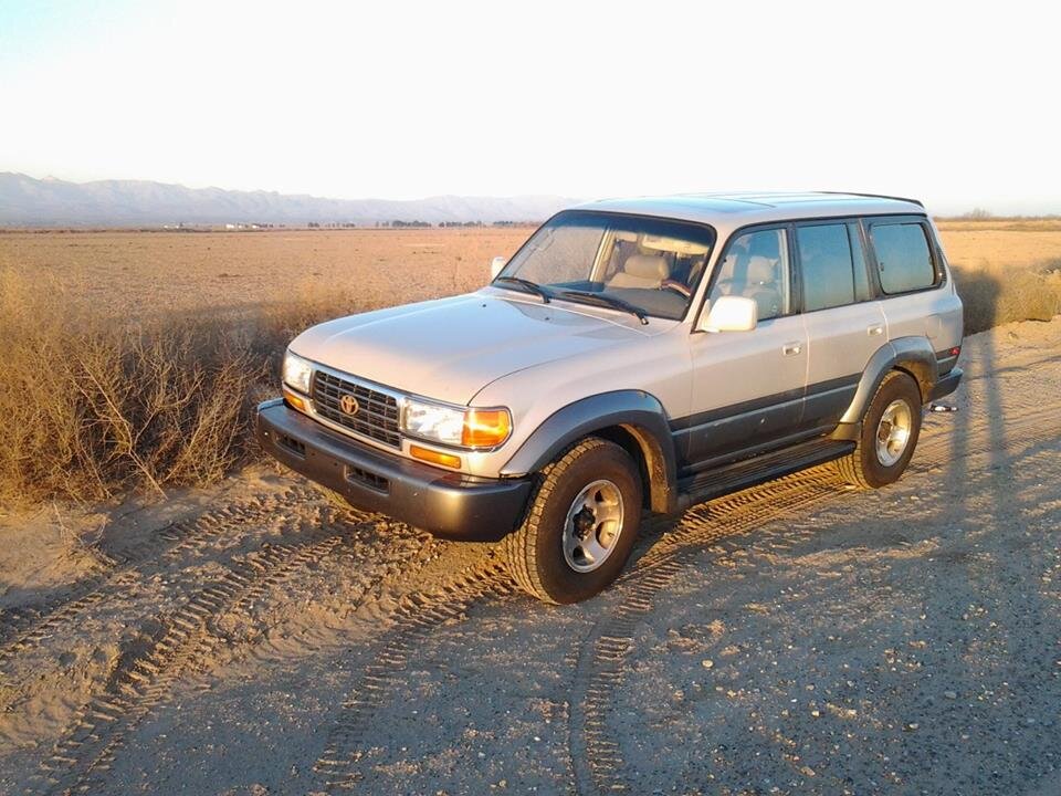

Well, we are still in the "shake down" phase of life with the new series 80. The electrics are slowly reawakening in the doors and seats, oddly enough; evidently they were unused for a long time and just the act of using them has started to get them to function.
