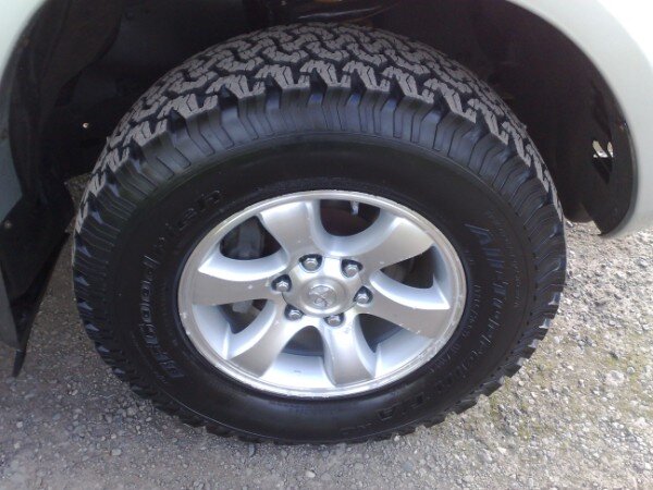

265 x 70 x R17 BFG All Terrains.

'best choice' and 'best quality' will very much depend upon how you intend to use your truck, and in what conditions. If you share that, I'm sure that you will get some helpful info....

I very much doubt you will get 275 x 75 x R17 to go on without some cutting and chopping.
It won't be the vertical height of the tyre that will cause your problem, but more the horizontal that will foul the front and rear plastics within the front wheel arches.
Plus, in my opinion, going larger than 265 x 70 x R17, shown in my image above, will seriously have effects on fuel consumption.

I'm newbie so will defer to your better knowledge. Was just going by posts on another forum that said the max size you could safely fit to a stock 100-series was 285/75/16. As we are talking R17 not R16, a look at BFG's specs here:
http://www.bfgoodrichtires.com/tire-selector/category/off-road-tires/all-terrain-t-a-ko/tire-details
...indicated that a 275/70/R17 should be around the same diameter and thinner. I take your point on fuel consumption for sure, but also would be interested in what you think is the max size you can fit to a stock 100 without rubbing, just to know.
