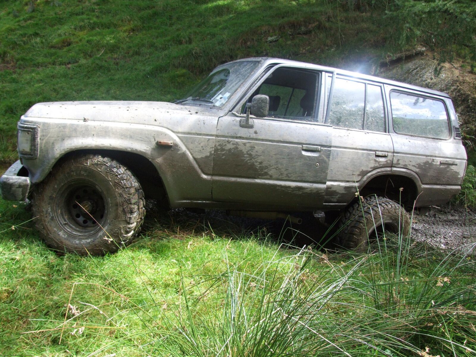

To allow me to fit my 33's I have a 65mm body lift which means when the axle meets the bumpstop on full articulation there is still 40mm ish space between the tyre and the top of the wheel arch. Like this:-
