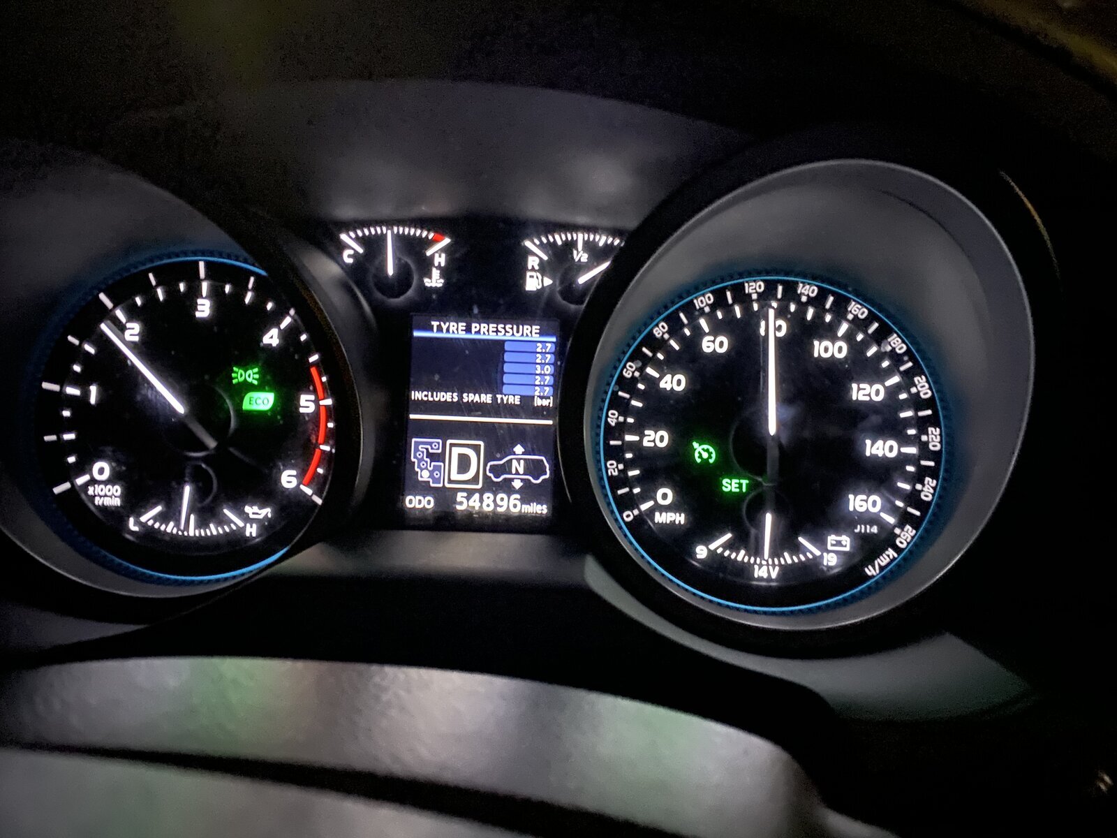

This was on cruise, it would just sit there, no change in rpm at slopes or inclines on road. I was alone in car with max 30kg luggage
Is the tyre pressure monitoring a factory option? Thought mine was full spec when I bought it and then I see this lol
:) Tyre pressure monitor is a default option. For me it always shows low warning if I have pressure to 2.4. Mechanics have set it higher than 2.4 (factory recommend pressure). After driving for a while the warning goes off
Hi Raj,
Yes when you get to 75 or 80 it behaves much better but the issue is more around 60 to 65, it just wouldn't stay in 6th. Even more notable when towing. The Geelong map significantly improves this needing much more pedal pressure to force a change down
