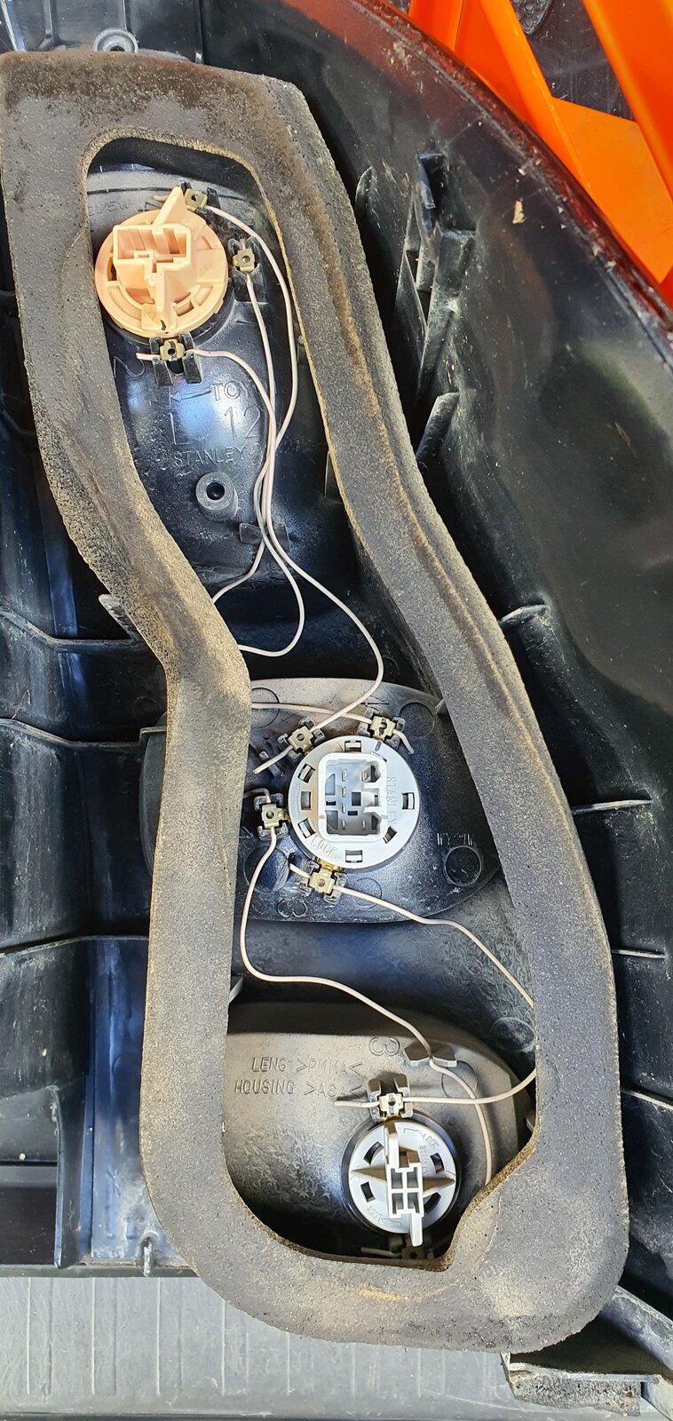

Yer, initially was going with Karl's suggestion of using tow bar connections in cubby, but that means extra wiring across lc to o/s. I think I will go from bumper lights as stated, which are a direct vertical route each side, and means I can make up 2 looms both the same. My stumbling point at the moment is finding the correct contacts to go into the original multi connector on the back of the centre upper light fitting either side, which are one end of home made connecting loom. See Karl's photos for those extra wires going into connector.
There are so many sizes, seemingly dictated by stranded cable gauge only, namely, Molex, Metra, du Pont.etc
As per my reply to Graham, who seems to have had it easier than us, I have sorted the rigid connector wires between backs of said lights, and the missing contacts on those lights, to complete the circuit.

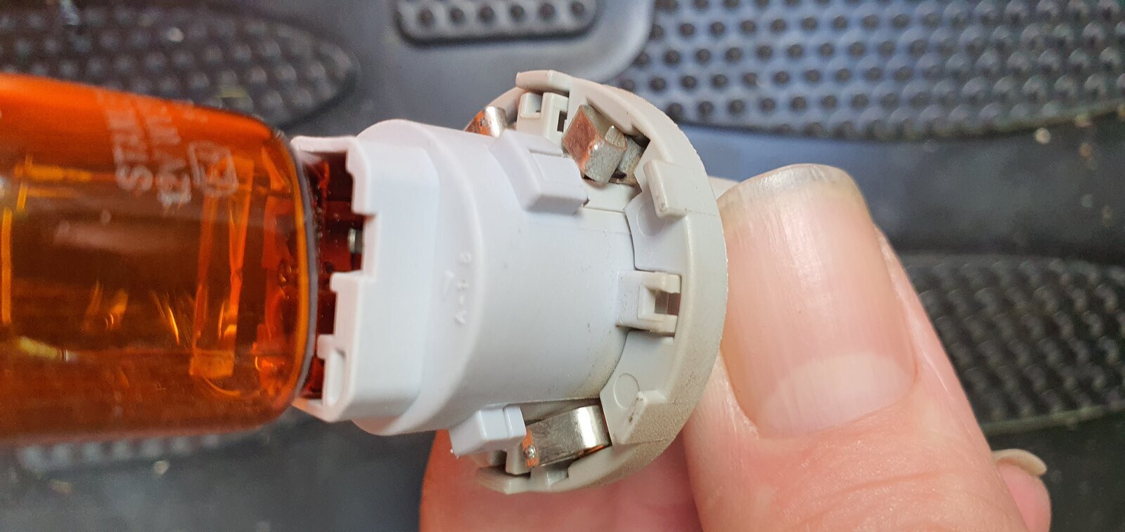

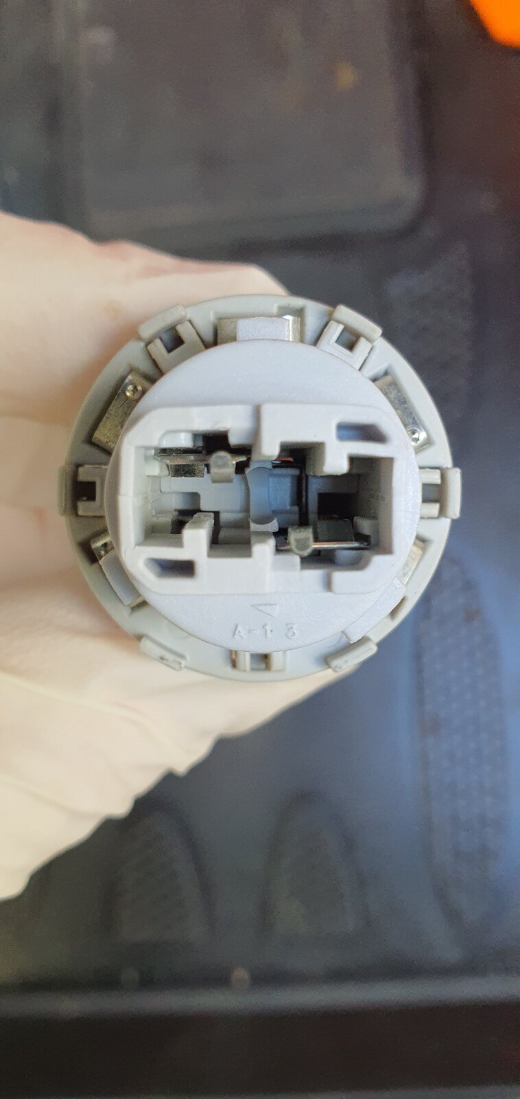

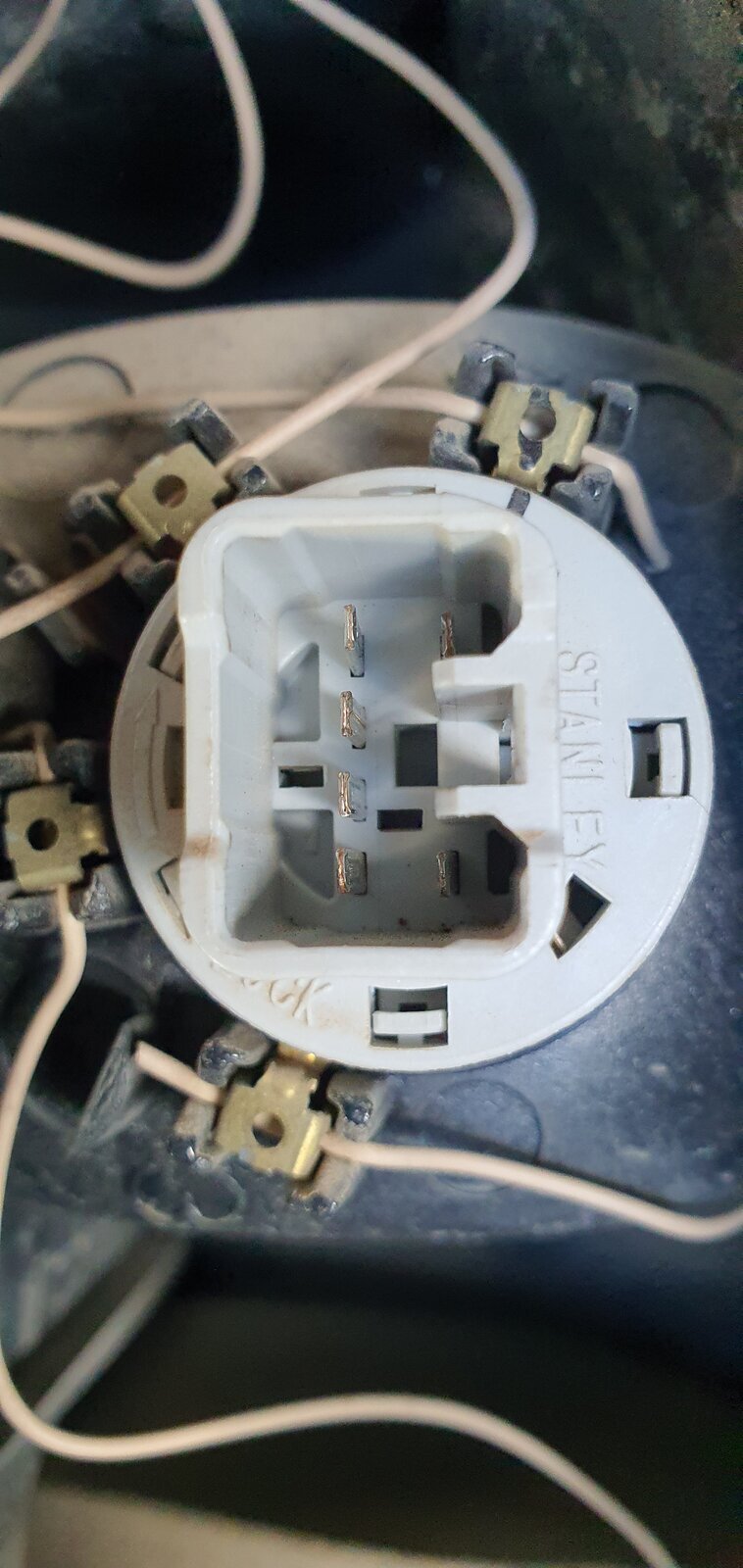

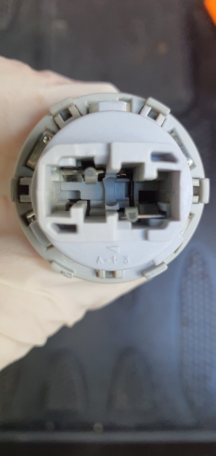

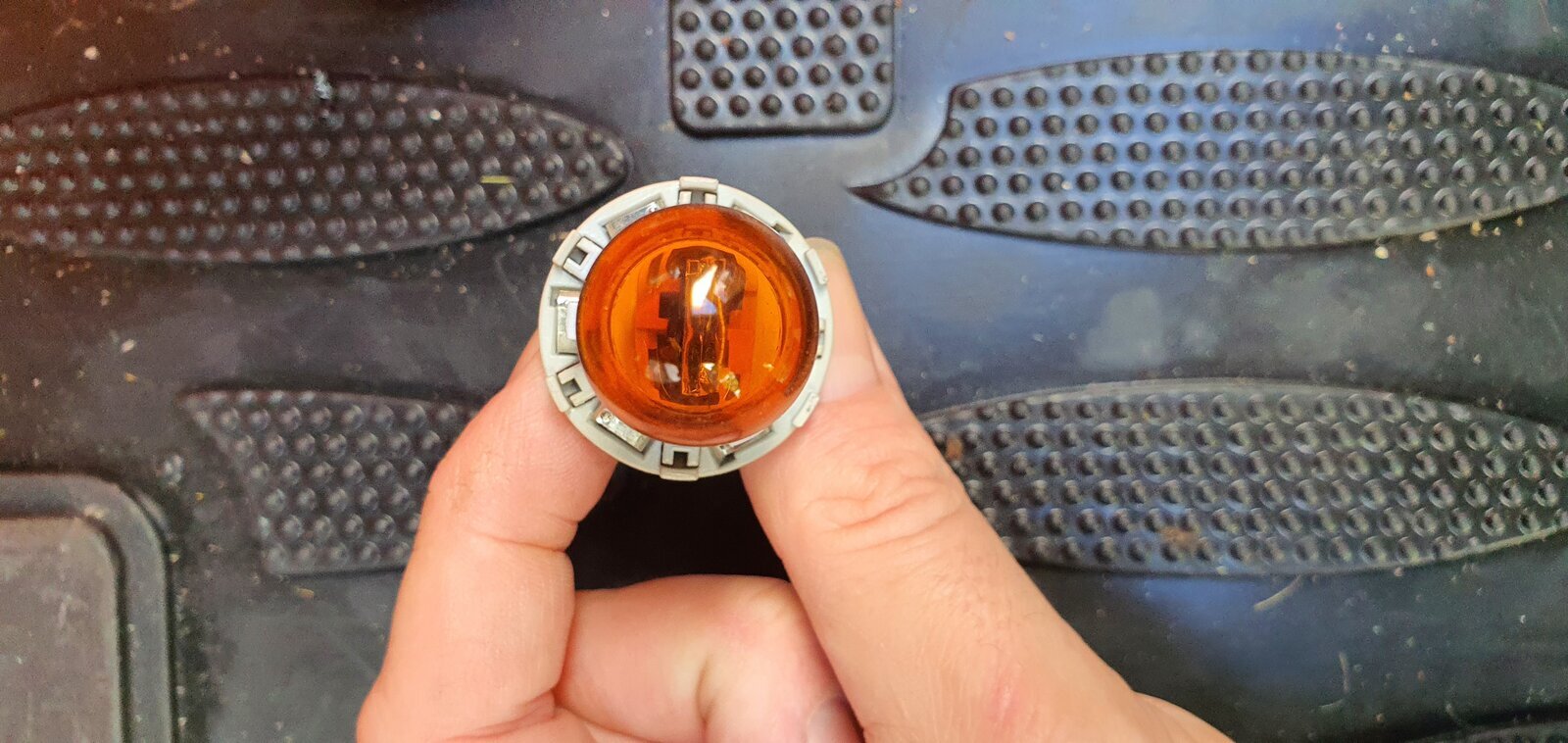

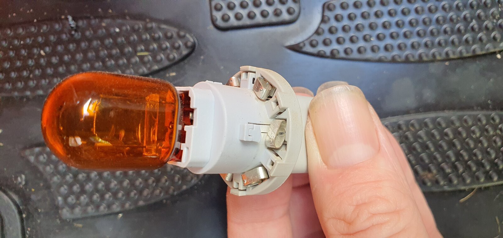

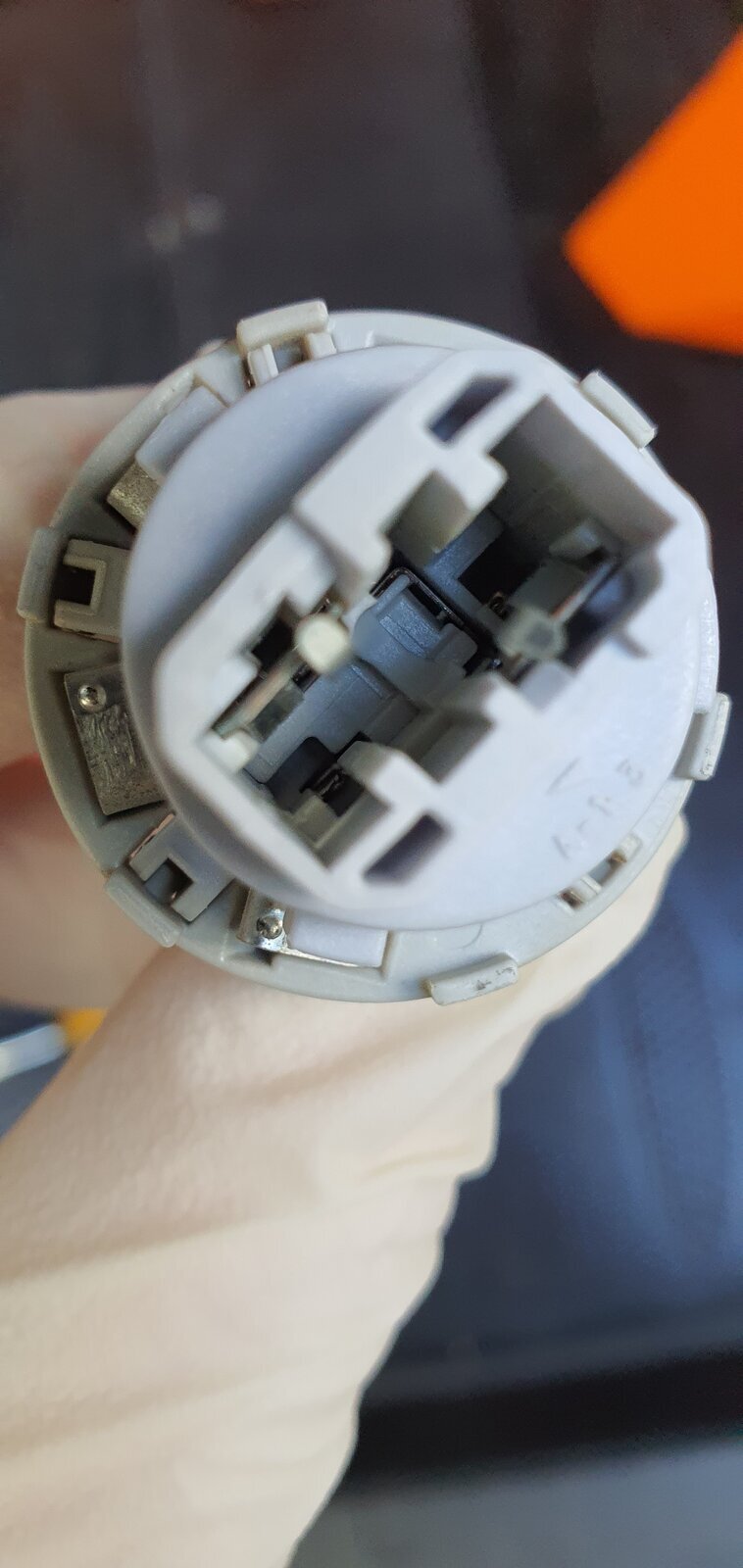

Few more pics of the indicator bulb holder and its contacts

Well done Karl, and many thanks for your extra legwork
From your extra pics, there is deffo only 1 bulb contact in my indicator bulb holders as discussed, and the contacts around the perimeter of yours appear to be different in spacing/width. So even though I have added the extra contacts and link wires on the back of the light units, they are not going to work, as thought.
It all seems to hinge now on getting the correct indicator bulb holders from Mr T as per your given part numbers on here. All other connections/ contacts/bulb holders appear to match up with original and extra link wires/ contacts I have installed. Will be in touch, thanks again.

For sure DH. Some of the work has been done, with karl2000 input we worked out what is what with parts and wiring. Gen. link wires have been added to both lights, from another source, and 2 Gen. Bulb holders with both contacts for lights/ brake, from Toyota parts, the extra looms are in garage awaiting fitment, and a source/route decided for these. I managed to get the terminals that go in the white connectors on the back of each light,they need to be crimped to new extra wiring. Just need to find which space in the connectors they go.
