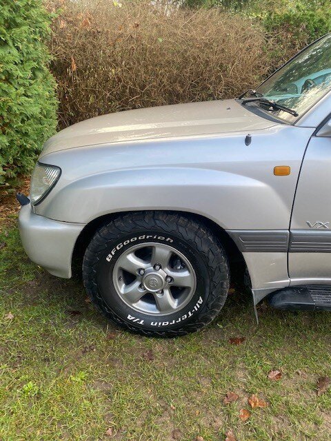

Hi All
Got a 2000 W reg Landcruiser Amazon 100 4.7 V8 Petrol.
Car drove amazing, suspension all worked with height control.
Car goes in for MOT and oil and filter - to my trusted garage and replace the rear tow bar 7 pin socket.
Go to pick it up and the front is like this, low to the ground and wont go up,
It, wont go up or down on the front suspension only. If you change from N to H, it just flashes does not move.
If I jack up the car and Press H, it goes into H but the suspension does not go up.
If this an issue with height control sensor, and if so where are these located , within the shock?
or is it more troublesome than this ? as mentioned it worked fine before the put it on the jack to do oil and filter and MOT
The garage can find what the problem is , and cant plug into the old diagnosis plug.
Any advice welcome please

If you have a look underneath front drivers wing about 10 inches from shock to the rear you will see a leveling device with some electrical connection someone may be able to get a picture up later also have a look for oil leaking around the shocks and hydraulic pipes and check the fluid level in the reservoir which is on passenger side close to the bonnet hinge best I can do right now
cheers, no leaks, levels all good. we are going to replace the front sensors and see if that works .
