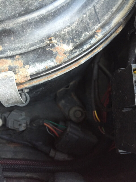

Very clear parasitic drain
Result :icon-cool:
Battery pack, poss the remains of a tracker or something in there too.

doubt it's a tracker Gary this is a 22 year old installation. There were two transformers and all sort of other communications boxes with aerial wires and things. I had the dash out, all the rear panels and the carpet up. Found 10p though. Just kept finding more and more. Also found the double tow wiring though. Left that in.

Seems to have gone Gary. I put a volt meter across the two batteries that came out and they were pretty much dead. The other bits of wiring seemed to have some form of charging circuit so I guess it's been desperately trying to charge these dead batteries. Still is the best 80 I have ever driven. And now it has a beautiful new cassette player in there. With a radio too. And yes the electric aerial works flawlessly too.
