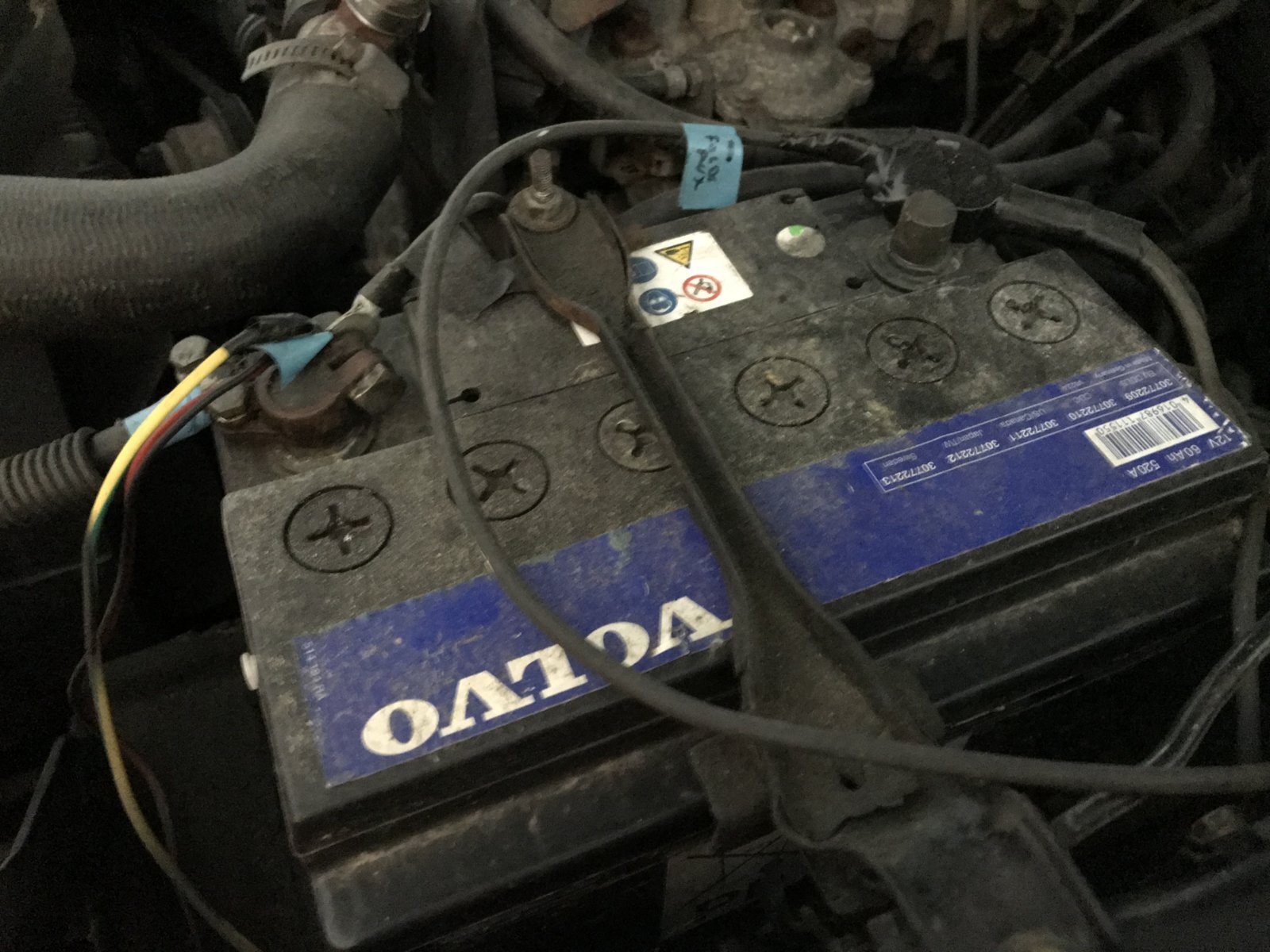

Running off 12v but seem to have 2 batteries one disconnected

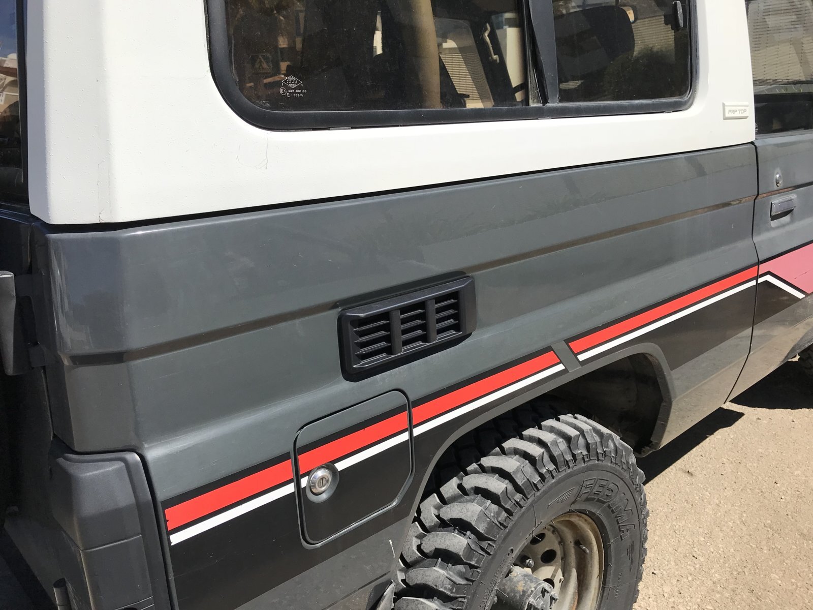

Do you take the frame out for the roof or leave in?

Yes definitely a 2 person job to remove the roof.

I'm not familiar with how they built the 73/74 in Portugal but if its anything like the UK 70's then it will have 2 12v batteries linked together.
Maybe one battery died and a previous owner just disconnected the faulty one to stop it draining the good one.
You usually remove just the fiberglass roof and leave the frame in place.

1: it looks like your 73 has aftermarket rear springs. its sitting much higher than usual... and standard rear springs on 73s of this age are usually shot and they actually squat at the rear. See my avatar photo <<<<<.
Are there any part numbers visible on springs and rear shocks? are the spring hangers standard? can you post photos of hangers?
