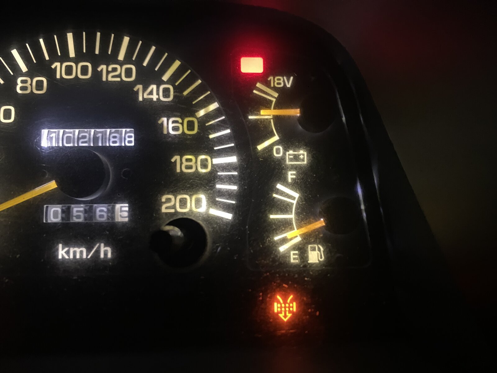

Anyone? What are these lights? What do they mean?

The top one is battery discharge warning, ie, the battery isn't being charged by the alternator. A simple cause of this is broken or no alternator drive belts along with more serious problems of course. The bottom light is clogged air filter warning. Don't you have an Owner's Manual?
I think that bottom one has been questioned on here before and it relates to either a swing out wheel carrier or your tailgate ?
Ha there you go then crossed posts and I have never read my owners manual either
Bottom one is a dirty air filter. It lights when there is too much pressure drop over the filter.
Most of the warning light symbols conform to a vague standard so are often the same on many brands , same as error codes... they are now not manufacturer specific in many cases .
