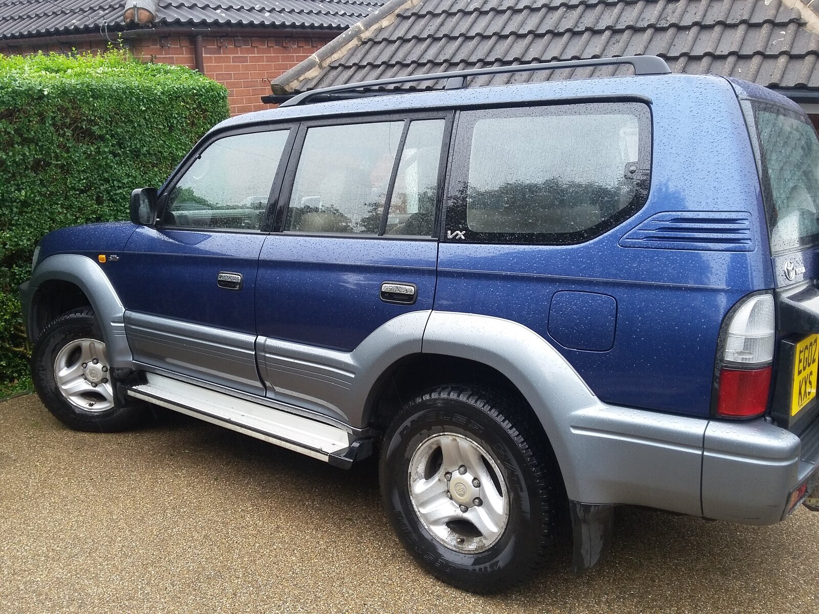

Hi All,
After an absence of just over a year i'm back having bought yet ANOTHER Collie after last one developed a transmission problem and would you believe this one has a problem with reverse when hot but works when cold all forward gears work as they should not terminal just a seal i am told by an auto transmission expert. I am going to try some transmission conditioner first to see if the seals pucker up and go from there the car is in very good condition and never been welded just surface rust on chassis its a one owner 02 VX D4-d auto 134k miles all for £2200 so wish me luck :neutral:

Congratulations! Looks new and that's a decent mileage compared to most round here!
Well done Chas, I remember your previous posts with the Collie and its faults. Lets hope this works out and it turns out well. I had a D4D VX auto and loved it ( now gone though).
