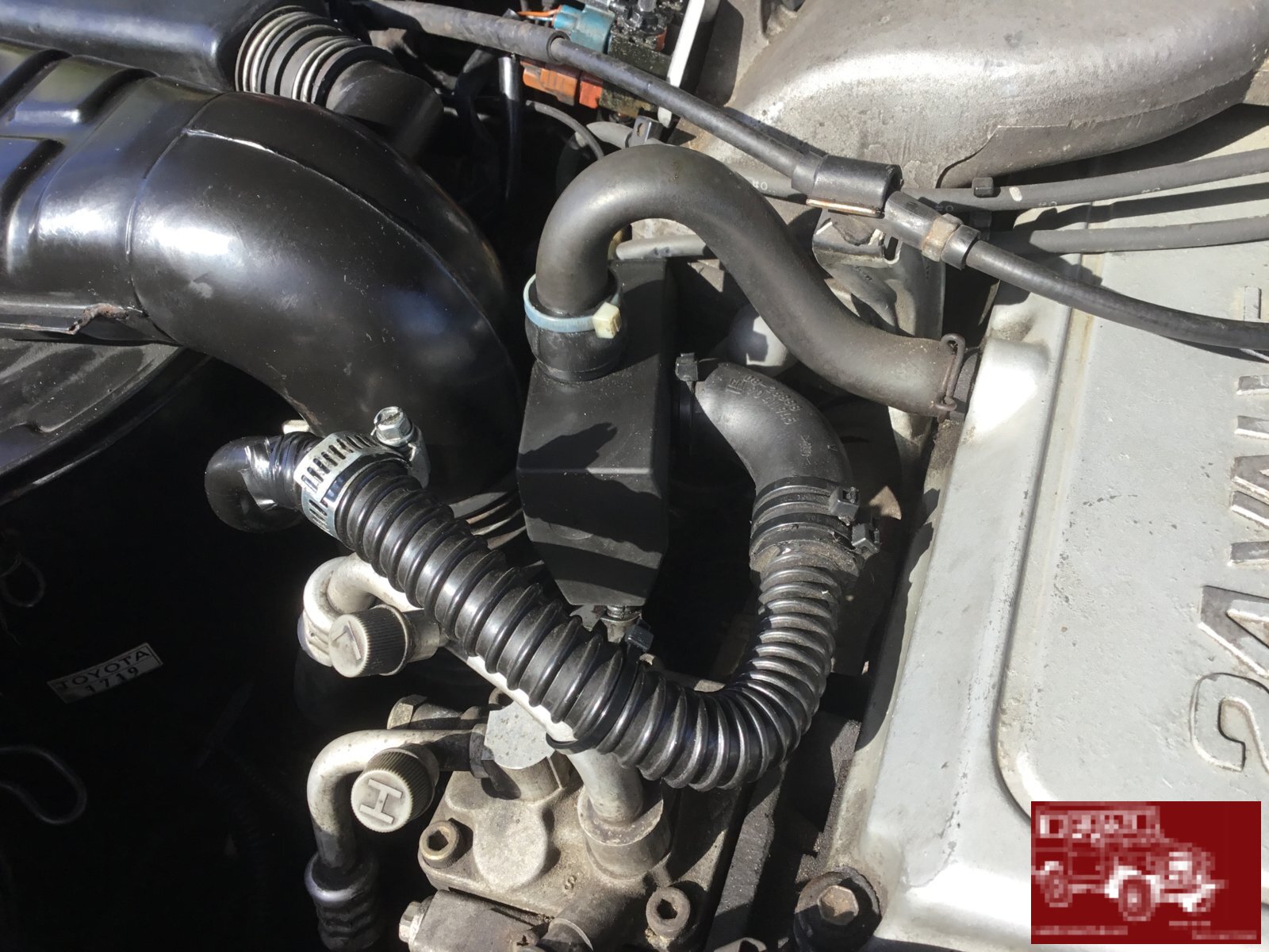

I fitted a catch can to the 80, it’s a Vauxhall part, from a Vectra I think the parts guy said it was. It fits in the space between the rocker cover and the air box. It’s basically just a gauze filter to trap the oil mist/vapour before the gasses pass into the inlet tract. There’s no level indication but it can be removed in seconds and I just empty and flush it every 1K miles or so. I’d say it traps 90%+ of the oil that would’ve gone throug the turbo. Venting out to the atmosphere is a bad idea as, sooner or later, you’re going to get oil drips from the pipe end.

Tow pack any chance of a picture? I might copy you. Thks
